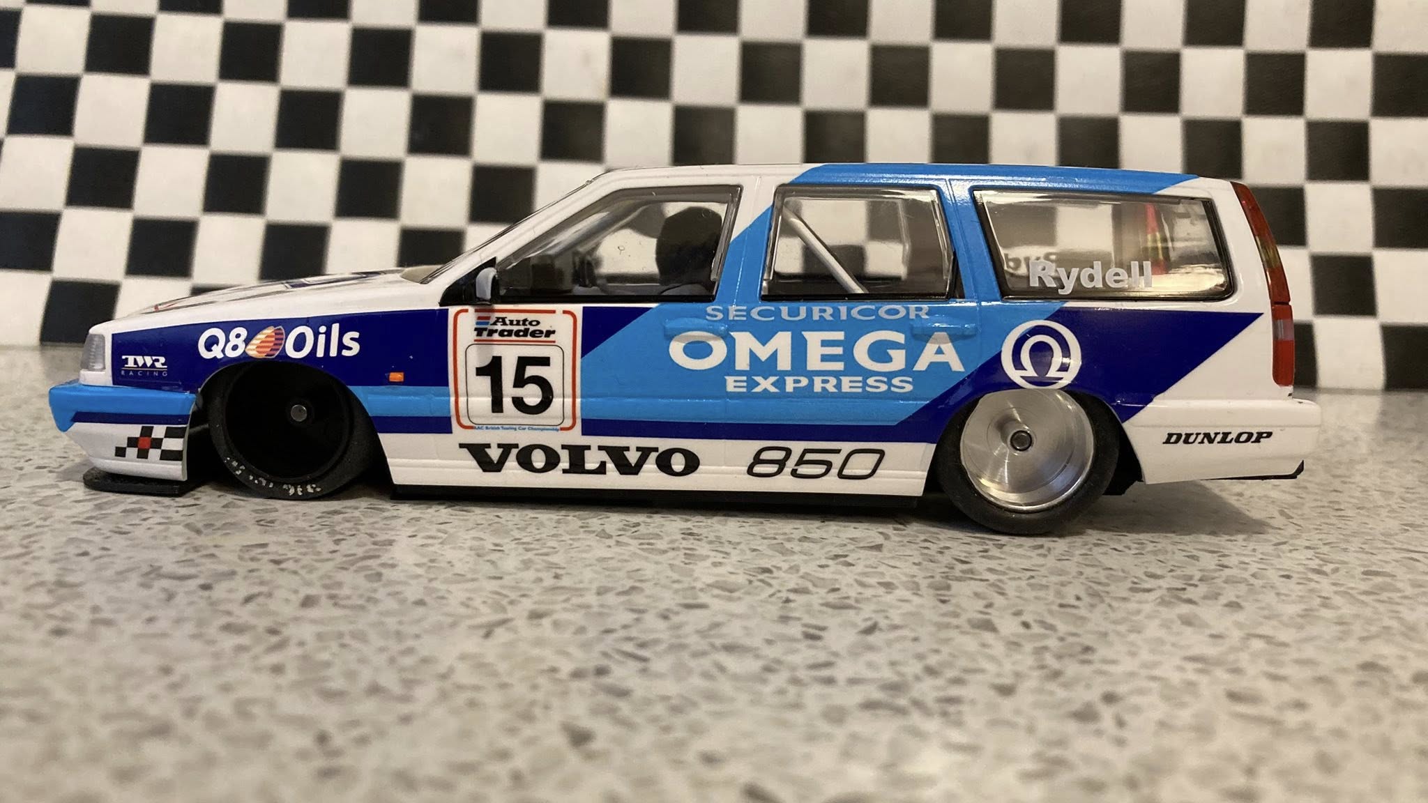

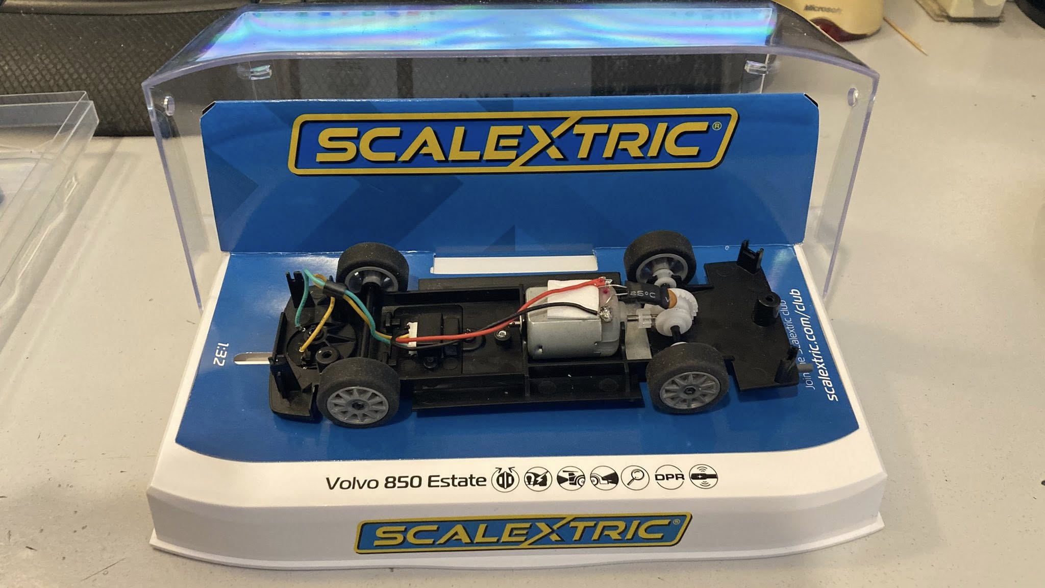

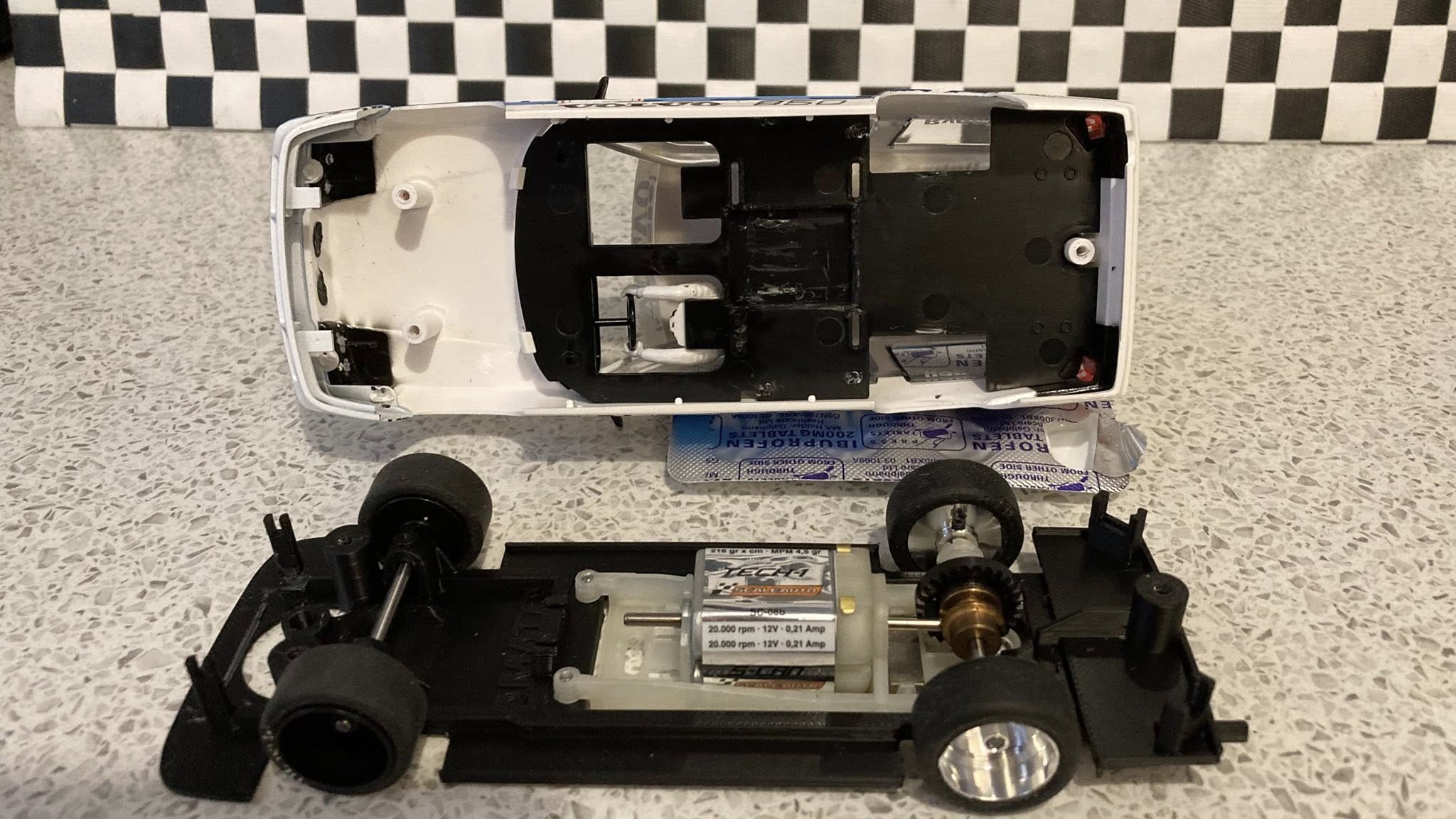

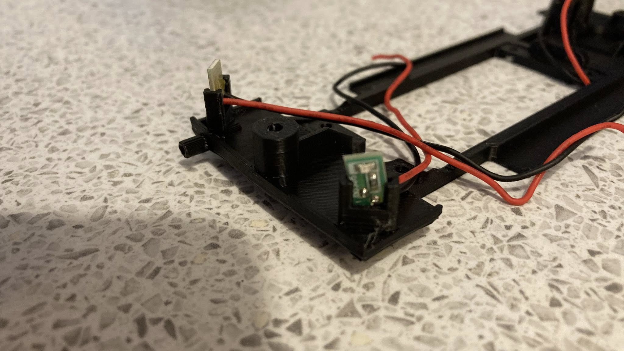

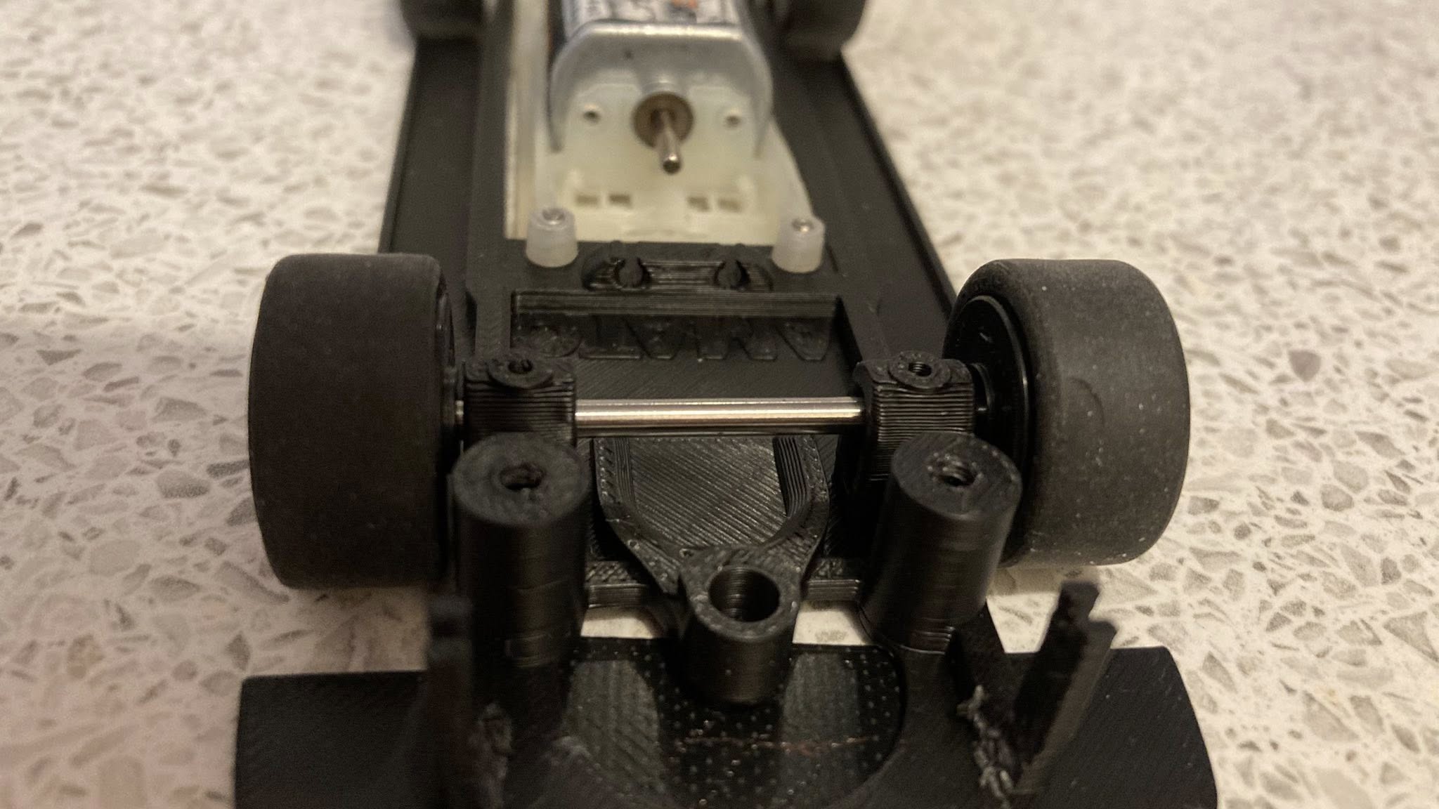

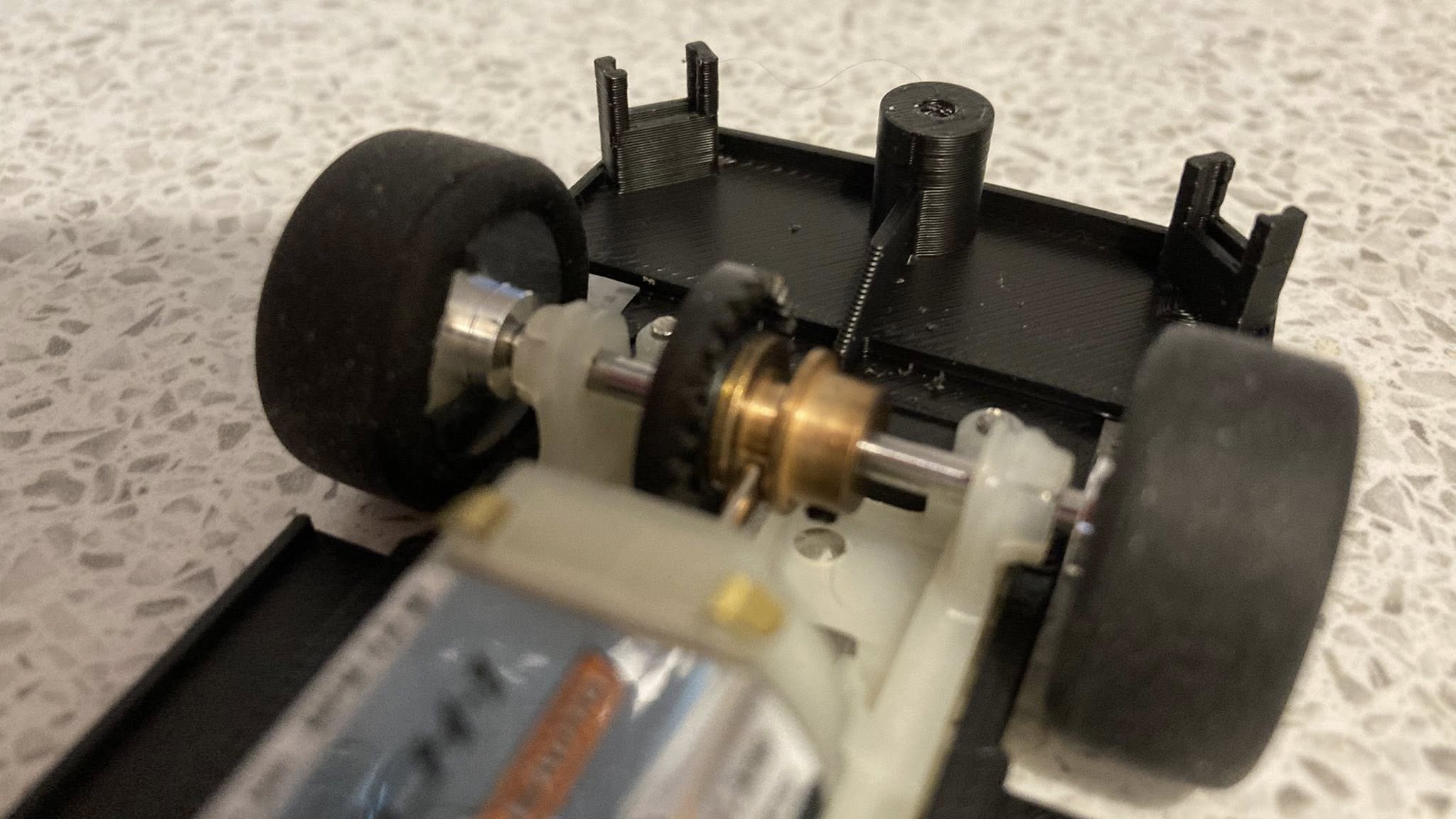

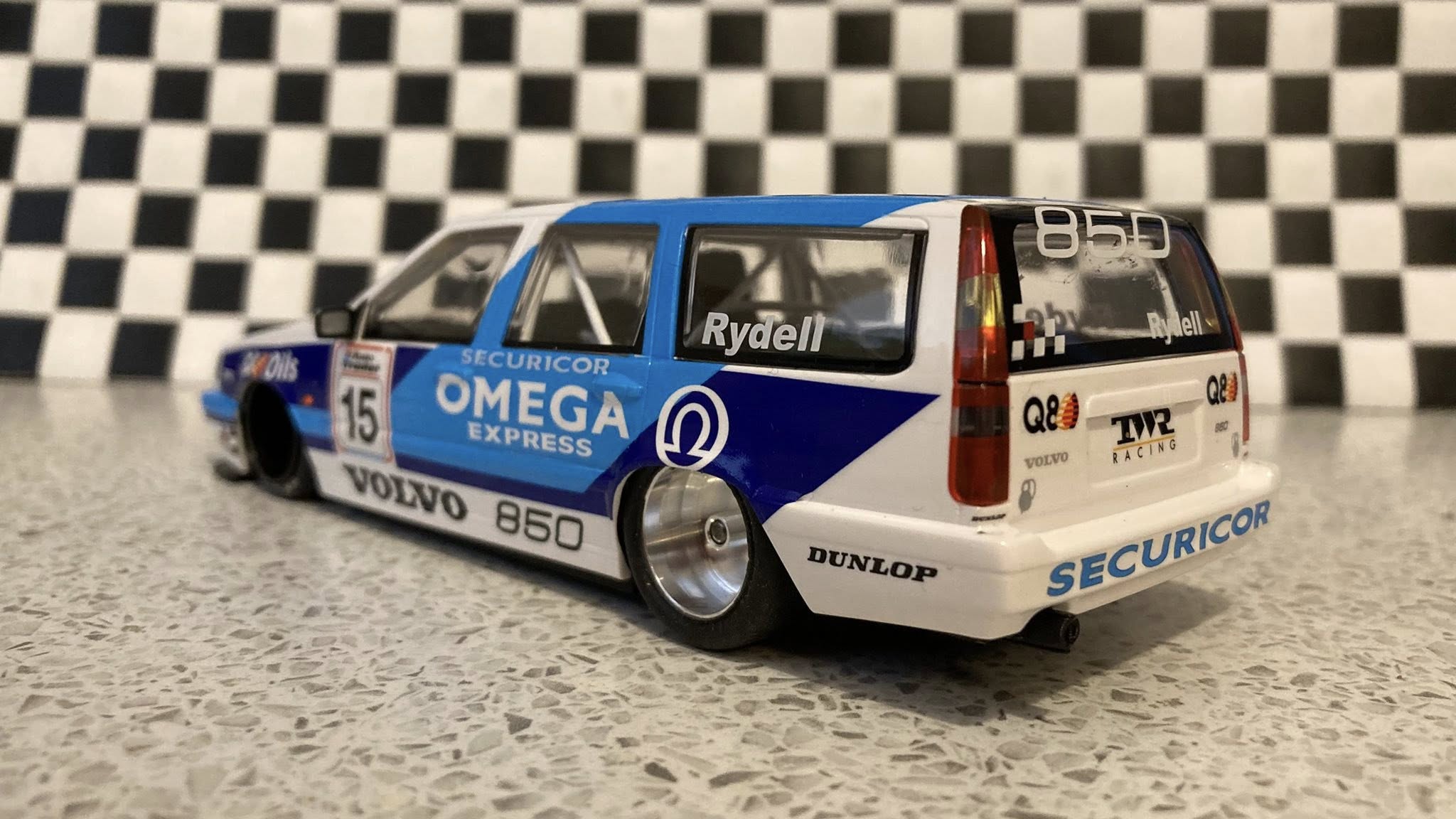

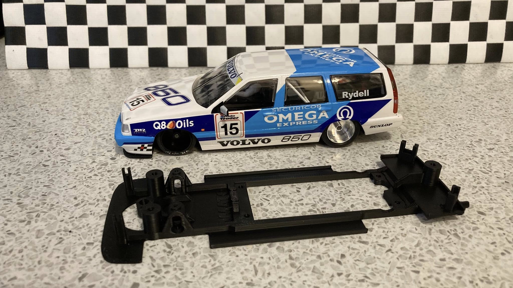

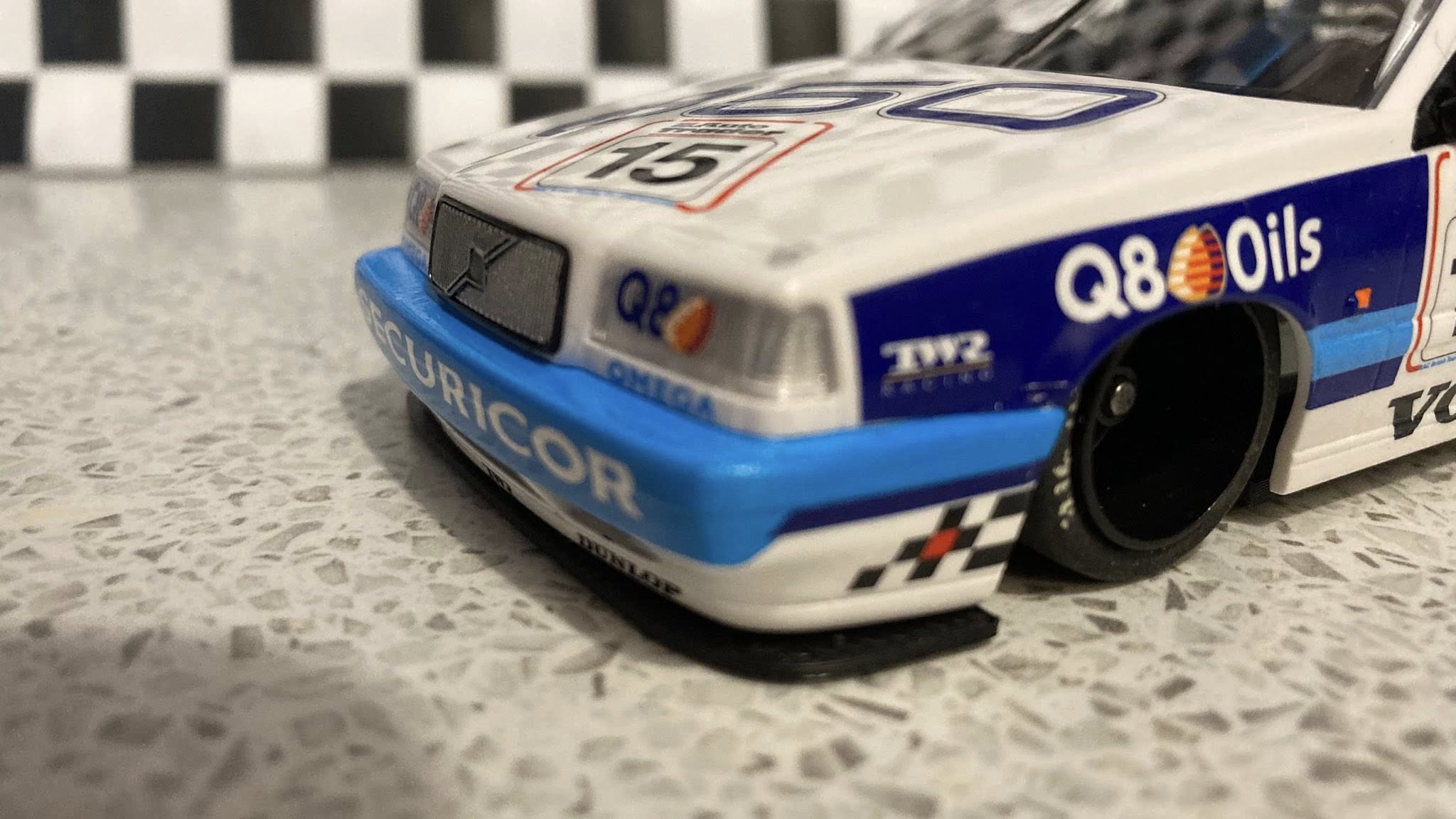

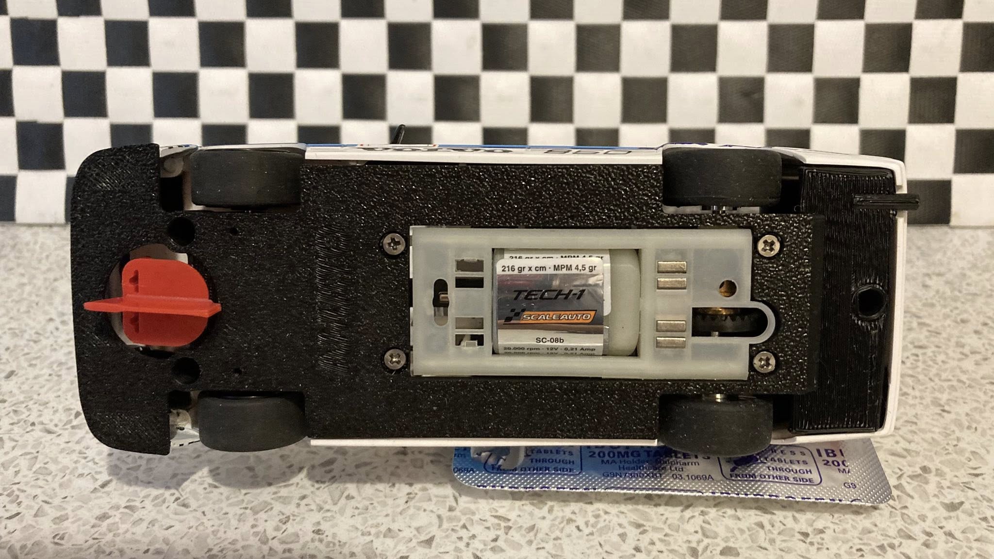

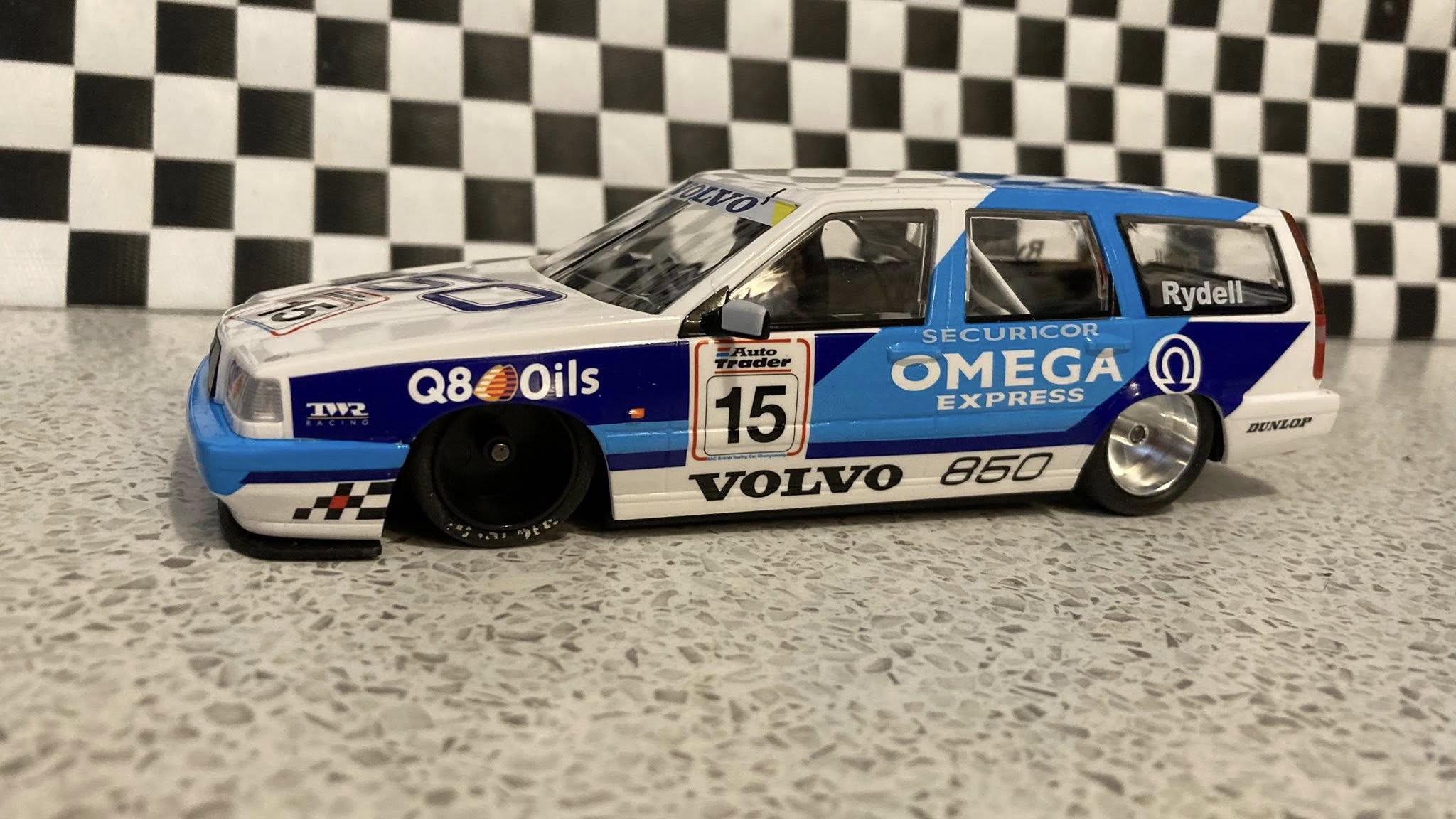

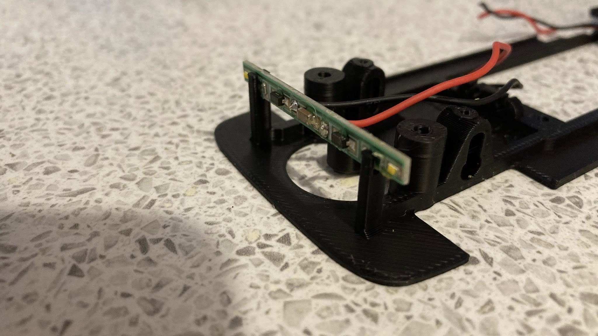

No update for a long while but thought this was worthy of its own post and a few photos.
Been working hard, My chassis for the new Scalextric Volvo 850 BTCC than was just released.
Enjoy  Cool Checkeredflag

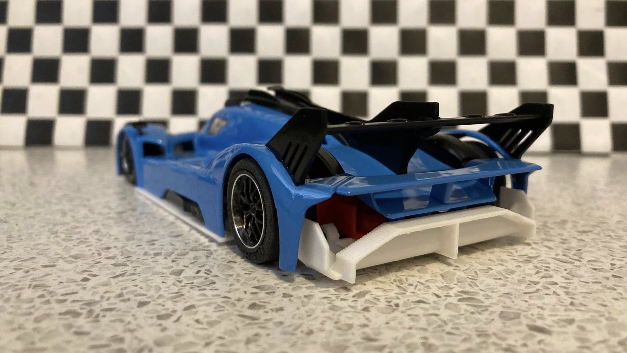

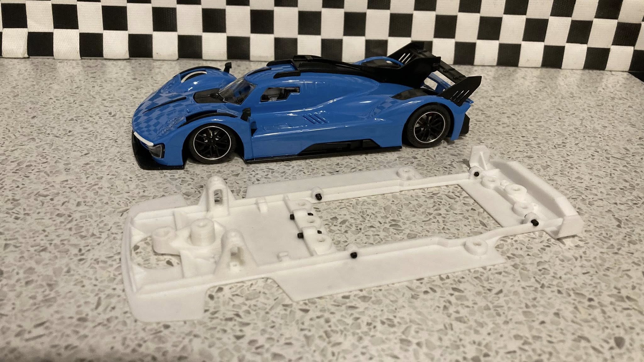

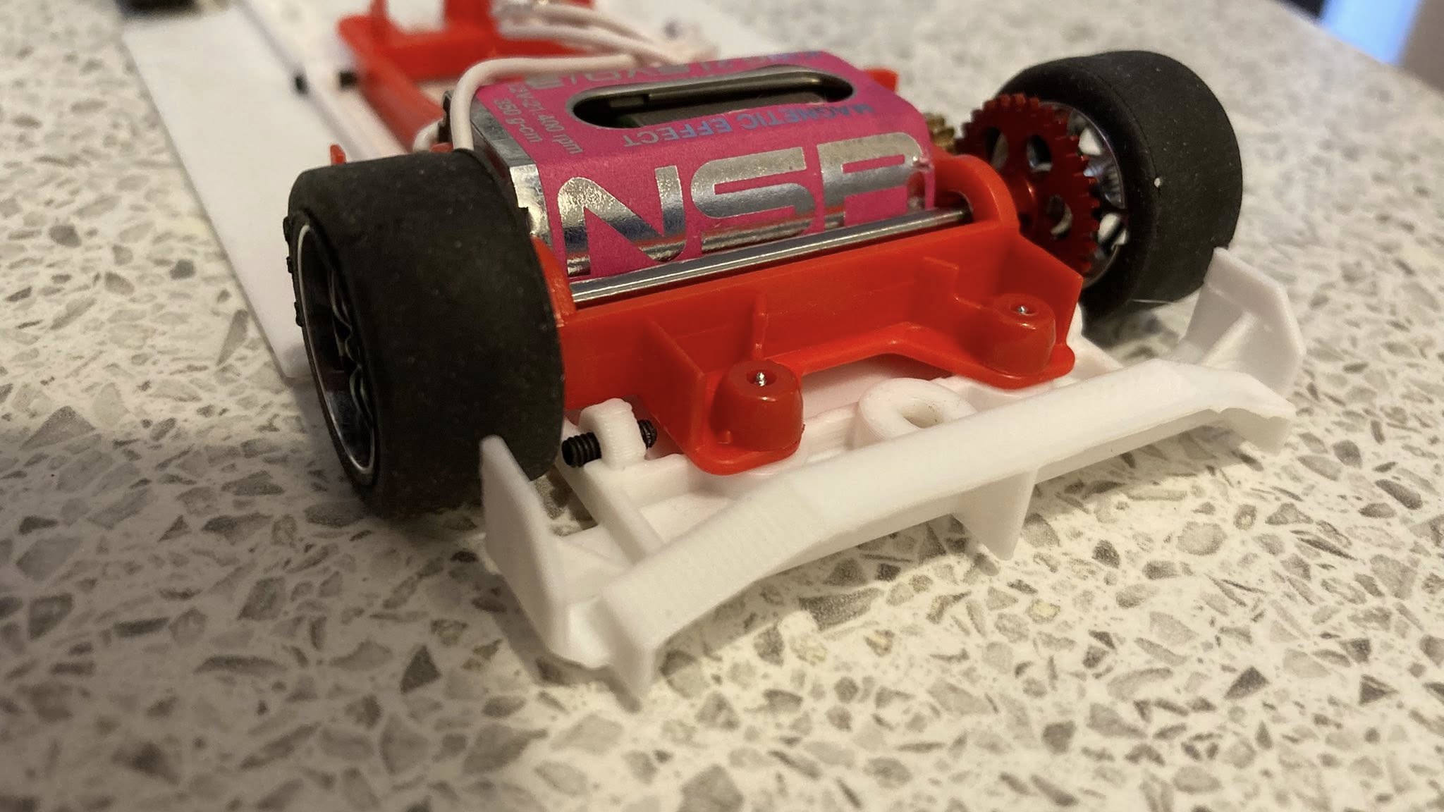

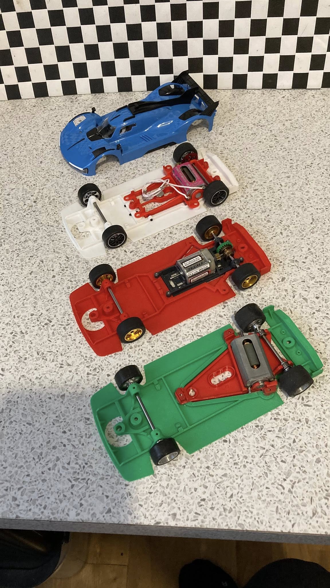

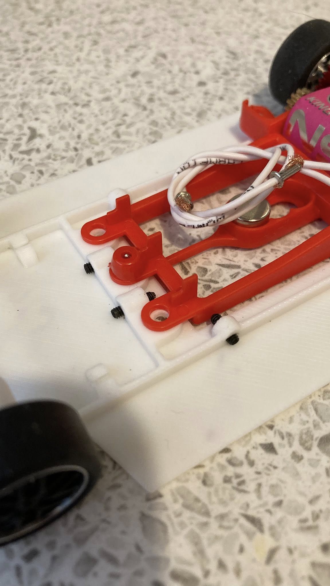

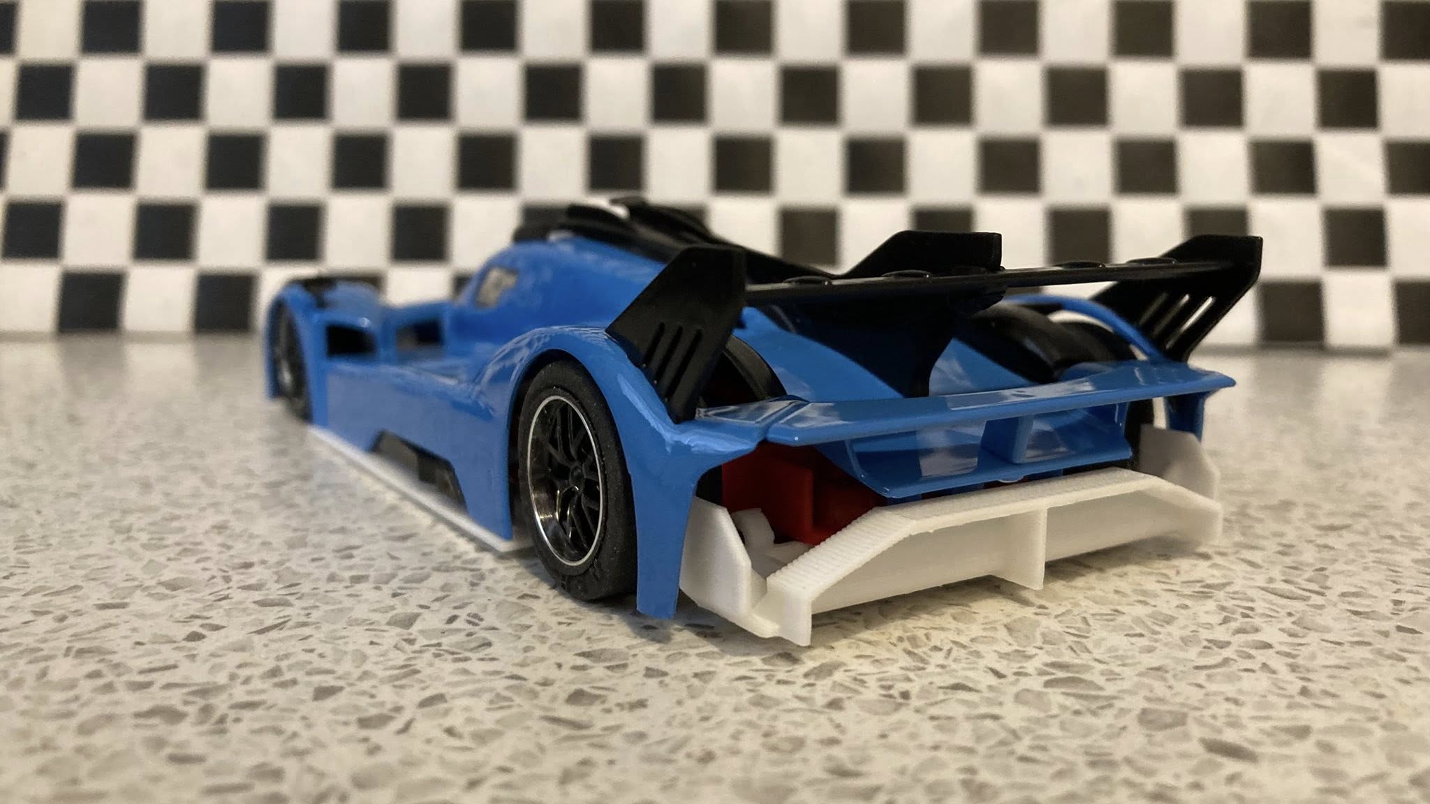

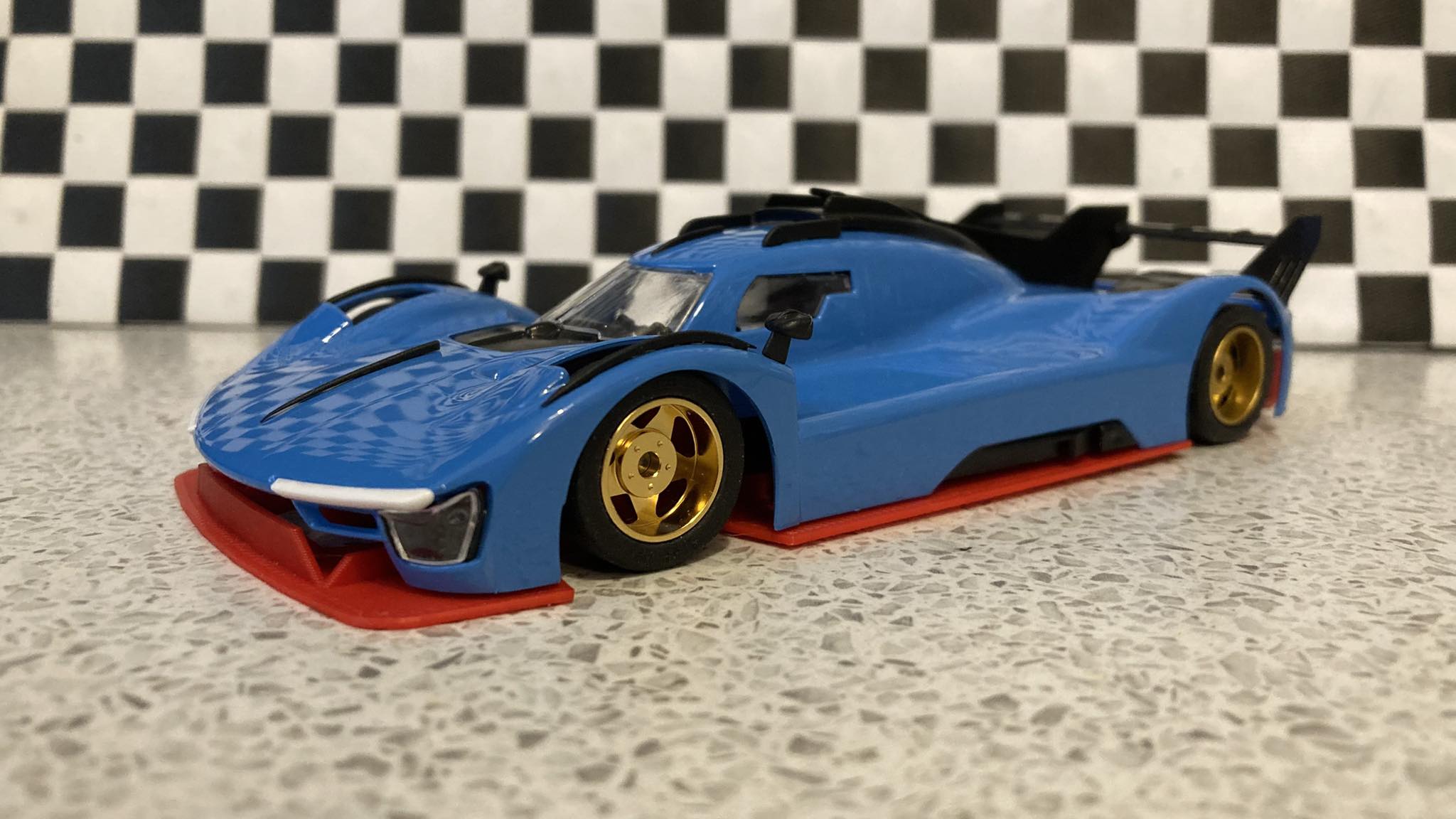

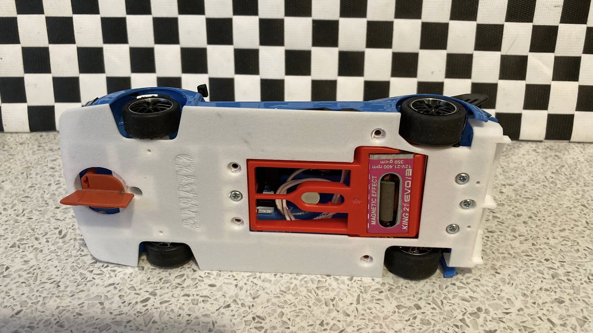

Here is my finished chassis (or 3) for the NSR Hypercar, comes in 3 flavours to take the Hypercar NSR sidewinder motor mount, traditional NSR triangle mount and Slot.it offerings (inline/side/anglewinder).
A few of my own design 'touches' added;
I felt that there was limited room for front wheel width so the uprights supporting the front axle have been moved in slightly, this allows for the wheels such as =AZZi6oVi7O7EpSxKd0iouHRflQxsy_KG-smLxC7DKE7ovwzK6H0mvVLd8DcPQ2OLV50GheLUSiIcO7Lbo4A5Mxwm3WlzhIWp5g4qV-IJlWNPDj8Arf8AmwsJQcTn6Z8BHVXgMFfwYoj8Lw0cBKro0GSv&__tn__=-]K-R]Staffs Slot Cars Wright which have a raised boss on the rear of them to tuck into the bodywork for a lower ride height. These also take slot.it spherical bearings (as found on slot.it motor mounts) as is the case with most of my chassis designs now.
All chassis' are stiffer by design so should suit flat wood tracks more.
The NSR Hypercar motor mount version has additional features of being able to add M2 grub screws to adjust/limit sideways and fore/aft motor mount movement [Image: 1f642.png]. The white chassis shown is a pre-production one and does not show the rear limiting screw location.
Price is £12uk for any version and are available to order now [Image: 1f642.png]
NOTE:- production chassis' are BLACK (black doesn't photograph well)
I can now offer a limited range of colours on prior request but this will extend lead times slightly [Image: 1f603.png]   Colour does not affect stiffness properties of chassis !
