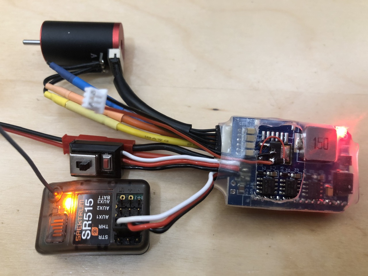

The recent discussion on this thread has helped me to shape the details of my ‘so-called’ stage 1 experimentation. I now realise I should include some sensorless motors in the trials too. This should help to answer the questions I pose in my previous post relating to ‘cogginess’.
Recap: stage 1 uses commercially available in-runner brushless motors plus a commercial ESC (electronic speed controller). Wireless control is via a commercial Spektrum DSMR transmitter/receiver combination. Track power is either 7.5V DC or 12V DC with step-down to 7.5V via a commercial high efficiency buck converter. A smart LED as discussed elsewhere will provide stay-straight/lane-change commands to the in-track lane changer electronics.
My next post will show the hardware configuration for ‘stage 1’ plus, hopefully, some on-track results. This may take a few weeks!
Meanwhile, I'm happy for the debate to continue on this thread - that’s the way we all learn from each other :)
c
ps the unloaded max wheel RPM for the 5500KV sensored brushless motor running at 7.5V is 18,200 RPM as measured by tacho. Transmission ratio is 31:13.

All of the above electronics and the 4300KV brushless motor have been fitted into a NSR Z4 AMG and tested on the H&B rolling road testbench at 7.5V.
At full throttle the H&B testbench reads 28.2mph which corresponds to 45.1km/hr.
Converting to ‘more useful’ units this gives a testbench speed of 12.5m/s.
This of course is the rolling road speed and track maximum speed will be less. However, I am happy with this maximum rolling road speed as the basis for ‘drivability’ track-level trials. Remember this car has a sensored brushless motor so low speed running should be relatively smooth too. Also, the transmitter in use has adjustment for maximum throttle, throttle curve, and adjustable brakes.
c
