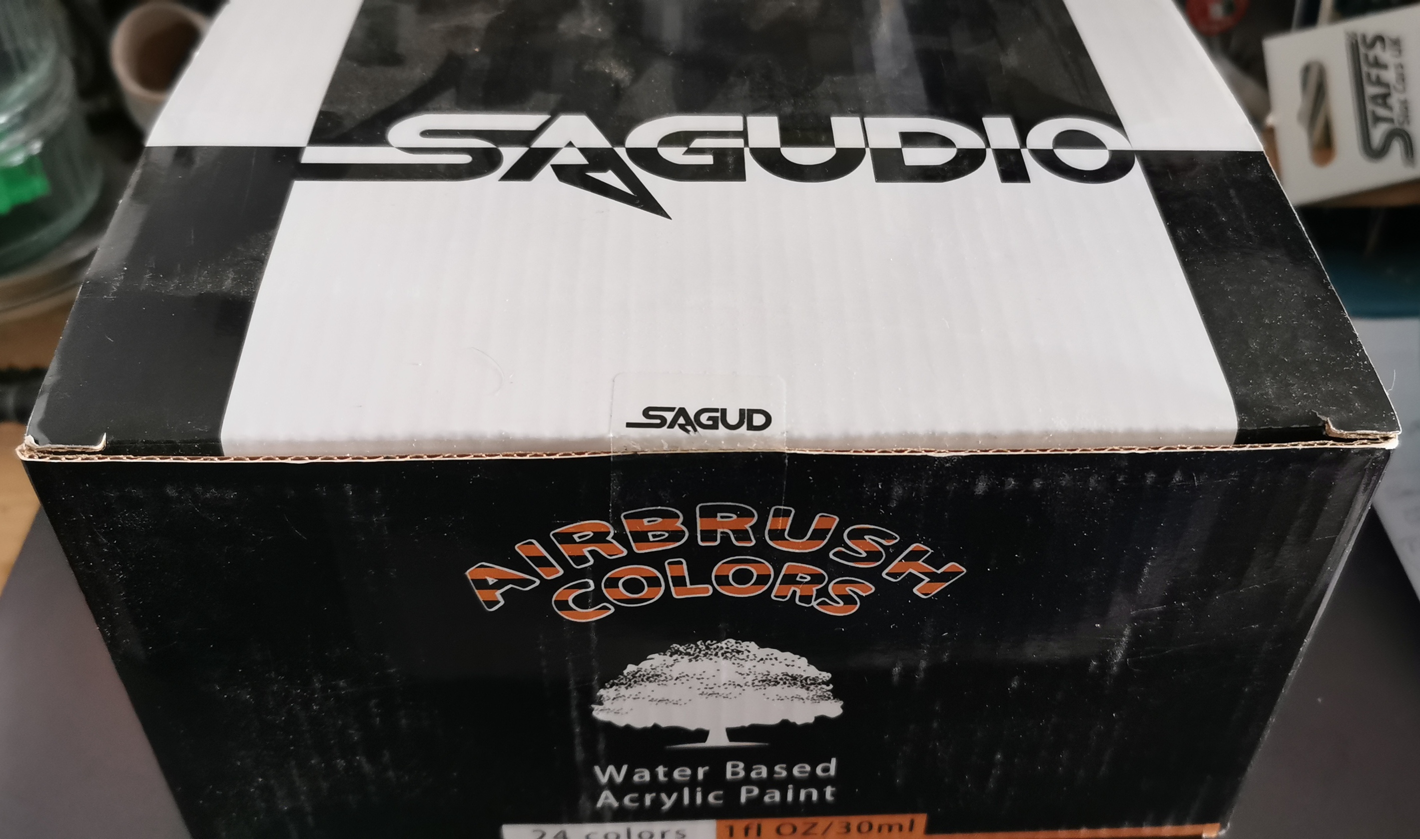

I'm now searching for paints, they'll probably be more expensive than the airbrush

Using my own (perverted) logic I've just ordered my paints...... from China (should match the airbrush)

I'm stunned.... amazing service, they obviously have UK stock, ordered 15:45 yesterday, arrived 13:20 today BRAVO
