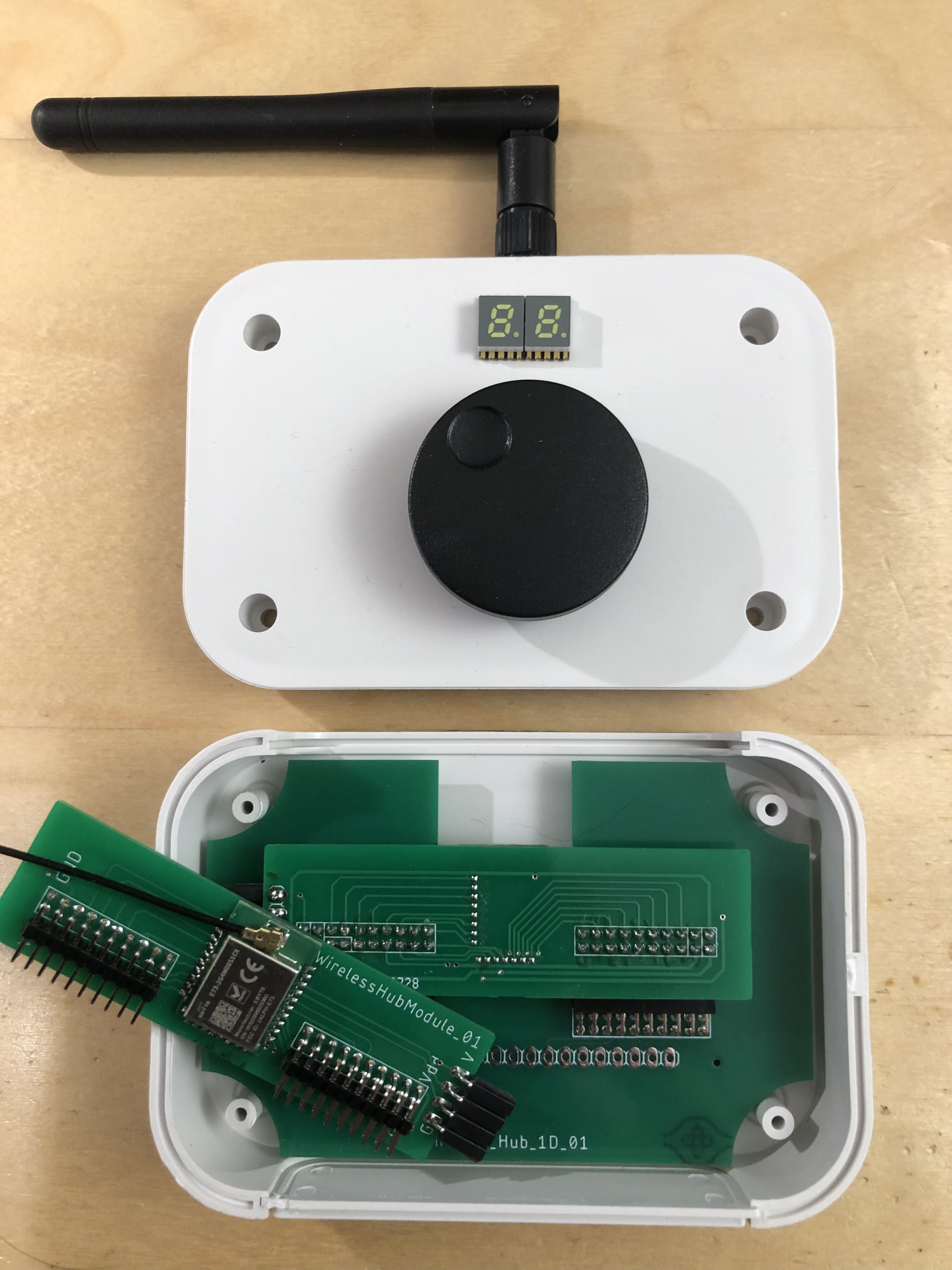

Here is the work-in-progress ‘Wireless Hub’ for 12 car control.
The dial and LED readout are for channel selection and ID binding. All 12 cars use the same channel set once selected so this only needs to be done once. ID binding is carried out individually for the 12 wireless throttles and the 12 in-car decoders. In each case the desired ID is selected in the range 1-12 using the dial and a press-to-select feature.
For lap counting and lane change, this is achieved using an extension of the SSD Infra-red strobe technique in conjunction with under track phototransistors and a sensor hub module.
IDs 1-6 match the standard SSD mark-to-space protocol and these, if required can register laps with the APB and ARC Pro powerbases as an alternative to the above mentioned sensor hub. All 12 IDs control standard SSD lane-changers (this has been reported earlier with a technical limitbof 14 cars).
The wireless hub (as can be seen in this photo) is in development at present with some way to go before the device is ready for testing on a 12 car raceway. Prototype wireless hubs (not quite as smart looking) are already running and the throttle-to-hub-to-car link has already been tested with the in-car decoder in a car running on a test track. So progress is happening.

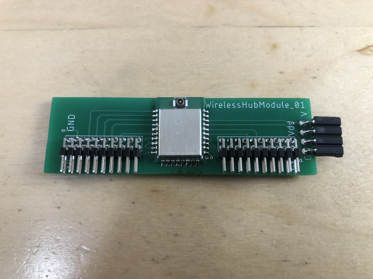

Earlier I showed a 2x20pin RF module which is based on the Nordic nFR52840 wireless chip. This module forms the core of a twelve car wireless hub which is designed to receive inputs from up to twelve wireless throttles. The wireless hub then either forwards this throttle data unmodified onwards to the twelve cars or, alternatively, the data can be modified via input from a race management program running on a PC. This approach is interesting because it should allow both lag-free wireless comms between the throttles and the cars yet at the same time allowing for simulation effects such as fuel mass effects and weather etc. [Note by lag-free I mean approx 10msec maximum delay i.e. undiscernible by human drivers].
It’s early days, the core wireless system functions in terms of reading throttle values and broadcasting this information to the twelve cars. Next to test the PC power control functions via USB signals from the PC (i.e. the race management program).

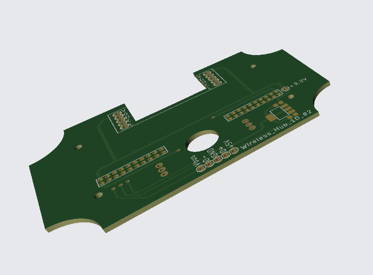

The image below shows a second prototype of the wireless hub which includes the necessary USB interface. It also includes an interface for a rotary encoder and a two digit LED readout. These are to be used for binding with wireless throttle and also, of course, binding with the wireless in-car decoders.
Still a long way to go … but a truely fun journey from a tech dev point of view.

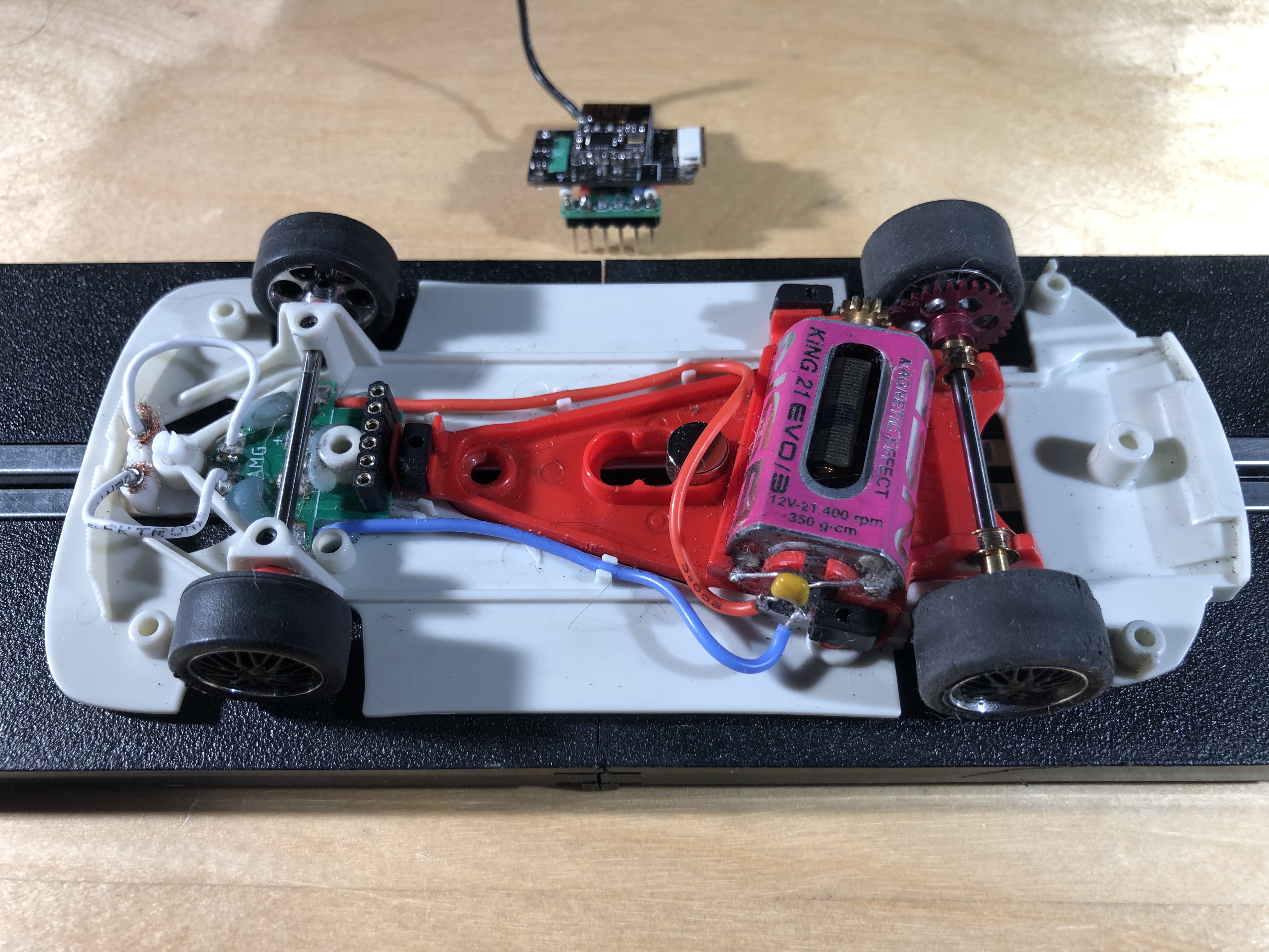

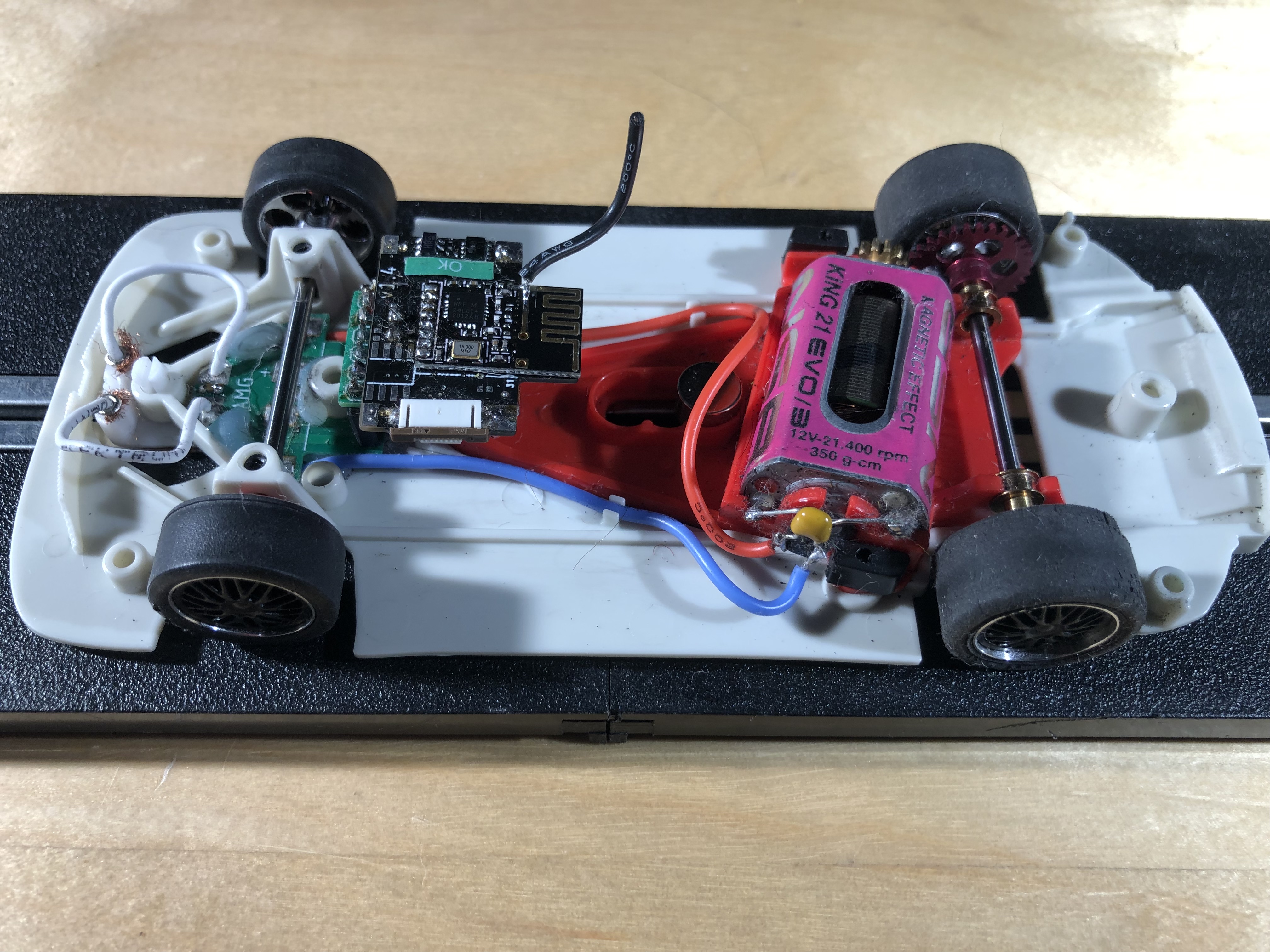

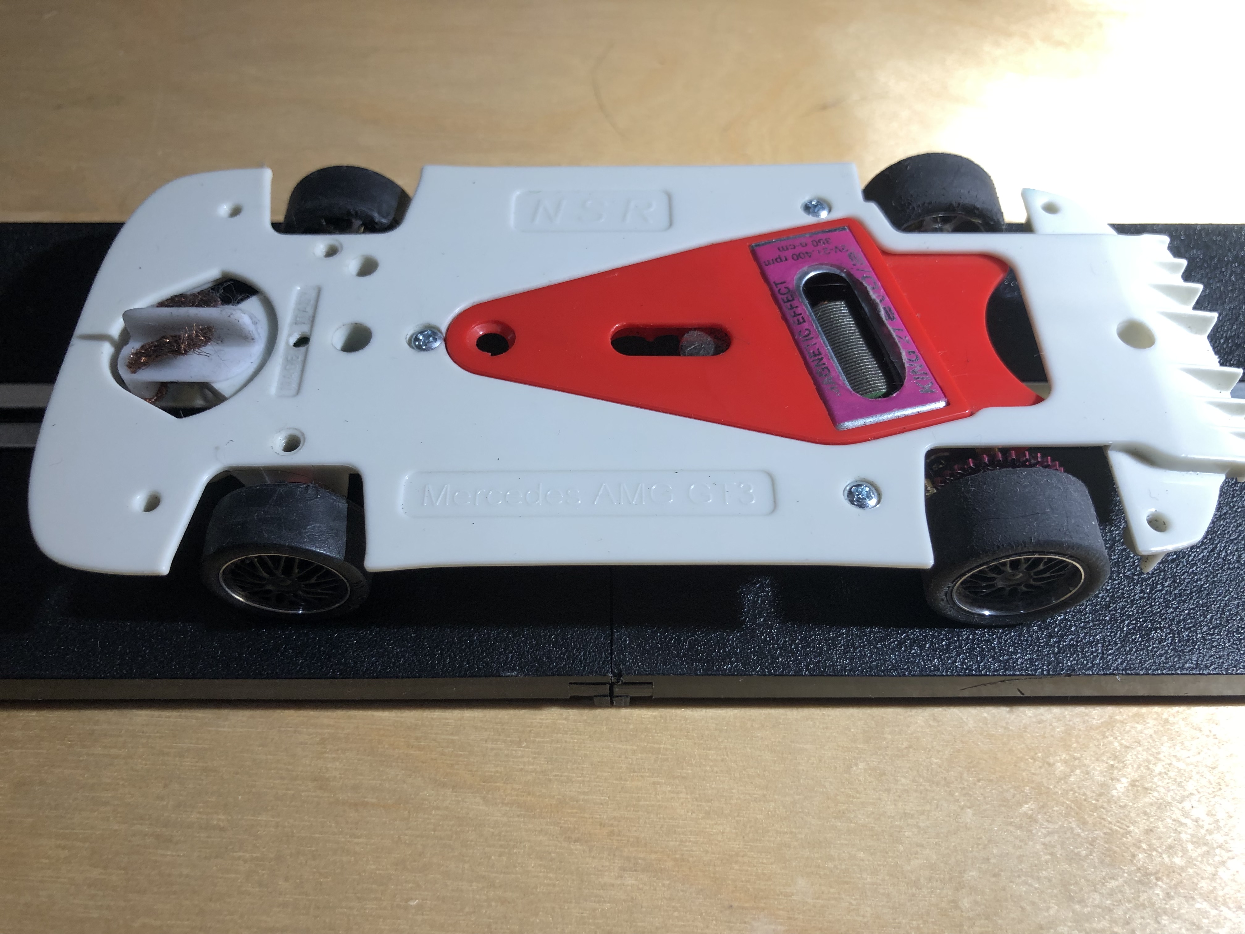

This is my first wireless test car. It’s driven many laps with the new decoder.
Photos taken after a good clean (to remove fluff!).
The front axle is so close to the ‘optimal’ position for the IR LED I had to use a small surface mount version.
The decoder is fitted using a six pin header for easy install and removal - always useful when developing new code :)
c

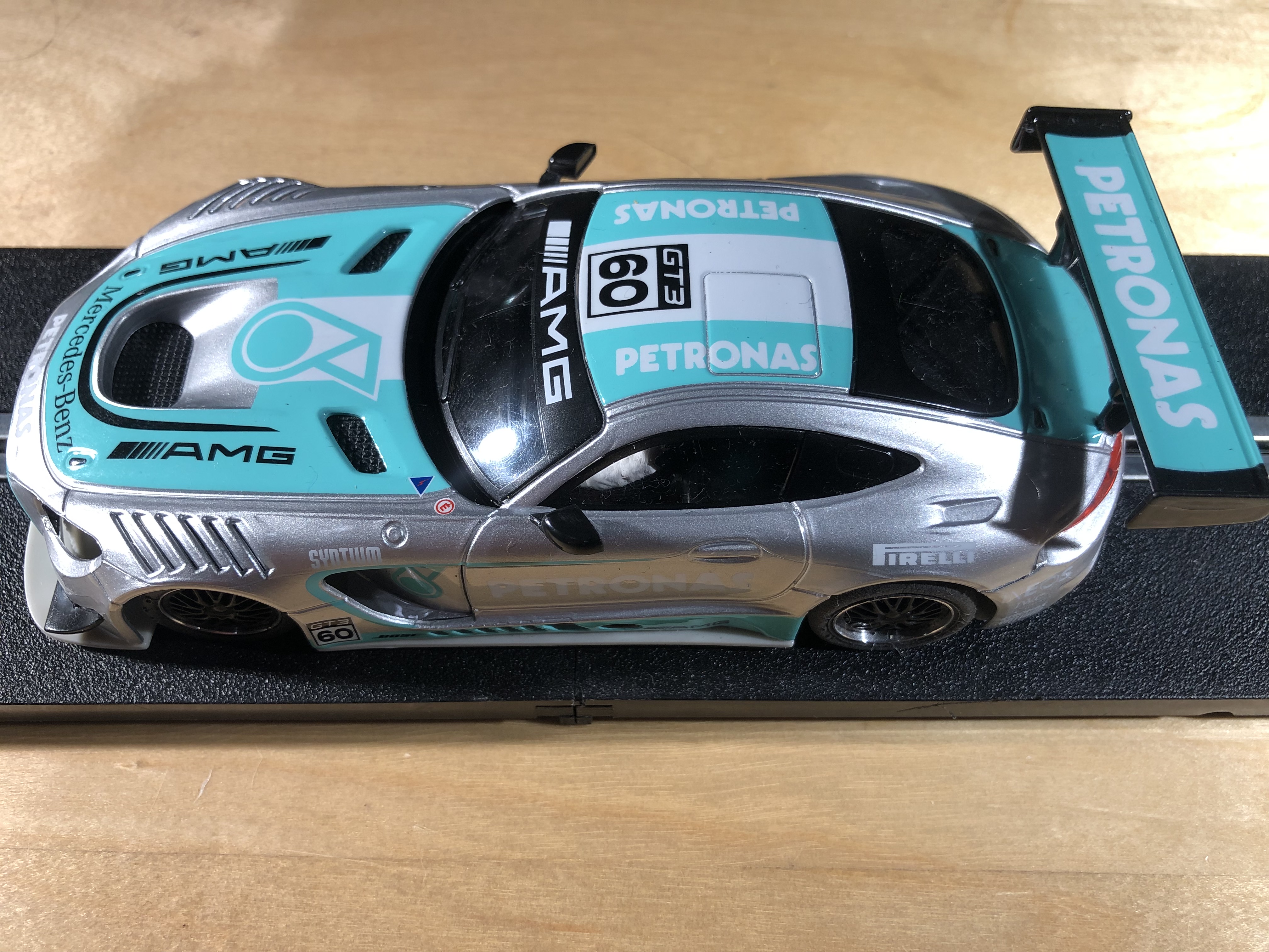

We plan to bring twelve NSR AMG GT3s with wireless decoders as per the Petronas livery’ed car shown earlier. These cars will strobe their IR LEDs on IDs 1 through 12. They use an extention of the SSD mark-to-space method i.e. extended out from 6 to 12 IDs. Waveform inversion is used to trigger lane changing which is fully compatible with standard SSD XLC electronics. On the 24th August they will be tested with O2 lane changer electronics on Ninco track.
The lap counting method follows the same approach as SSD with under-track phototransistors used to read the Cars’ IDs and then onward reported via USB to a PC running PC Lapcounter. This method has been proven to function on IDs 1 through 36 though PC Lapcounter itself is currently limited to 32 cars (which is more than plenty).
