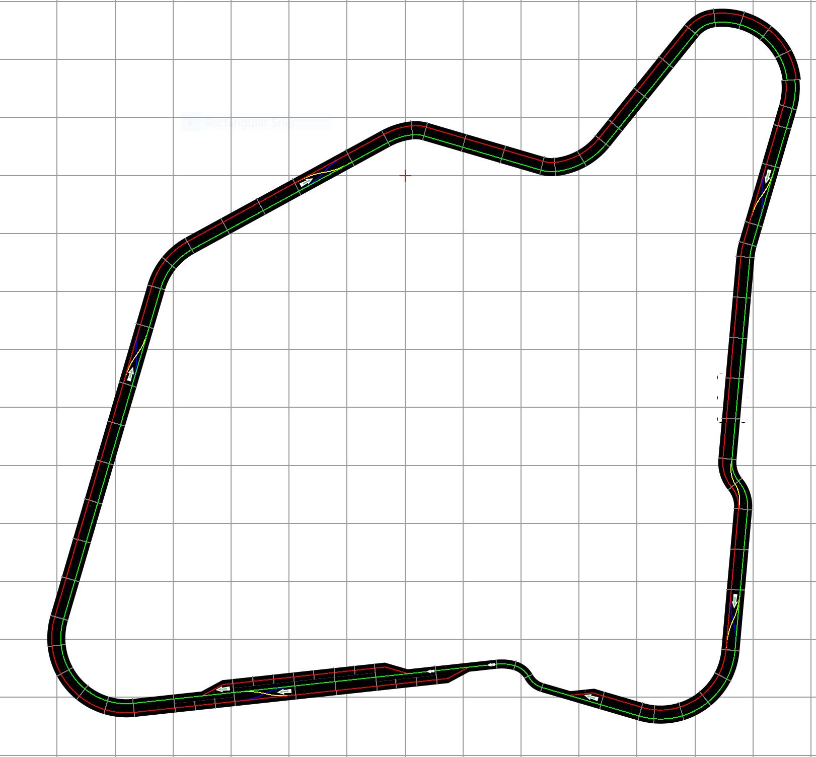

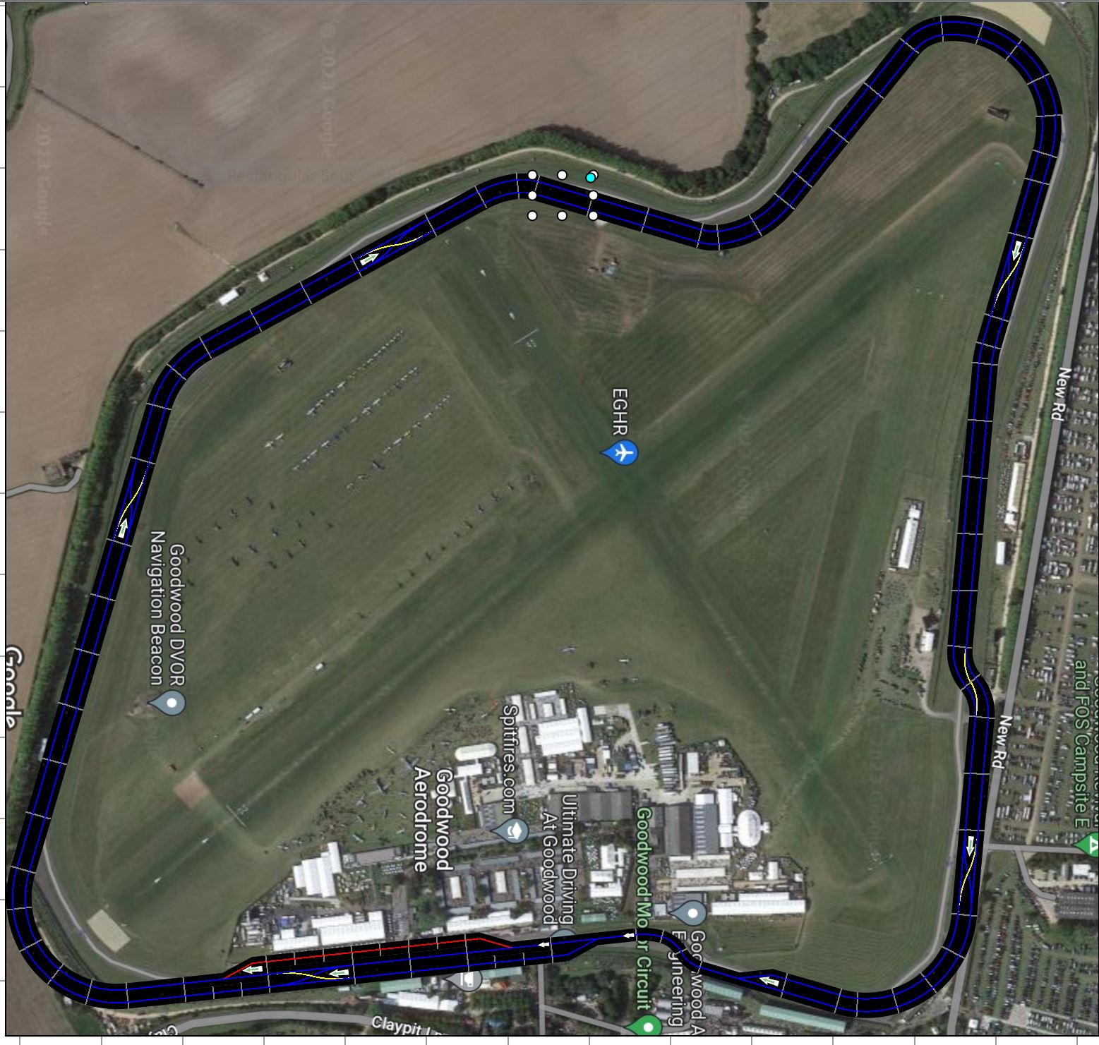

Here we go with something that I think encapsulates some of the feedback.
I have tried to recreate some of the racing elements described by Woodcote at the expense of religiously following the geographical layout.
I have been reading the archives on Best Racing Line modifications and will include a few modified track pieces to get the flow of the corners to feel more like the real thing.
i.e. Fordwater will include a racing line from the outside rail to the apex and back to the outside rail. In practice I am not sure you would not want to return to the outside rail, and I suspect very few would be in the outside lane coming into Fordwater, but it is conceivably that being able to hold full throttle from Madgwick to St Mary's might have some advantage over the inside lane, that would likely need a lift into Fordwater.
Its all got a bit bigger too :-) Now measures 6.5m x 6.1m

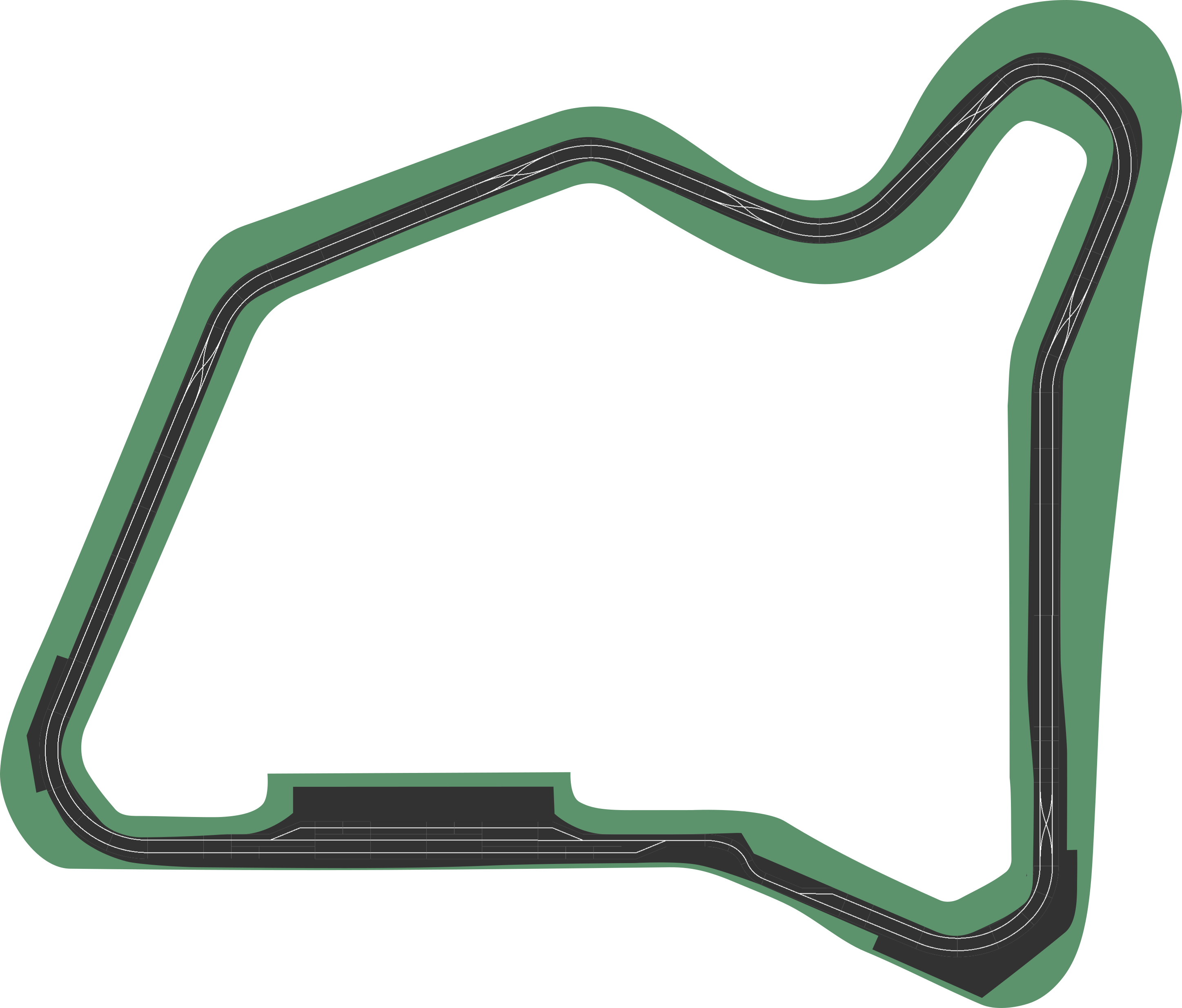

#16
Looking good. The single lane chicane looks great, and the circuit looks as if it would be more driveable. The only thing I'm not sure about is the chicane on Lavant Straight which looks a bit harsh.
I wondered if it might be possible to hint at some of the double apex curves, and more subtle elements of Goodwood by using Duncan Kirby's method of creating a racing line. You may remember that he changed the appearance of where the track edges were by careful placement of kerbs and track limit lines. Sometimes they'd be right up against the rails on the inside of a corner, so the cars looked like they were putting two wheels off the track. Or on the outside of the corner it would be the opposite, moving out onto the borders.
Of course this might not be possible, but I couldn't resist having a look....
#17
Love it Jason and very much in keeping with the constant abuse of the inside edge of Lavant exit that is so often turned into a rally stage by the exuberant :-)
Would be lovely to bring a bit of Duncan into the track too :-)
I agree the racing line mod from the CLC's is far more aggressive than the real world and in all likelihood will become a more subtle affair. I just wanted to take advantage of the track pieces that Gregk had created in UR30 and added to the track as an idea. I also modified a couple of R4's to create half length R4's to take the edge off a couple of lines.
Your image is fantastic and will help me planning the board cuttings.
As Woodcote mentioned I will be trying to include the elevations between St Mary's and Lavant, as well as the adverse camber of Madgwick.
[+] 3 members Like woodingboys's post
