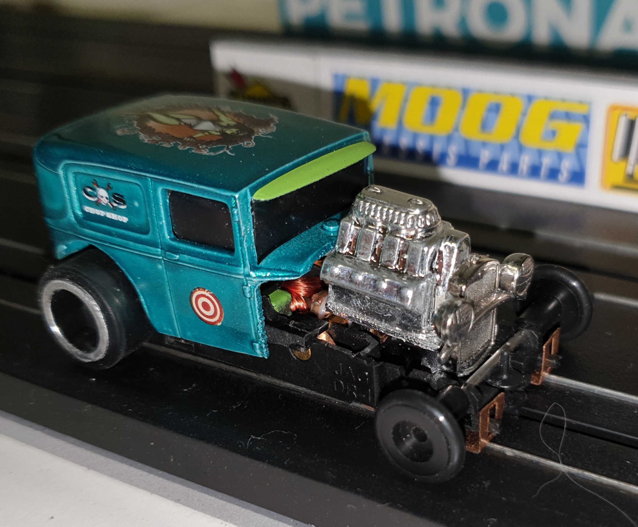

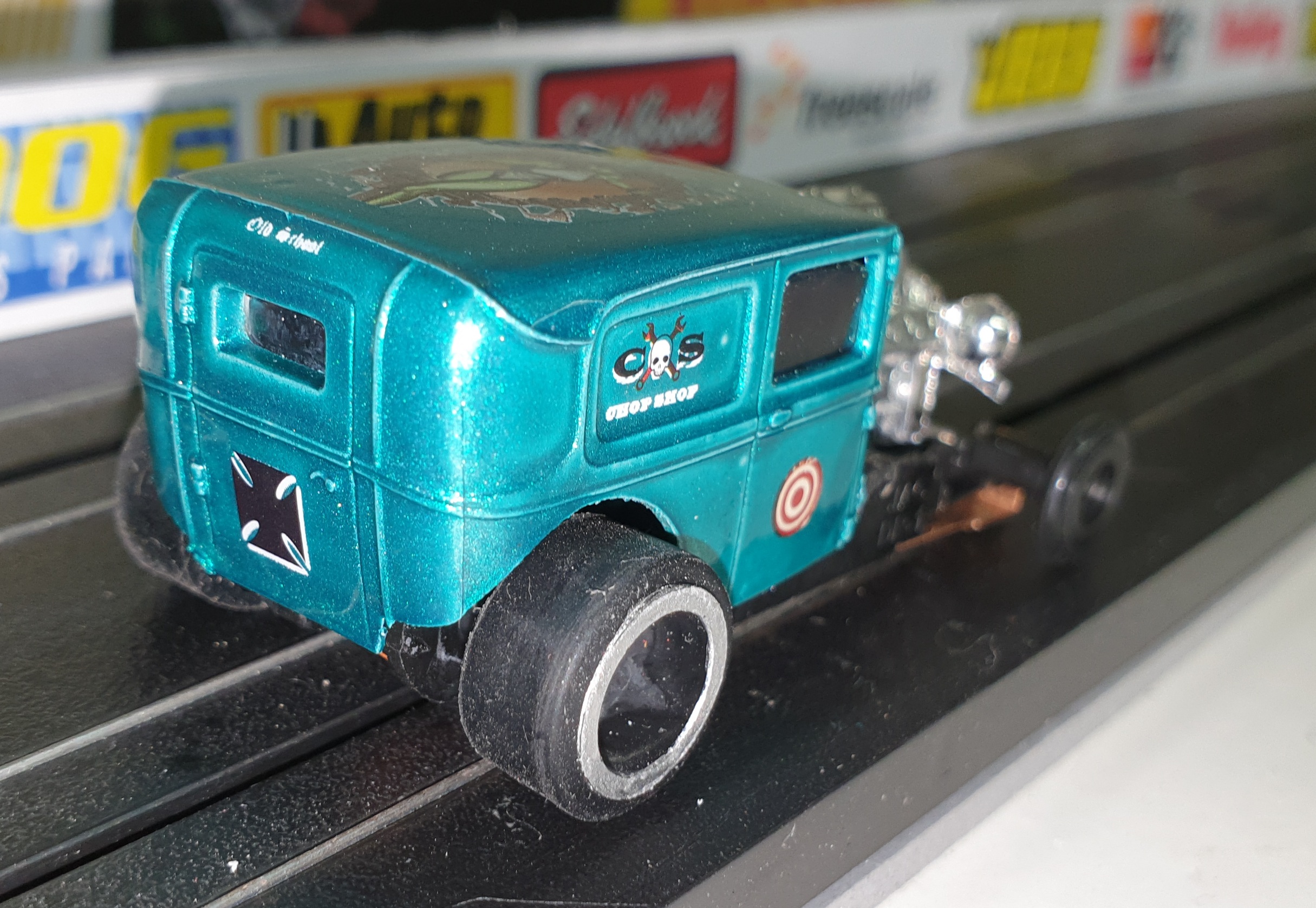

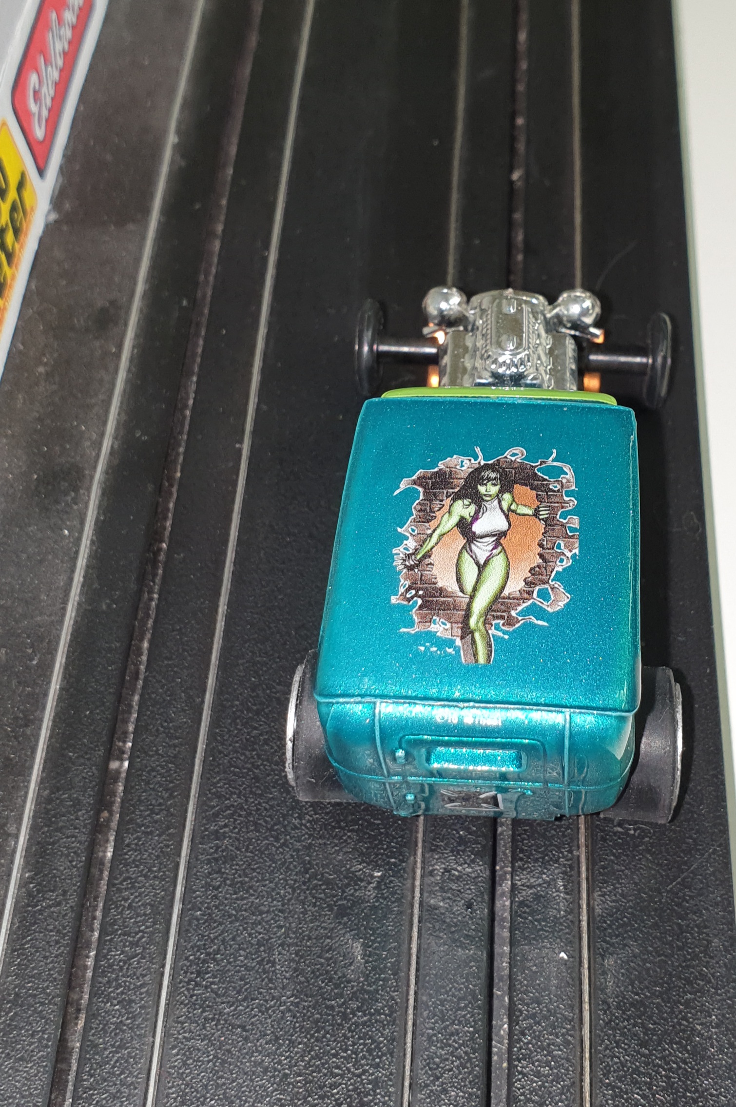

Not documented but customized by me .
Nico

Nico. Cool looking car. Beautiful colour.  Thumbup
Bill. It's great to see your "Grage" is open for business again. The Red Delicious has been super slammed, and the body mods looks amazing! The colour, flames, and speckles are beautiful!  Checkeredflag
