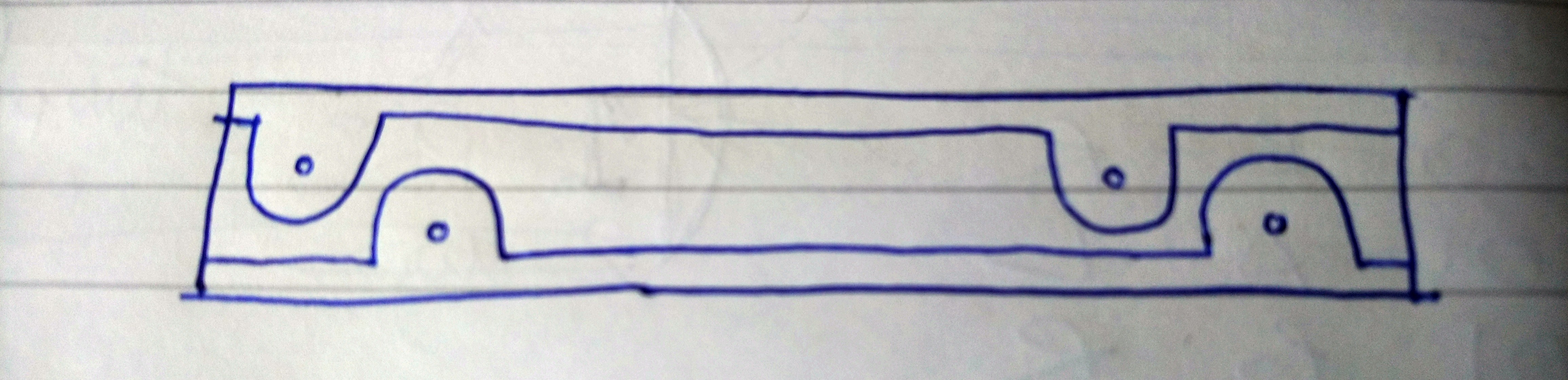

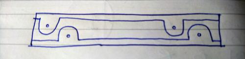

(8th-Dec-20, 08:50 AM)Gordon Steadman Wrote: What do you do with the industrial scale offcuts?
You could reduce this by making 2 chassis at a time from the opposite sides and careful cutting.

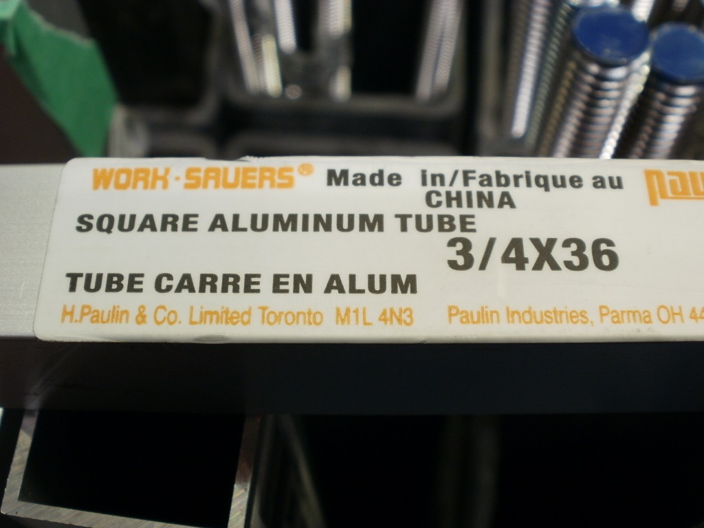

I forgot to say that it's not really possible to safely make a chassis with the cut offs. You'll take your finger off before saving a dollar.
A 36" inch length of 3/4" square aluminum tubing is $18 Canadian. The average chassis is about 4.25" inches. That means I get 8 chassis for $18 Canadian. That's $2.25 per car. How much are we trying to save by risking fingers for some fancy bandsaw cuts? I can easily afford $2.25 per car.

I'm not doubting your logic in any way, but being the mathematical genius you are, and with a bit of tessellation as dazee hinted at, you could possibly double your production runs, especially once your machine thing arrives...

Hi Jeremy,
These cuts still need to be made on a bandsaw even after the mill arrives. The mill helps to make all the holes a bit more precise. A mill will specifically help with the guide hole, and crown relief areas.
Thank you very kindly for your drawing. Your lines look perfect in theory. But a bandsaw is a very dangerous machine. I will do anything to make the cuts a bit safer and easier to do. My first 10 chassis's were all over the map until I came up with a repeatable cutting system that was the least dangerous to perform. I like my fingers.

The material only cost $2.25 Canadian per car. That's $1.50 US, or maybe one Euro? How much trouble are you willing to go through to save half a Euro?
Yes, it certainly can be done. Is it worth it? Not to me. I need a better reason than just a few pennies. I'm good with just the bottom half of the aluminum square tubing. The less time spent on the bandsaw with challenging cuts, the better. One car at a time seems to be the best outcome so far.
