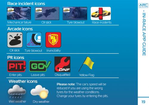

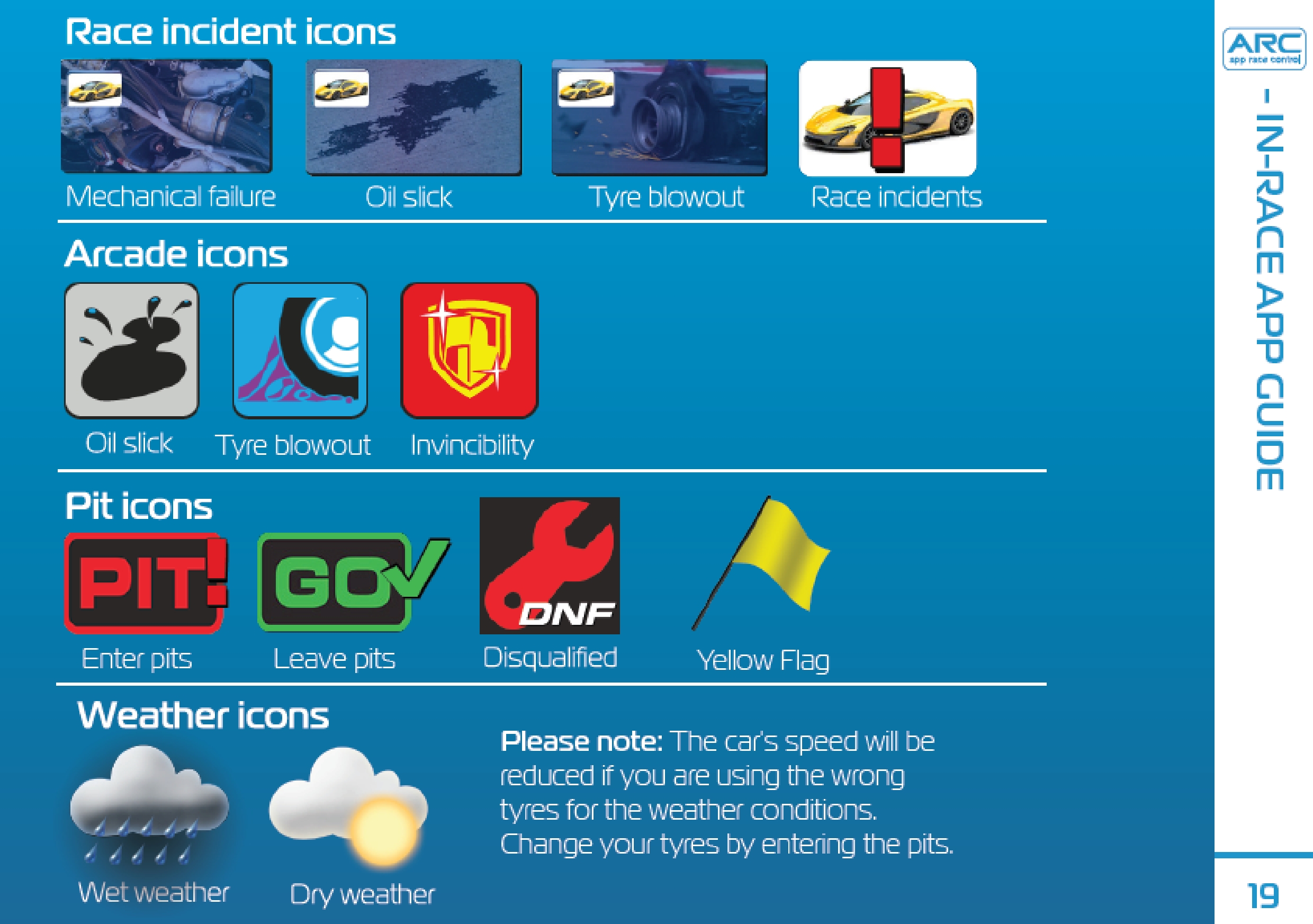

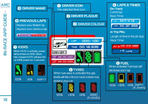

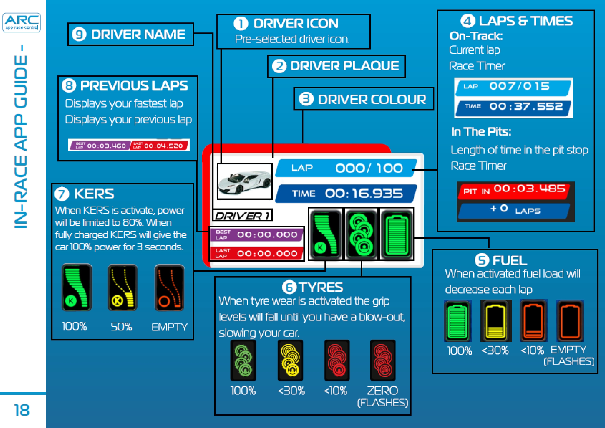

It does work well out of the box, but only if the 24-page ARC Pro Quick Start Guide is used as a bible - especially for car and controller connections. The Quick Start Guide gives a very quick (two-page) overview of the app and there is more on the ARC Pro page of the Scalextric website, including the chance to download a pdf copy of the all-important Quick Start Guide. What you get about the app in the Guide are the two pages attached below.
Apart from those overviews, there is no manual to using the ARC app. I was very comfortable with exploring the app without a manual and I quickly figured out what it did, how to set up races and to trouble-shoot issues. I do that will most other apps on my phone, iPad and computer. However, I appreciate not everyone is so comfortable with that.
