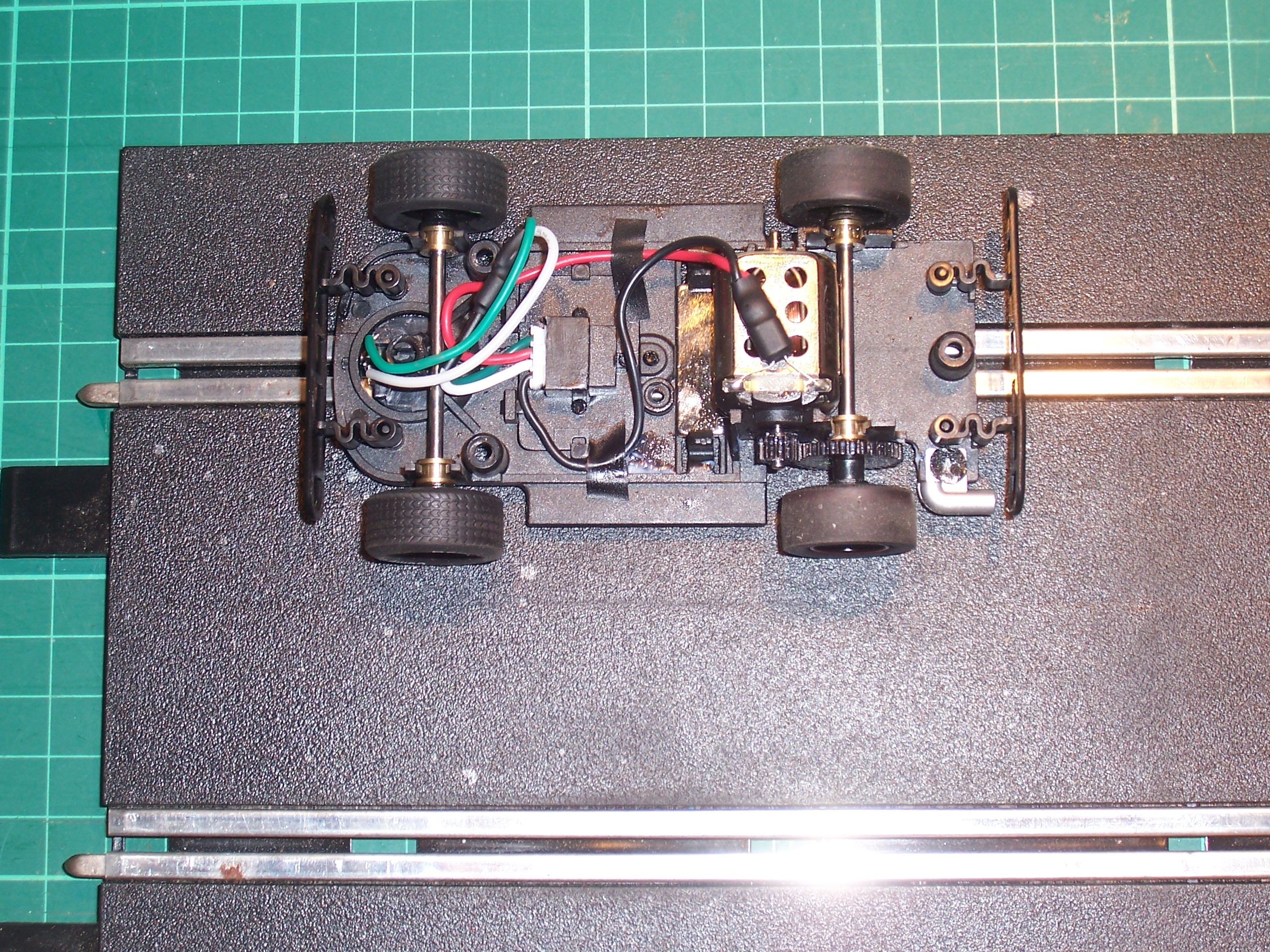

The body is secured by three screws and lifting it off reveals the standard Pioneer layout and mechanicals:
It is nicely put together, wires are taped off where necessary and all components are solidly mounted. Quality control is up to their usual high standards. The front and rear bumpers are not fixed in as they are the most likely things to get broken in racing incidents and can be easily replaced, assuming they become available as spare parts.
