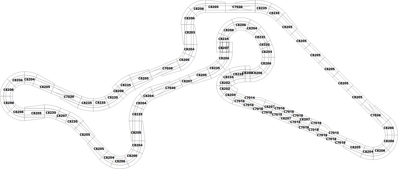

I would always pay attention to Andy's suggestions as he's had a lot more experience of digital racing.
With that in mind, here's a layout that incoporates some of those suggestions. It's 7.02 x 2.98m. I haven't drawn in the powerbase as there are two different types, which are different sizes, I believe.

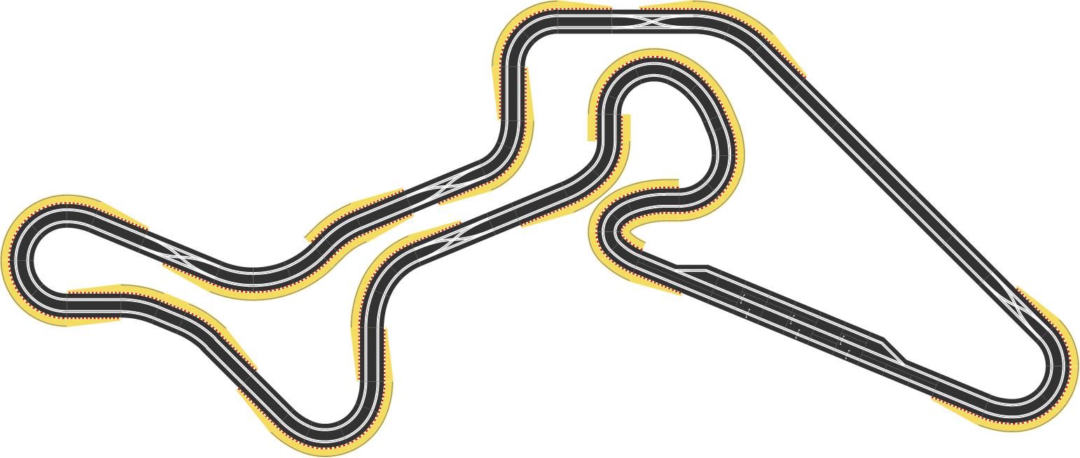

Here are the track pieces.
And here's a rough shopping list. You'll obviously need to cross check this and take out any pieces you already have.
Track
C8205    Straight  x16
C8207    1/2 Straight  x6
C8200    1/4 Straight  x2
C8236    Short Straight  x1
C8202    R1  x2
C8206    R2  x7
C8204    R3  x10
C8235    R4  x12
C8234    1/2 R2  x2
C7036    Lane changer x5 (or perhaps 4, if you replace one with the powerbase)
C7015    Right hand Pit Lane in/out   x1 set
C7016    Single lane straight   x12
C7018    Starting Grid   x3
Borders
C8233    Straight border lead in/out    x11 pairs
C8223    Half straight border x5 (two of these will need to be cut up to make borders for 1/4 straights which Scalextric don't make)
C8240    Outer border R1    x2
C8279    Inner border R1    x2
C8228    Outer border R2    x17
C8280    Inner border 1/2 R2  x1
C8239    Outer border 1/2 R2   x2
C8281    Inner border R3   x1
C8224    Outer border R3   x10
C8238    Outer border R4   x12
C8282    Inner border R4   x2
