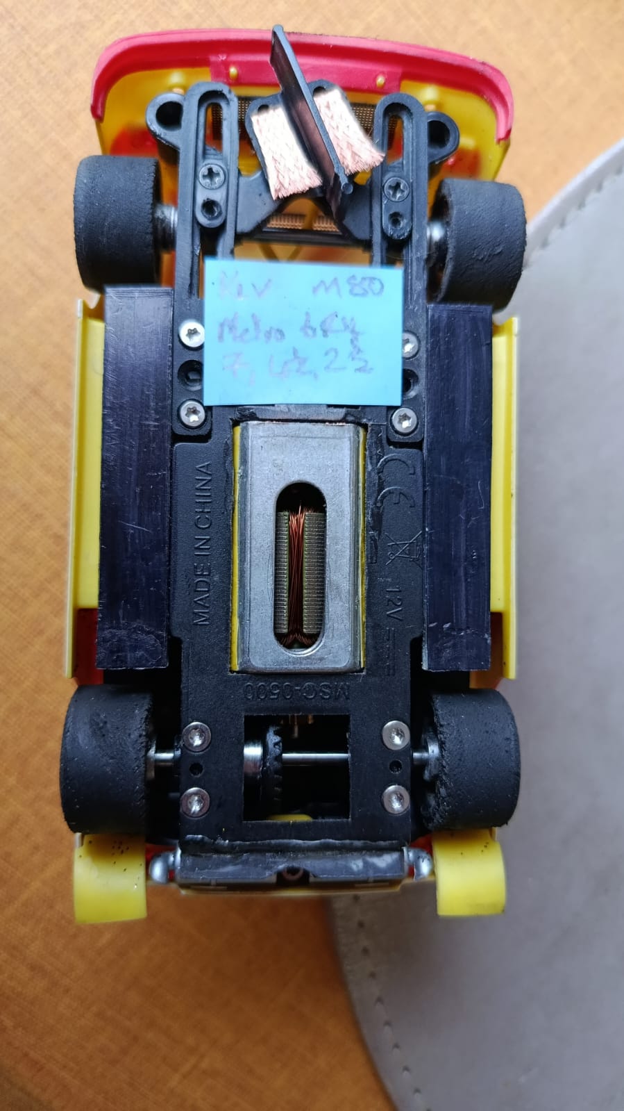

The first pic is putting it back together.  The screws holding the front section of the chassis onto the main section are loose by about a third of a turn with a dab of superglue on the top in the nut to stop it loosening.
I drilled the rear axle blocks through with a 1.8mm drill for longer M2 screws.

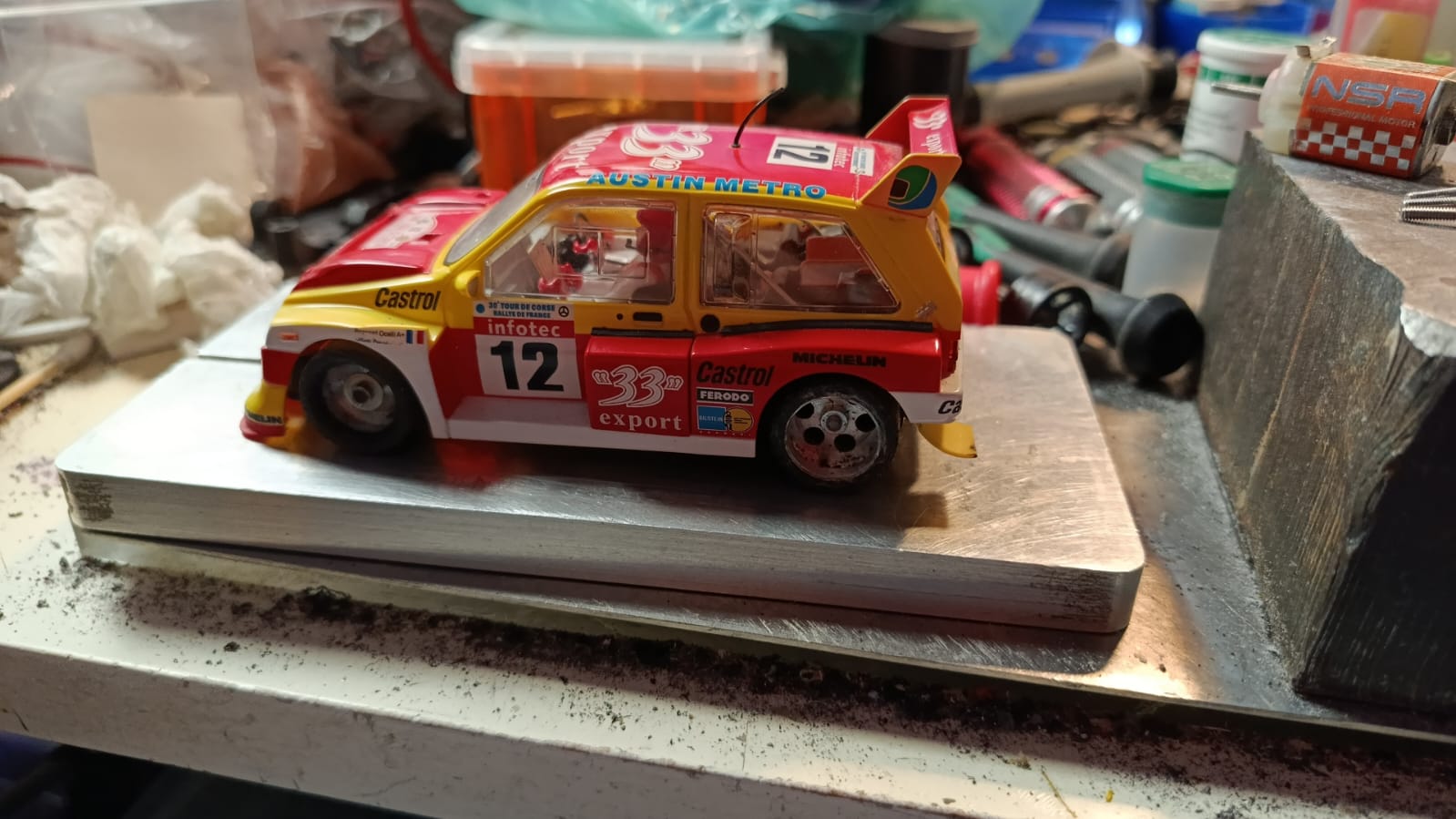

The second pic is now ready to run.
I might get some wheel inserts printed for it to finish the job
The upshot is 'it's a flier!!!' I can't believe how well it goes, who needs a fancy adjustable motor pod  Bigsmile
