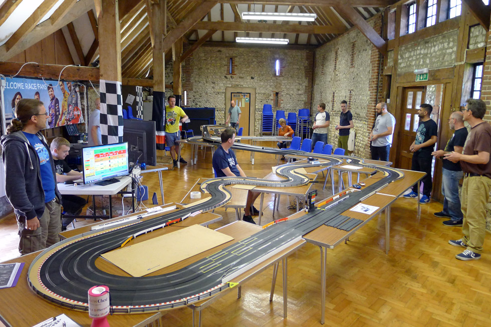

My opinion is that modern Scalextric cars are the best suited for use with ARC Pro - they are easy to convert to digital, they are robust and they are quick, but not too quick... Digital racing is so much more than driving fast, so high-performance slot cars can actually hinder the arts of overtaking and race strategy - and can lead to a very expensive crash-fest.
If you have a good-sized home track - or can set up a big temporary layout - then running slightly faster cars can make an exhilarating change. At our Scalextric digital club, we run mostly standard Scalextric cars with magnets removed, but we do have one race for the Slot.it Group C cars...
