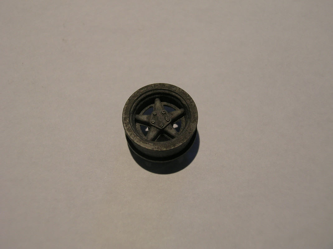

I am starting a 1/24 Cox Ferrari 158 for a customer,....and, have started with the wheels.
 While the Cox cars all had wonderful cast magnesium wheels, most had rather slab like looking (too thick) outer rims, and I was looking to improve on that, so that they look a touch more like the real 1964 158 wheels which did have nice bead detail.
Below is the  stock Cox Ferrari wheel, really very nice, but a very thick/slab like  outer rim.......

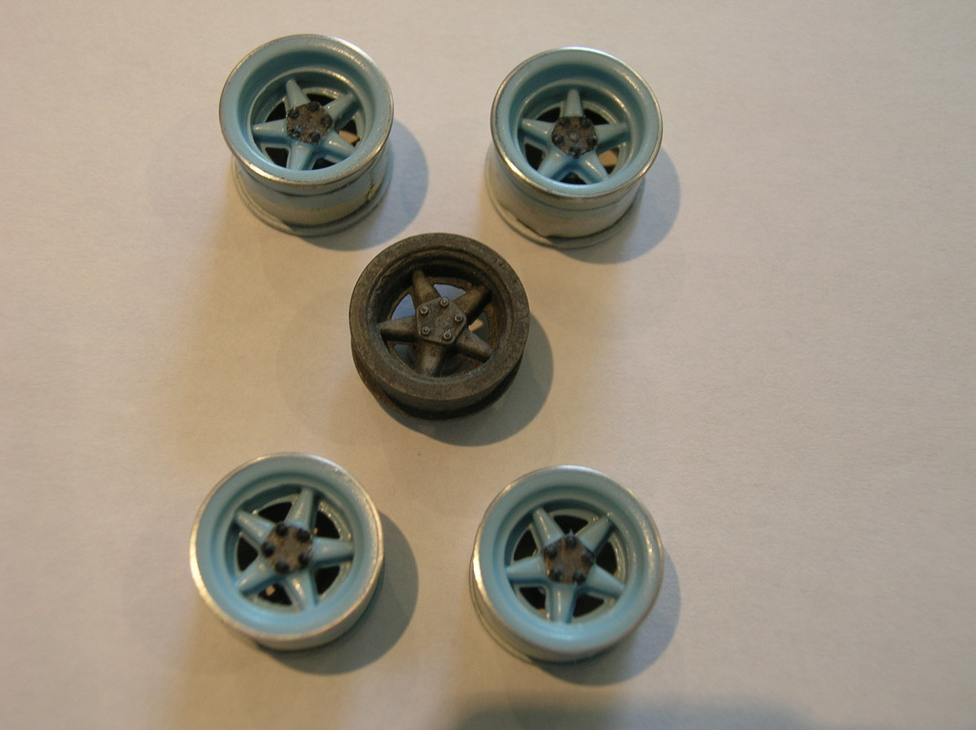

So,......into the lathe, a little cutting, and a bit of paint, and this is the result,.......(original in the centre)
The colour does look a bit washed out, but is does look closer to the wheels above
[Image: DSCN5088.jpg]
Still tons to go........
