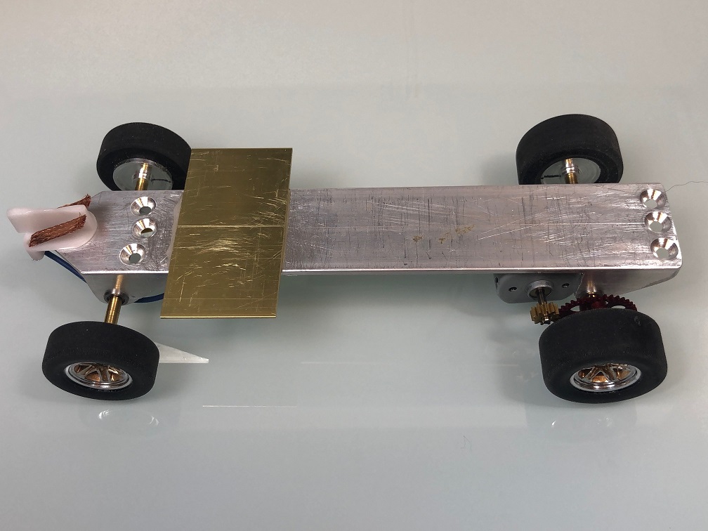

The all up weight is just over 130-grams. The target weight is 140-grams.
A piece of 2" inch brass by 0.032" thick does the trick nicely. Cutting a piece just over an inch wide should give about 10-grams of weight.
A line is scribed down the center of the chassis, and the brass weight. The mating surfaces are rough sanded with 150-grit sandpaper, and wipe clean. Then the weight is epoxied to the chassis with both lines lined up. A clamp is used to keep it in place for 5-minutes.
The weight hangs under the chassis at about 1.5mm off the track. Stick-on lead weight can be added to the top of the outer wings if needed.

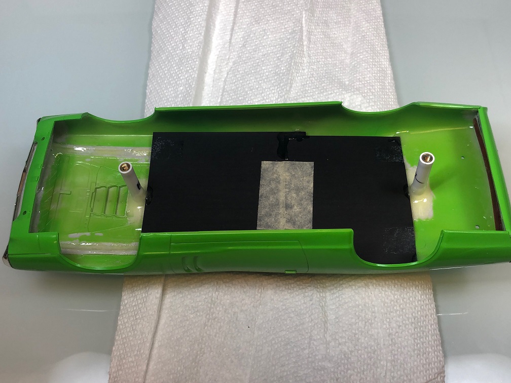

Urethane washers that properly fit the 4-40 screws were purchased from DArt Hobbies.

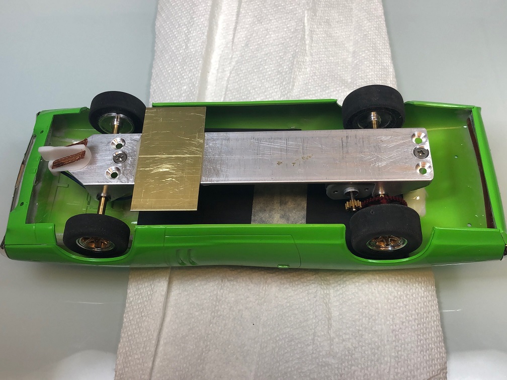

This is the tricky part. Setting/keeping the washers in place while installing the chassis. Practice makes perfect.
Success!
The final step is important. The screw needs to be somewhat tight and allow a little body float. It will get loose over time. A good piece of tape is required to prevent the body screw from backing out during racing.
You're ready to race. Don't forget to oil the bearings.
