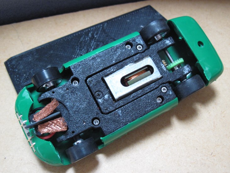

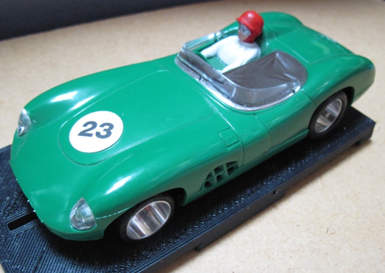

Scalextric Power & the Glory Aston Martin DBR1
Picked this up at Cobham as well as the other shells highlighted recently so well worth the trip. Mostly intact body wise, but prime for conversion so out with the miniature circular saw and sectioned the under pan chassis as shown to drop in one of my sprung Goodwood chassis’. Remaining under pan parts superglued or screw retained back on and new body posts resin glued in to suit the new chassis.
Now its is boxer powered (Scaleauto SC0025b) and goes a lot better on its PSR alloy wheels, tyres and 10:24 gearing than the original S can powered chassis.
