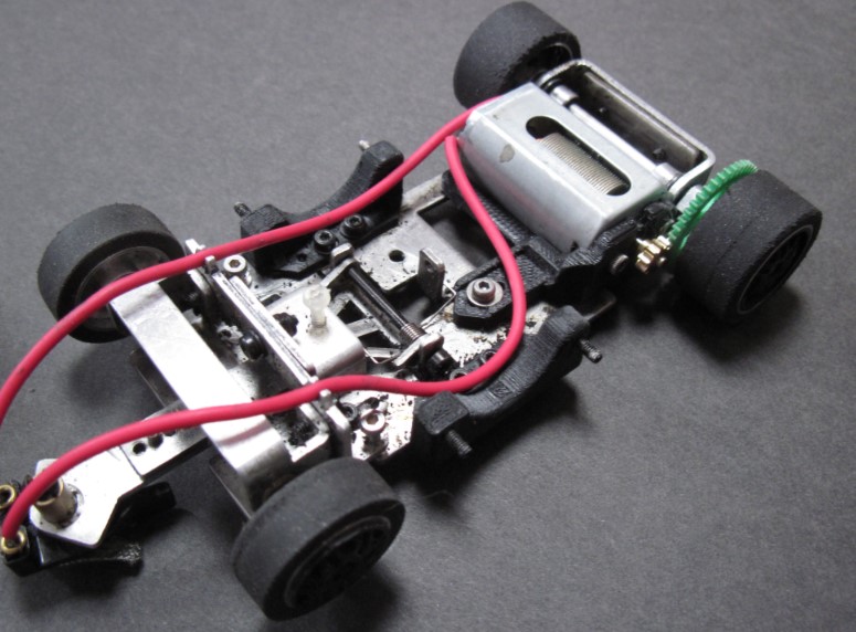

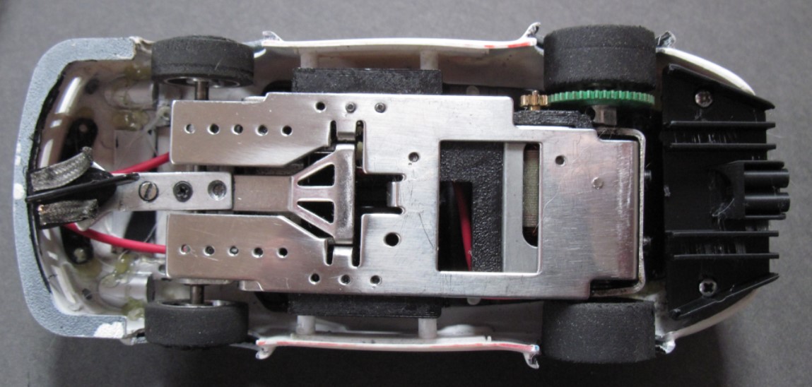

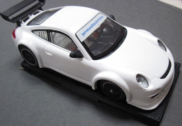

On and off the bench for a while now is my rather battered Ninco Xlot 1/28 scale Porsche 997 club racer. The chassis has been used as a test bed to replace the pulley system with a sidewinder cog and pinion together with a new SW Boxer motor mount. From this, decided to add arches, front & rear diffusers and a new rear wing plus modify the body sit with new mounting brackets. This pulls the track out a few mm and the car is a lot more stable as a result, plus is more lively with the NSR EVO 21K motor using a 10:44 gear ratio than the old (and unavailable) Ninco XL1 motor.
