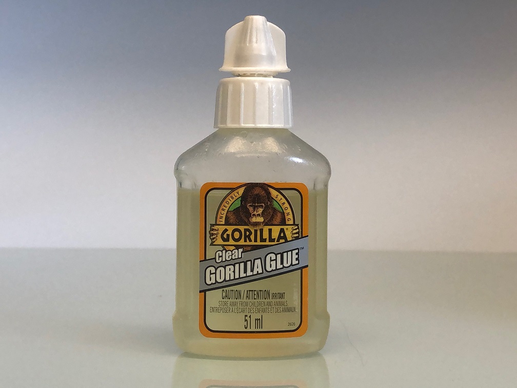

HELP! what is the best tyre adhesive ?
I have used clear Gorilla Glue on the recommendation of the club members before me. I've had zero failures since 2018. It works amazing. Just keep in mind it's gap filling, so less is more. Put a small drop on the end of a toothpick and swipe it on the center of the wheel. Spread it all the way around the wheel and install the tire. Squeeze the tire to push excess glue out the sides. Wipe excess glue off with a shop towel and leave it for about 3-hours. Then begin truing.
