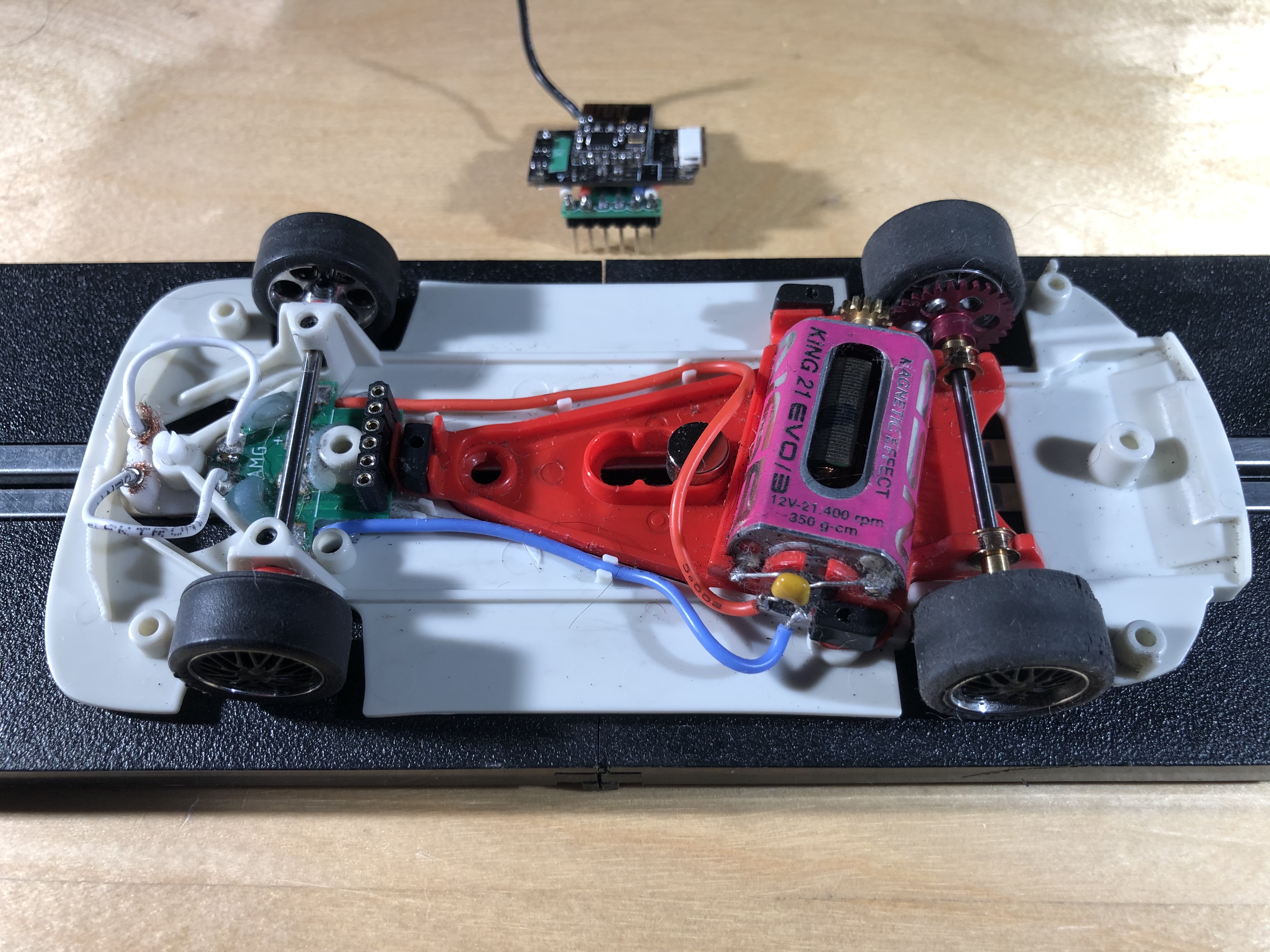

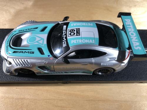

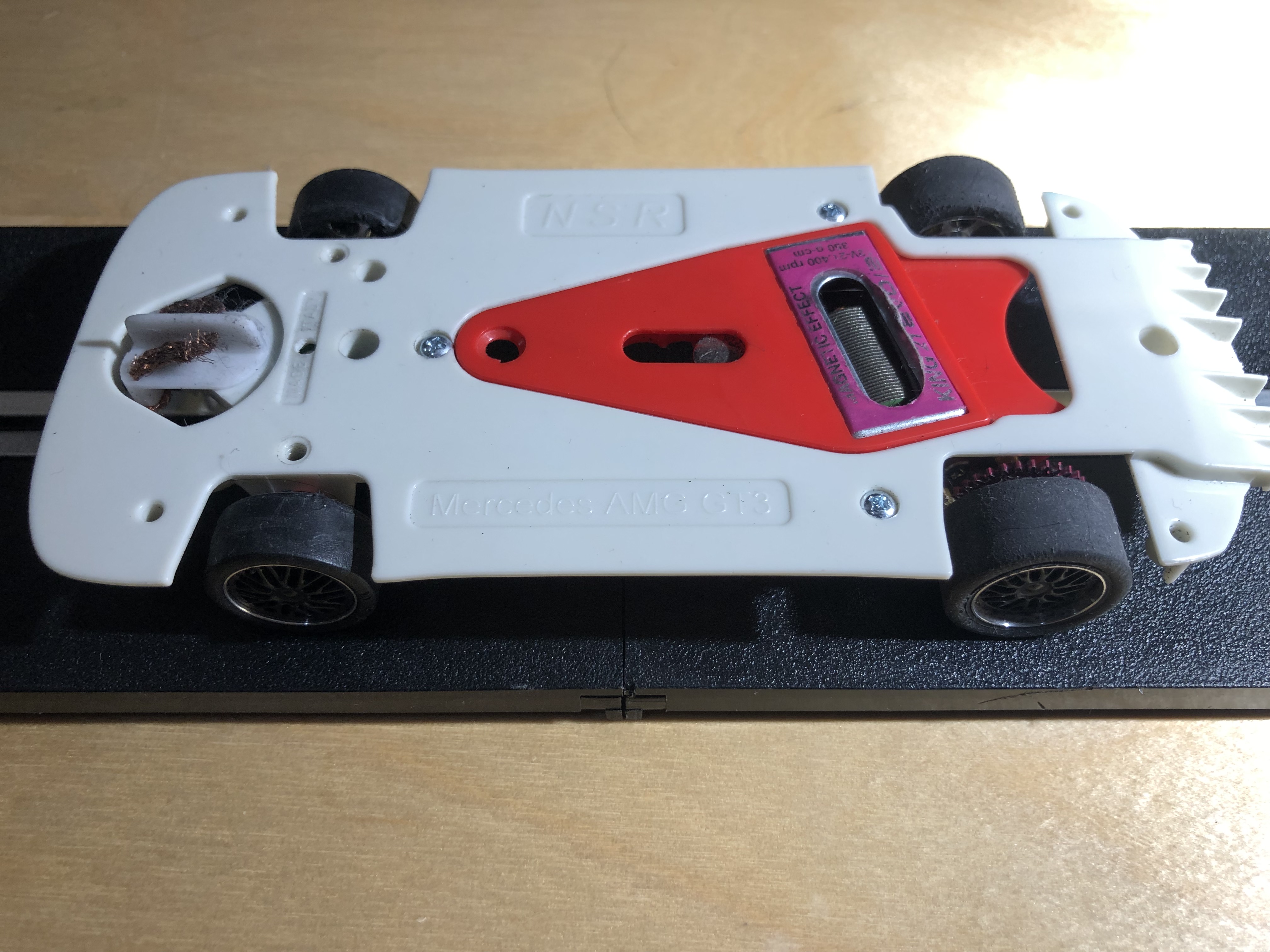

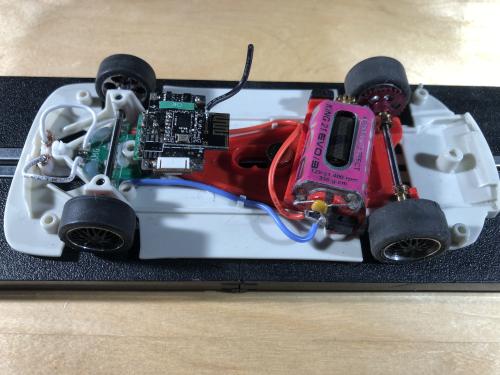

This is my first wireless test car. It’s driven many laps with the new decoder.
Photos taken after a good clean (to remove fluff!).
The front axle is so close to the ‘optimal’ position for the IR LED I had to use a small surface mount version.
The decoder is fitted using a six pin header for easy install and removal - always useful when developing new code :)
c
