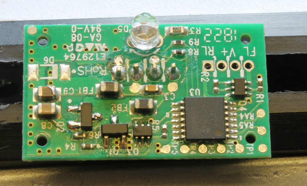

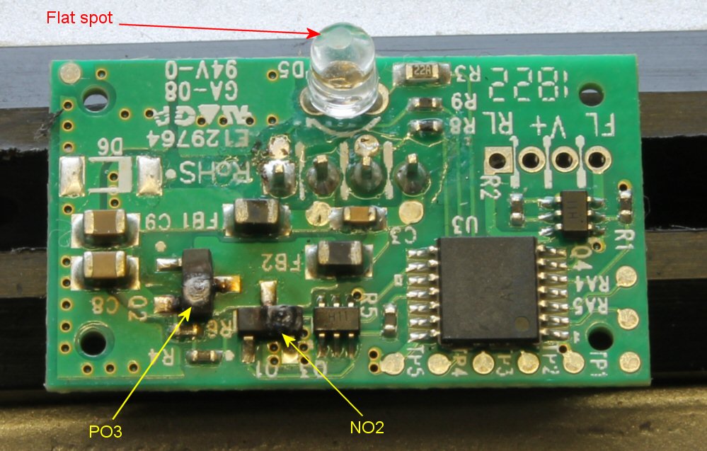

Another Rev H C8515 chip .....
The MOSFETs have blown. These chaps control the braking and running of the car. More often or not only one of them blow, so when repairing them I always replace both with higher spec ones.
As on a previous repair on one of these latest chips, there is slight damage apparent on the infrared LED. This time it is OK but an eye should kept on this newer chips if you start to experience missed laps or lane changes.
