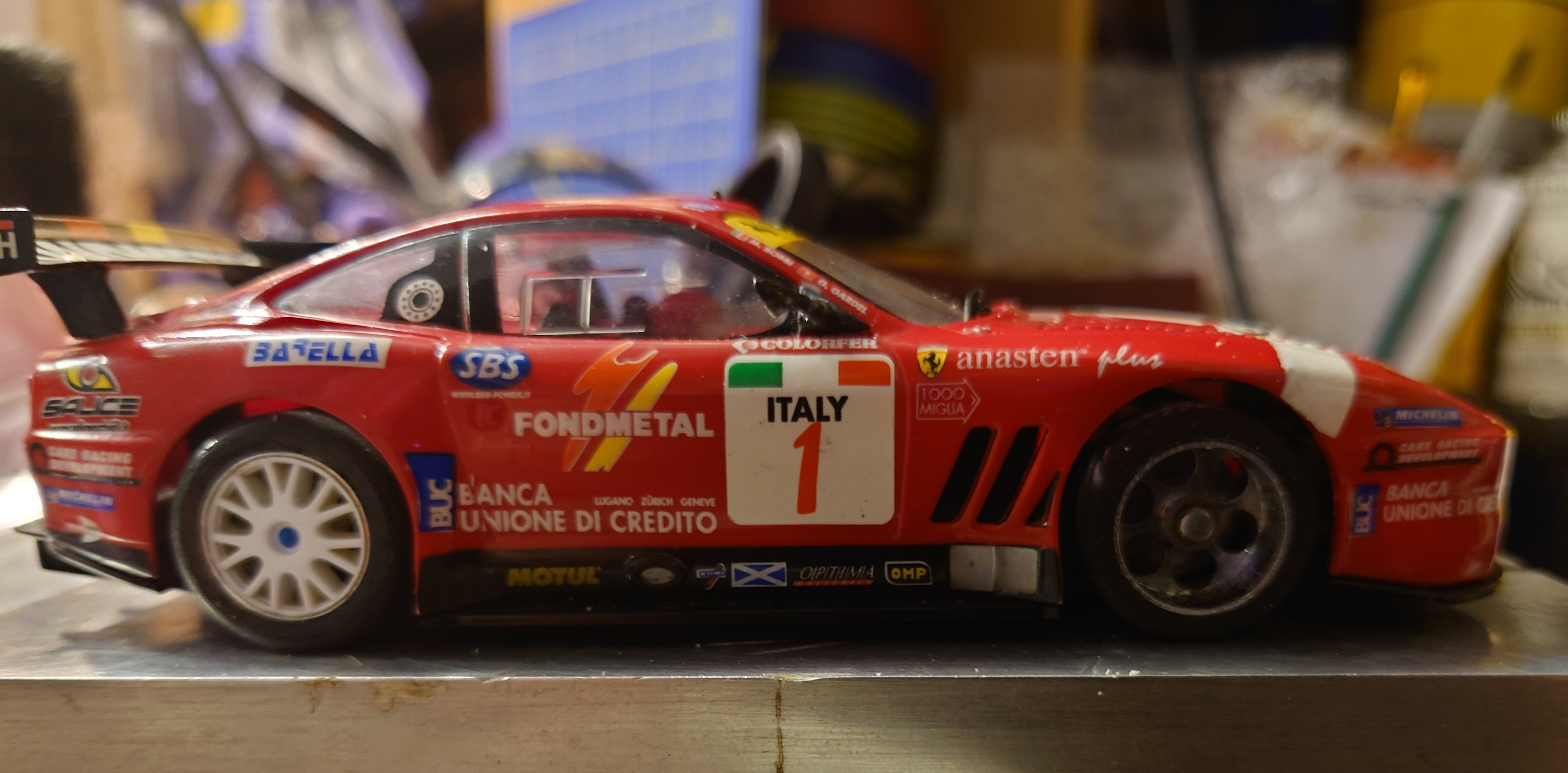

Proxies nearly always require wheel inserts if you're using plain alloys, here's what I do...

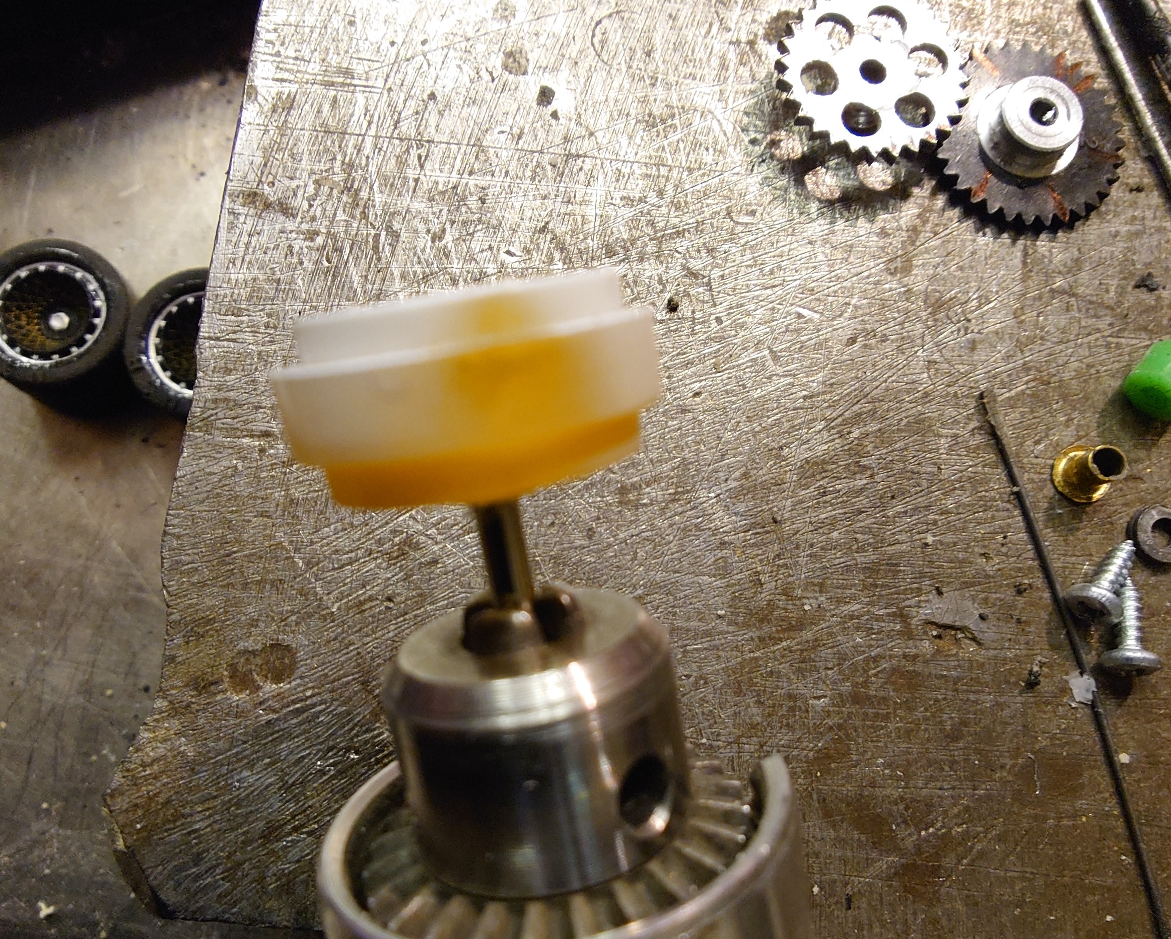

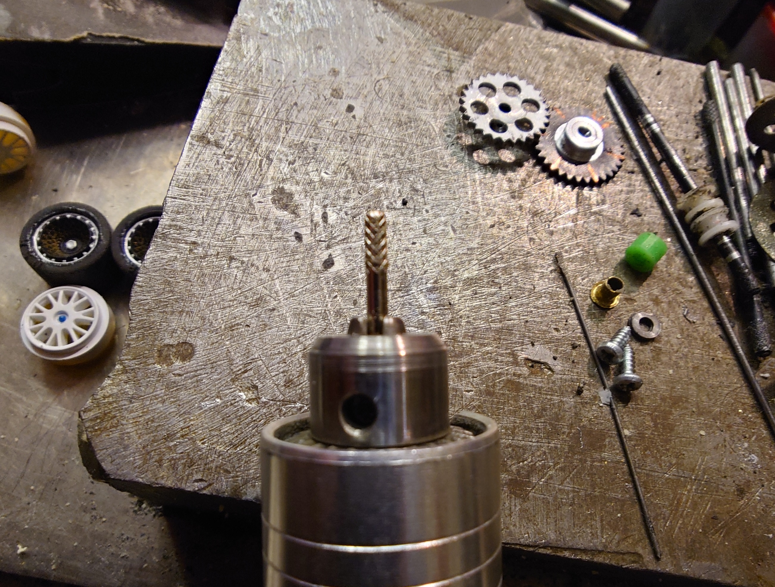

  • I chopped an old axle shorter to fit in my dremel type grinder
  • Push a wheel onto the knurled axle as square as you can so it runs true...it'll hold well enough

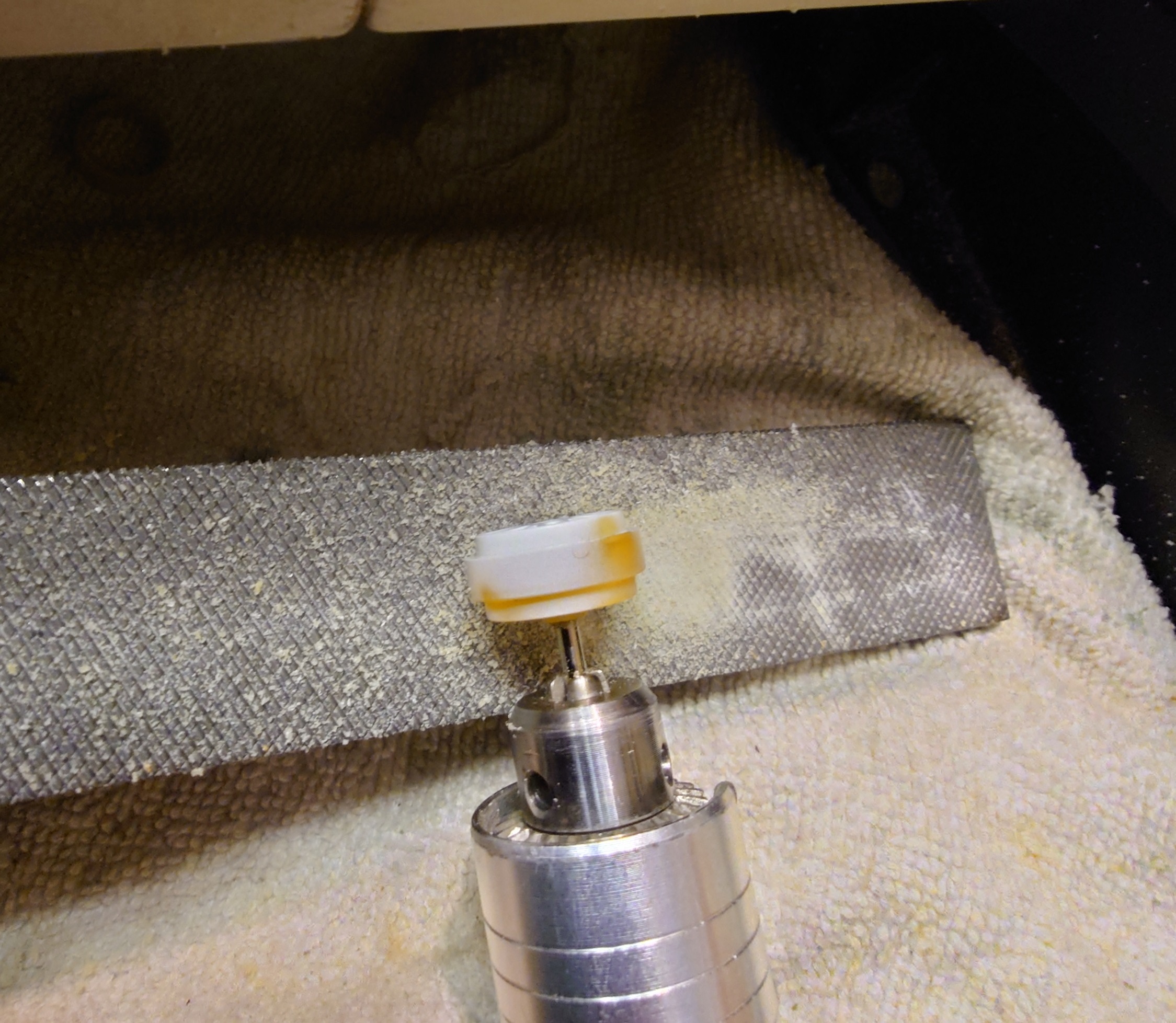

  • Grind the wheel down to size on a big bastard file (that's their real name - honest)

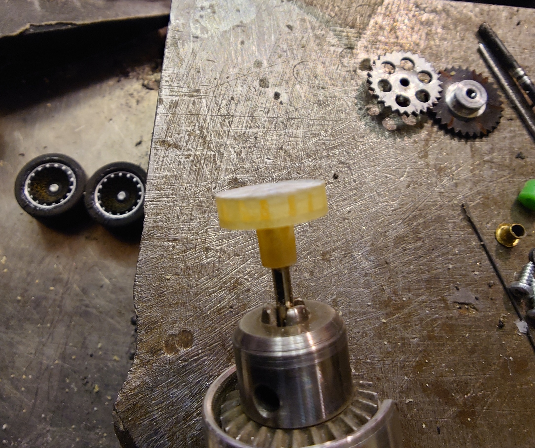

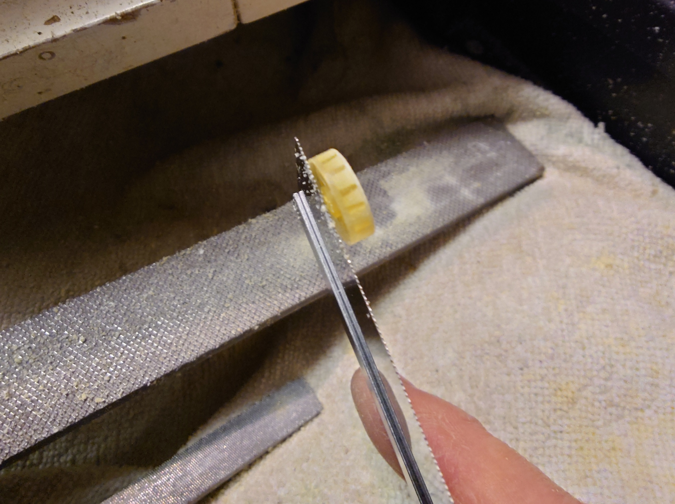

  • Grind it down to just fit inside your alloy wheel...you may find a lot of the wheel will disappear as you grind it really thinly

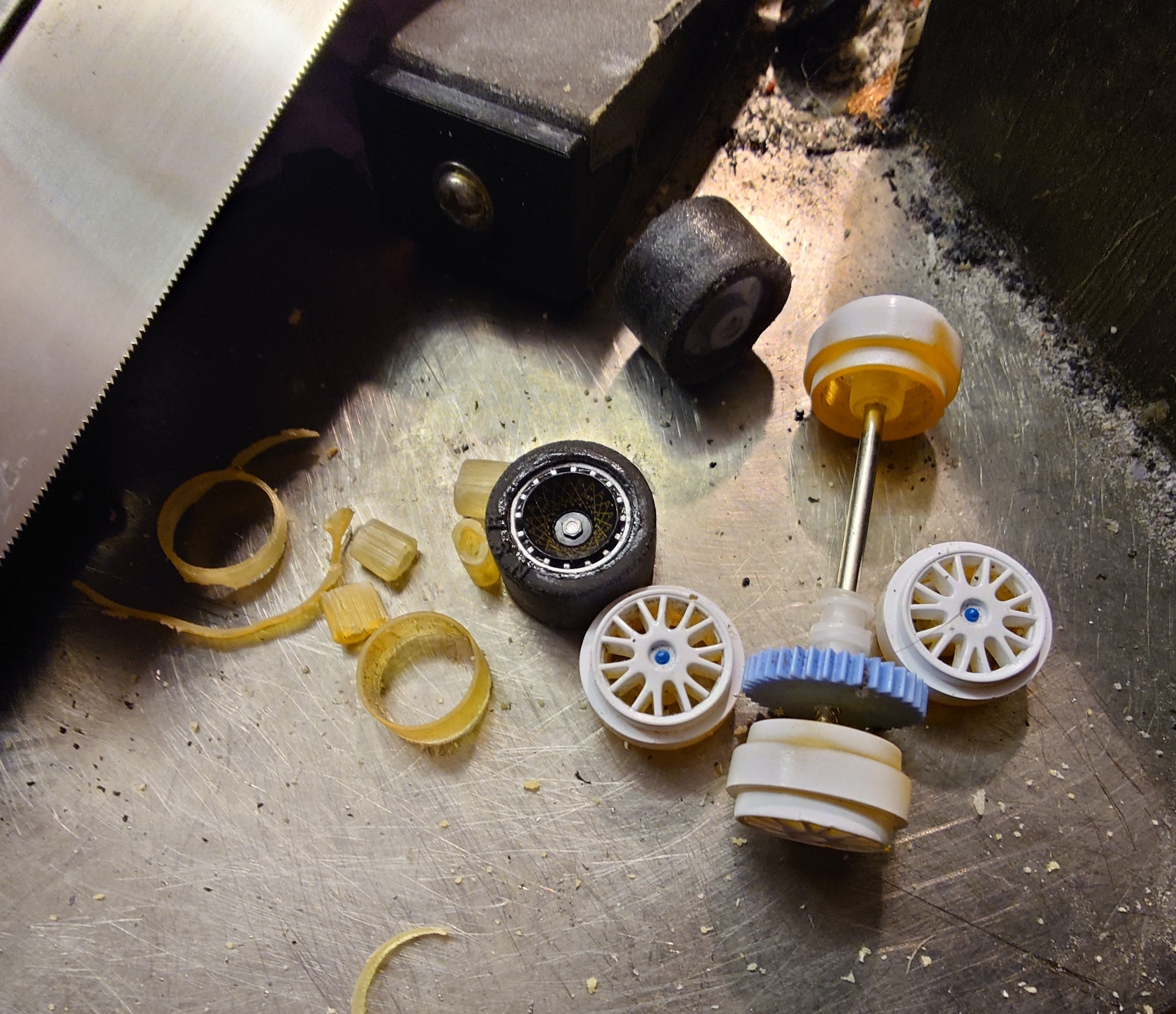

  • Cut the front face of the insert with a razor saw, it's easier to do this whilst it's spinning in the dremel machine but run it slowly or it'll fly off into hiding
  • Try the first one so you have the right thickness, you can cut it short but not push it into the wheel so far

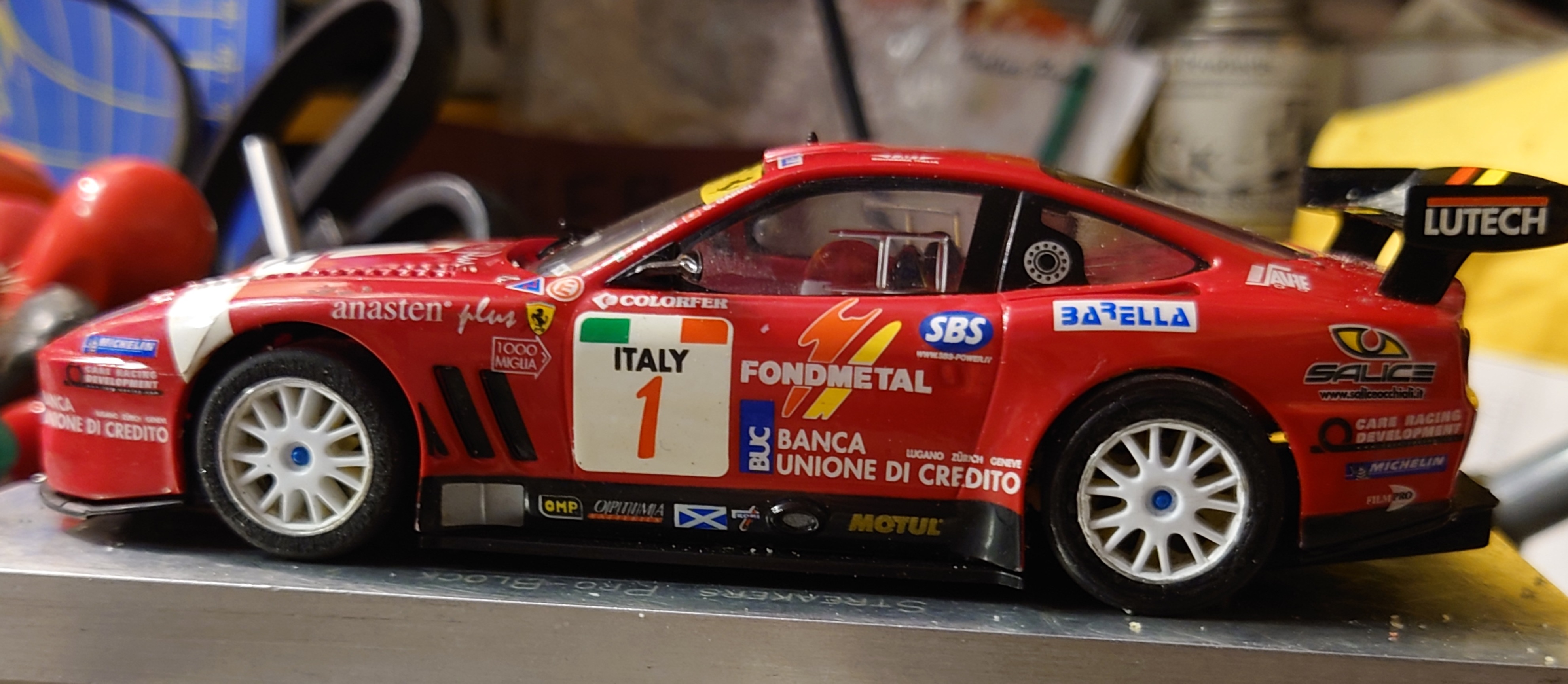

  • All 4 fitted and look much better than plain wheels
...and there's one nearly finished proxy car (just need to skim a few thou' off the tyres to width)
