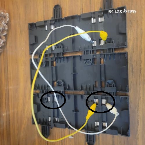

(28th-Dec-23, 05:20 AM)Pineman Wrote:
(9th-Nov-23, 03:29 AM)Pineman Wrote:  Hi Andy,
Okay, thanks for the info.
okay, will this set up do the trick ?
of course will use thicker gauge wires and add in something for the missing rails.
Hello Pineman,
If you examine Andy's pics. It shows a dead short between the rails. But only on the non-powered track section.
Your jumpers are going to the powered section of track and reversing the polarity. I would not suggest that.
Instead. Replace the yellow/white on one side to both white on one lane. And both yellow jumpers on the other lane. Within the circles/ovals.
Creating a dead short on an unpowered section of track creates drag to a motor in motion. The faster the motor is spinning, the harder the braking. Braking reduces as the car slows down.
