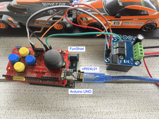

Inspired by Slingshots DIY Controller….
I wondered if it is possible to make a powerbase for Scalextric Sport Digital from development boards and if it could drive and ID change cars in a usable fashion. Turns out the answer is yes.
Furthermore using wireless or wired controllers works fine.
As an added benefit it is possible to put together this system without soldering! provided you have a bench power supply and an old PB4 track piece to use/abuse.
