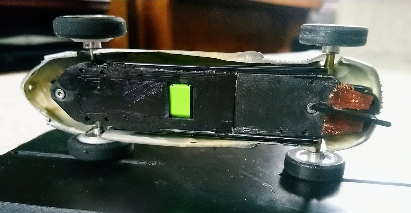

The second GP reworked car is also a Mike Dove car, a Mercedes W154.  This one is a resin cast body which originally had a similar brass chassis/motor to the W25B.
Now sporting a two part 3D chassis, scaley green slimline motor (fitted at an incline to get perfect gearmesh) and ballast under the motor with added tungsten TIG rod glued to the sides of the rear chassis but extending forwards to the front axle.
Again 2mm ground clearance for CSCRA rules.
...this goes exceptionally well!  Checkeredflag
