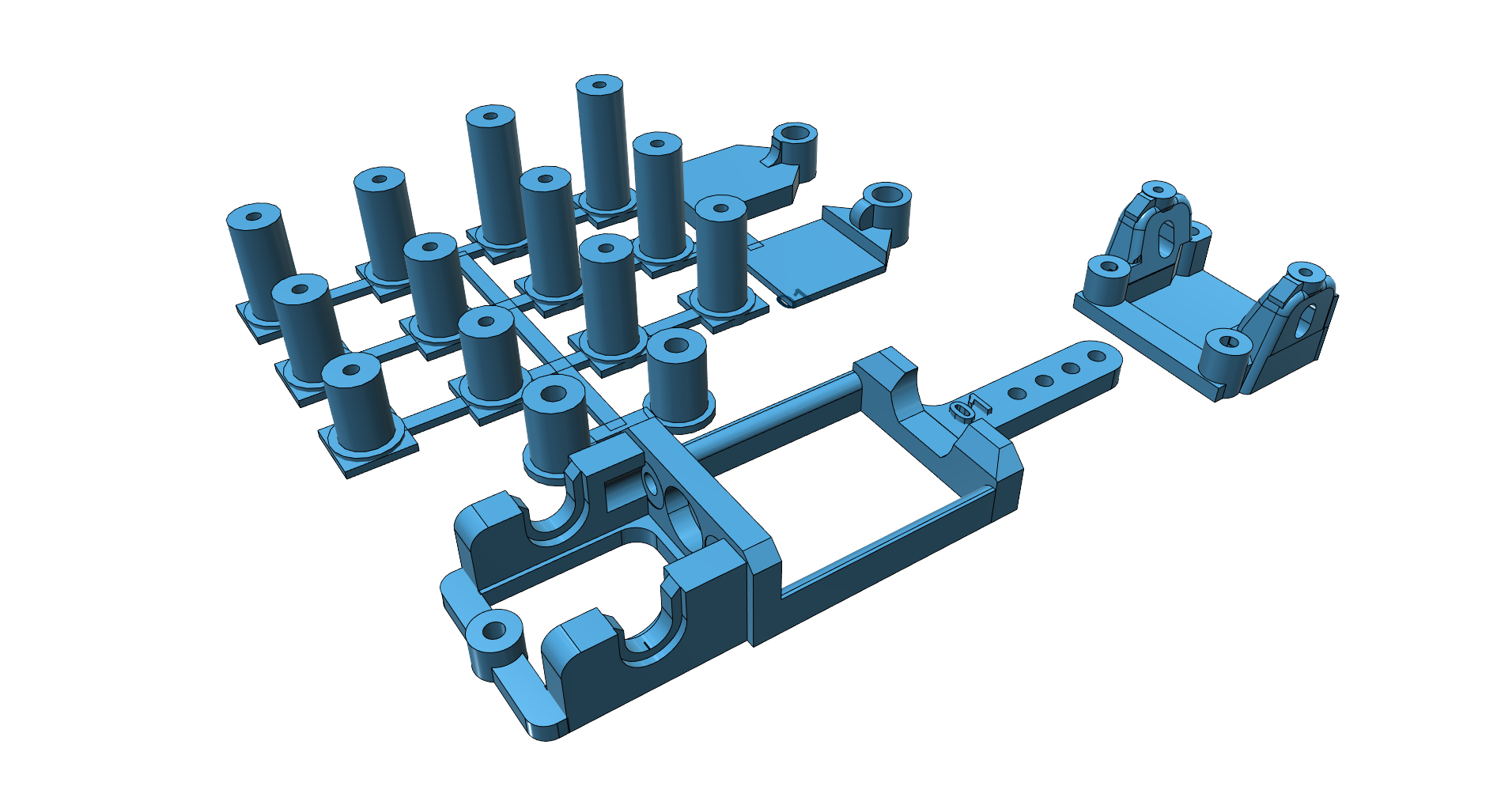

Something for the scratchbuilder. Below is a idea developed by Danny from Avon Slot car club for a GP chassis using 3d printed pod and front axle assy taken from a busted chassis. Building on the idea and with Danny's input came up with a kit for the scratch builder in pic 2.
Below is the CAD for the design showing a motor pod (S can/FC130 Can drive) with fixing points at each end the front end have an extended tab so as to give some flex depending on which fixing point used. The front axle assy has 4 mounting points, and accepts a choice of guide holders which set the guide height. Kit includes 12 body posts in pairs at various heights, and 2 chassis posts. There is a 2nd version available for the FF050 slimline motor.
