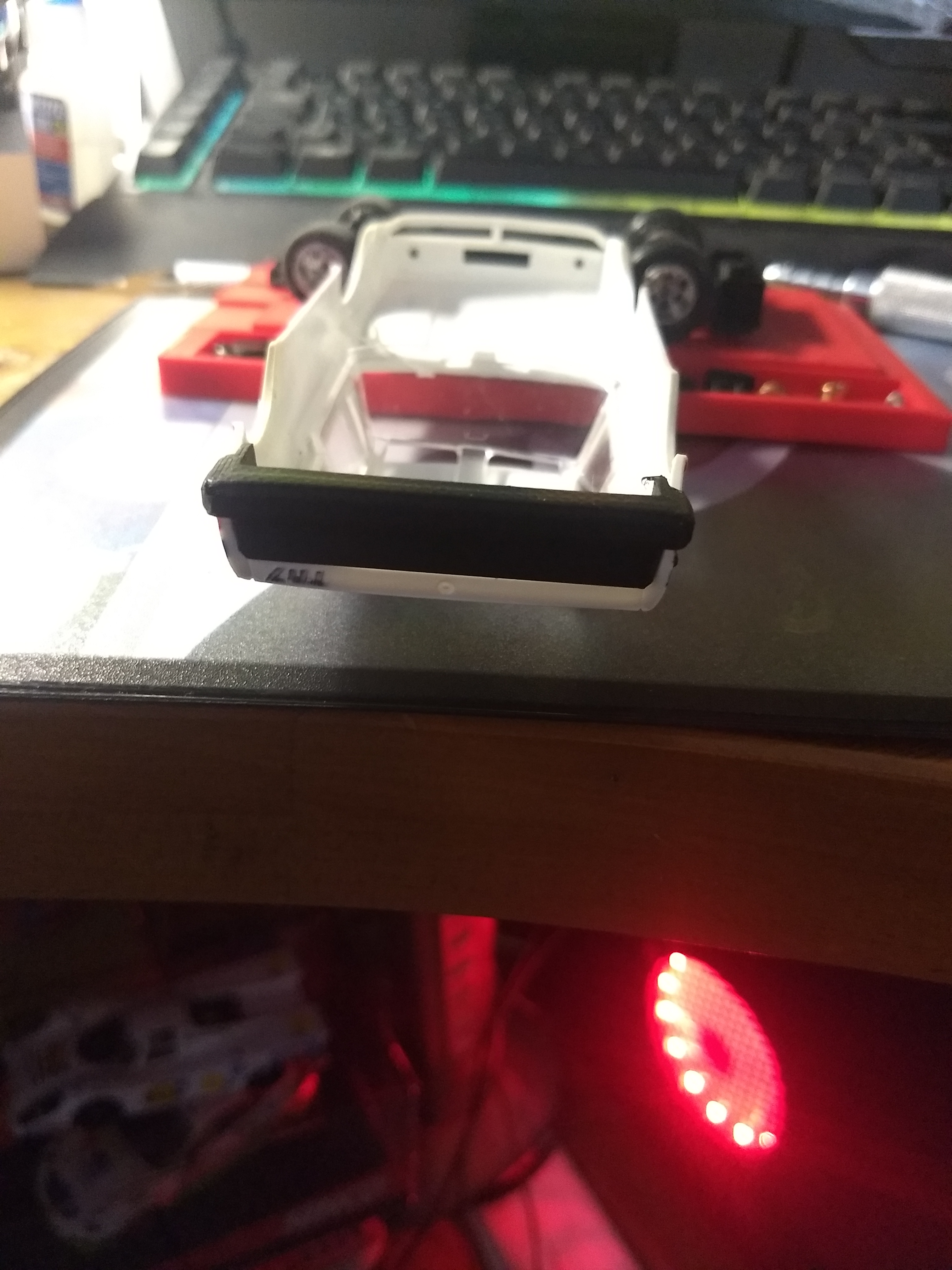

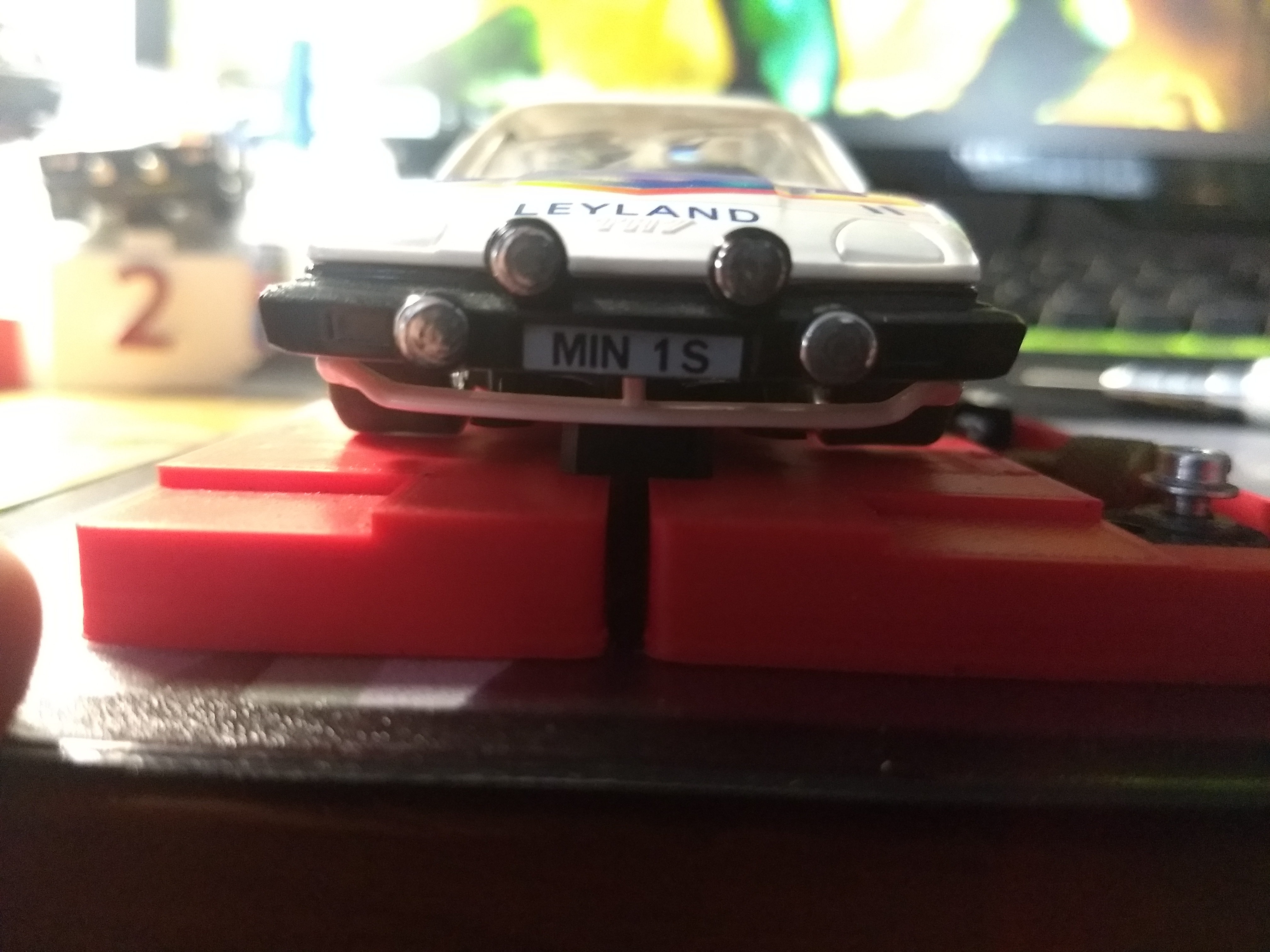

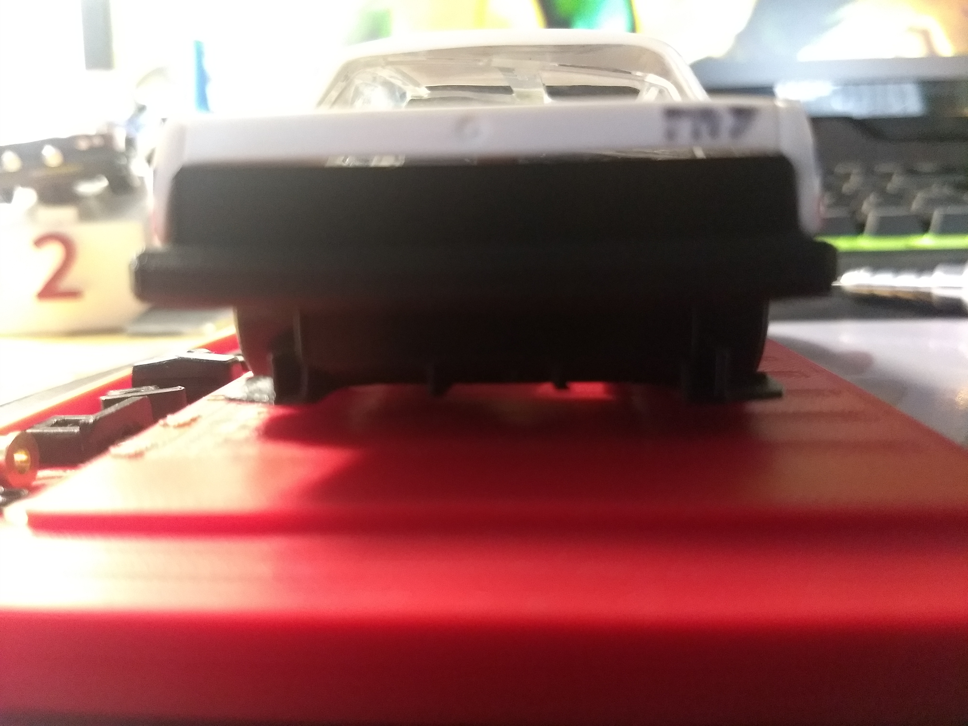

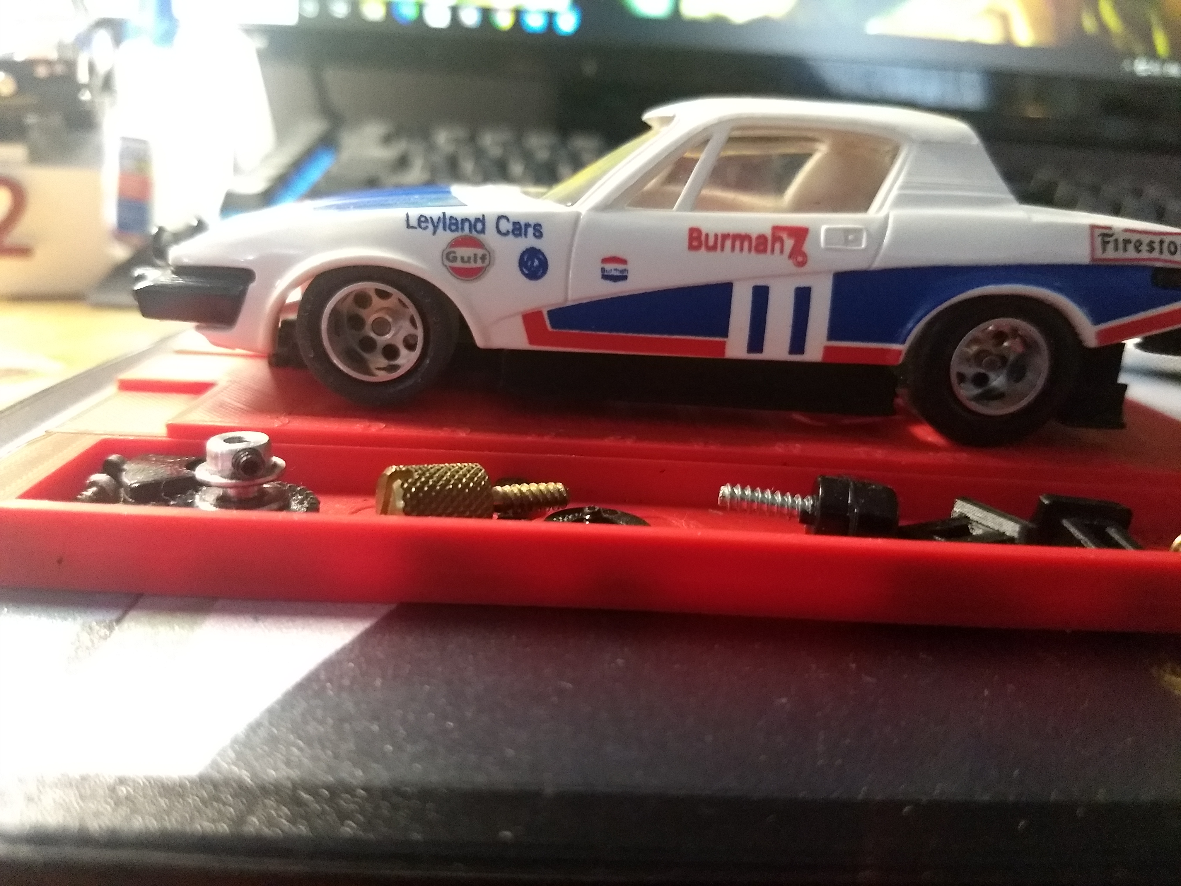

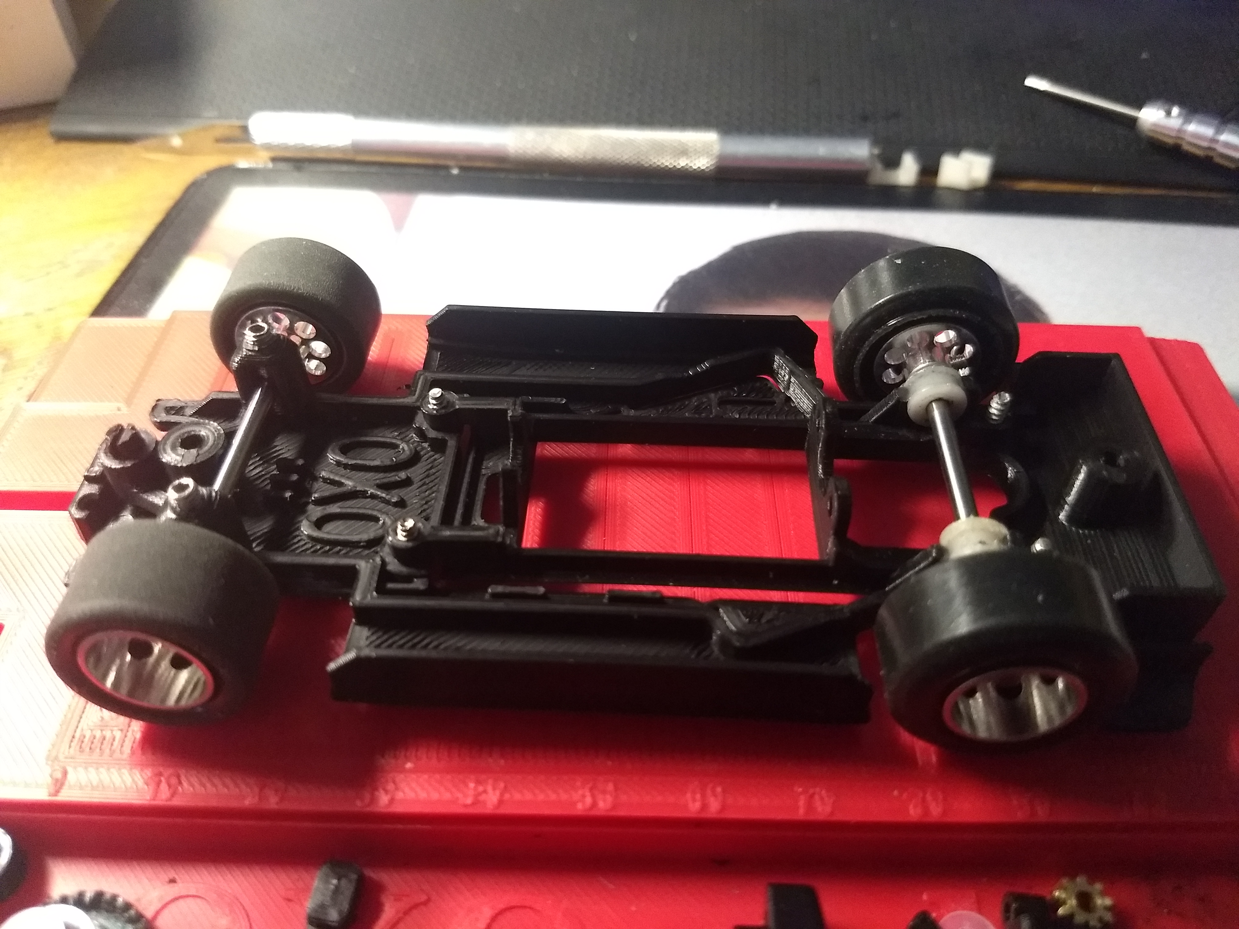

its coming together now ... stance looks good and with the side skirts now printed to the chassis it looks much better
luckily no need to modify front valance , guide fits good
front looks planted , just need to fettle the axle adjustment a bit ( see pic)
the rear looks good , although i might remove the rear chassis corners behind the rear wheels
i do feel the rear arches need further trimming for clearance only , as i am happy with the body height
next is body posts , motor , weight placement , gearing , glazing and then the interior question ( which one ?)
hoping to debut it as a little side note during B2JG proxy ( work commitments permitting ), when i host in a couple weeks  Thumbup will be good to see how it compares
