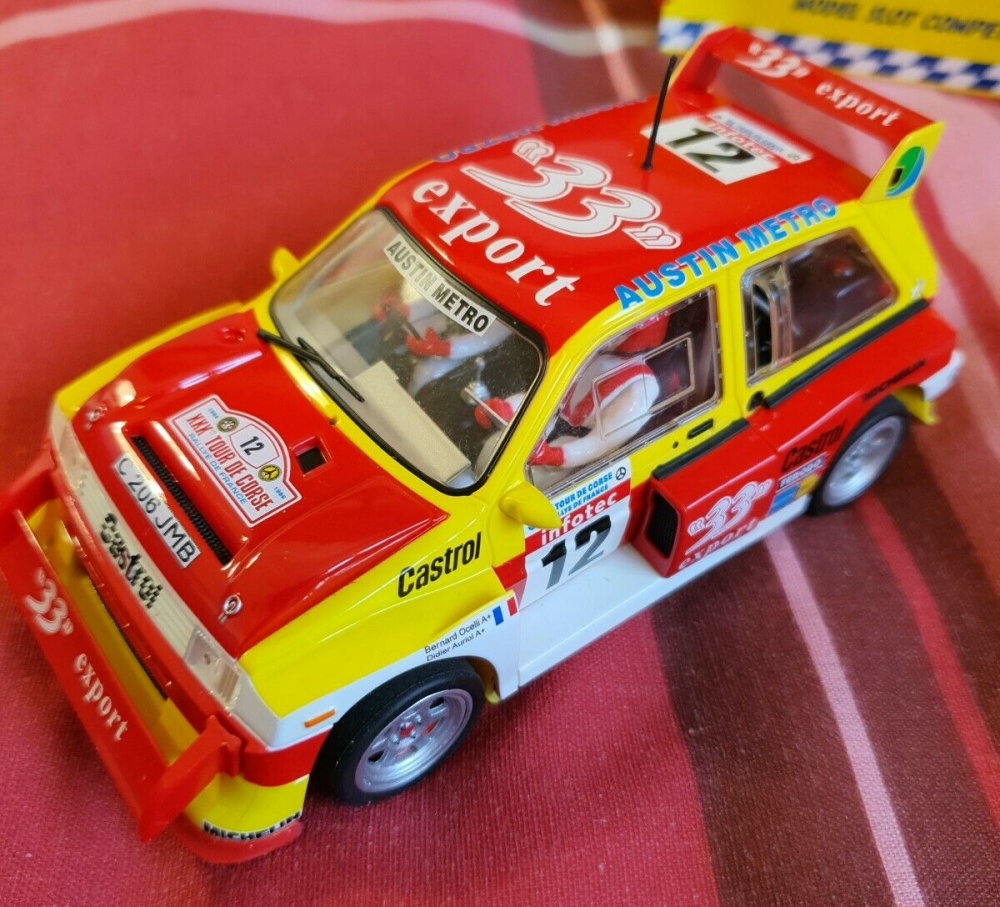

The latest eBay purchase:
MSC Metro 6R4 Rally Slot Car - Didier Auriol and Bernard Ocelly
Condition is ‘Used as New’.
UPDATE - PLEASE NOTE ONE WINDSCREEN WIPER IS MISSING.
See photos. Little use by Adults, no children. Original braids.
Straight out of the box it looked great, the only obvious issue being declared, the missing wiper.

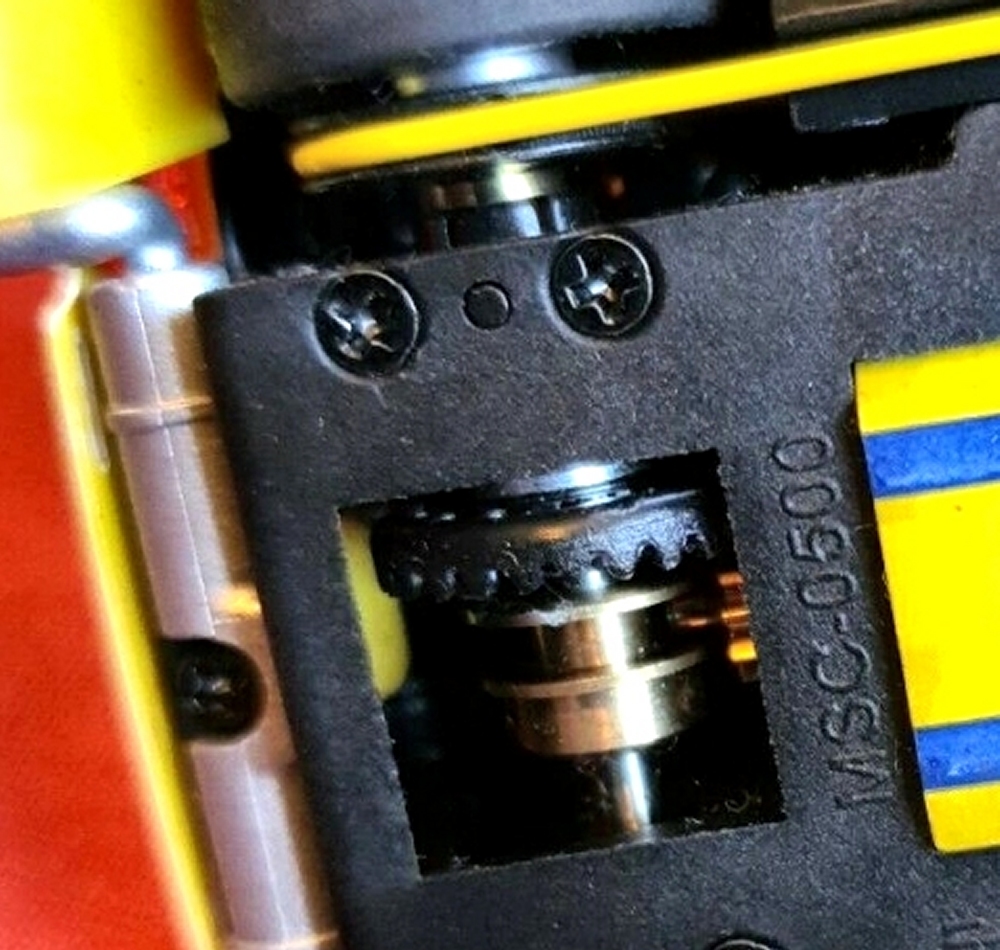

However, the first thing I always do before applying power to a car is to turn the rear wheels by hand to check for gear mesh and/or any binding. I was surprised to find that the crown wheel didn't engage with the motor pinion, or would just occasionally touch and 'graunch'.
On stripping the car I found the crown (axle) gear to be well out of alignment and the separate brass 'spacer/saver' to be rubbing on the motor shaft, both easily adjusted though. In retrospect - and by enlarging the original eBay photo - both these issues can clearly be seen.

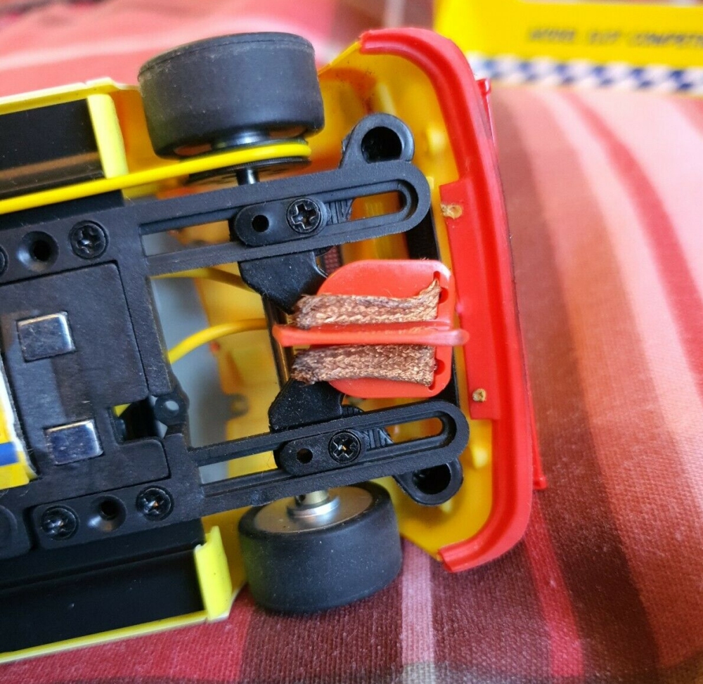

The front axle had way too much side-play, with the offside front wheel rubbing on the body, as can be seen in the photo below. It was easy enough to adjust out, as the wheels simply hadn’t been pushed fully home on the axle. While doing this I noticed that one braid had a very tight 180 degree twist where it exited the guide blade. Even enlarged this isn't obvious, the twist being so tight and almost in the braid slot itself.
Never seen that before.

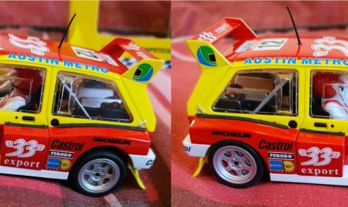

Finally the body. Both front and rear spoilers were poorly fitted, the rear not having been pushed home fully and the front not being located in the body recess at all on the Navigators side. I was expecting to have to glue them but both seem to be securely locked in place now they’ve been tweaked.
