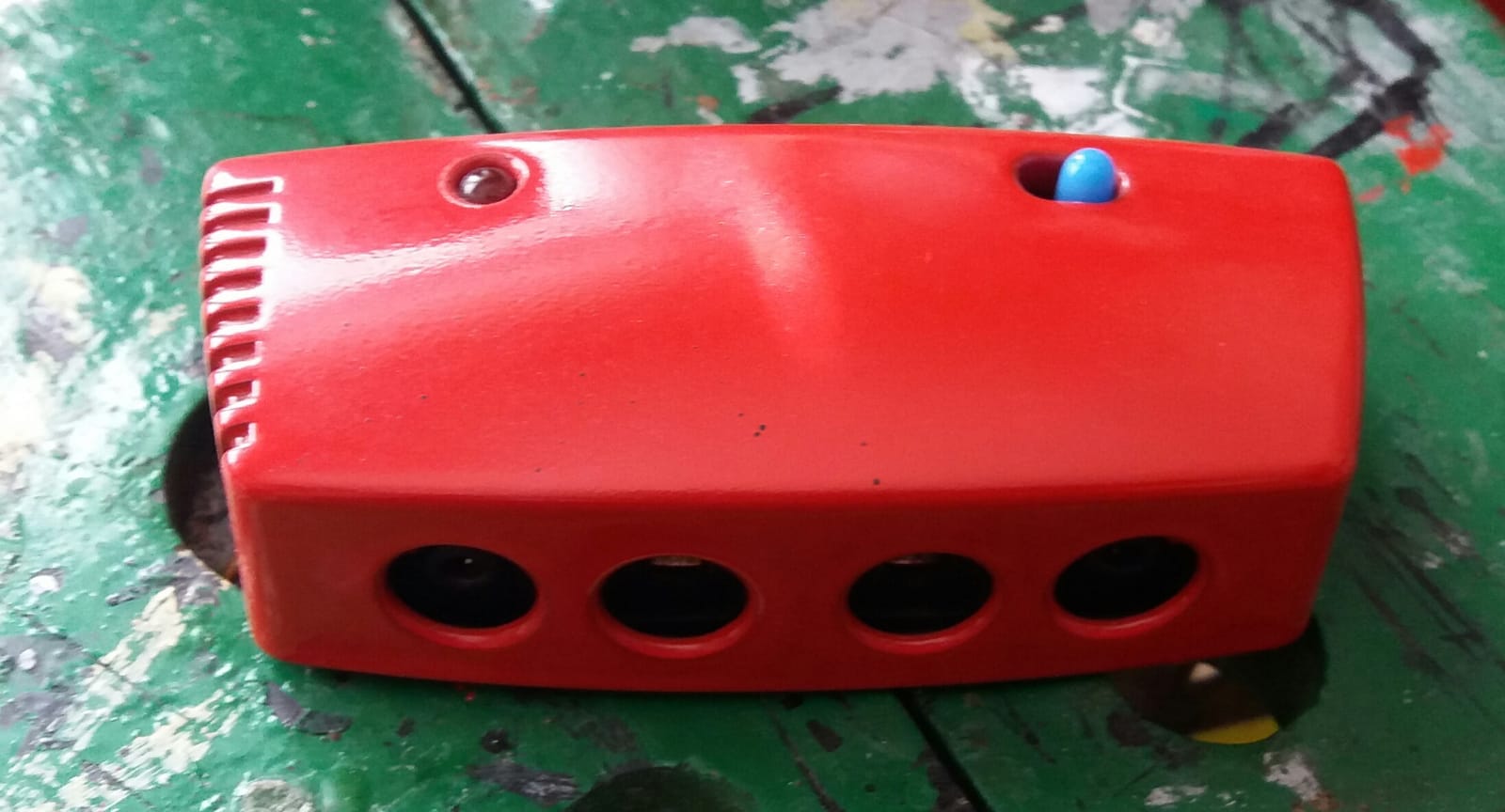

This is the innards of an obsolete Scalextric Powerbase C8217:
Could somebody who knows more about electronics than I do please explain the purpose of the various resistor doodahs?
Also, this one had the option of using two power supplies but the current versions will only accept one. Anybody know why this was changed?

I don't know how much more I know about electronics than you, but that is a reasonably clear old-school circuit board - so I'll have a go...
The brown striped resistor is there for the LED, essentially to drop the voltage so the red LED lights up and does not blow. There's a diode in that circuit too to rectify the input current to the LED...
There are four pairs of diodes (black cylinders with silver tops), most likely in the power circuit to each lane - maybe two in each, depending on what that blue switch is doing... The diodes 'rectify' Alternating Current (which the power packs deliver) into Direct Current, which a slot car's motor needs to work. Each diode also drops the voltage about 0.6 of a volt - so a circuit with two diodes will drop the 15 volt AC input to around 13.8 volts DC at the track.
The green things either end... I presume they are resettable fuses. But I could be wrong.
Why change the excellent two-input set-up? I guess it was to simplify the operation. From browsing UK slot car Facebook groups, these powerbases are the #1 reason for the question "why is only one lane working on my Scalextric set?". In my opinion, it is the best analogue powerbase Scalextric have produced, precisely because it had separate power for the two lanes and avoided the dreaded power surge when your opponent crashed.

Picking up from where Andy left off...
There are four diodes for each lane. These provide "full-wave" rectification to channel the AC into DC. That is that two diodes pass the current when the AC is one way around and the other two pass when the AC is the other way around (Alternating Current).
The other two diodes pass current from each power supply circuit to the LED (feeding via the single dropper resistor). That way the LED lights up if any one of the poweer sockets is being fed and also if both are.
The green components are simply capacitors to provide a little smoothing of the DC current going to the lanes/cars, acting as suppressors.
The switch connects/disconnects the two power lines. This is after the rectification stages so that the power-packs are effectively isolated from each other by the diodes.
The introduction of these power-bases and the accompanying three-wire controllers was a step up for Hornby/Scalextric but it has all been undone in the more recent power-bases and controllers.
Perhaps Hornby were inundated with service calls concerning operator error with the switch and therefore they decided to dumb-down back to the simple arrangement.
The carbon-fibre look was very trendy! Below is how mine looks nowadays.
PS - A Nerdy bit - these power-bases are constructed using "discrete components" where each item has its own single function. Pretty old-fashioned technology in the age of "chips" which combine several functions into one component.
