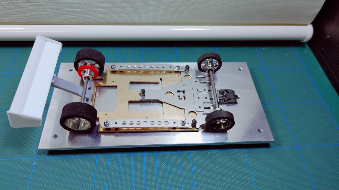

30th-Apr-26, 03:27 PM
Finished the chassis for the SCX Chaparral in posts 832/833/838.
A simple single rail design, done with .047 wire which is more than strong enough, while allowing for nice torsional flex.
This will be powered by an 18K 050 motor which will comply with the owners club rules,...on to the bodywork.
