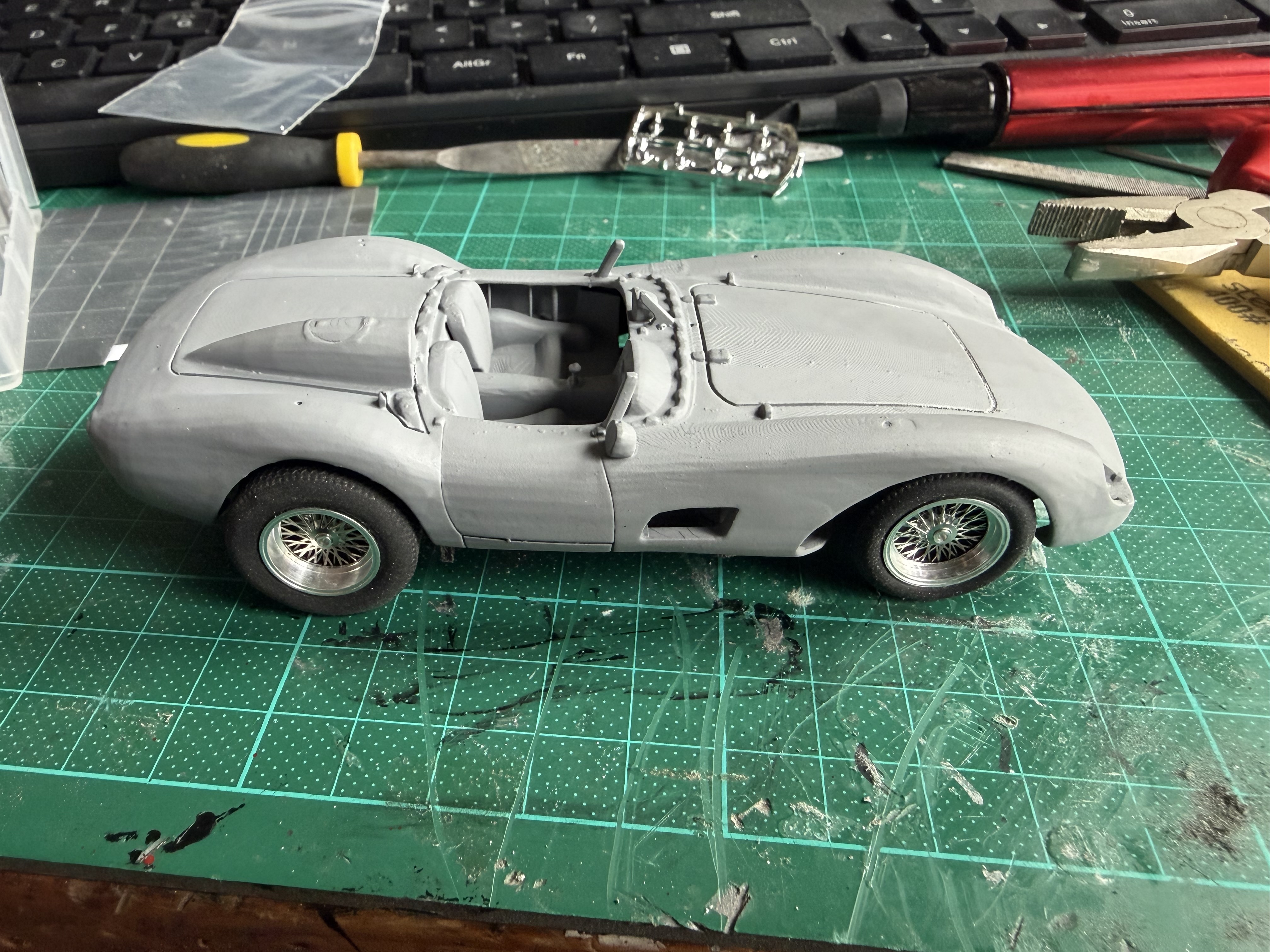

I have been asked to see if I can make this into a better runner/looker,.....it will definitely need a new chassis, motor, wheels/tires etc.,etc., and bodywork/paint/decals. I will start by cutting the sills, and rear bodywork from the lower "clamshell" chassis piece and attaching them to the upper body section,........to be honest, this project really does not excite me, but, the customer is a good friend, so I had little choice  Bigsmile

Step 1 (from above post),........all stripped down. and given a quick clean,....good news, no cracks/splits, and no missing bits.
Now to cut the necessary body bits from the chassis, and glue them to the main body.
