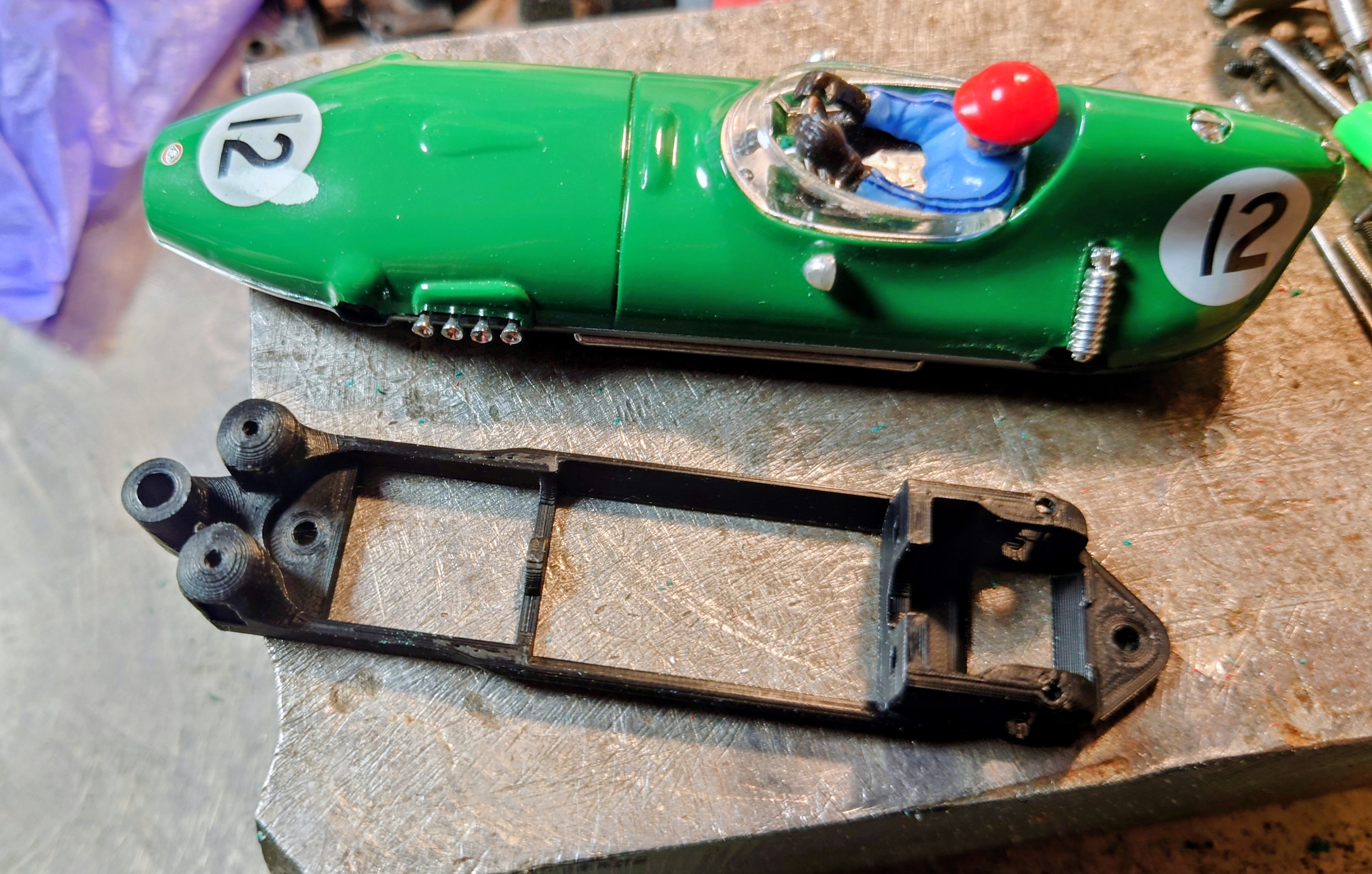

Cartrix Lotus 16 bought a couple of years ago with a badly broken guide mount.
After making a chassis for a Scalextric Lotus 25 (the old one) that works nicely, it's time to do the same for this Lotus.
Chassis halves glued and roughly ground out.
A few millimetres of plastic left to grind out to fit the chassis.
[+] 7 members Like Kevan's post
A brass plate will hang under this 3D chassis.
The chassis is sandwiched between the bodyshell and brass plate allowing free movement of all three parts.
There will be 2mm ground clearance under the brass plate to conform to CSCRA regs that we race GP cars to.
Narrow track, wheels and tyres to suit.
I have a chassis design for inline slimline motor but this chassis is for a Flat 6 motor, possibly one from a Racer Sideways Group 5 that are mild enough.
I forgot to add rear axle will be in Slotit spherical bearings and have height adjustment. Front axle will be through a brass tube and also height adjustable.
Adjustable height makes it easy to set proper ground clearance.
