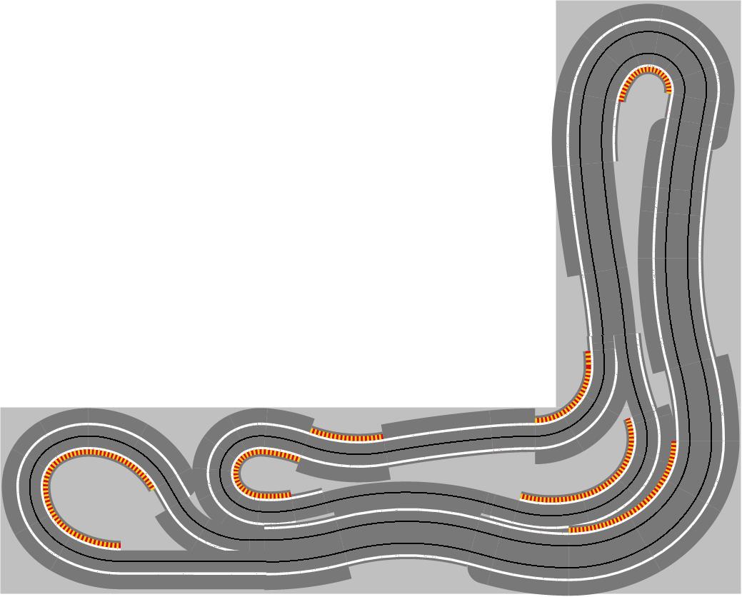

I had a go at drawing a rough approximation of your track in Ultimate Racer. It has a 9cm track width with 7cm borders and it looks like this...
I coudn't resist trying out a couple of alternatives.
A figure of eight...
And a rally loops style track which bumps the track length up from 9m to 17m.
[+] 4 members Like JasonB's post

(19th-Aug-25, 09:56 PM)JasonB Wrote:  I had a go at drawing a rough approximation of your track in Ultimate Racer. It has a 9cm track width with 7cm borders and it looks like this...
They are great the last one I really like particularly the sinuous lanes at the back. Do you print the plans off from the Ultimate racer or just use it as a guide and hand draw it?
Personally I would just use it as a guide to hand draw it.
