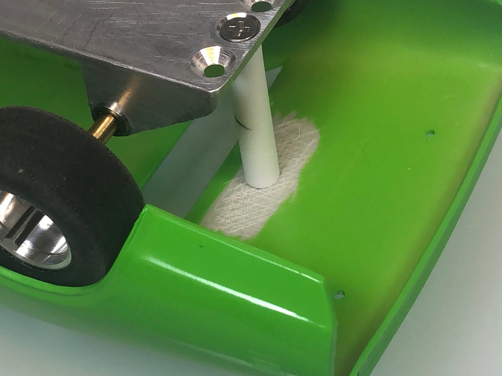

Once I'm happy with how the car sits. I insert a toothpick through the body post hole and measure it to get a close guess on the post length. The Charger came out to 28mm front, and 29mm rear.
Install the body posts to the chassis and do a dry test. If all looks good, you can start preparing the body and posts for the epoxy.
Note the area where the posts sit in the body and scrape the paint off. Then use a sharp blade to make X-cuts in the plastic where the epoxy will be applied.
I also sand/rough up the end of the body post by hand. It helps the epoxy stick.
Then while the posts are still attached to the chassis. Apply epoxy to the inside of the body and on the posts. Make sure a small dab of epoxy goes into the posts. Quickly set the chassis into the body allowing the tires to center everything. You can adjust the chassis to make sure it's square, and that the tires line up with the wheel wells. Gently hold it together, and check it several times. Allowing the epoxy to harden while upside down to create a better glue fillet.

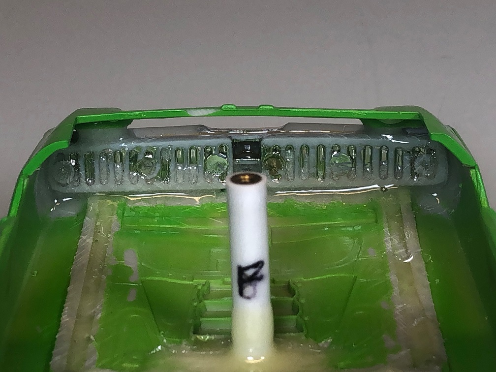

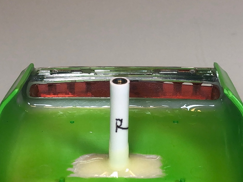

Part 4: Bumpers.
These were designed as static kits. A touch of glue will usually do for a static model because it never has an off.
The prep is very important if you want it to survive as a slot car. These cars have experienced some very hard hits, and they still survive.
Besides removing the paint and chrome. A box cutter with a fresh blade was used to mark X's on both glue surfaces and surrounding areas.
While holding the car in one hand. The front bumper was held in place with one finger. 5-minute epoxy was liberally painted on the inside of the car. The car was held nose up to prevent expoxy from seeping past the bumper.
Same treatment for the rear bumper.
The extra weight is worth the improvement in strength. It's starting to look like a car now.
Note: Always read the kit instructions before you start. I didn't notice that the rear valance panel was glued to the rear bumper and needed to be painted separately. The green paint will be dry by morning.

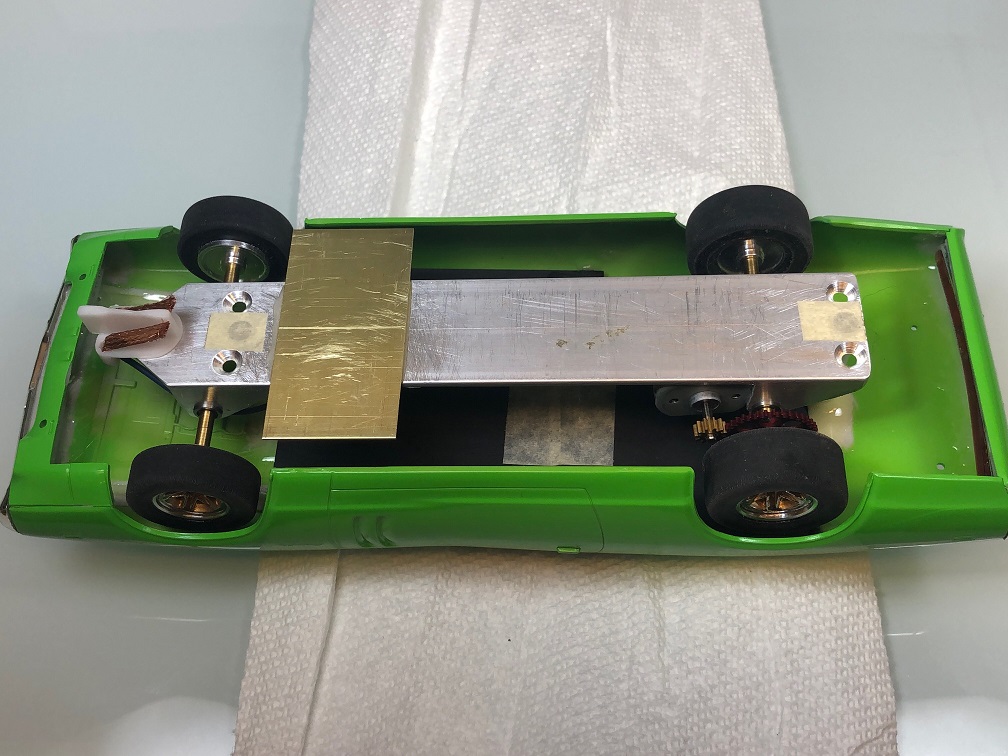

The all up weight is just over 130-grams. The target weight is 140-grams.
A piece of 2" inch brass by 0.032" thick does the trick nicely. Cutting a piece just over an inch wide should give about 10-grams of weight.
A line is scribed down the center of the chassis, and the brass weight. The mating surfaces are rough sanded with 150-grit sandpaper, and wipe clean. Then the weight is epoxied to the chassis with both lines lined up. A clamp is used to keep it in place for 5-minutes.
The weight hangs under the chassis at about 1.5mm off the track. Stick-on lead weight can be added to the top of the outer wings if needed.

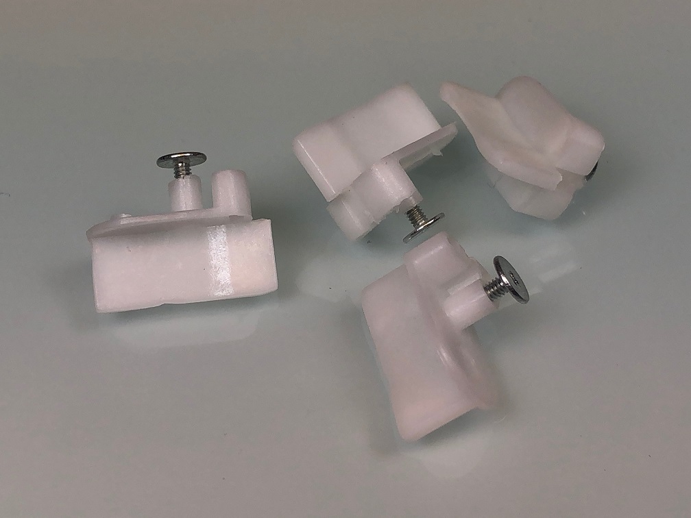

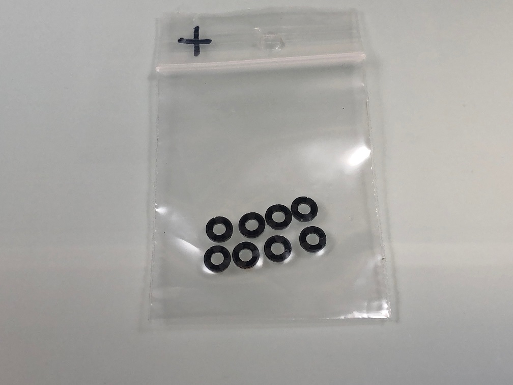

Urethane washers that properly fit the 4-40 screws were purchased from DArt Hobbies.
This is the tricky part. Setting/keeping the washers in place while installing the chassis. Practice makes perfect.
