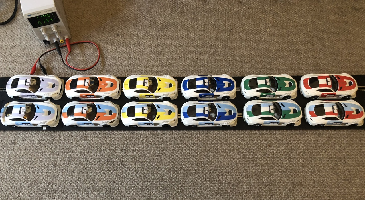

The above cars are of course white car kits so needed some colour to be added.
The colour schemes were laser printed onto matt white polyester self adhesive A4 sheets with three cars per sheet. The product I used was from Labelplanet with product code LP1/210MWR. The adhesive works nicely too. It’s easy to remove if necessary without leaving residues.
The cars are fitted with white (hard) chassis so they can be driven either magless or with magnets fitted.
Next, they need lights and colour-coordinated rear wings.

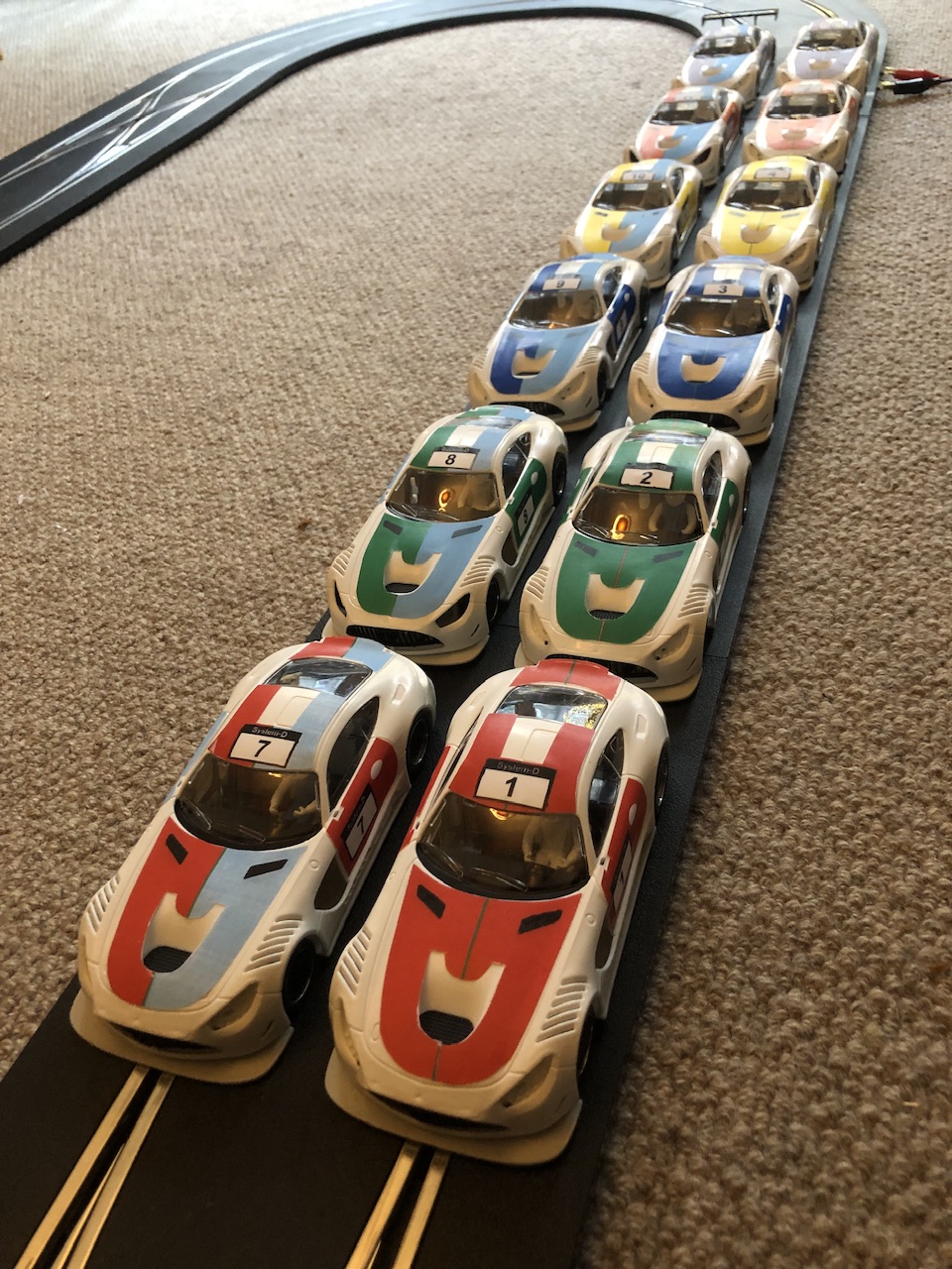

After the system not quite being ready for racing trials last weekend, some good progress was made this week.
Cars on IDs 7-12 are now running correctly at racing speeds, slow speed traversing R2s and fast (ish) on 4 metre straights.
But that is only six cars… next to add IDs 1-6 into the mix.

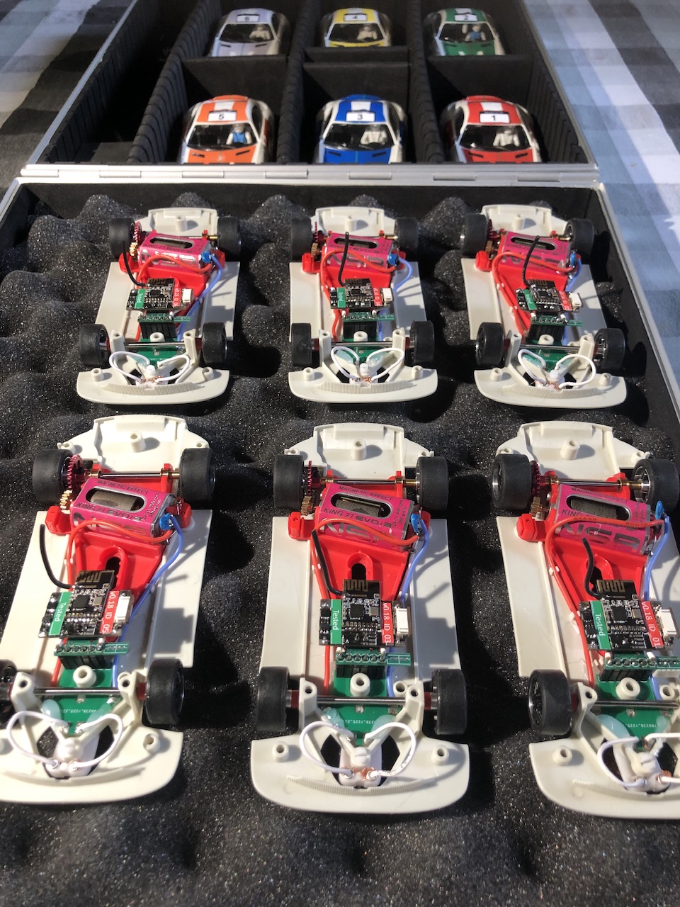

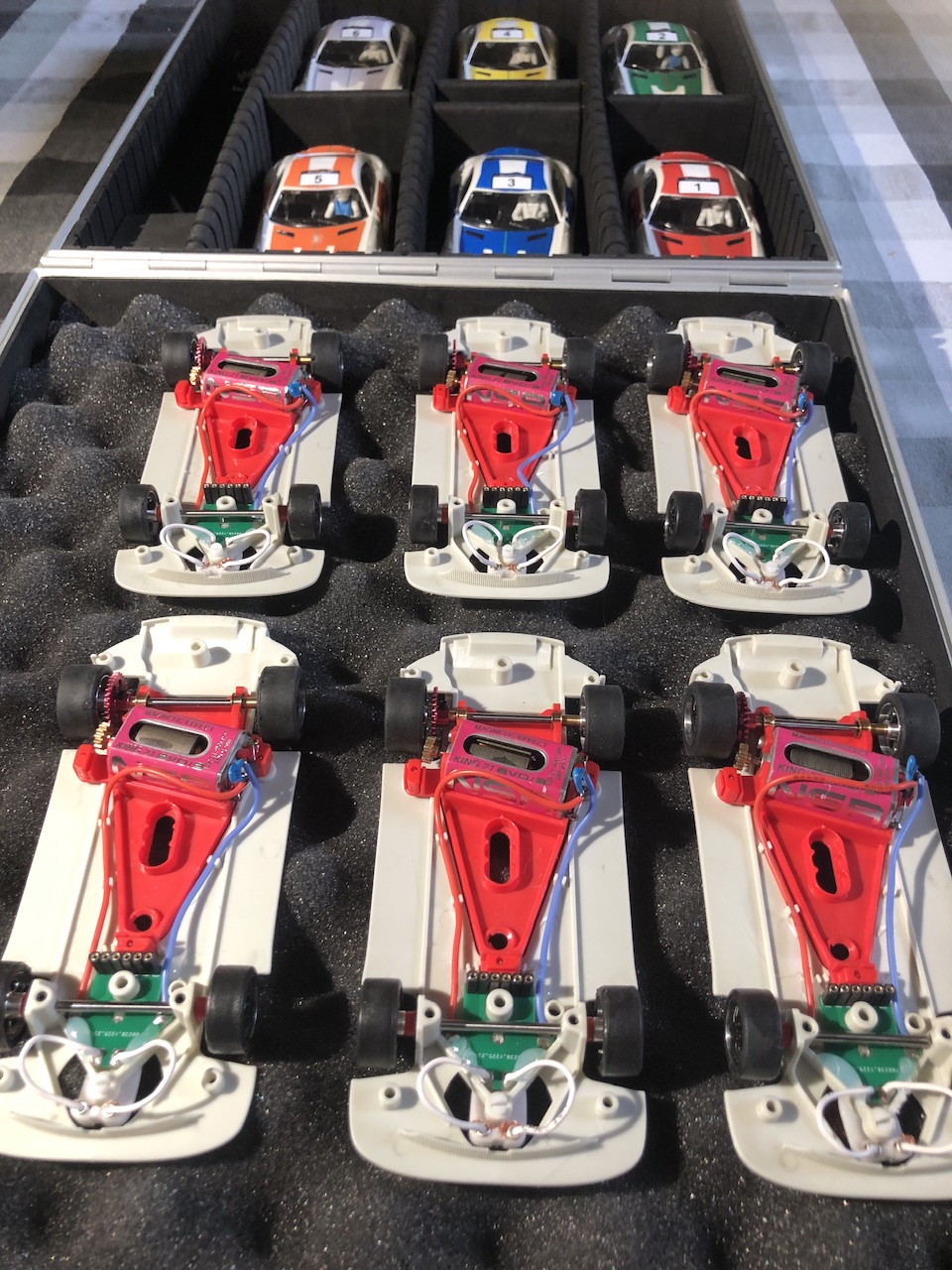

Same method as shown earlier is used for chipping the cars with decoders on IDs 1-6.
A ‘triangular’-ish circuit board is used which has a six pin header socket and a downward facing surface mount Infra-Red LED fitted. This is wired to the pick-up and motor (hence the total of six pins) and then hot-glued into place.
The decoders are then ‘plug-and-play’ using the six pin interface.
This approach is great for trials of the new system. And, using matching pin configurations for SSD and O2 - it is straight forward to change system as and when desired.
IDs 1-6 now ready to join the trials of the new system to be followed by a lab based characterisation of throttle response times and max safe speed for lap detection etc.
