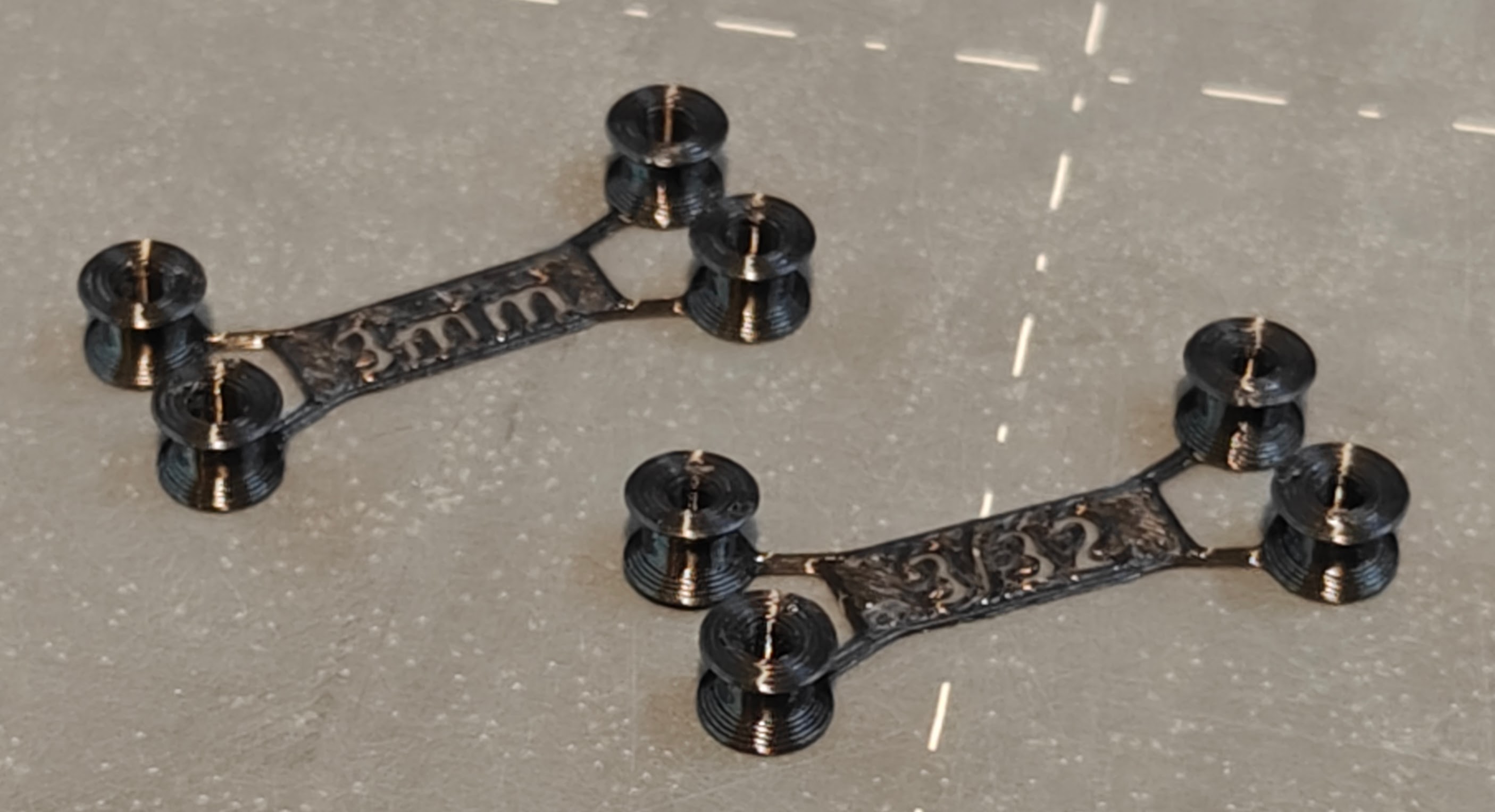

Since RevoSlot has made 3mm axles in 1/32 cars a common thing now, not to mention all the 1/24 cars that use them, AND the fact that 3mm double flanged bushings that fit into regular 3/32" bushing clips don't exist (afaik), I've done a simple printable version. These will be included in my kits from now on, as well as a 3/32" version, as many new to the hobby who get my machine don't have spare 3/32" bushings to use with their slot.it and other cars. Note that, due to the variations of machines and material, you may need to get a reamer (or drill bit) of the appropriate size, or make adjustments to your flow rate or xy compensation in order to get a slip fit with your axles. They can be printed in any material and used with lubrication. I would not recommend filled materials, such as PETG-CF, as the abrasive nature might damage the axles.
Here's a link to the printables page, where they've already been uploaded:
https://www.printables.com/model/459450-...achine-rsm
I'll also be providing a bunch to Alan to sell via 132slotcar.us, for those out there wanting to convert cars with snap-in bushings from 3/32" to 3mm axles.
