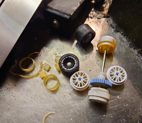

Making wheel inserts from wheels

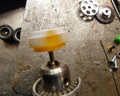

Proxies nearly always require wheel inserts if you're using plain alloys, here's what I do...
  • Don't throw plastic wheels away, one day they'll be useful

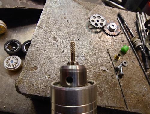

  • I chopped an old axle shorter to fit in my dremel type grinder
  • Push a wheel onto the knurled axle as square as you can so it runs true...it'll hold well enough
  • Grind the wheel down to size on a big bastard file (that's their real name - honest)
  • Grind it down to just fit inside your alloy wheel...you may find a lot of the wheel will disappear as you grind it really thinly
  • Cut the front face of the insert with a razor saw, it's easier to do this whilst it's spinning in the dremel machine but run it slowly or it'll fly off into hiding
  • Try the first one so you have the right thickness, you can cut it short but not push it into the wheel so far

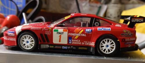

  • All 4 fitted and look much better than plain wheels
...and there's one nearly finished proxy car (just need to skim a few thou' off the tyres to width)
[+] 10 members Like Kevan's post

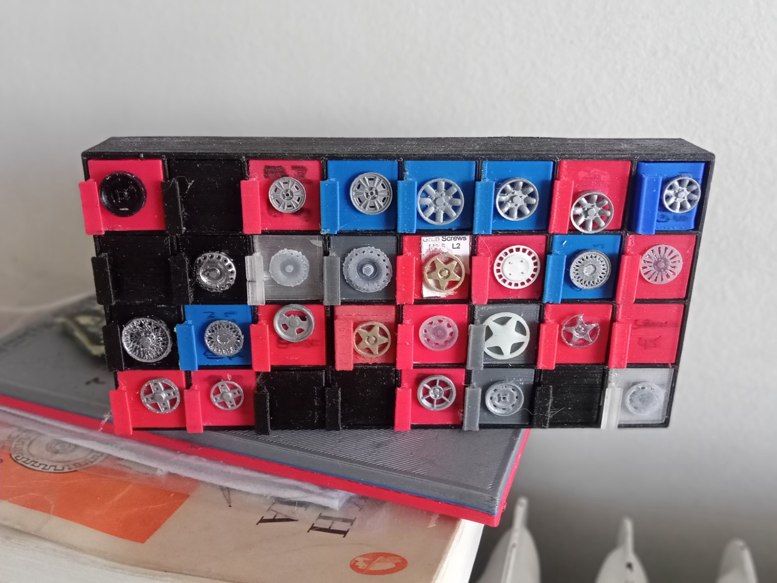

However, for DiSCA racing, a realistic wheel face is mandatory so my good buddy Mark Long (LongRoadRacing) designs and 3d prints the inserts for the GasMonkeySRT cars, saving precious grams of rotating mass in the process.
It also allows us to have matching wheel inserts for the various rear wheel sizes we use ( depending of the status of the various moving targets of car tuning for endurance racing)

Yep I've done that too Alan, designed and resin 3D printed inserts and with time and effort you can create unique looking wheels.

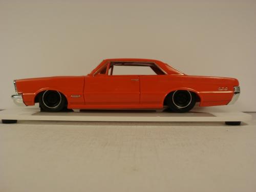

3D inserts are very cool. A good friend printed these up for me (Slot.It wheels). I showed the guys in my club.
I was told by everyone in the club to lose the Chip Foose wheels, or I can't race classic stock car. So I had to install these boring steel wheels. Bleh!
Thankfully the decals help pull your eyes away from the ugly wheels.

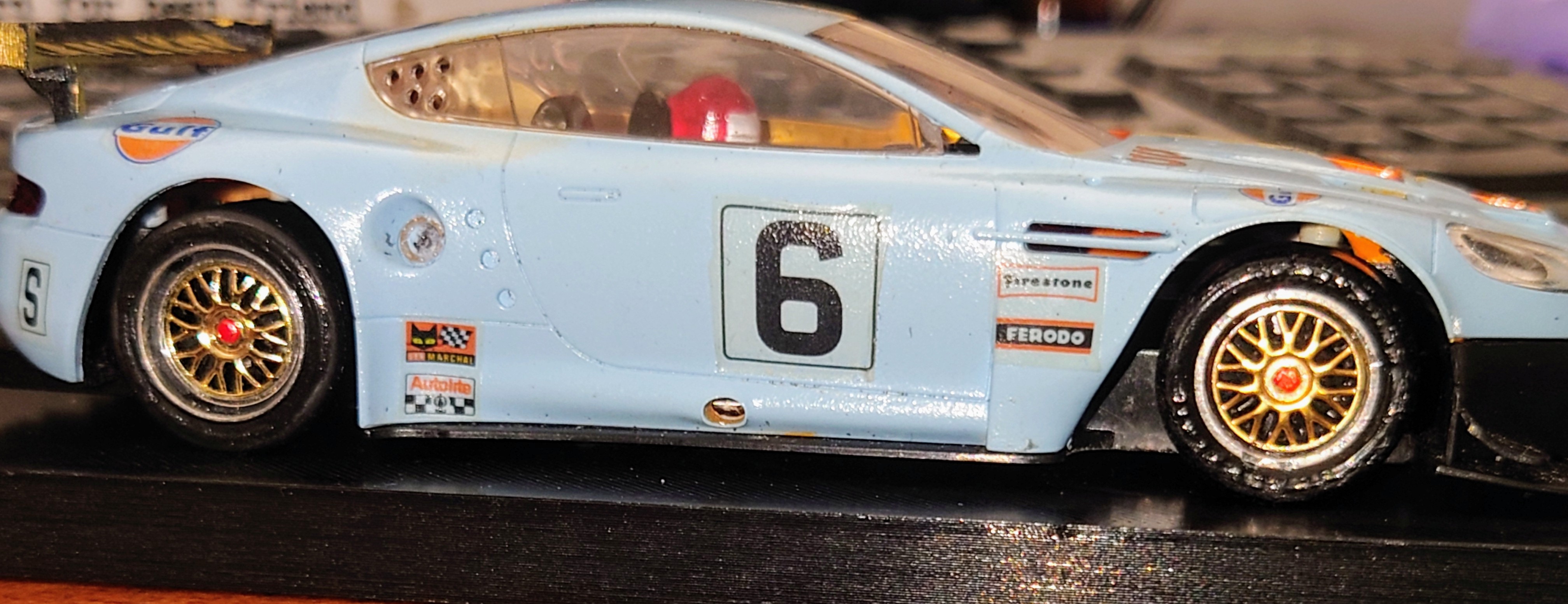

Inserts done for my other proxy entry...
...a set of Fly wheels, gold looked better than white
