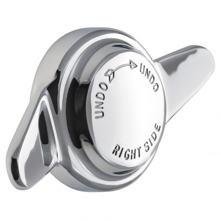

In 'the olden days' when some sports and racing cars had two or three eared centre spinners 'directions for use' were actually cast into the face of the spinner.

Quote:" .... rotation of the wheel on the hub under braking will cause the nut to rotate on its thread. If this rotation is in the correct direction — which is ensured by using differently handed threads on either side of the car— then the nut will automatically retighten itself."
Explanation found on the web.
