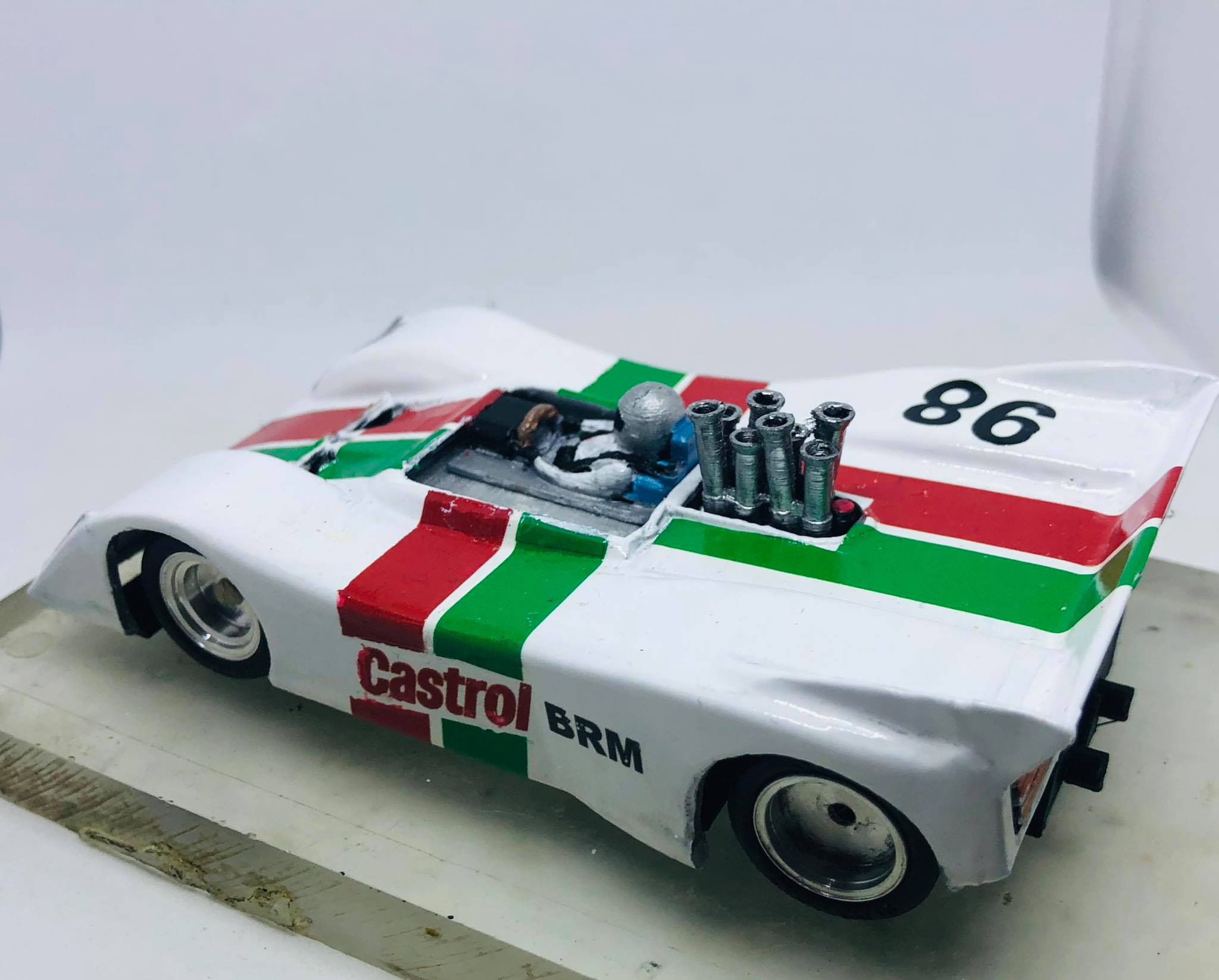

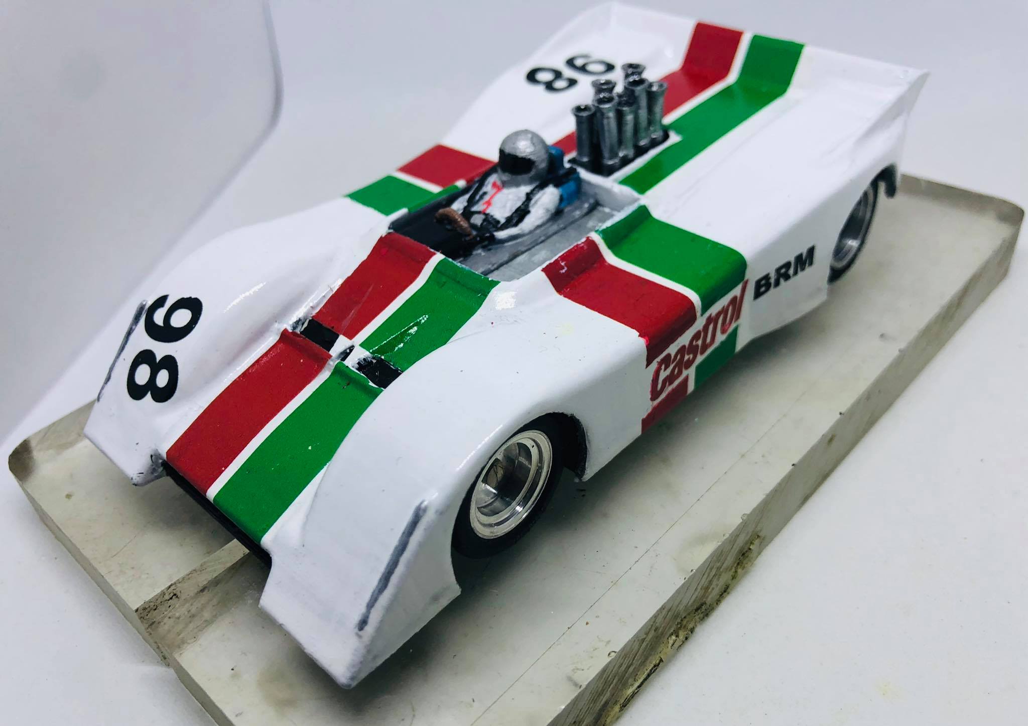

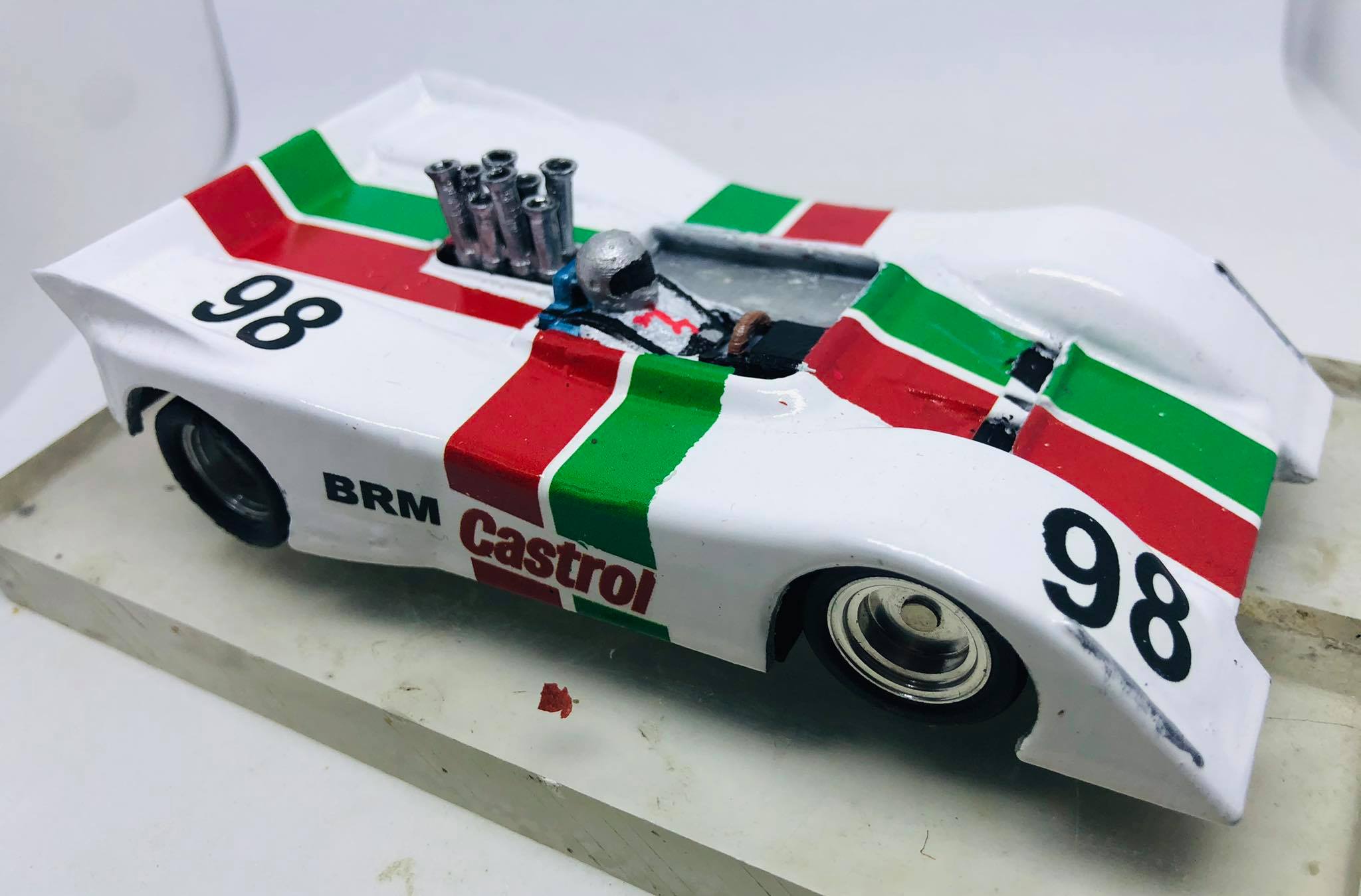

Want to thank John for the above and beyond service he has given to me - will always recommend him to anyone who want a 3D printing.
John - you thought of printing wheel inserts?

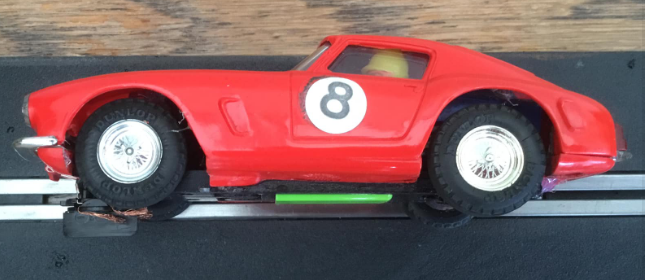

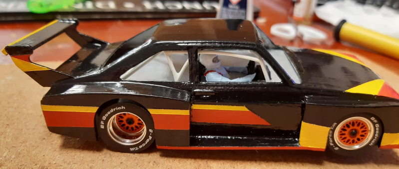

Decals are awful ( crumbled) but my version of his amazing Can AM BRM:
#52
Cool and original car, Anthony.
CanAm? Now you're talking my language. I grew up in Montreal, Quebec, Canada close to where they raced CanAm back in late 60's (Mont-Tremblant).

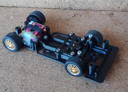

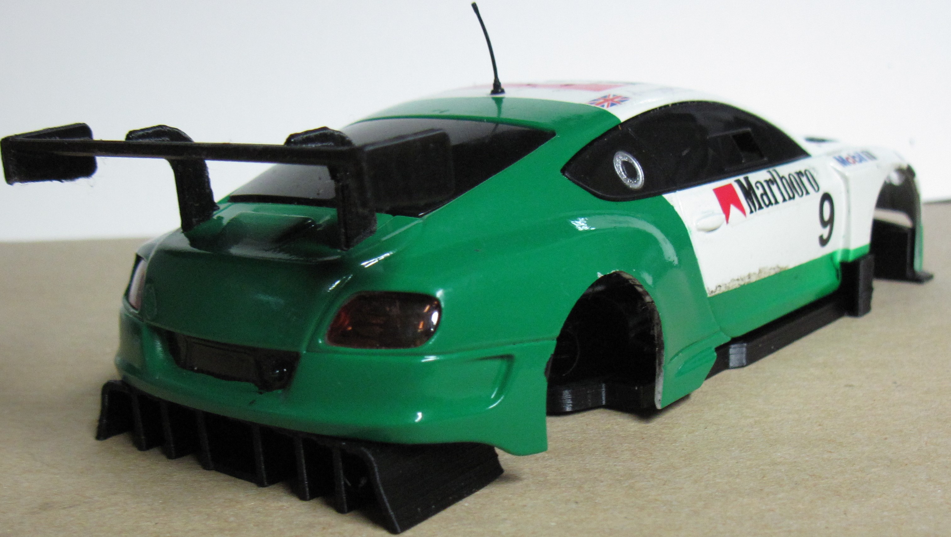

Bentley GT3 chassis and wing

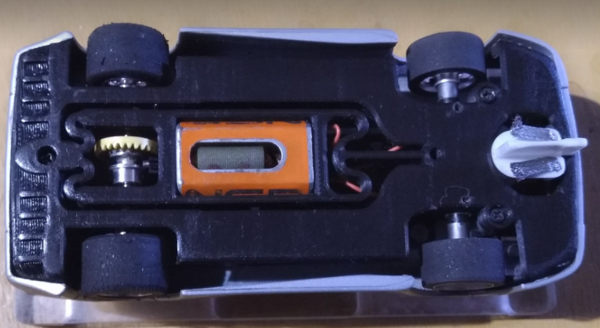

Fitted with the new chassis system 'G' spec. with AW Boxer pod.

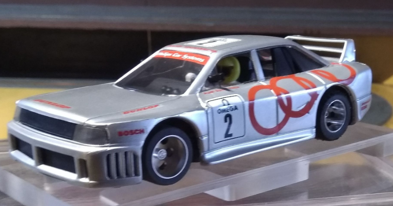

SCX Audi IMSA chassis (Cheers Dave for use of the pics).
Both chassis' are available in AW or IL S can or Boxer.

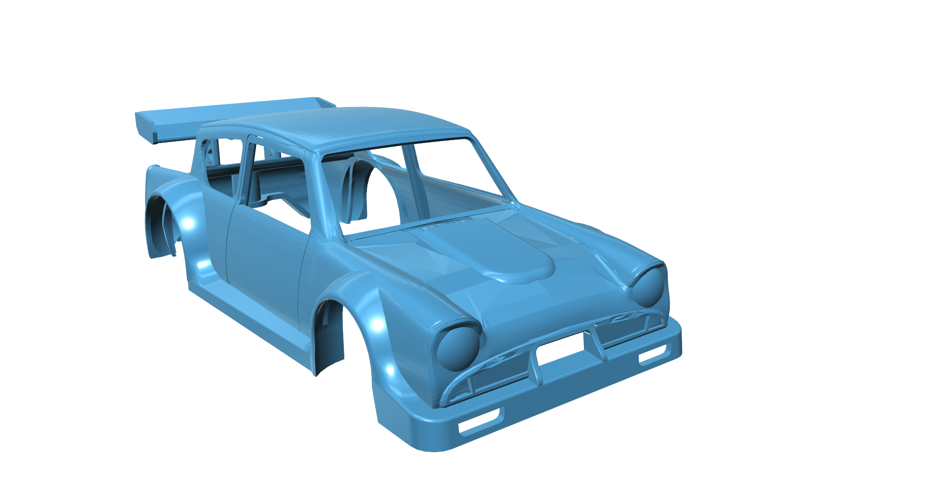

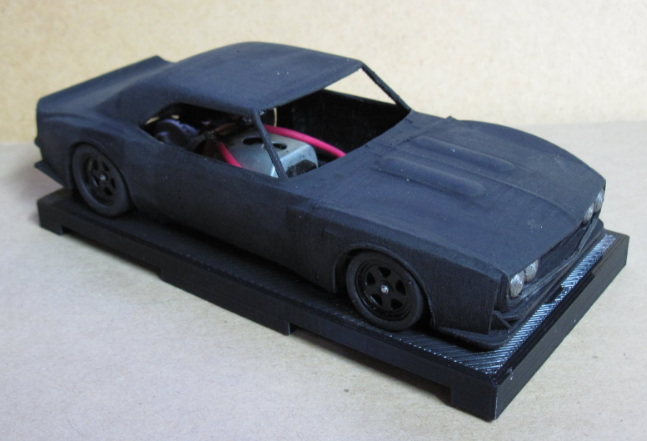

Ken Block modified a Mustang, this is my 'street racer' modification to a 67 Camaro, lowered, arches pulled out, twin turbo bonnet new front. Started off as a design doodle to learn new CAD techniques to modify and redraw STL files and morphed into this. Some work needed to refine held up by the cold spell for printing, but hoping to get this completed by end February with interior, glazing and chassis options for IL & AW Boxer/S can.

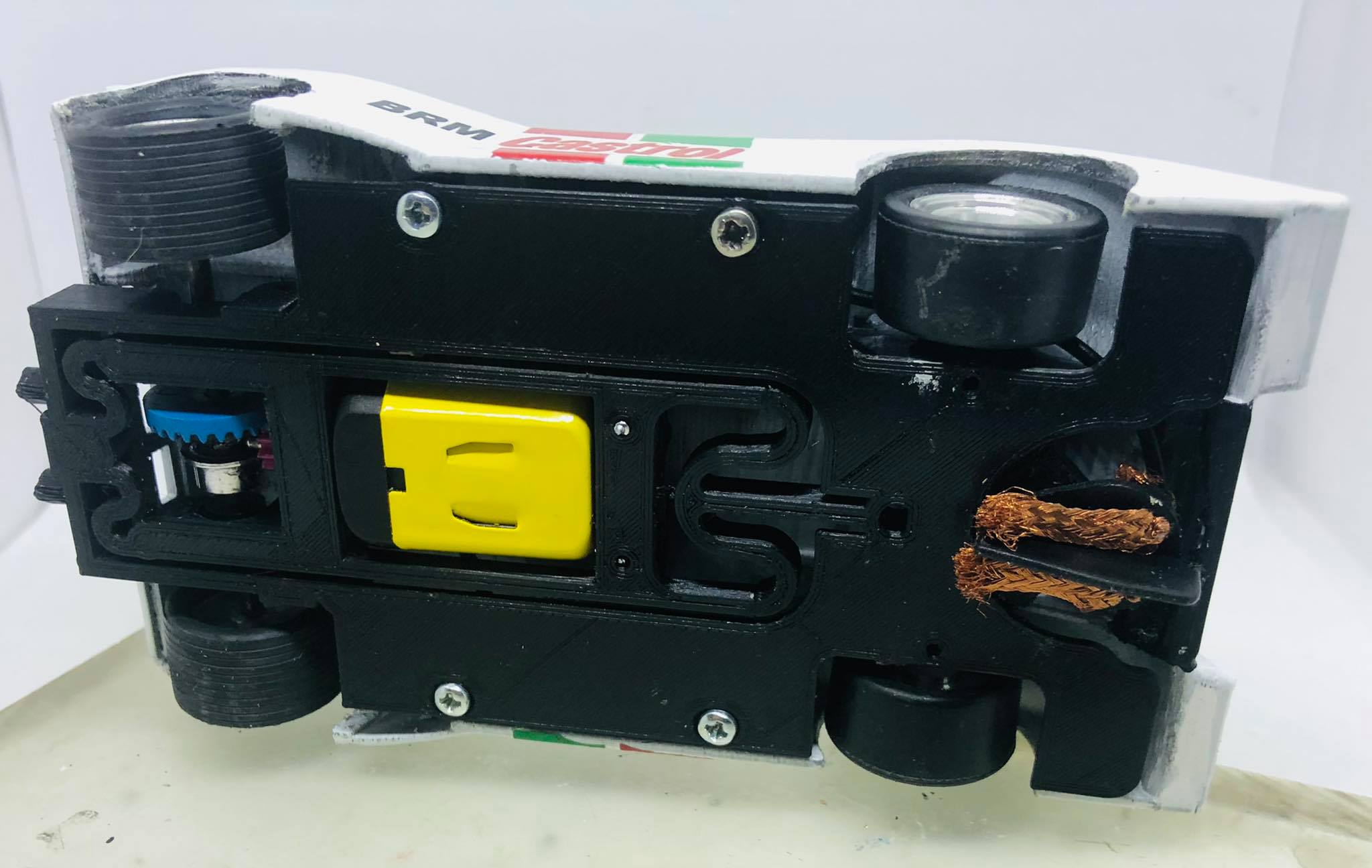

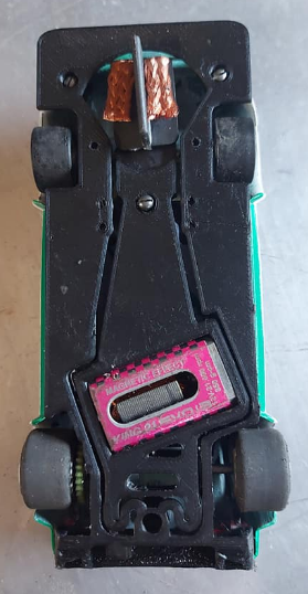

Special chassis for an old Berlinetta 250 GT FF050 powered based on a standard JS chassis WB modified and posts added to suit.

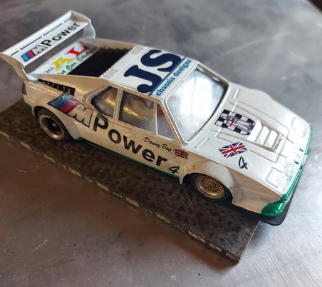

BMW M1 SCX chassis to the new G spec.

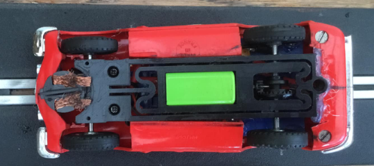

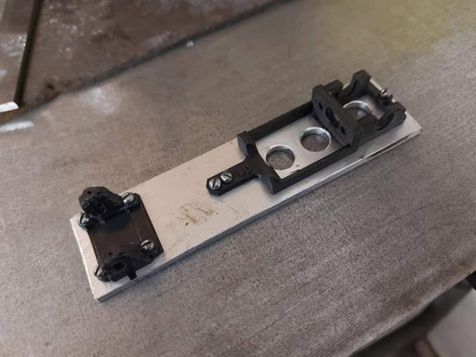

This add to the existing range of  IL pods of either S can or FF050 options, for those that want to use a brass or aluminum plate as below by Danny for his entry into the Parsons Park prewar series.
Finally the Metro chassis has been popular for those wishing to capitlise on the WB matching other Scalextric shells, so below is a modified chassis with the rear tab removed a post to replace it and a 3rd body post now included to make the conversion easier. This a rear torsion arm, front pivot chassis which enables a short WB.

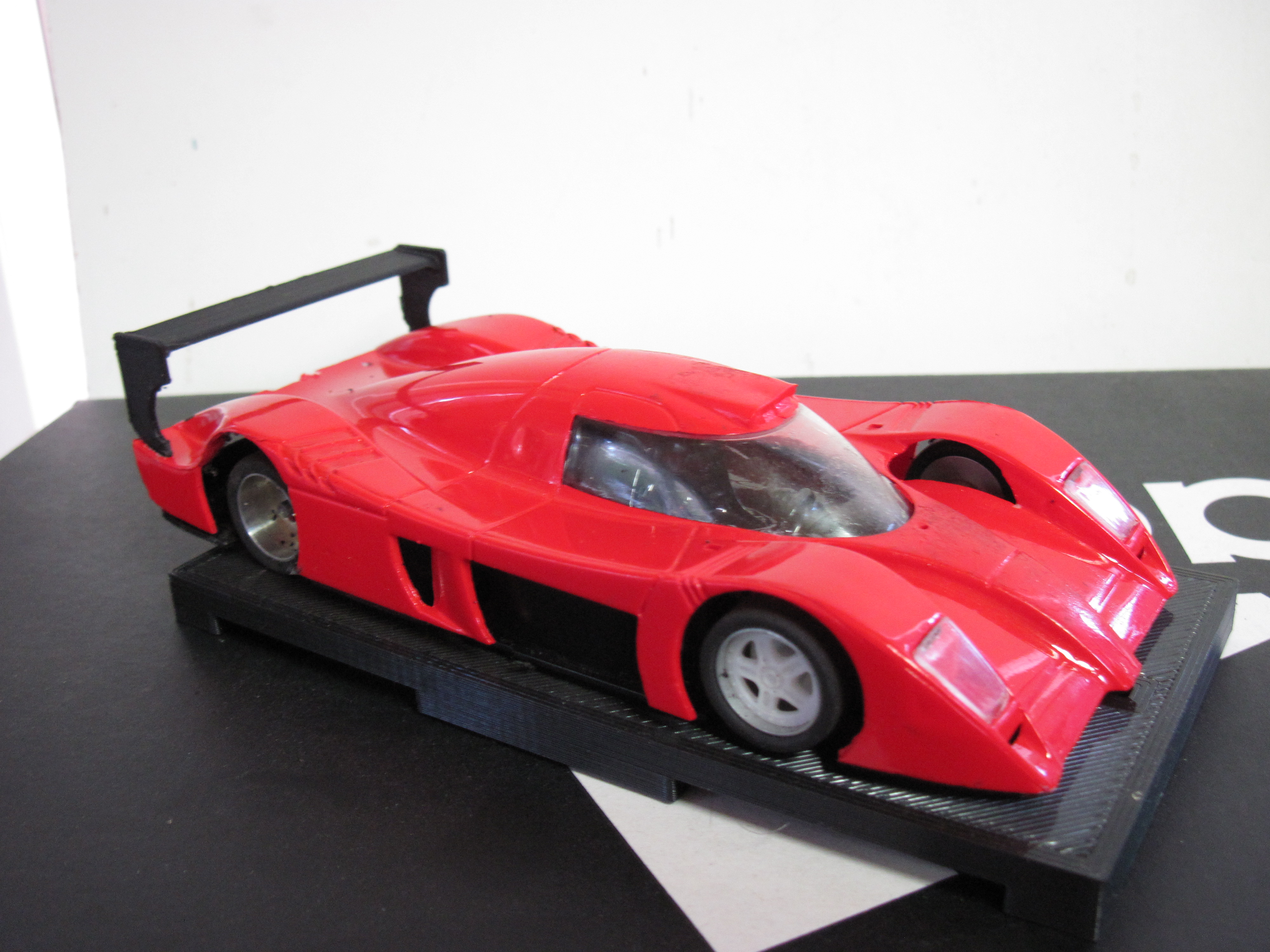

Some new wings to add to the range of F1, GT, & LMP cars.
Scaleauto Toyota GT1

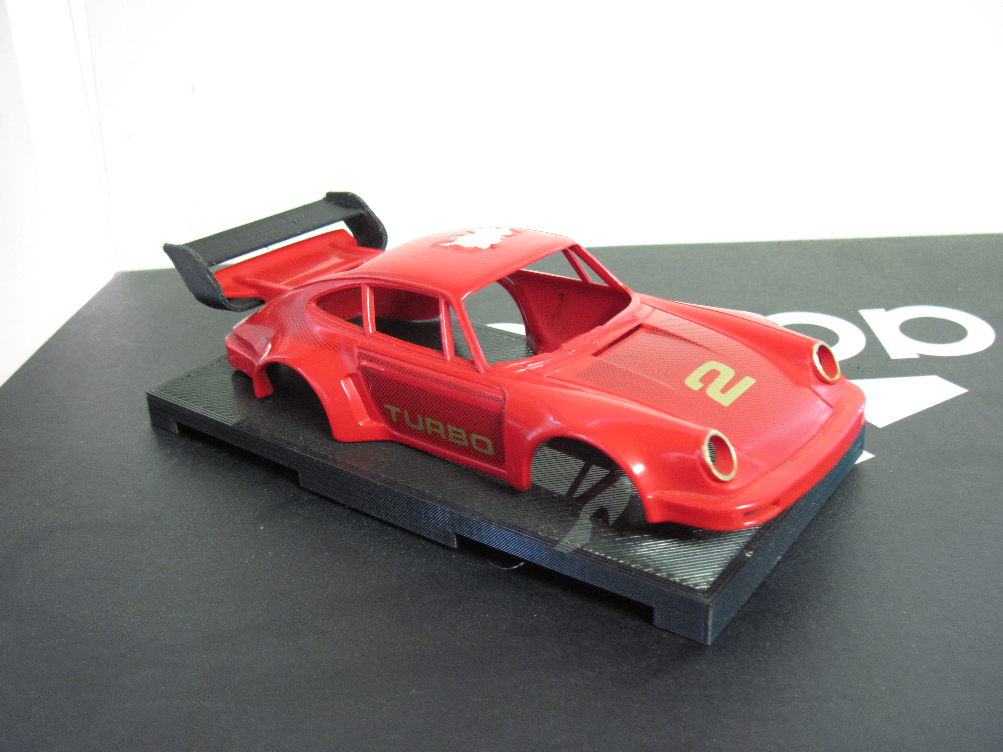

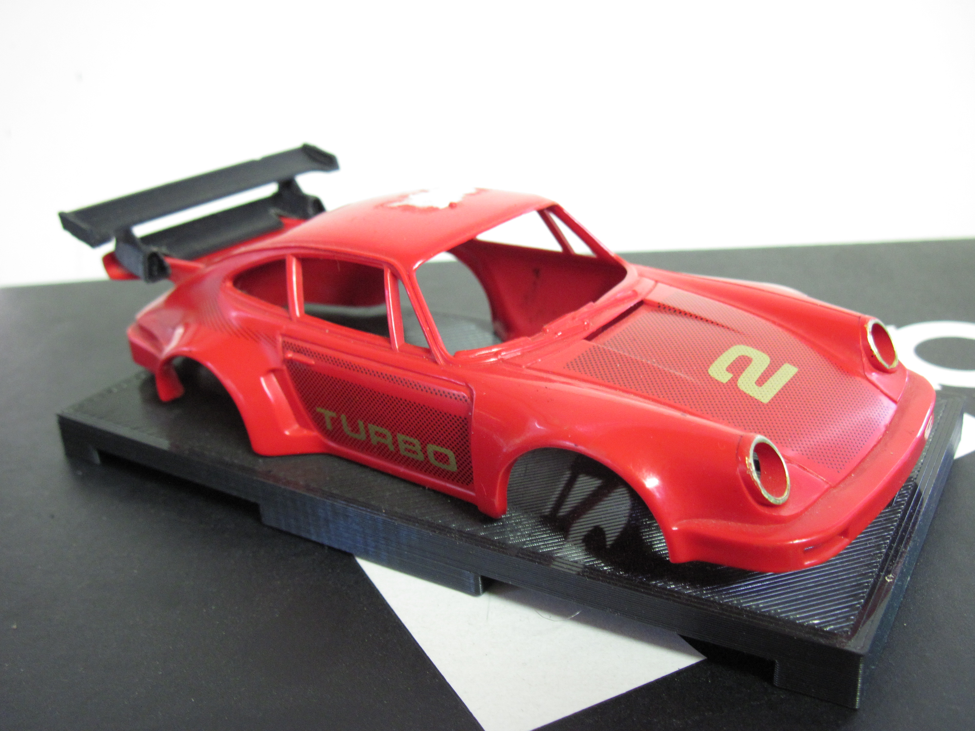

Alternative wing for the Scalex Porsche 911 70s shells.
And the current wing for the 911.
The Toyota and current 911 wings are one piece, the new 911 wing is in 2 parts, the base and the wing itself which is superglued in position at the desired angle of downforce.  The 911 wings can be glued on to the existing tea tray or the tea tray can be cut back and profiled to suit.

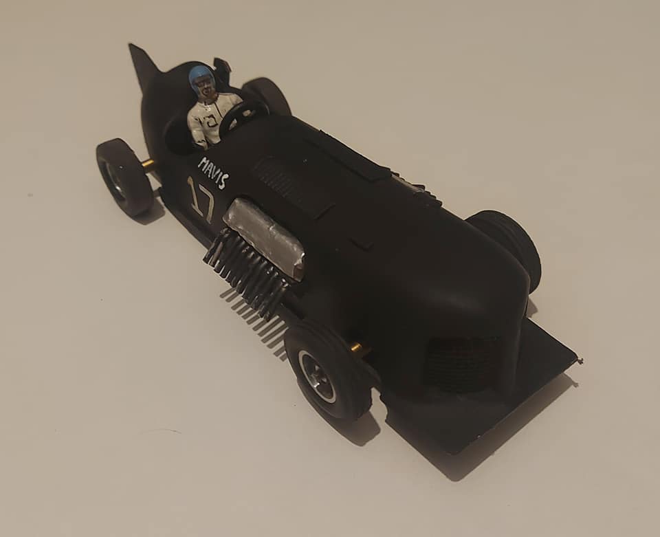

Back in Post 33 highlighted the front engine FC130 chassis for scratch built early GP cars, development has continued and at the recent Parson Park pre-war  race the chassis saw off the competition to come first in class 1.
Danny's MG (Resin shell by Tony Condon)
Front engine chassis from post 33
So congratulations to Danny Condon for the class 1 win and an honorable mention for Tony Condon bringing a JS Chassis SRKIT (Post 45) home in 2nd place in Class 2.

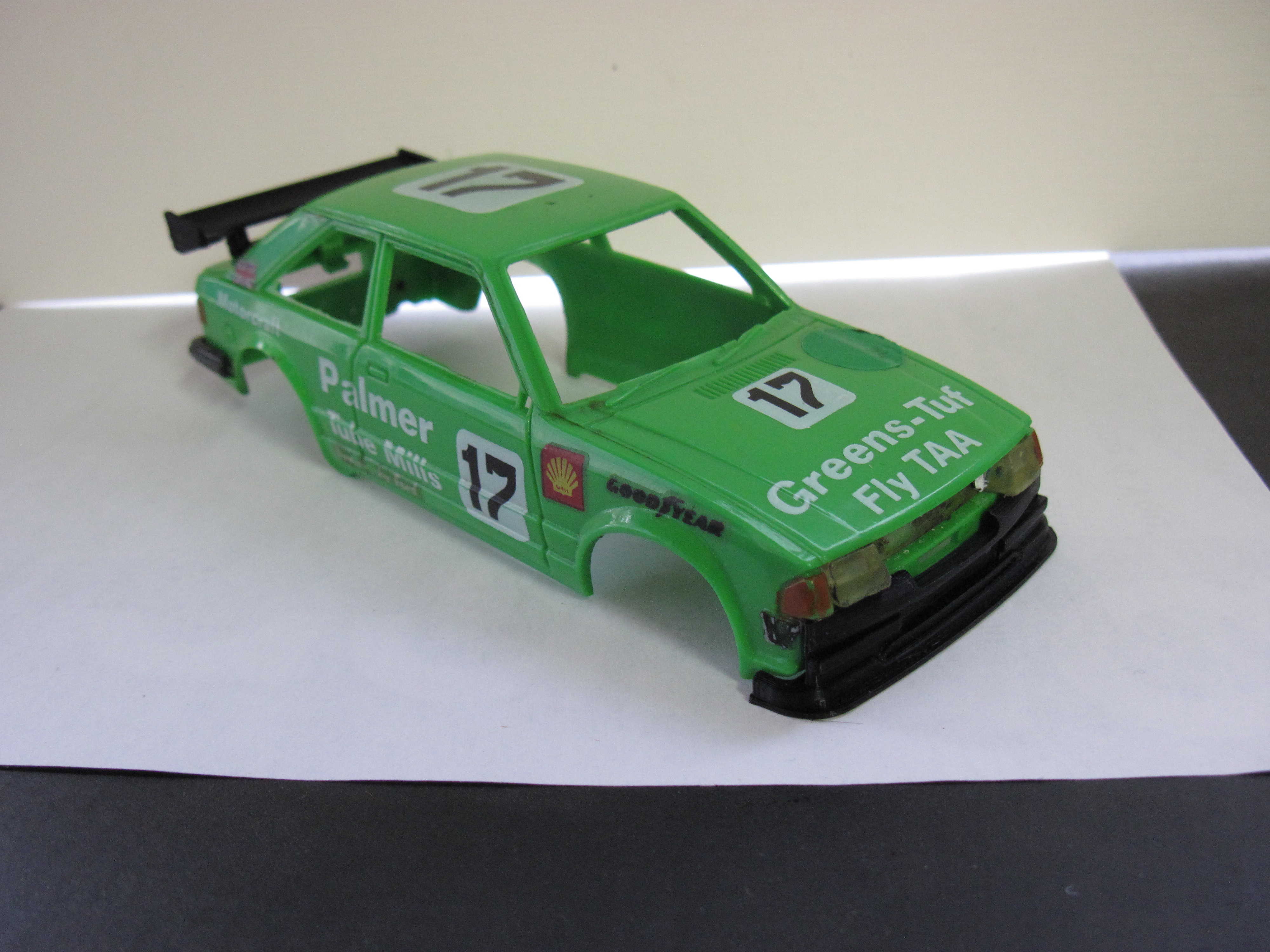

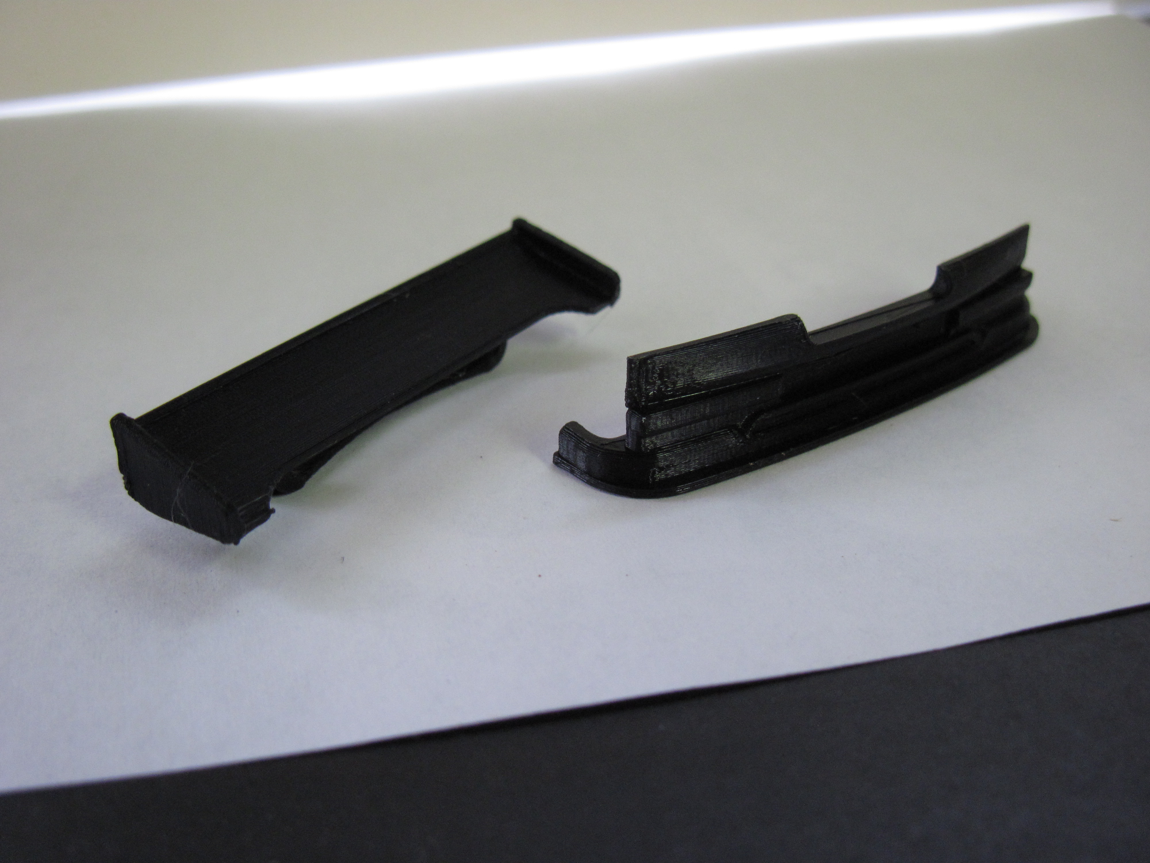

Wing and front dam for the Scalex XR3. Front dam glues to the shell with a dash of putty to blend in, the wing locates via 2 screws using the original peg holes. There is also a range of chassis' to go with this kit IL, AW & SW using the S can or Boxer (IL only) motors.

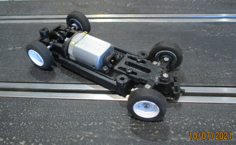

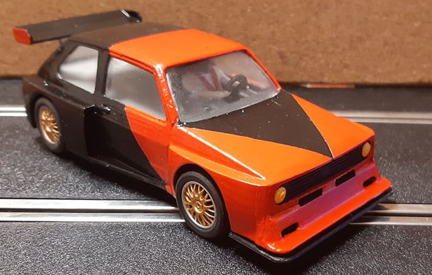

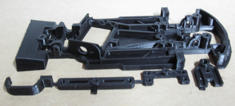

Golf Mk1 group 5 Shell with SW chassis. Chassis takes any of the can drive S can motors with fixing holes (NSR used here) and has a mix of torsion and coil spring suspension. Shell & SW chassis now available with printed interior driver/tray, and will add vac form glazing option at a later date.
SW chassis
Thanks to Nigel for building this up for me.

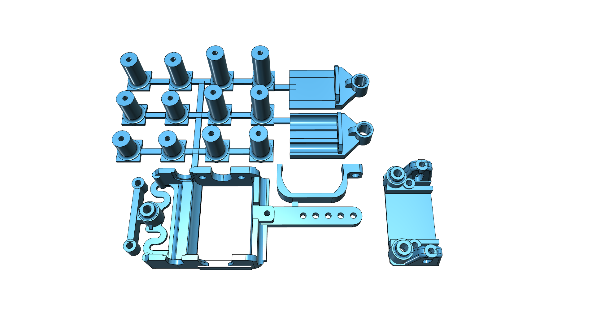

Design list and Bits box lists updated see page 1 for files.
Sneak peek at some new stuff coming along.
New steering front end option for the chassis' which includes the guide.

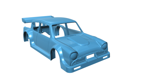

'Wanglia Supersport body, with a range of chassis' IL, AW and SW.
