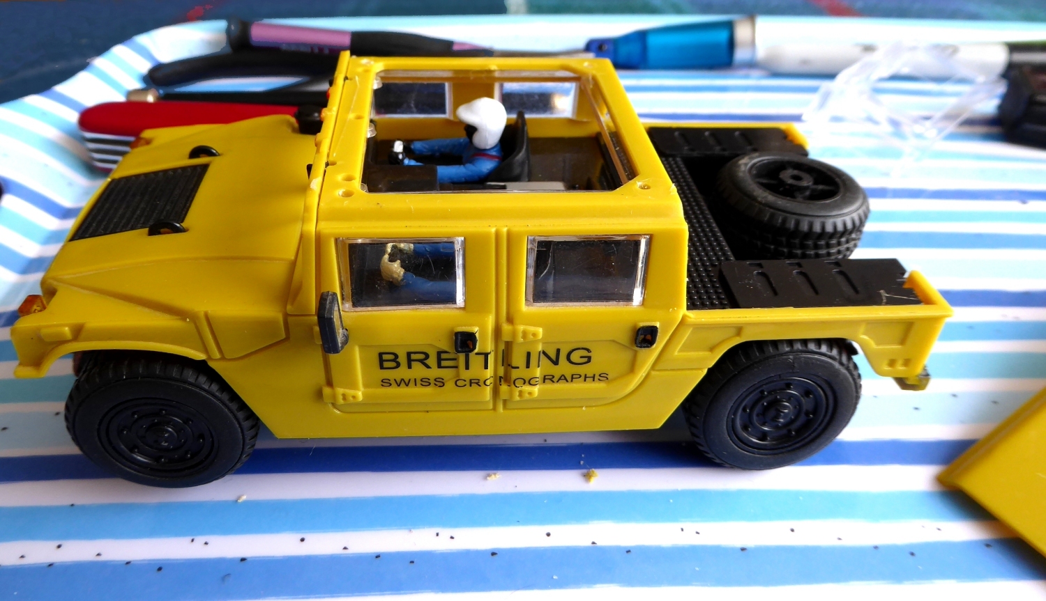

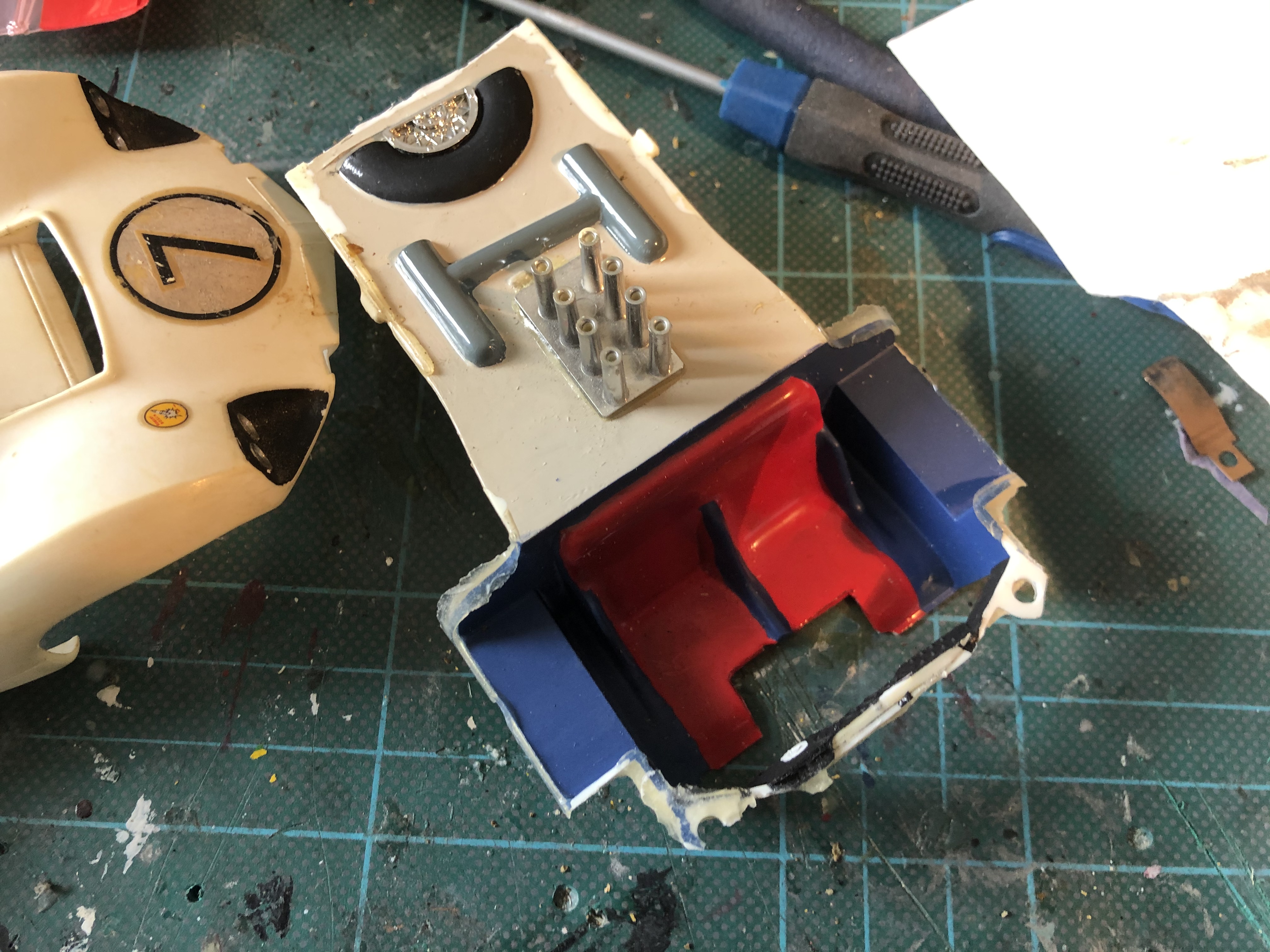

Well I did say the Hummer might end up on this thread  Bigsmile
The stretched 'station wagon' looks didn't do it for me, so I was hoping the interior would have the crew cab and pickup bed detail hidden under that l-o-n-g roof..... which was gently prised off using a penknife blade....and it was.  Thumbup The spare wheel was not, however. That shown is the loose offside rear, so only 'three wheels on my wagon'.
At this point I decided to address the loose rear wheel issue. Each is 'officially' a two piece plastic item, the wheel and a very deep push-in insert. However both wheels had broken up, one being in three pieces and the other four. With the inserts removed, easily pushed out from the back using a jewellers screwdriver, the wheels were reassembled using superglue. Once set and trued up  the wheel inserts were glued in permanently with solvent cement, to reinforce the assembly. It worked a treat as both are now a VERY tight fit on the rear axle. Only mistake was to re-attach the tyres. I was going to spray the wheels silver. Not sure I dare remove them now. Probably will though.
The Hummer remained this way for several days as I lost my bottle and couldn't bring myself to cut it up - but ....... after stripping off the added detail - lights, bonnet vents, mirrors and personnel .......
.... I passed the point of no return, removing the tailgate/rear doors carefully with a Dremel wheel for possible re-use as the back of the crew cab. Side windows succumbed to a razor saw for potentially the same re-purposing, leaving the roof to be shortened - but that's for another day. I think I'll probably follow Powerslot's route though and install a windowless rear wall cut from plastic sheet, using the windscreen surround as a template to fit the roof contour.
Now - do those wheels come back off again or .... ?  Tappingfoot

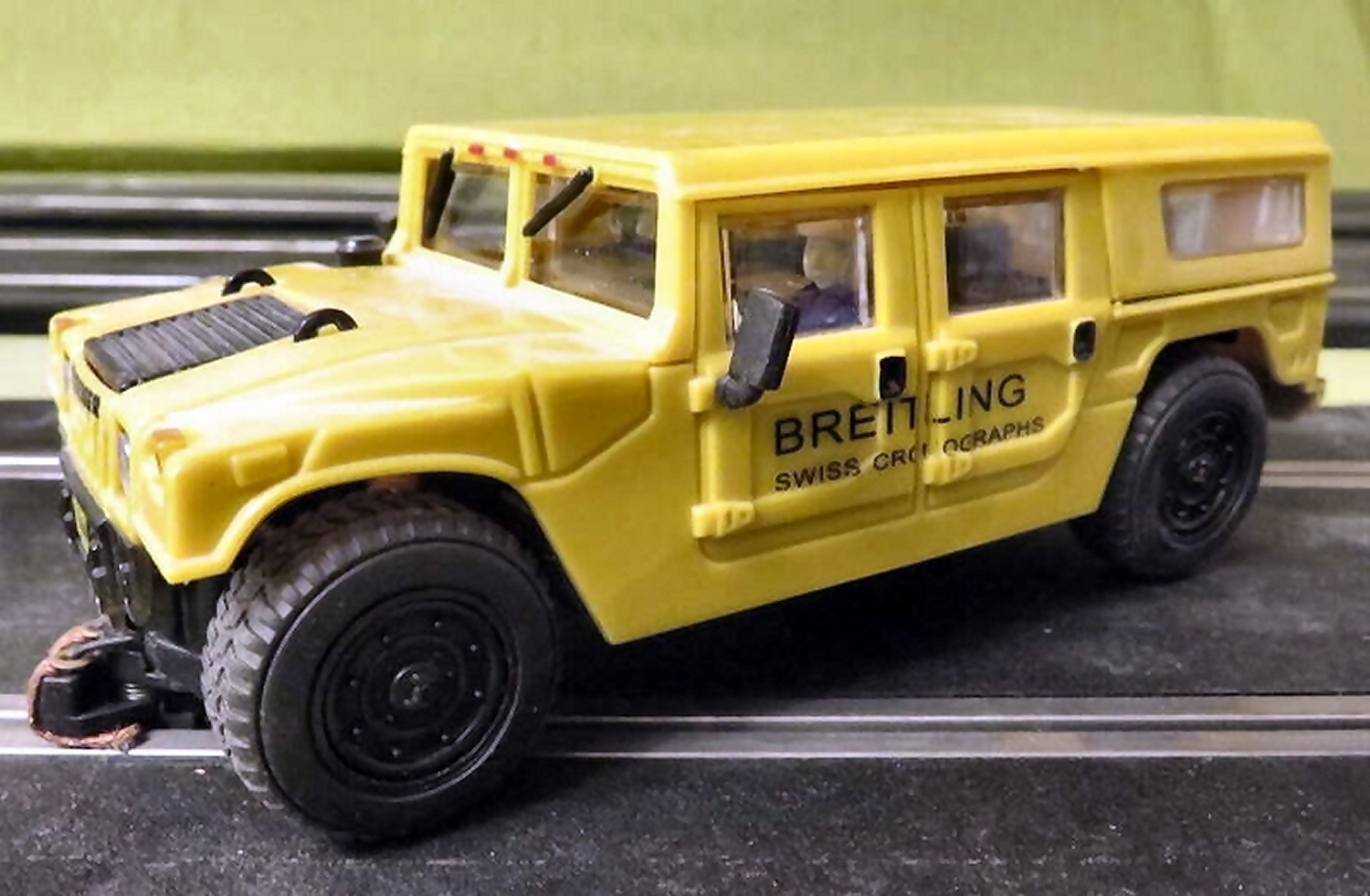

A few of my current jobs
An eBay find and sold missing one mud flap. Other than that it looked fairly sound, with mods only confined to the chassis. Nice to see on arrival that the seller had found and attached the errant mud flap. Bonus!
First thing to do was whip off the body and check it over.
Obvious issues were:
a) the driver was correctly on the right for this version - but the instrument panel was on the left.
b) both sets of side windows were coming away along the bottom edges and up the windscreen pillars
c) the windscreen was  becoming detached at one corner
d) at the same corner the screen and sideglass was slightly fogged, presumably from a previous attempt to secure them
e) one wiper was missing
f) both the front and rear spoilers were coming loose
g) the fog and spotlight array was detached
Tackled in the above order:
a) the interior tray was gently prised away from the body and the driver and navigators head, arms and torso were then 'popped' from underneath. (I know it is modelled after a right hand drive car but I just couldn't live with the Navigator sat behind the instrument panel while the driver had no gauges!) Fortunately the figures weren't stuck in. However, the steering wheel and binnacle were. These were gently prised out as a unit by inserting a small jewellers screwdriver into a gap, then twisting it.
The top half of the crew were glued back into their new positions, with the driver now behind the instrument panel on the left. Approximately 1/8" had to be trimmed from the steering wheel assembly to make way for the boss below the instruments and it too was glued in place. All this was done using GS Hypo Cement. oh - and the handbrake was realigned to match the new driving position.
b/c/d) All glazing was carefully edged away from the body to allow 'Glue & Glaze' adhesive to be wicked in. When fully set the fogging from a previous owners attempts to fix the issue was polished out using 'The Treatment' modellers wax. Fortunately the glass was just hazed, not damaged.
e) The single remaining wiper was removed. Happily it was used to complete the '33 Export' version I bought some time ago, which was missing this very wiper!
At this point the interior was reinstalled, using a good bead of GS Hypo Cement.
f) The rear spoiler was barely hanging on by a thread and was eased from the main body using a craft knife blade. The locating pins were undamaged so the spoiler's mounting surfaces were shaved smooth using the same blade, then it was reinstalled using the clear GS cement sparingly. The front spoiler was very firmly attached at one end, so the loose end was prised away sufficiently to get the GS's needle applicator in behind it. It was then allowed to spring back into its correct position and left to one side to set.
g) The fog/spotlight bar was tidied up at the back. Removing traces of old cement revealed the bases of the original mounting points, which were drilled out to accept fine brass rod, two short sections being superglued in to take the place of the previous plastic studs. The broken off studs were drilled out of the mounting holes in the body and the repaired unit pushed into place. Currently the lightbar is a tight push fit to allow removal for racing, although it may get superglued in place at some point.
Finally a triple zero sable brush and Humbrol enamels were used to spot in some of the previous owners race damage.
Apart from the driver/navigator swap, none of the other work is obvious. It all contributes to a tidier, more solid, bodyshell though - and at least I know it's been sorted  Cool

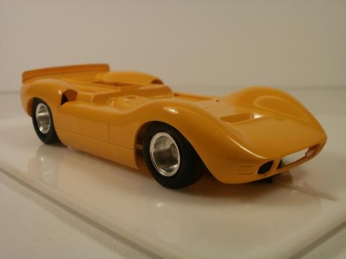

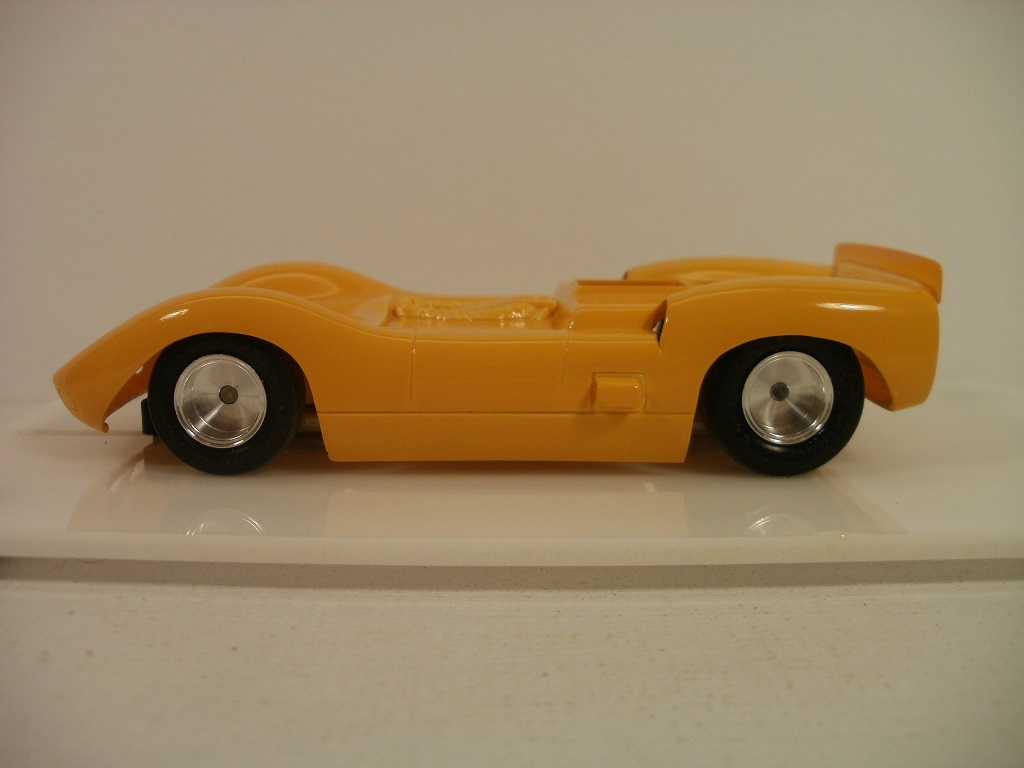

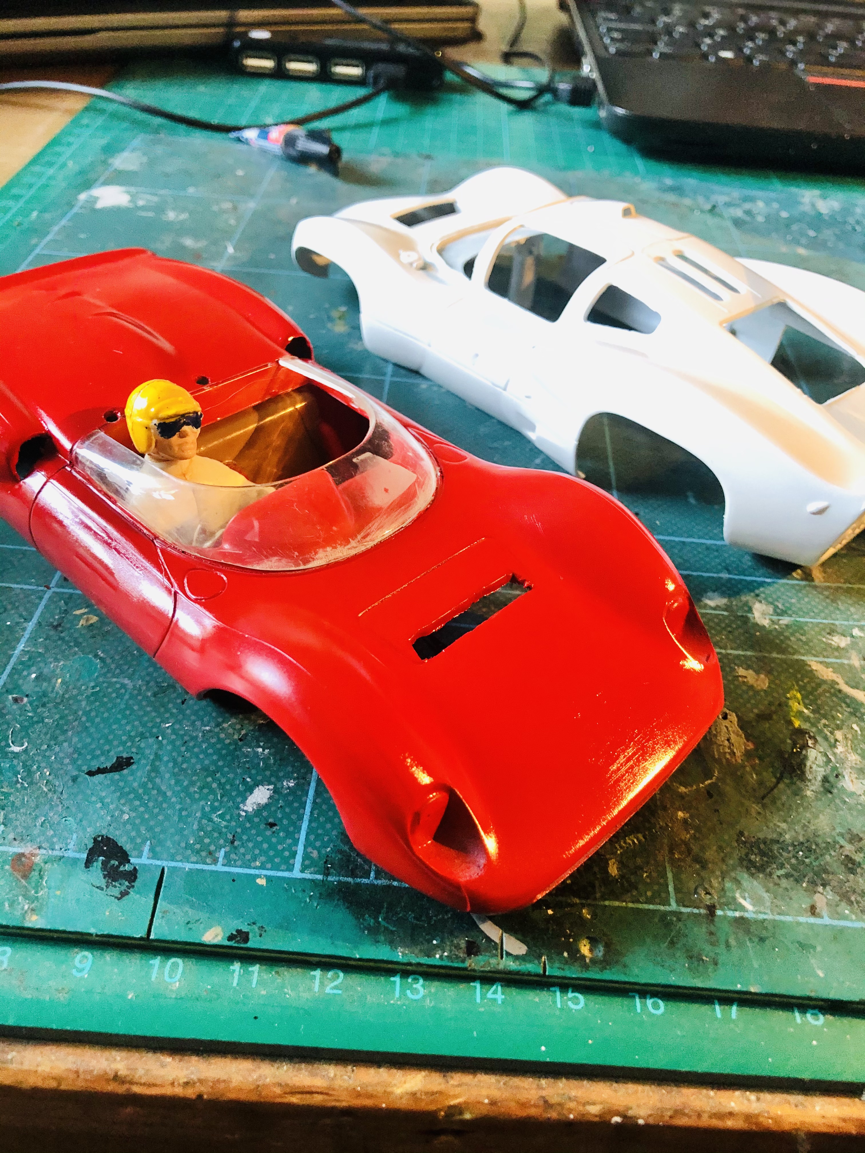

On the bench at the moment is a 1/32 McLaren M1B. It runs, but still needs all the body detail and wheel inserts. A proper build thread will be done when the car is completed.

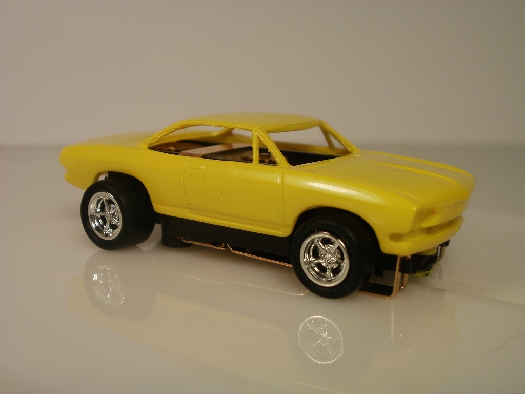

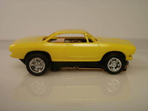

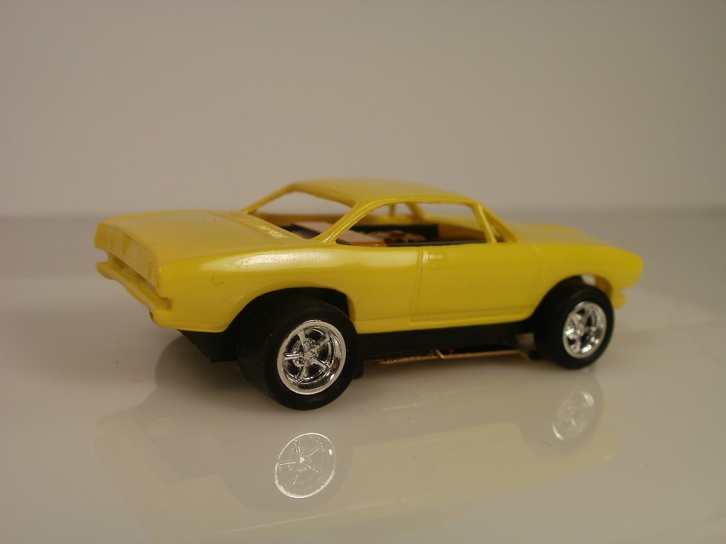

The HO side of the bench is also busy with trying to finish off various cars like this 1966 Corvair.
Did you do the yellow pearl paint Ken?
Hi Top Down,
Thank you very kindly for asking. The Corvair is plain Tamiya TS-16 yellow. And the McLaren is Tamiya TS-34 camel yellow.
Pastel yellow is one of those colours that rarely needs clear-coat.
Must be an optical illusion then. Highlights look pearlescent on the Corvair  Bigsmile
Ken what brand is the Mclaren? STrombecker?
