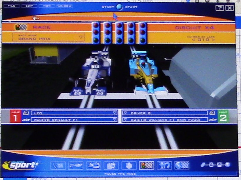

I set up a small test track earlier and tried a few things from the PC. Race formats and setting power on/off options worked ok.  The race formats all make sense but the user interface leaves me cold. I would like to see a clear count of laps completed or a countdown to finish but something odd happens after a few laps and the (tiny) lap count is removed.

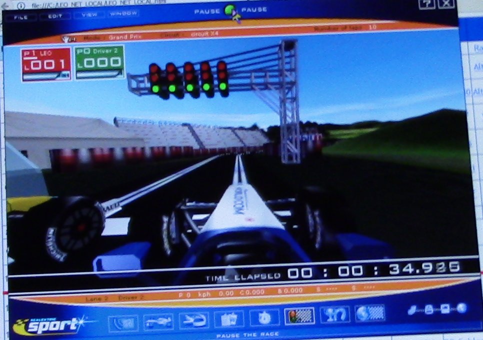

With a 10 lap GP race set up it starts well:
With one lap completed in Lane 1:

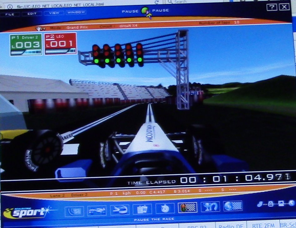

With 3 laps completed in Lane 1 and 1 lap in Lane2:

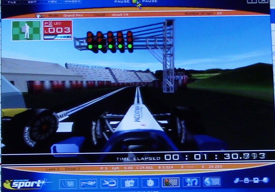

With 4 laps in Lane1 and 3 laps in Lane2:
With 4 laps in Lane1 and 4 laps in Lane2:

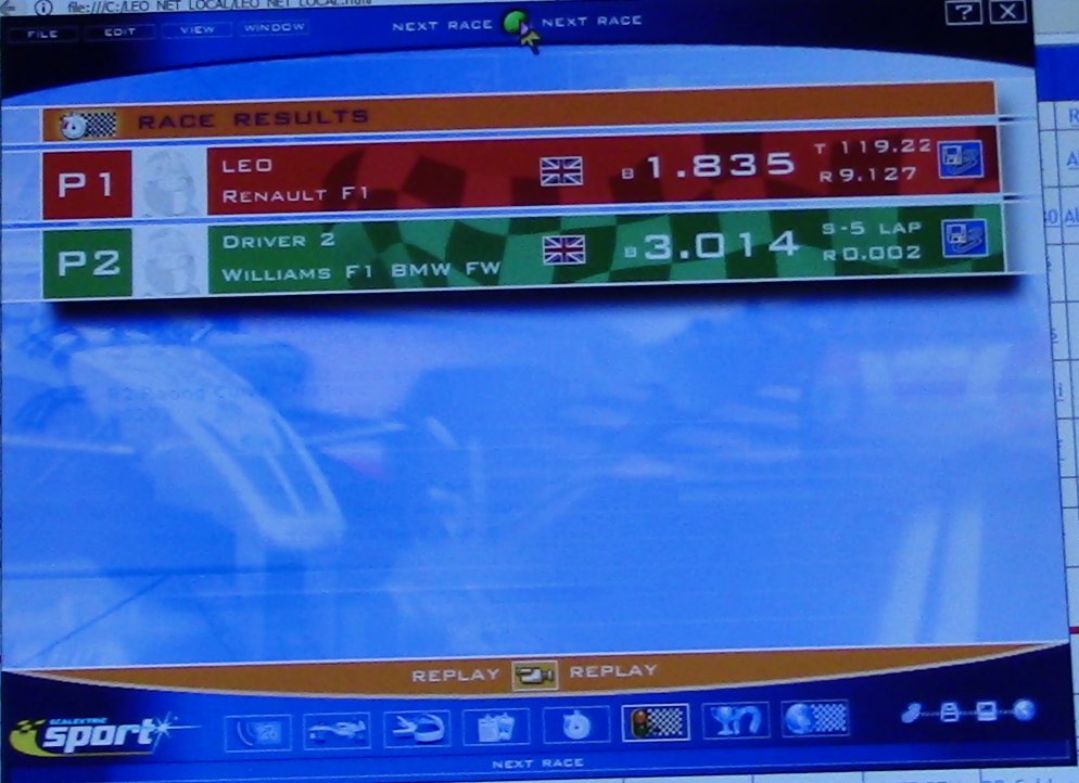

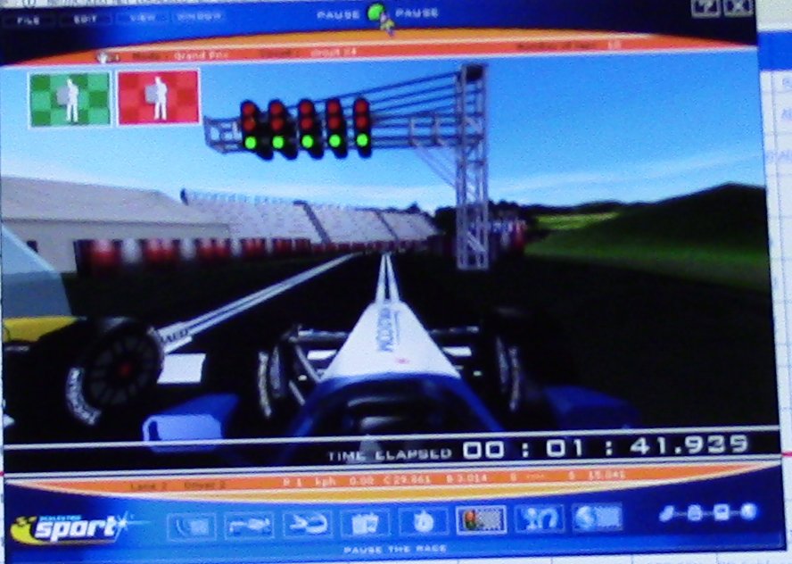

That is how it stays until one car has completed 10 laps:
The finish screen shows how many laps the 2nd car completed.
