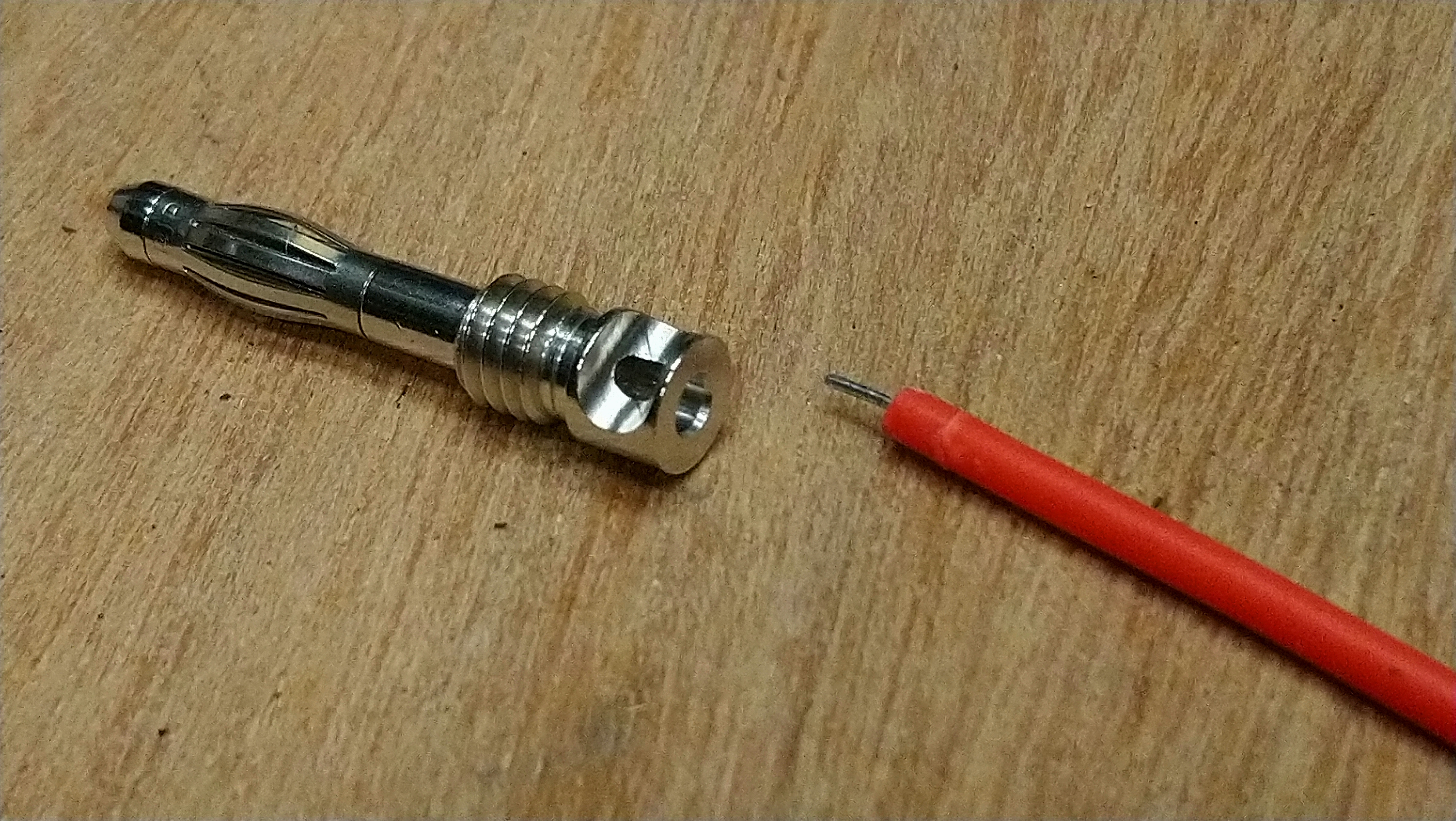

Any idea how I connect this wire to this banana plug?

If there's no screw/bolt to screw down and trap the wire, then solder it. Flux and tin the cavity on the plug - you'll need a hot iron and plenty of solder - tin the wire and then solder together.

Done!
Thank you.
