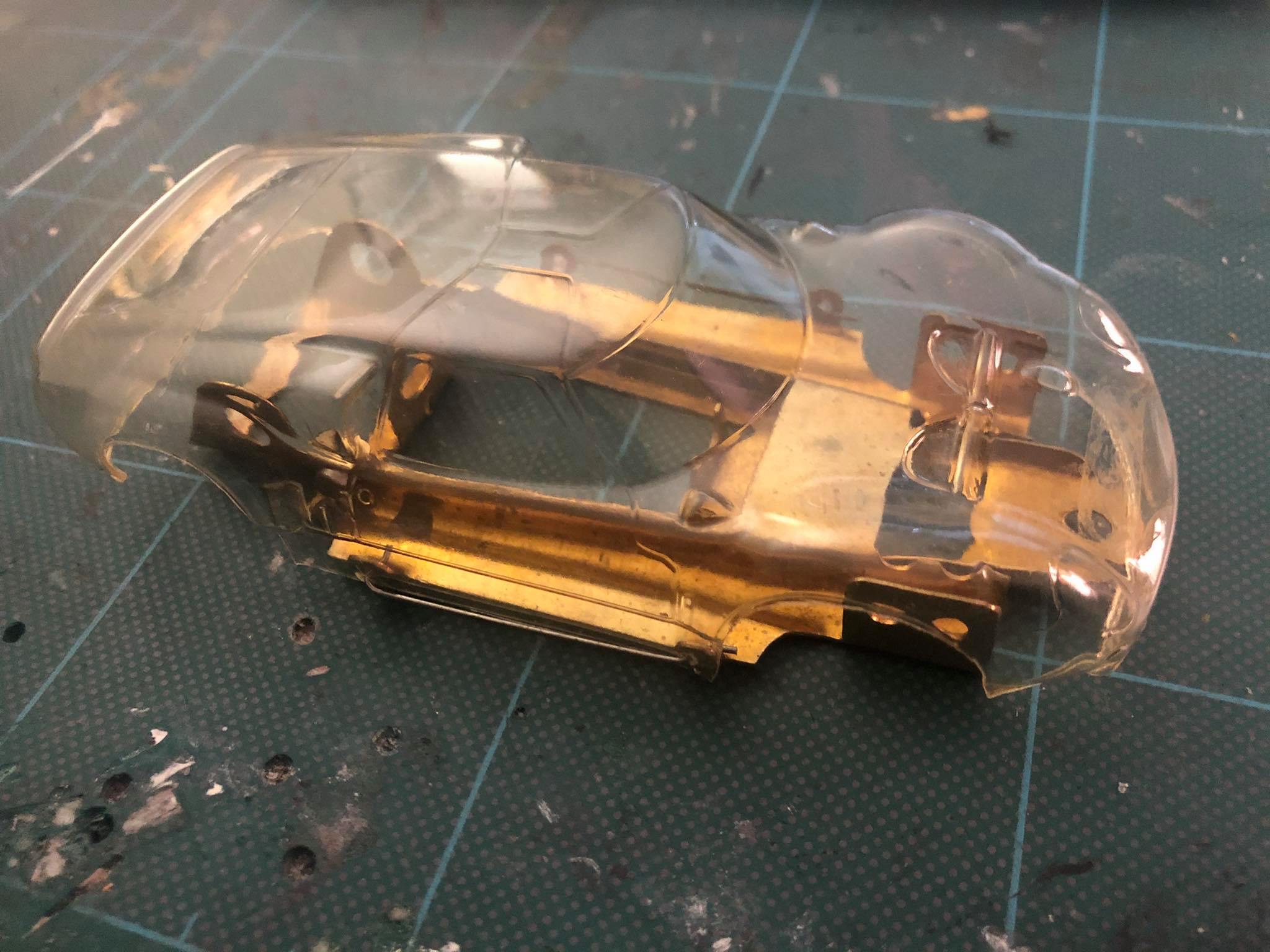

Spent a fruitful Morning finding chassis and fitting them to the bodies.
Henious Crime I know but I will be painting these on the Outside, Have attached the 1/32nds in the traditional manner with side clips, using 3 late 60's early 70's chassis I believe manufactured in Argentina. One is definitely a lil cuc Cox cloned idea for sure.
The 1/24ths I am going to use a system I have wanted to for a while - velcro. I have this super sticky stuff I got from Amazon (actually for my wife who never used it) that works well with removal and reattaching the bodies.
I have the paint and the decals - so after some more fettling to make everything fit,adjust wheel widths, add detail (like Carb stacks and exhausts etc) it will be away I go
1/32nds:
Lola M6 - Mecom
Lola t 70
Select Chappy 2 D
1:24ths:
Lotus 30
Chappy 2G - Lancer original
Honker - Lancer Original
King Cobra - Lancer Original
Matich - Lancer copy
Thanks for looking

Posts: 1,924
Threads: 175
Likes Received: 2,427 in 943 posts
Likes Given: 2,390
Location Overijse, Belgium
Progress...
