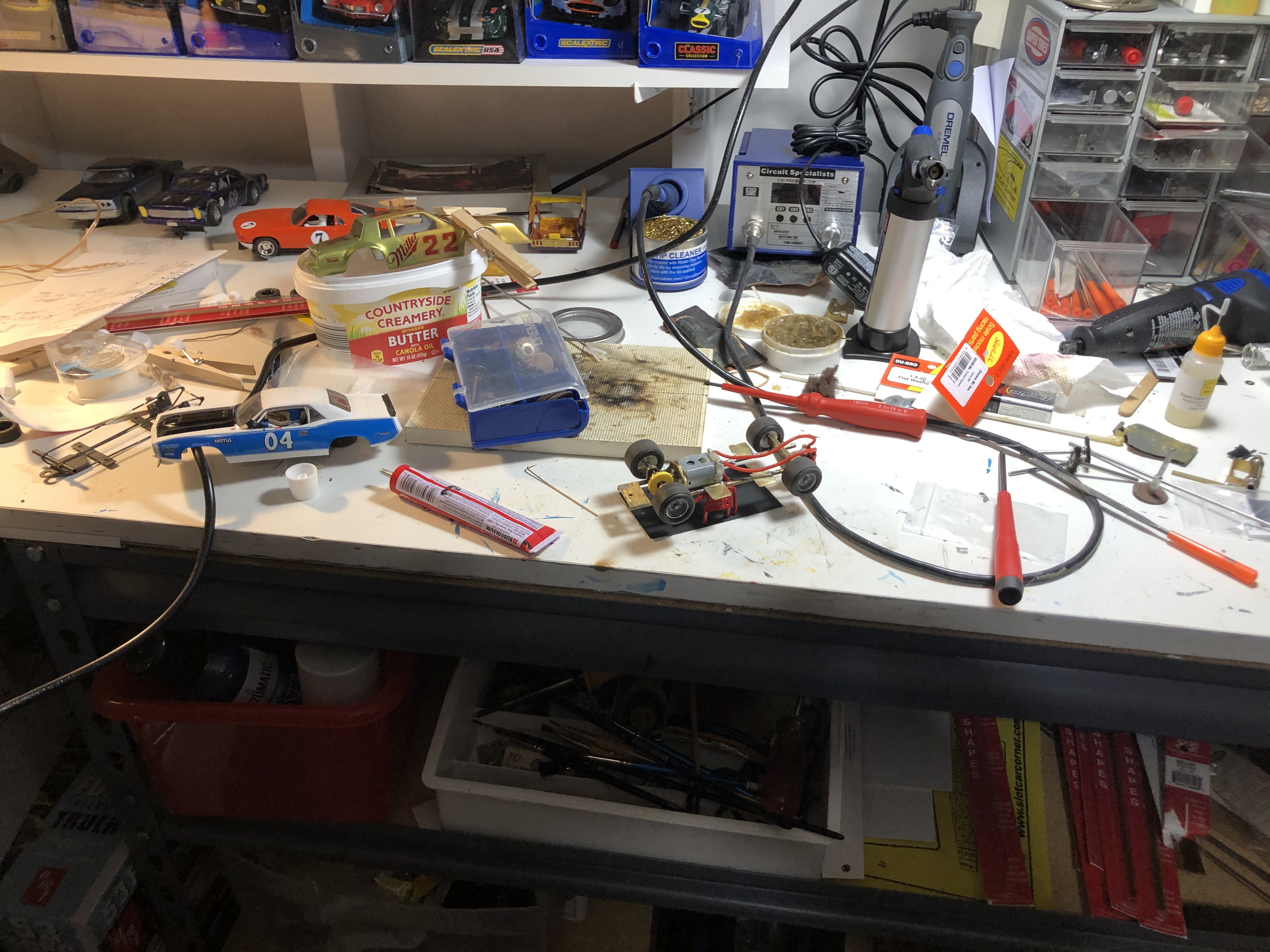

I’ll be organizing this mess after the caffeine kicks in; hence the multiple pictures. A messy bench is the sign of an organized mind.....that’s my story and I’m sticking to it

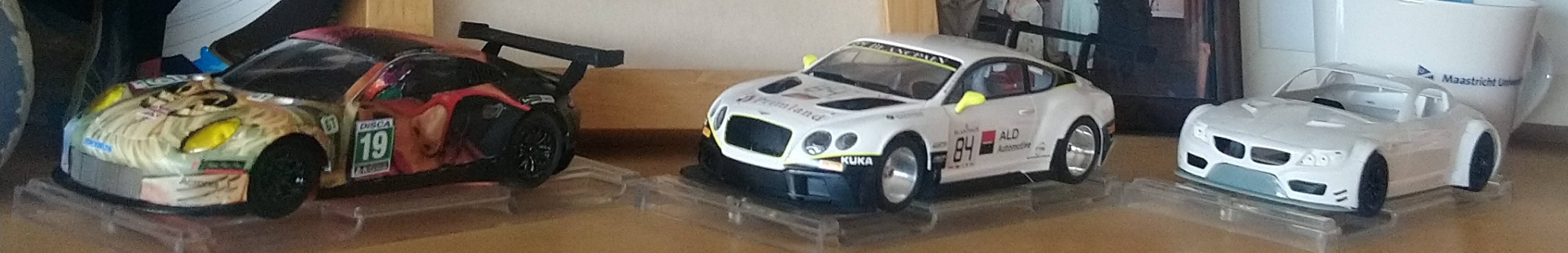

Not quite 'workbench', more like 'home desk''...
Some 'Work in Progress' GT3 cars for me to reflect upon when I lift up my eyes from the computer screens.
I love puttering with gears

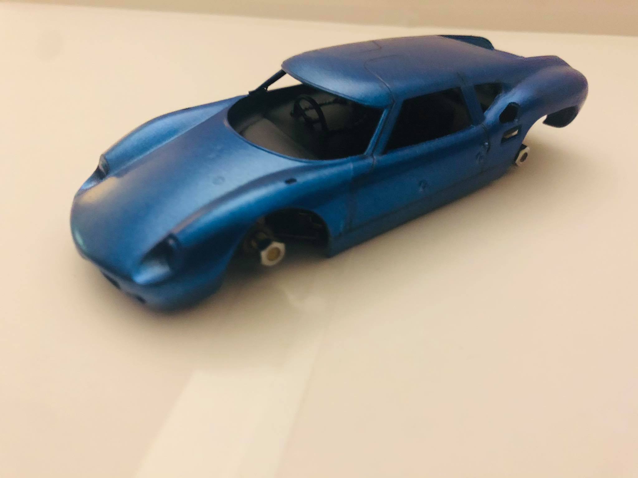

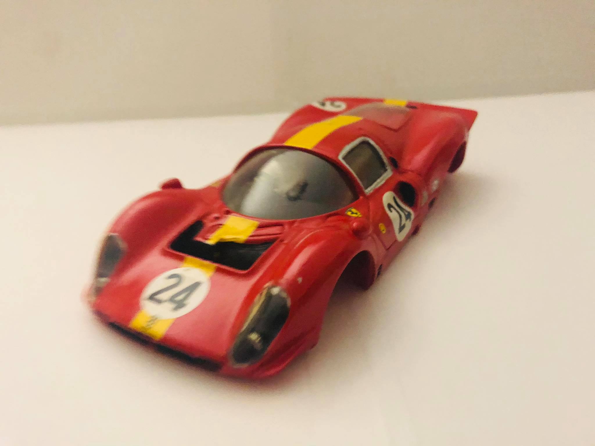

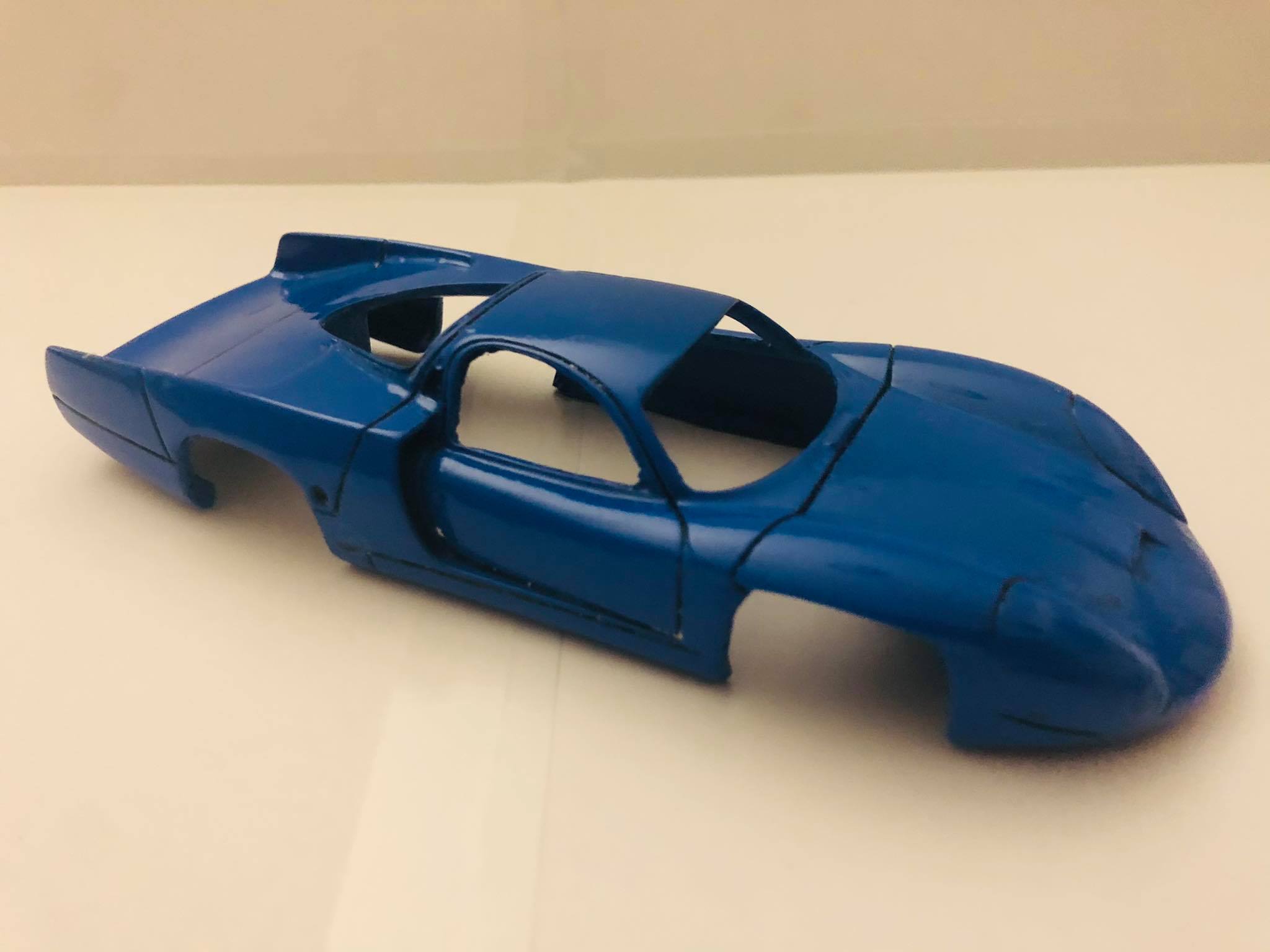

Just a few things on my bench at the moment Rofl
Picked these up very cheaply and yes I know they are oversized but the detail is just to die for Sun
So looking for sidewinder chassis for these :

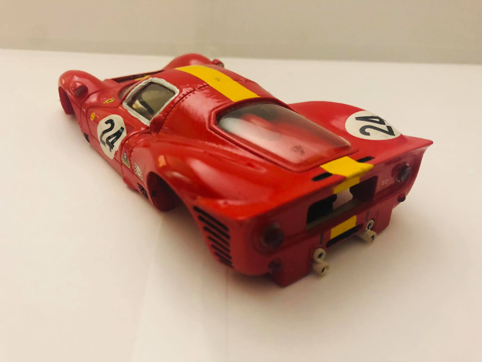

The P4 is an Ocar body that I built up at least 15 years ago and just never got to adding mechanicals. I have ordered quite a few Ferrari inserts so that I can finally get them done. That one will get a Slot it chassis that I have in my parts bin. The 275 p's will get BRM wire wheels, (one came with a Racer5 Chassis) and will need to investigate the 3L for wheels.
Some more being built - this is ready for decals and detailing and part to attach the motor:
The body and chassis are by John May (in our traders section)

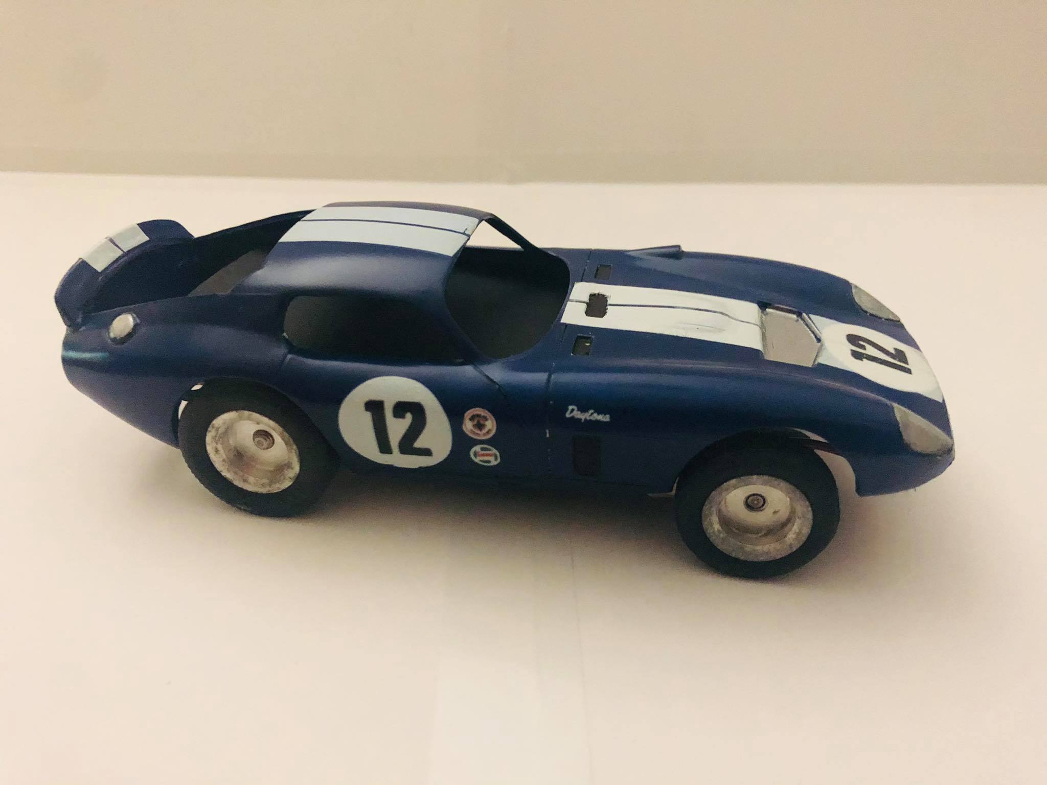

Building up another Cobra Daytona by Autohobbies:
Then two Classic slots bodies to be finished:
And lastly a Monogram Ford mk 6

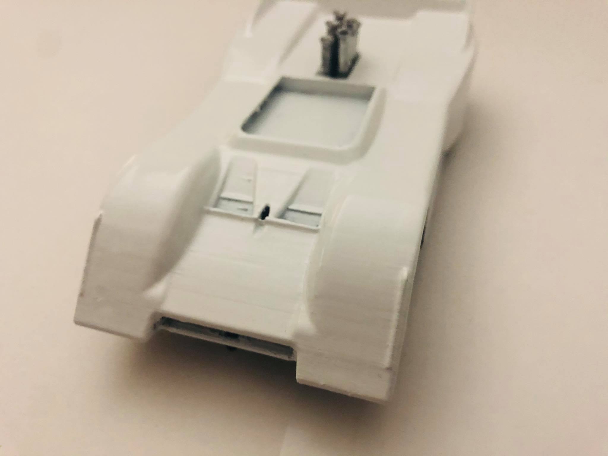

I have another Ford by Palmer painted and ready for decals and mechanicals
Enough to keep me going I recon?
Any suggestions for the Racer chassis's??

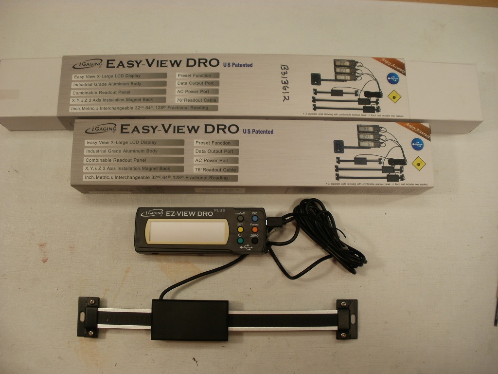

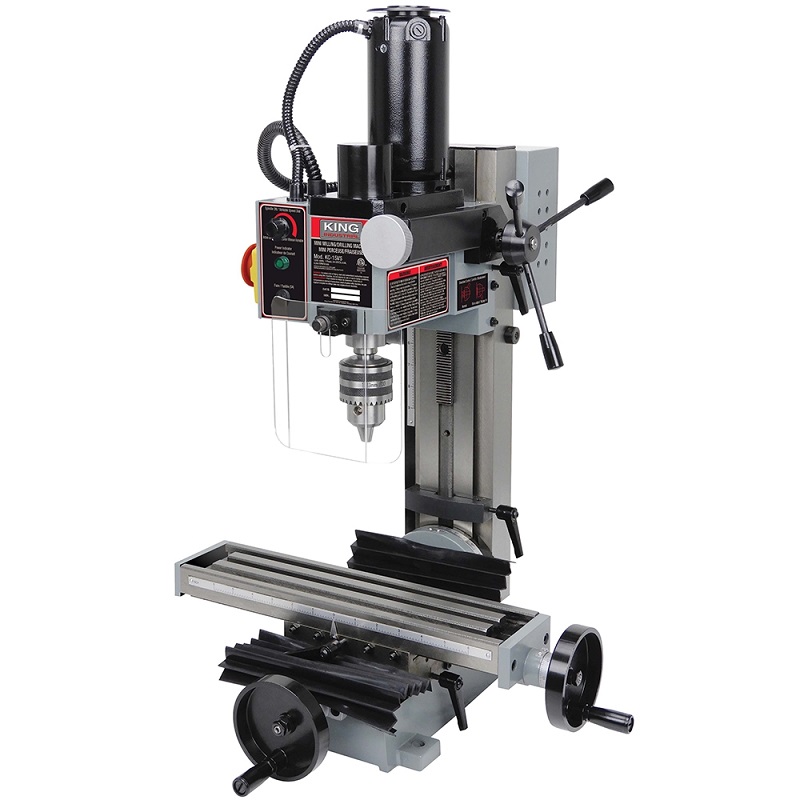

It's not a slot car. But it will help build slot car chassis's to an accuracy of plus/minus 0.001" of an inch. It's a mini-mill. I've added remote digital XY-axis read-outs to the table. Chassis building accuracy just went through the roof.
I work in automation. This will help my existing business, and officially open a slot car machine shop. Anyone want a very precise aluminum chassis?
It only weighs 135-pounds, and fits in my basement. It can turn a block of scrap aluminum or brass into a shiny new pod. An education and background in machining is highly recommended.

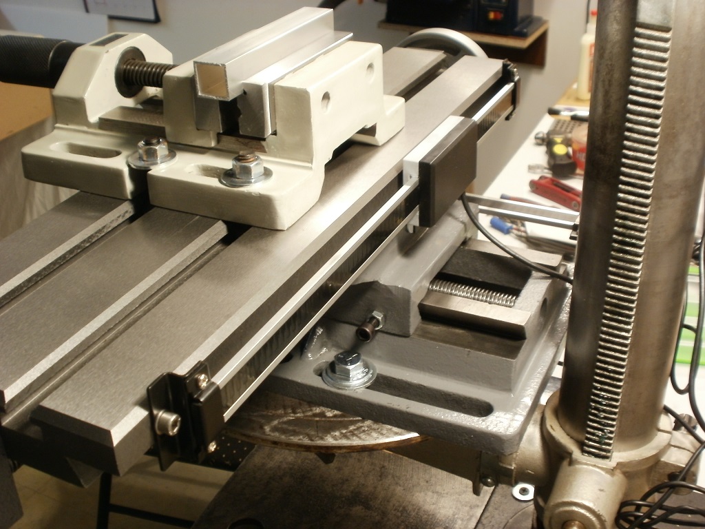

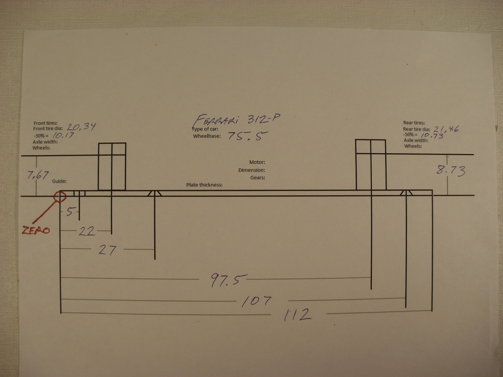

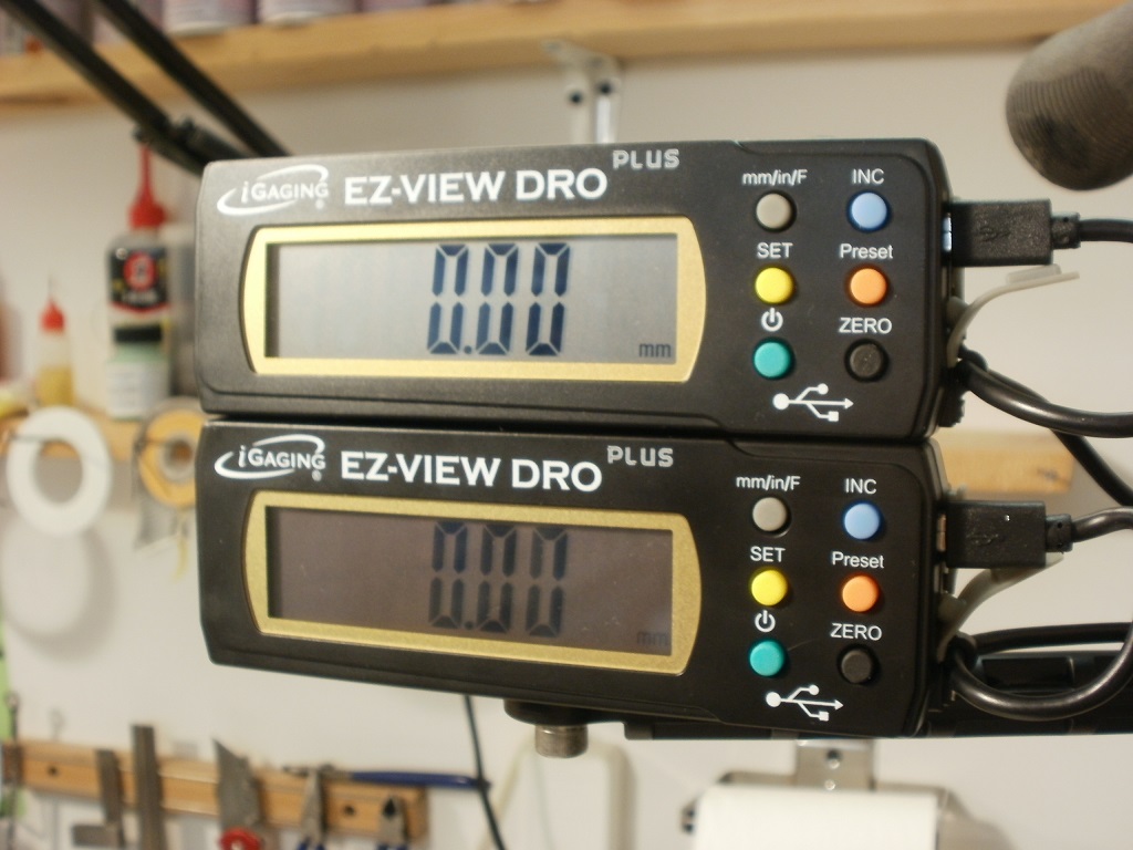

I have hit a road block in my building plans. The mill hasn't arrived yet. It was supposed to be delivered by Nov 15th. I have digital readouts sitting on my bench beside my old drill press. I don't want to scribe lines and do things by eye again. So I build nothing while I wait. Tapping my foot.
The machinery supplier was very kind and offered me a discount on something to hold me over. It's a large 6"x12" inch compound table big enough to fit the 6"x12" inch digital readouts. Now were talking. I made brackets to mount the readouts to my existing drill press. Now I can drill and ream holes as accurate as the readouts can provide (plus/minus 0.001" inch).
The readouts work exactly like digital calipers.
All my drawings since my first car were meant for digital readouts.
The vise has been trued with a dial indicator. The digital readouts have been set to zero to the inside corner of the jaw with an edge finder. Every piece of 3/4 square aluminum tubing that drops in goes to zero/zero straight away. It's a digital drill-press. Poetry in motion to a machinist.
