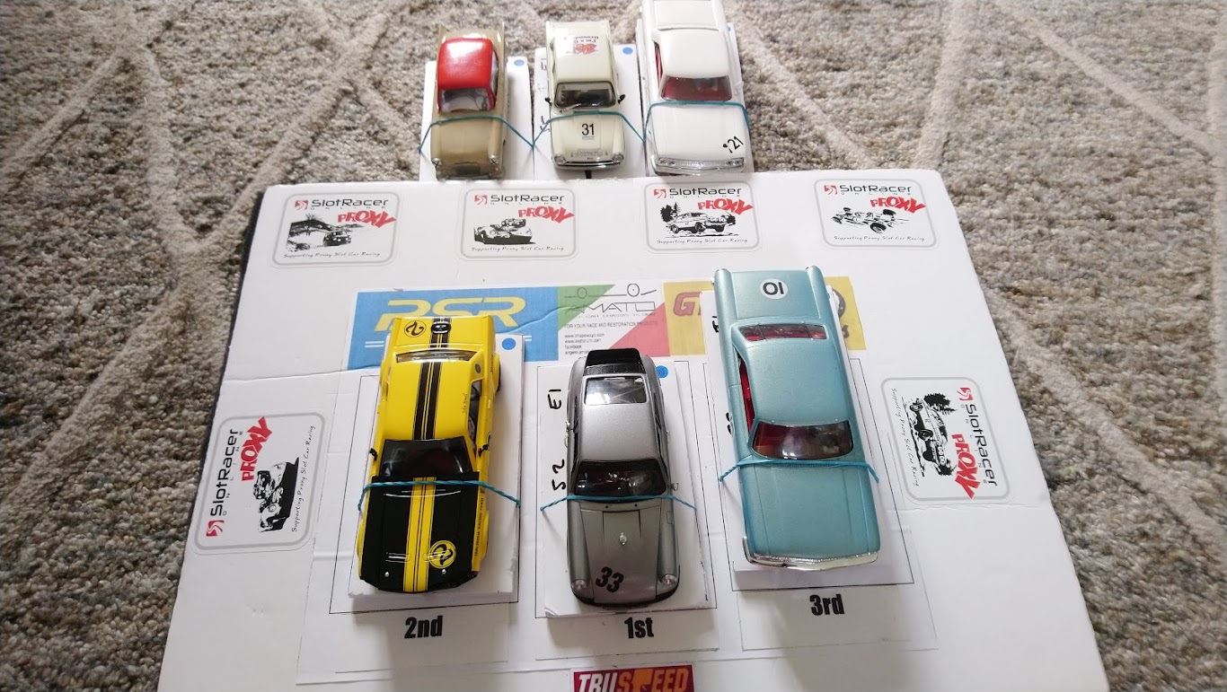

I have attached photos of the car packing order, to assist hosts replace cars back into the correct packaging locations.
And also the Hosts Briefing Sheet
These are found on the leading page of this thread.

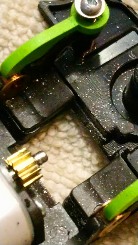

  • the most concerning of which is Brumos RSR BMW 2.8  The gearmesh sounds awful yet there isn't an excess of backlash BUT the car left a trail of aluminium dust all round the track that we called the 'silver dust of death' as it coats the tyres and reduces grip.  Its second race was gingerly finished but this car isn't going to finish the proxy without work.  We had to run cars of our own round for a few laps to clean up the silver dust before the next proxy heat.
The motor shaft on the SRC is fairly large, my guess is it is rubbing.  If it’s ok with our Race Director, Graham, I would be ok with minor work being done.  If power can be applied and lightly filed on the inside
 to reduce friction it would be greatly appreciated, I accept all penalties assessed by our Race Director for the repair.

I never saw the issue of the Brumos BMW during qualifying, so it makes me wonder if one of the rear wheel bearings has become dislodged from the chassis location ?

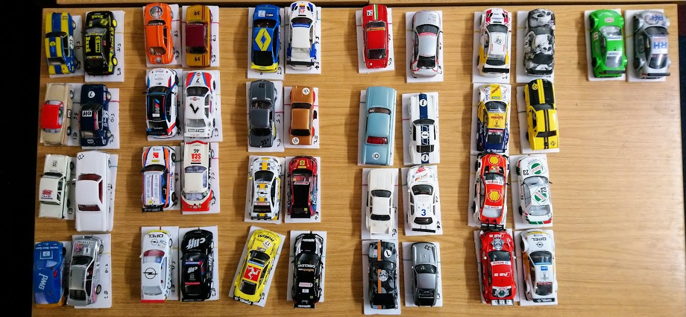

The cars were unboxed and laid out in pairs to run in reverse order with the quickest pair (on official qually times) racing together in the last two races.

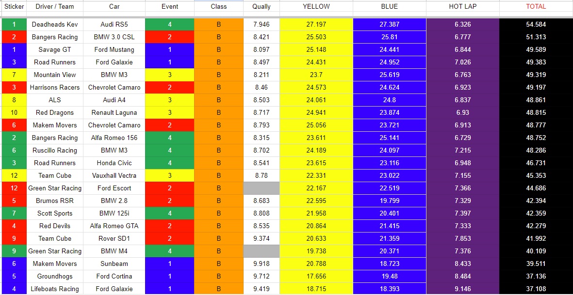

[attachment=31765]
[attachment=31766]

Event 3
[attachment=31769]
[attachment=31770]

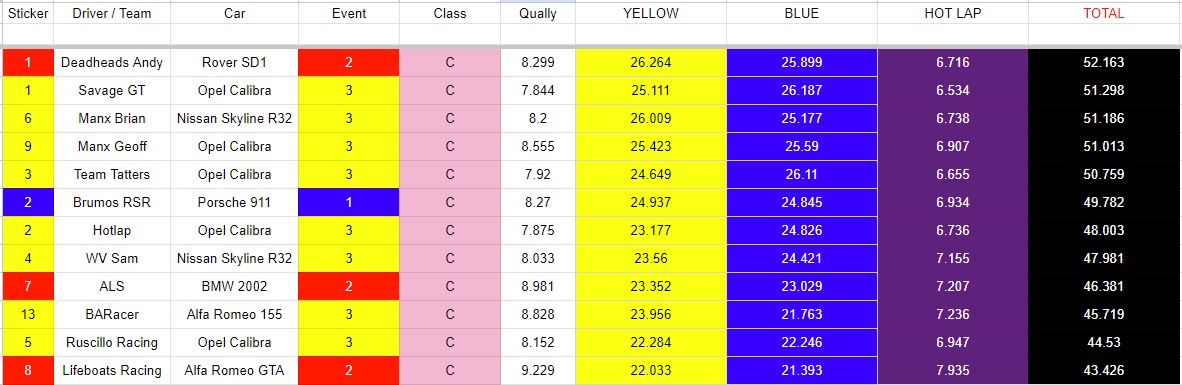

Event 4
[attachment=31771]
[attachment=31772]

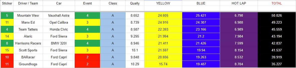

Class A
[attachment=31773]
Class B
[attachment=31774]
Class C
[attachment=31775]

Whilst packing the boxes for the 2nd time it was blindingly obvious that the process needed simplifying so all the cars have a numbered coloured sticker applied by Graham, this same numbered coloured sticker also appears on each cars base plate and on the included layer photos in the box.

What was the issue with Brumos BMW ?
RE: Touring Cars Slotting - Official Results & Reports - Kevan - 10th-Sep-23
(10th-Sep-23, 05:43 PM)Graham Wrote:
(10th-Sep-23, 05:26 PM)Kevan Wrote:  All three cars fixed ready for round 2  Thumbup
Aluminium pickup on the motor shaft, typical setup with an inline crown.  I've cleaned the motor shaft and lubed the groove.  Thankfully the crown teeth look undamaged....caught it early!
