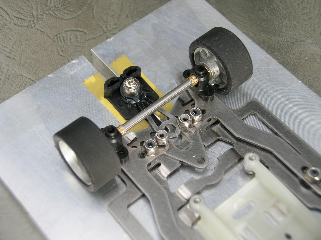

A new chassis from MRSlotcar should hit the shelves during the first/second quarter of 2022, one that will work with either "hard" or lexan type bodies. (The chassis will be a separate kit, and will not replace the chassis' under the RTR cars from MRSlotcar.)
It is still in the final design stages, with lots of variations being tried,..those variations centering around finding an appropriate amount of torsional flex.
To that end, I have been really hacking up a pre production model.........using various length and thickness center pivot rods, The particular car in the picture is likely close to the final design, and while this version is for lexan type bodies, a separate top plate will be available for mounting "Hard" bodies. Additionally I have suggested that the MRSlotcar adjustable front axle block be used, and an adjustable guide tongue be utilised..and, both these features will be incorporated into the final design.
In its current state (as pictured) it is running on sponge tyres, and on the MRSlotcar commercial track it runs away from anything plastic..........I will be doing some more modifications in the next week or so on the Policar track to assess/maximize its performance on plastic with urethane/rubber tyres.

Still working on potential options.............one option is to use foam blocks glued to the inside of the body and then an "L" shaped bracket glued to these blocks, and screwed to the chassis plate. This is common on the Plafit type chassis of both 1/32 and 1/24........works very well.
This option will require a completely redesigned top plate, and "L" brackets.
The second option is to build some mounting holes into the chassis plate, which will then be screwed to typical body posts............either way,  the existing body posts will likely not line up, and will either need to be moved/added.
Chris Walker
