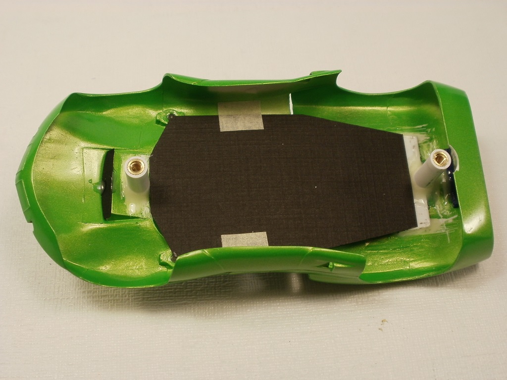

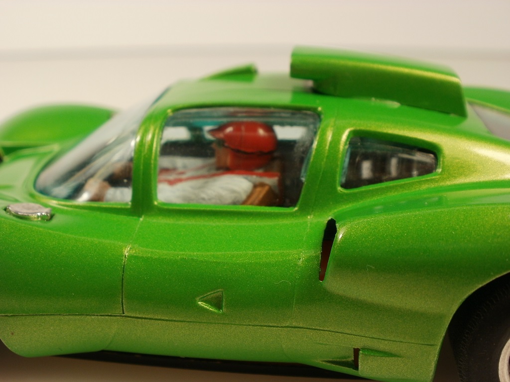

Cool looking body. 40-grams is a bit heavy. It's easy enough to make a lightweight card style interior. How much does the body weigh without the interior and 4-screws that hold it in? Interiors are simply top-heavy excess weight. All you need is a small piece of black cardboard from a craft store, driver, and steering wheel. And some masking tape to hold it in.
The Strombecker interior was very heavy in the car below. The driver, steering wheel, and injector stacks were cut from the original interior and glued to the cardboard.
[attachment=12631]
[attachment=12632]
I look forward to seeing how you finish this cool looking Mustang.
