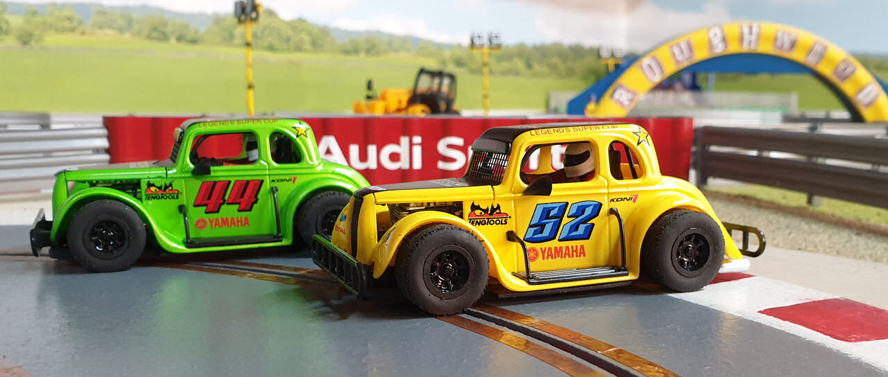

End result compared to stock, subtle but certainly lower.
[Image: XzSyBZb.jpg]
And a couple of shots with less tyre outside of the arches, I plumped for a 61.5mm front track 62mm rear track compared to the stock 65mm all round.
[Image: UWSpzbS.jpg]
[Image: CMs5qyO.jpg]

And finally, something closer to the style of the original wheels  Checkeredflag
[attachment=12660]
