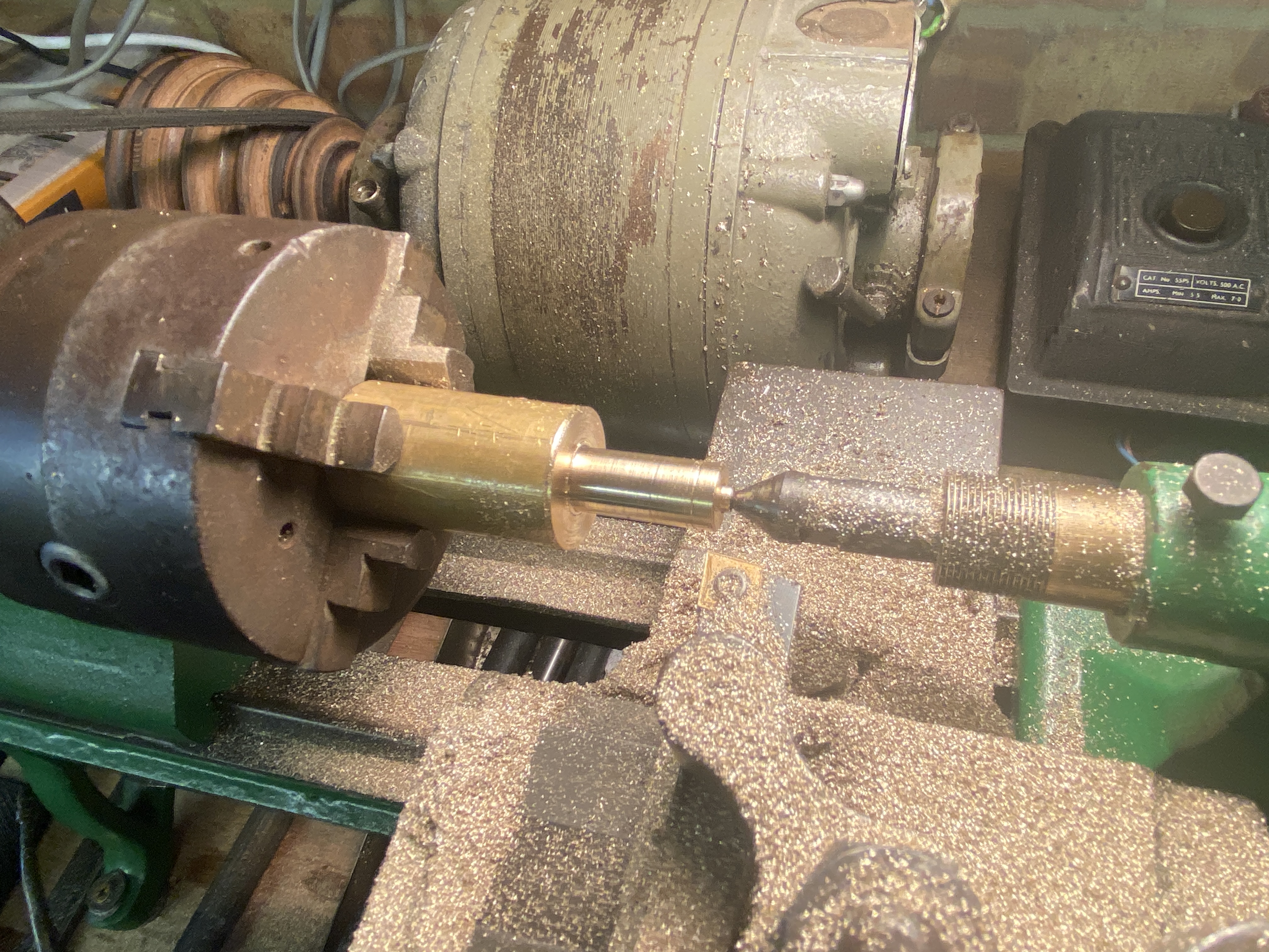

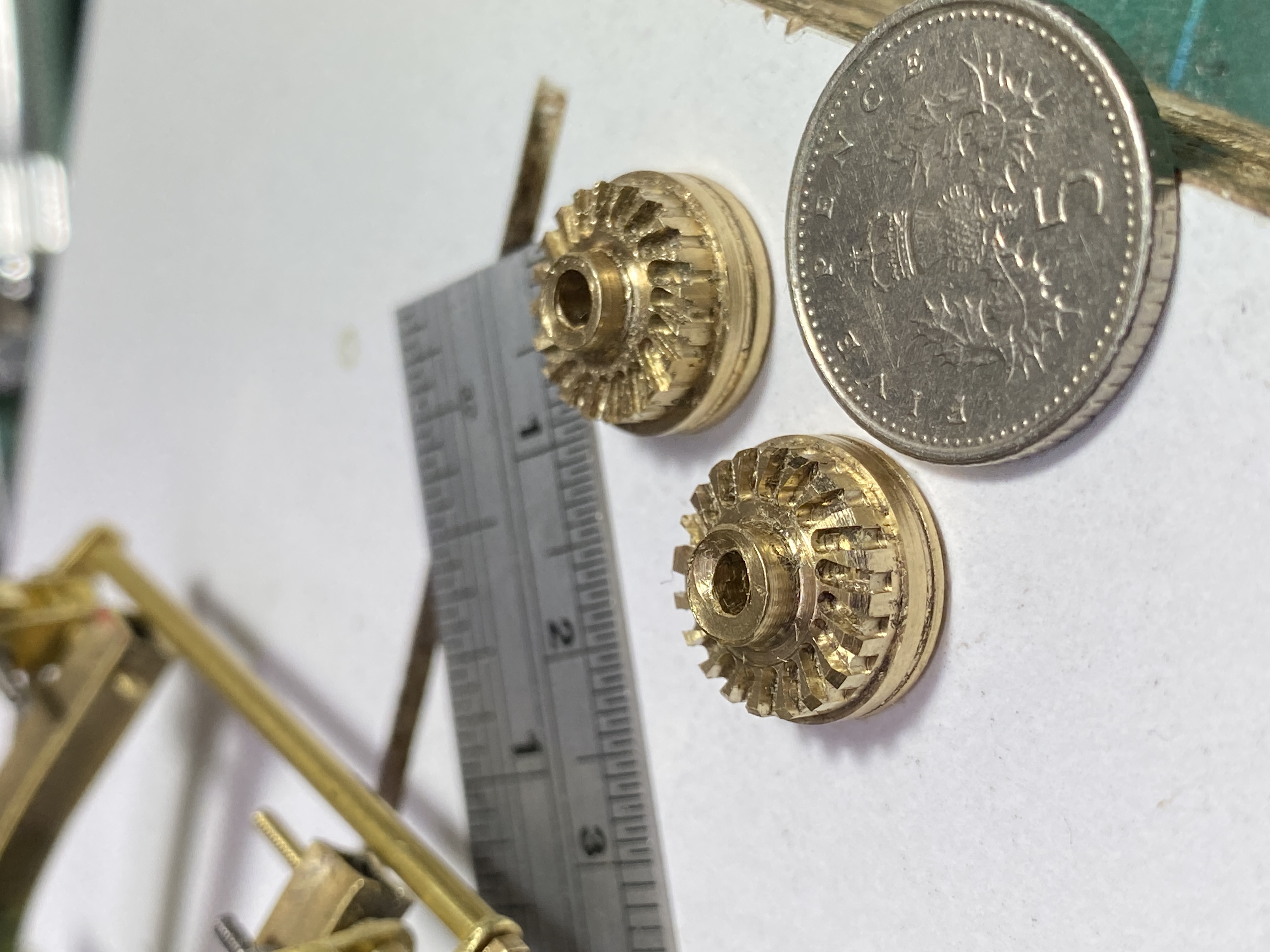

Tonight I've just finished making the fake drum brakes which I'm pretty happy with considering I'd never used a Milling machine before, boy these little Proxxon's are lovely machines. I got mine really cheap as a lady brought it thinking it was more a pillar drill. Wrench
For the drums, I turned some brass and drilled the 3/32 axle hole, machined the little groove and then decided I wanted to try and machine some fins.

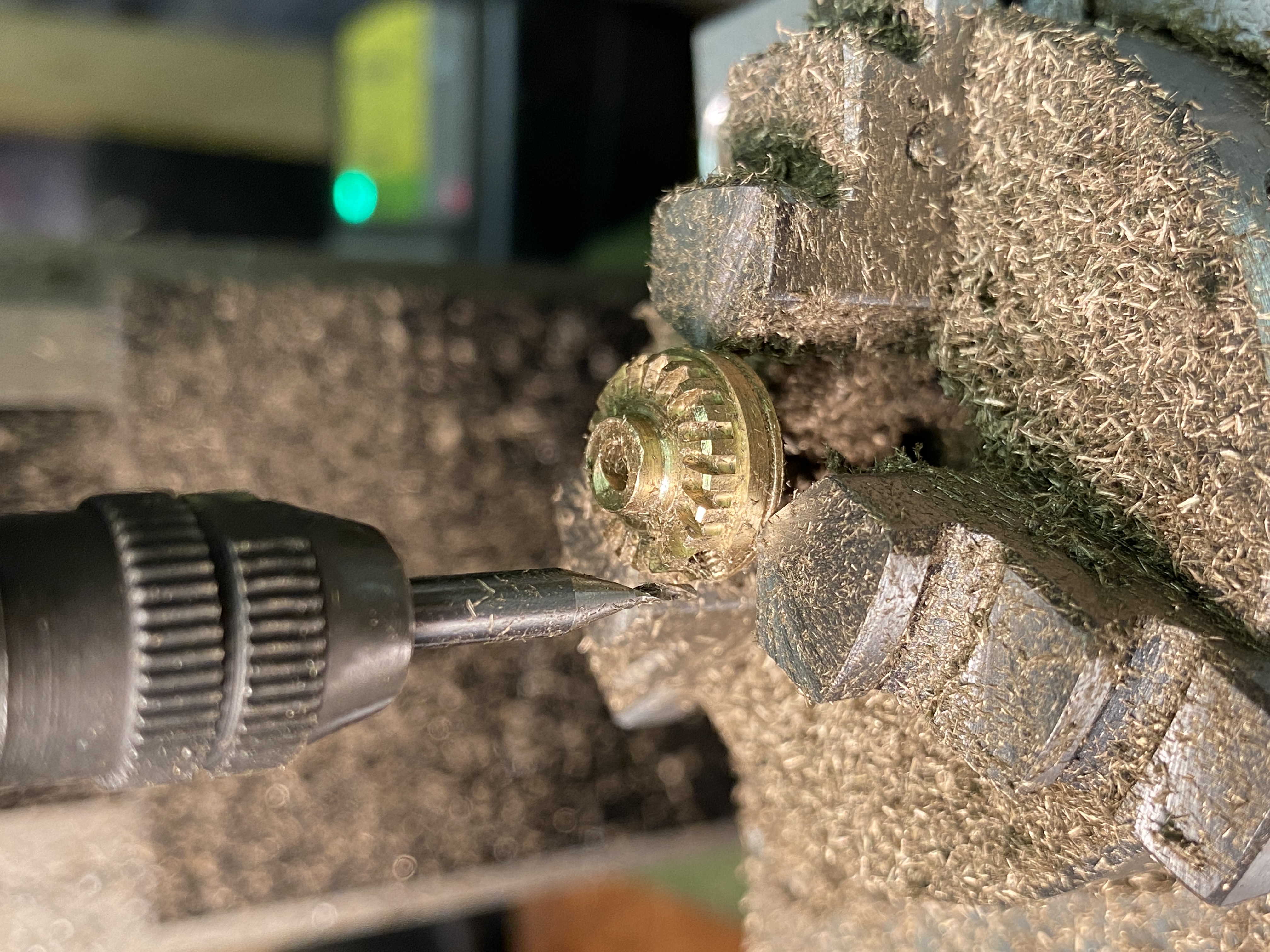

This was done with a dividing head made for the Proxxon Mill.
I then bored out the George Turner wheels for my brass drum to push fit in, I will glue these eventually.

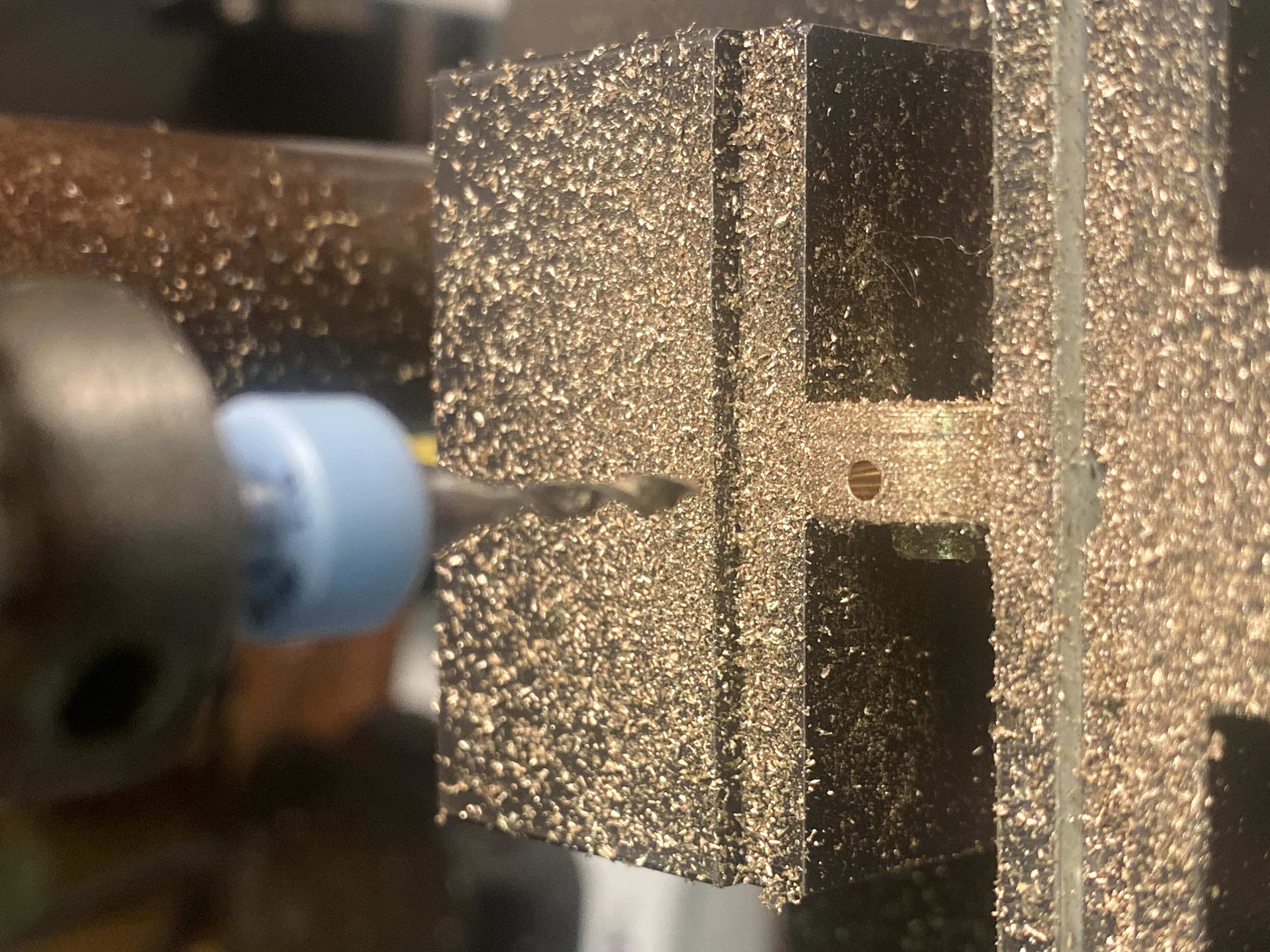

Oh and drilling and tapping the little grub screw was really rewarding, harder than it looks. Well it was for me.

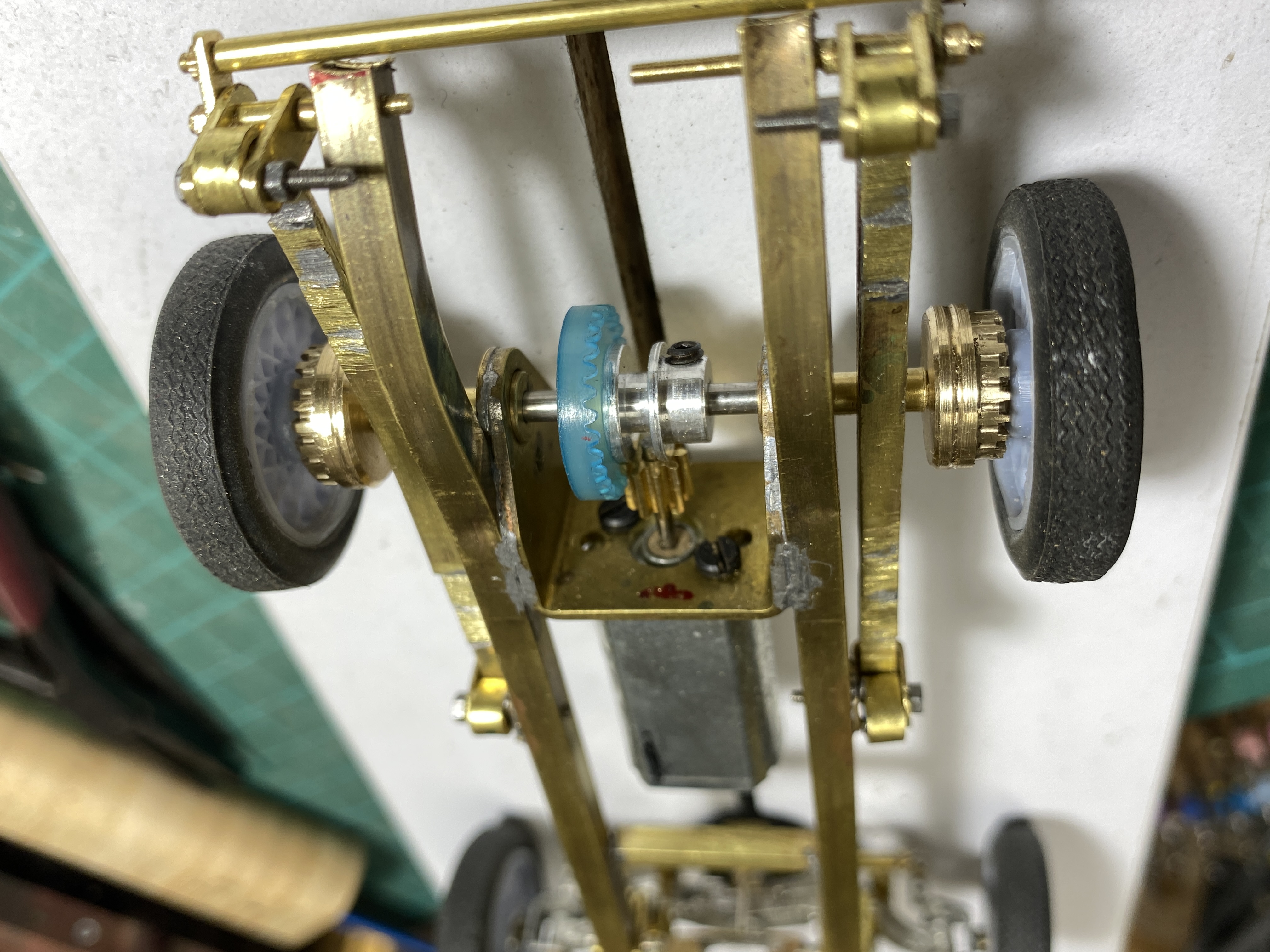

I have also been working on the back suspension, I'll post a separate post for that so I don't bombard one post too much.
