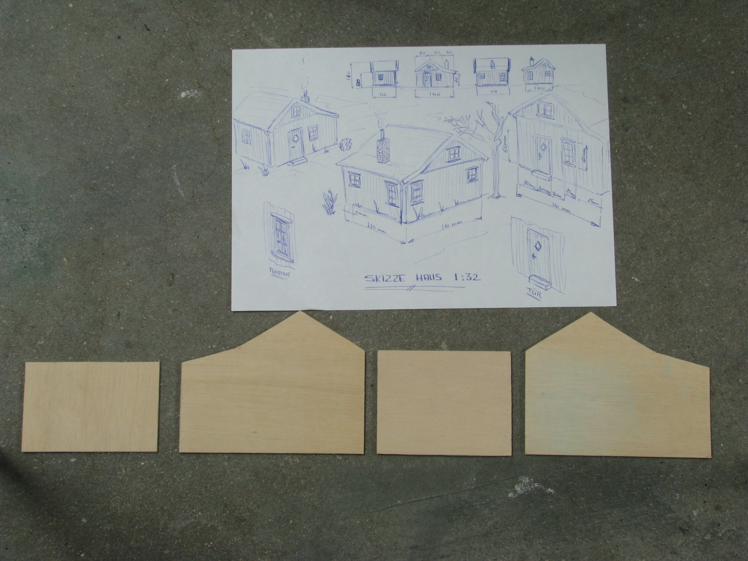

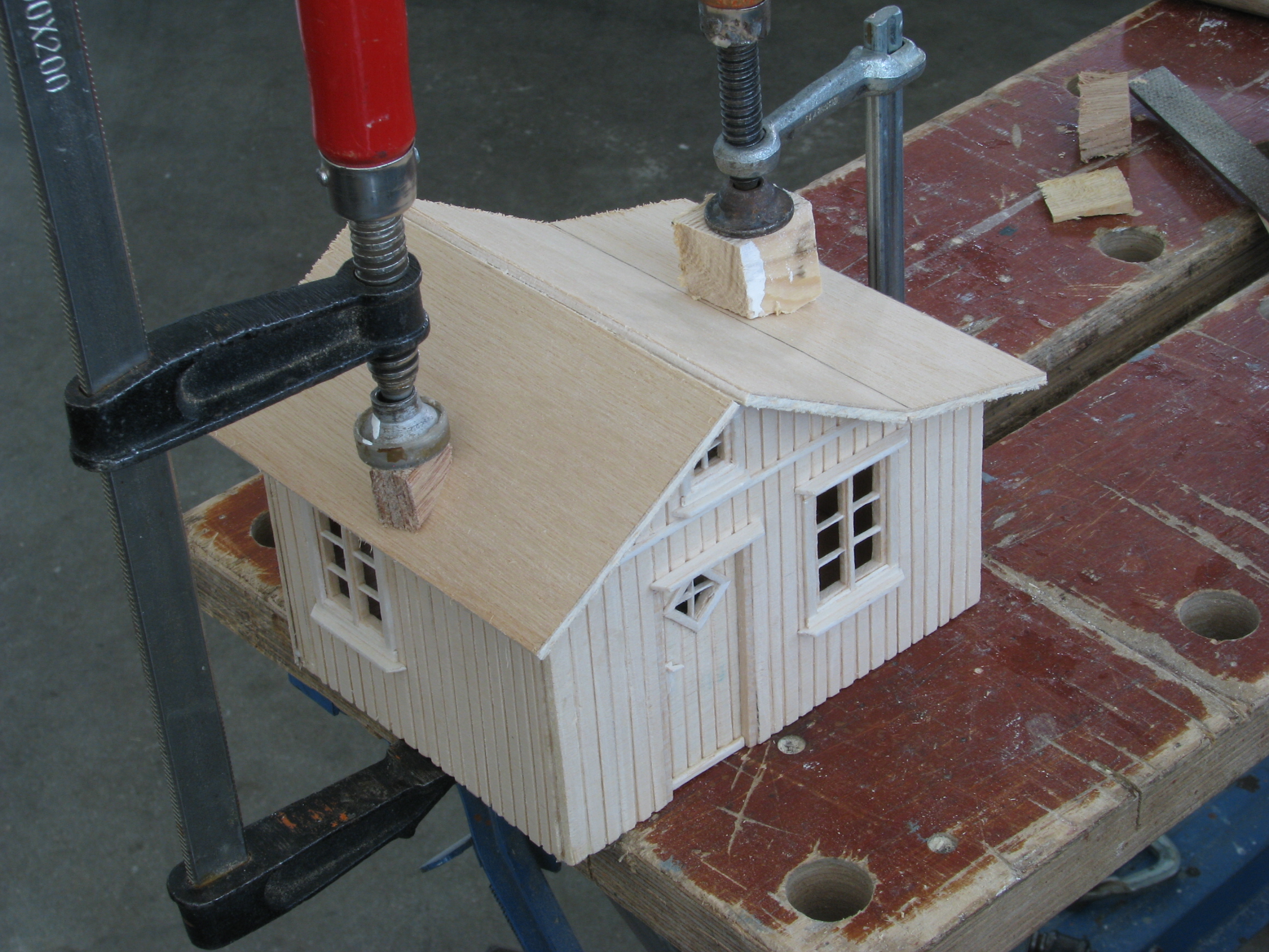

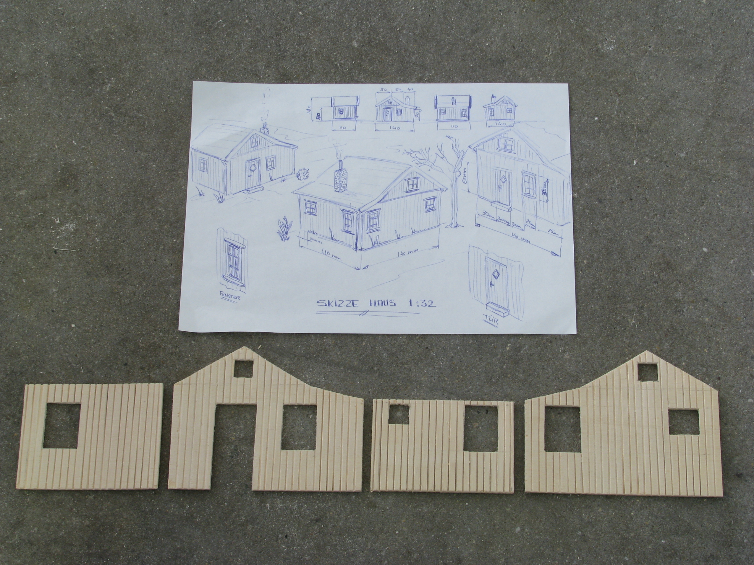

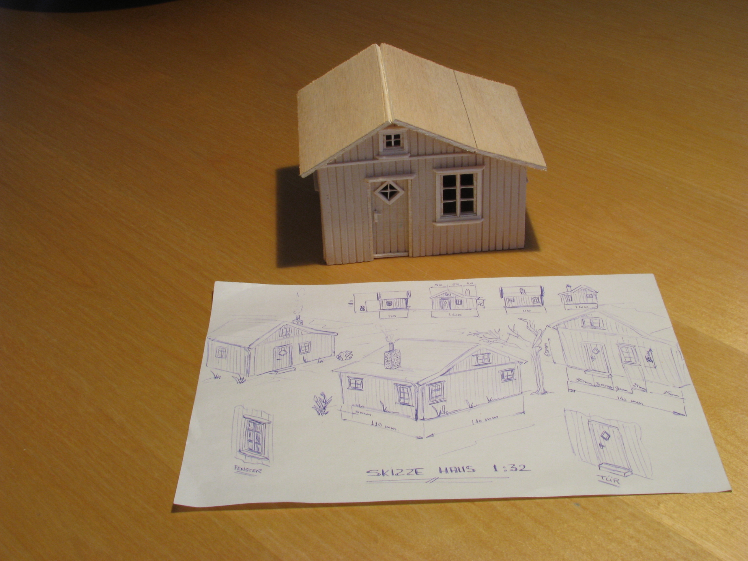

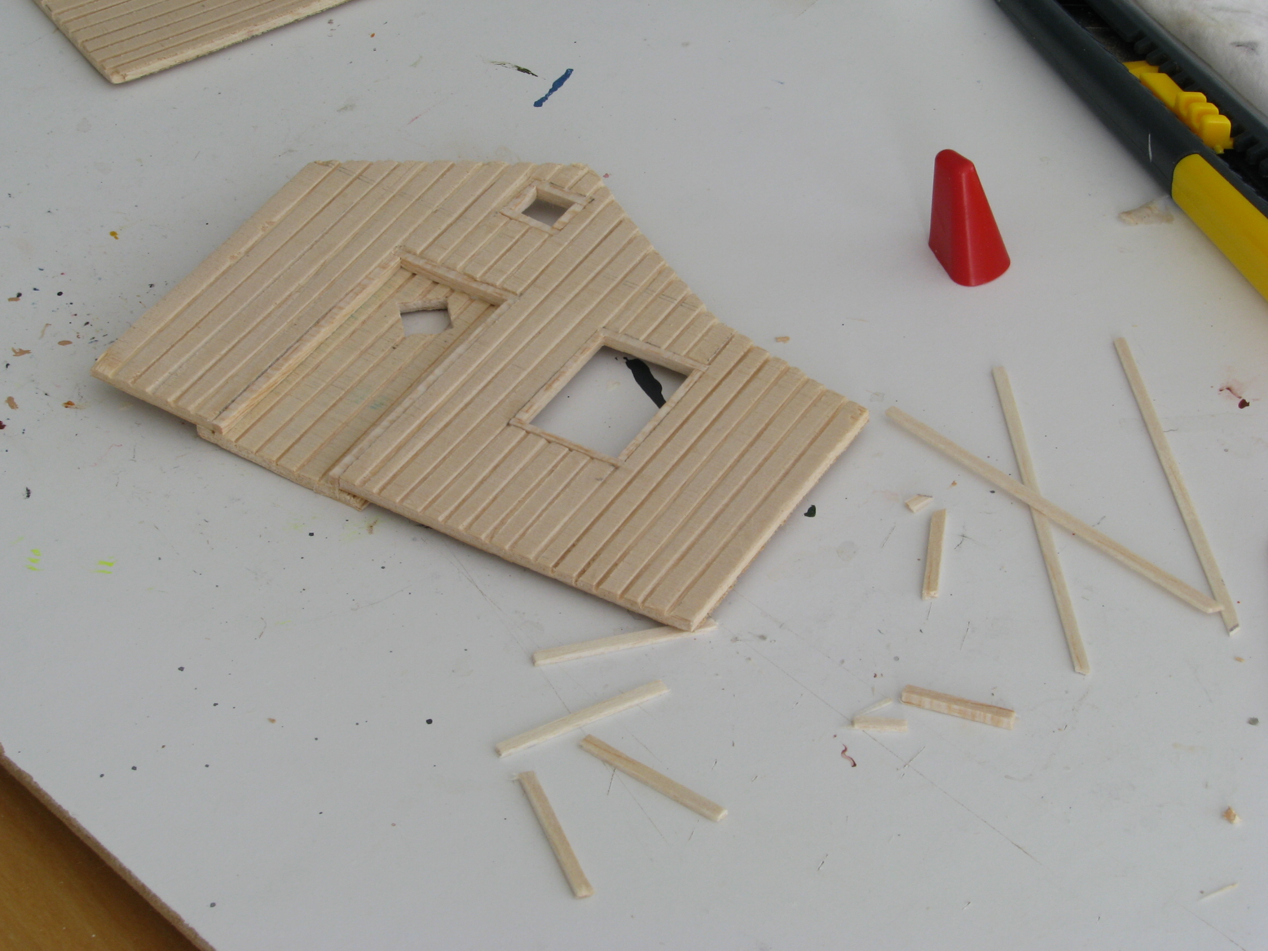

If you want to make your own buildings, here's an example of how I did it on my Swedish Rally Track:
Hub Thumbup
[attachment=16508][attachment=16509]
An example could be found in a holiday brochure about Sweden.                            The drawing of the house and the four 3mm plywood walls.
[attachment=16510][attachment=16511]
Testing all parts together.                                                                                                             Sawing the walls to get that typical plank structure.

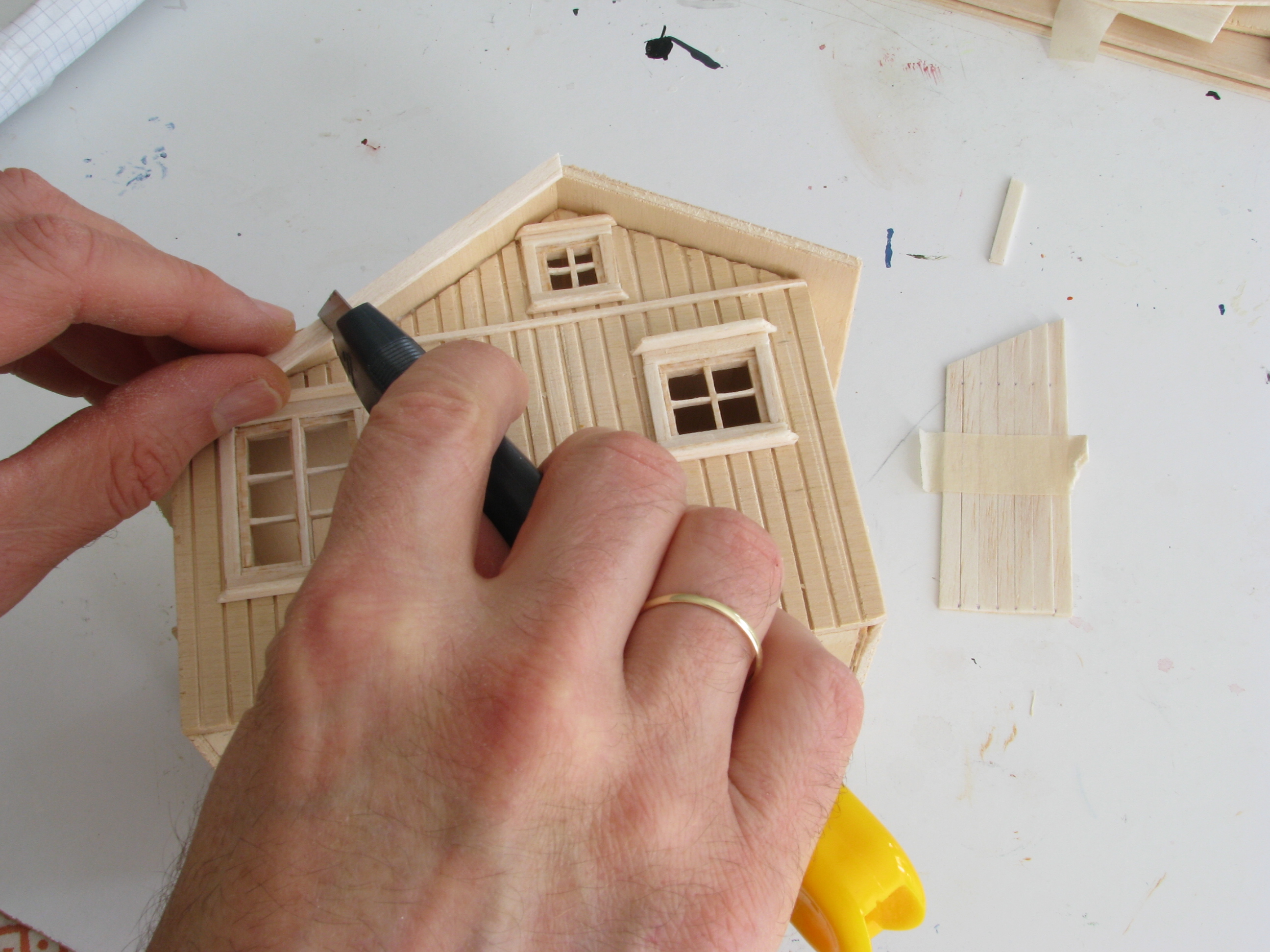

[attachment=16512][attachment=16513]
Drilling holes for the window and door openings.                                                             All openings are finished.
[attachment=16514][attachment=16515]
Gluing the balsa wood window and door frames.                                                             Some patience was required.
[attachment=16516][attachment=16517]
Testing all parts together again before gluing.                                                                    White glue on the walls.

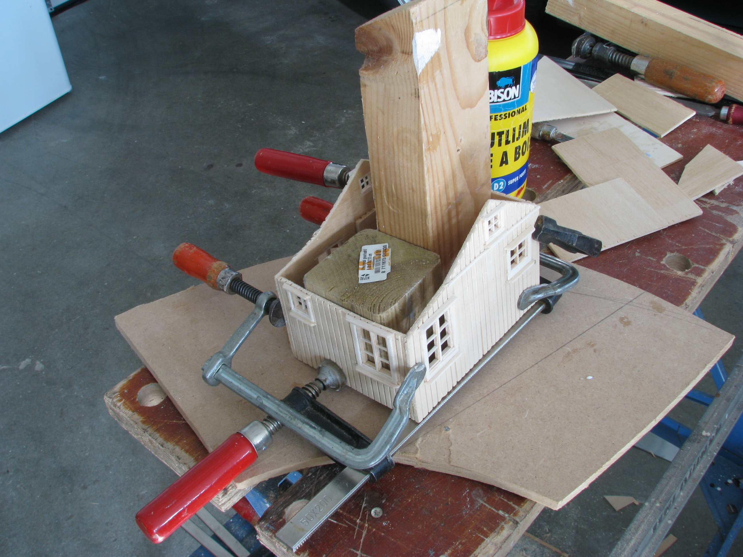

[attachment=16518][attachment=16519]
Clamping the walls.                                                                                                                        Clamping the roof to the walls.

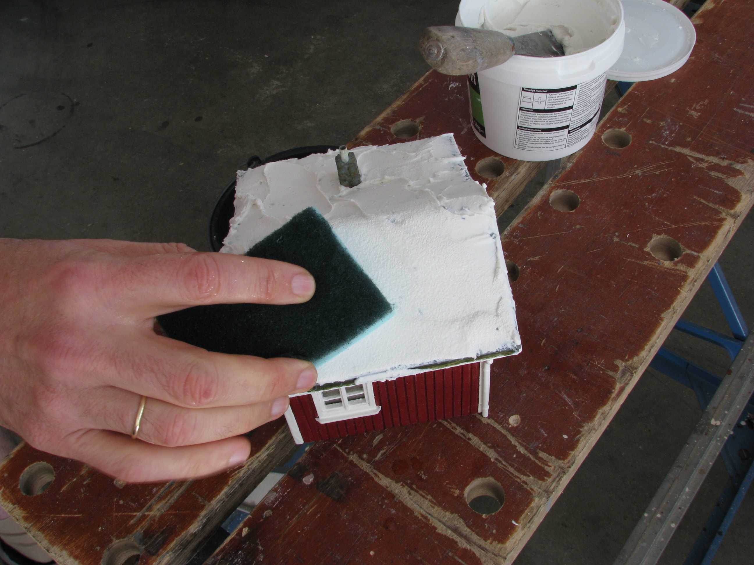

RE: Swedish Rally Track - rallyhub - 24th-Jul-21

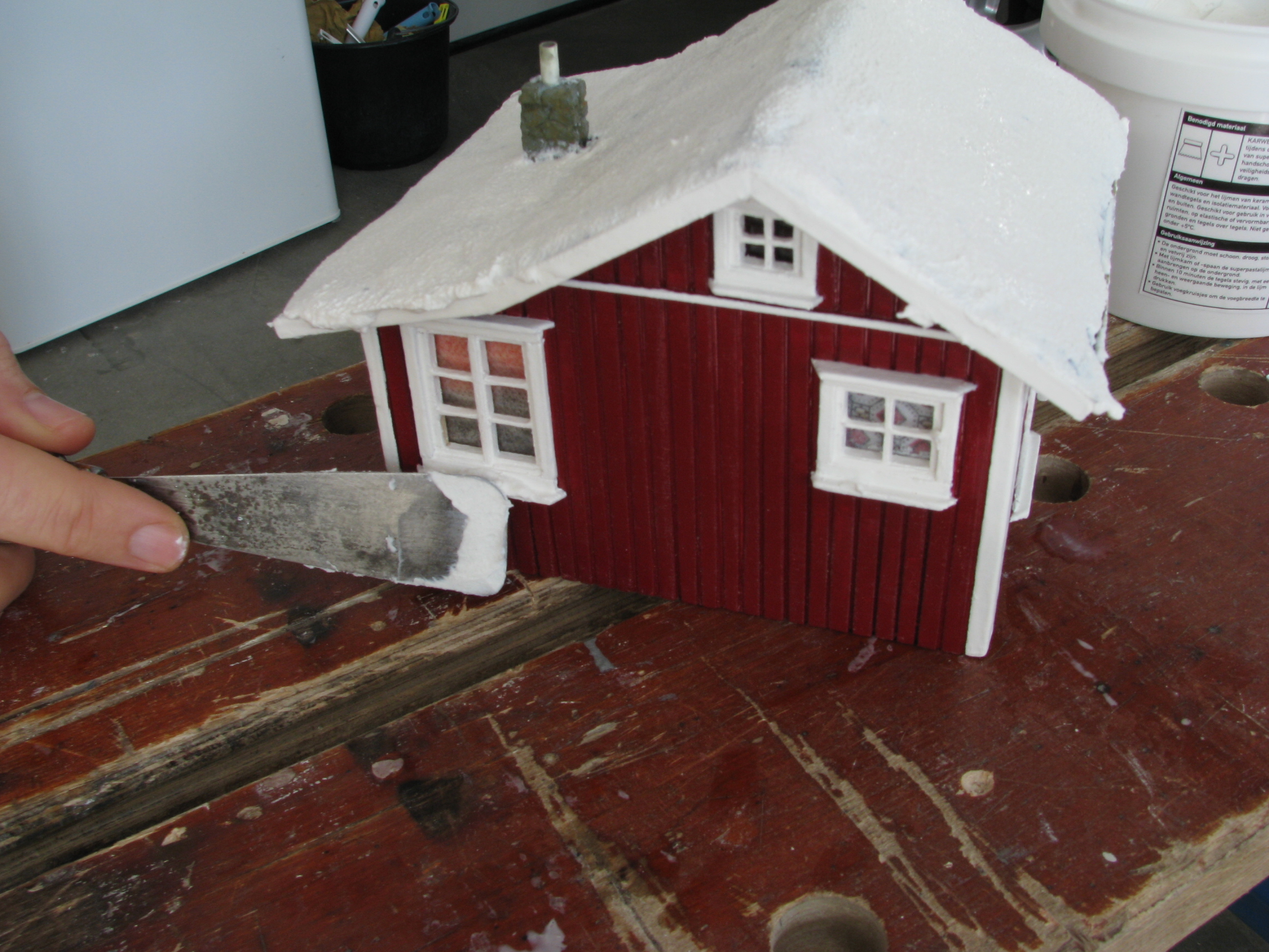

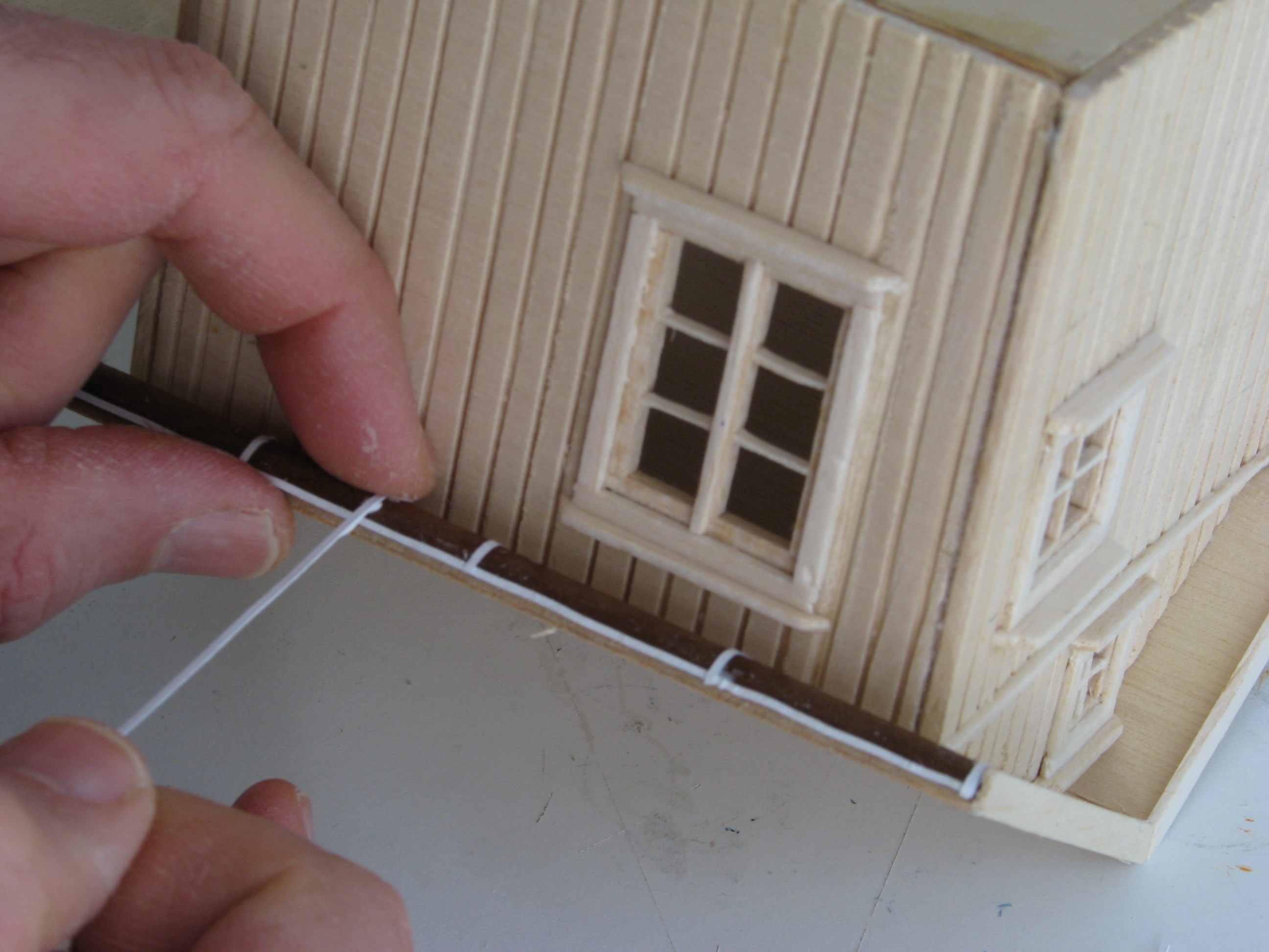

Here you can see the next phase of the construction process:
[attachment=16520][attachment=16521]
Creating the balsa wood roof trim.                                                                                          The rain gutter brackets were made from a strip of paper.
[attachment=16522][attachment=16523]
Painting the typical white edges.                                                                                             Gluing the aluminum downspouts to the building.
[attachment=16524][attachment=16525]

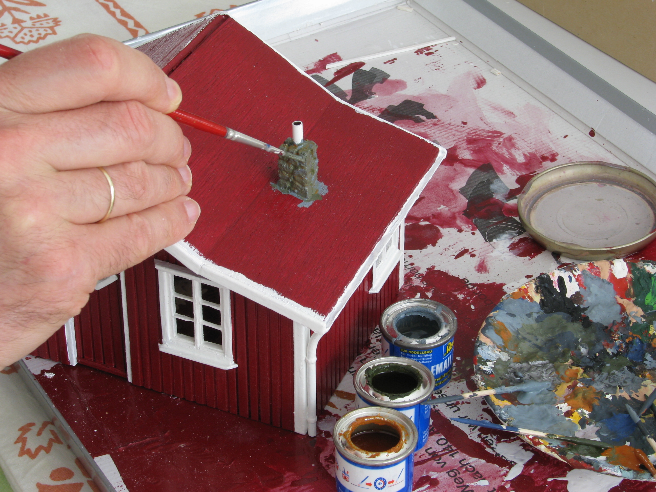

Roof details.                                                                                                                                      Painting the chimney.
[attachment=16526][attachment=16527]

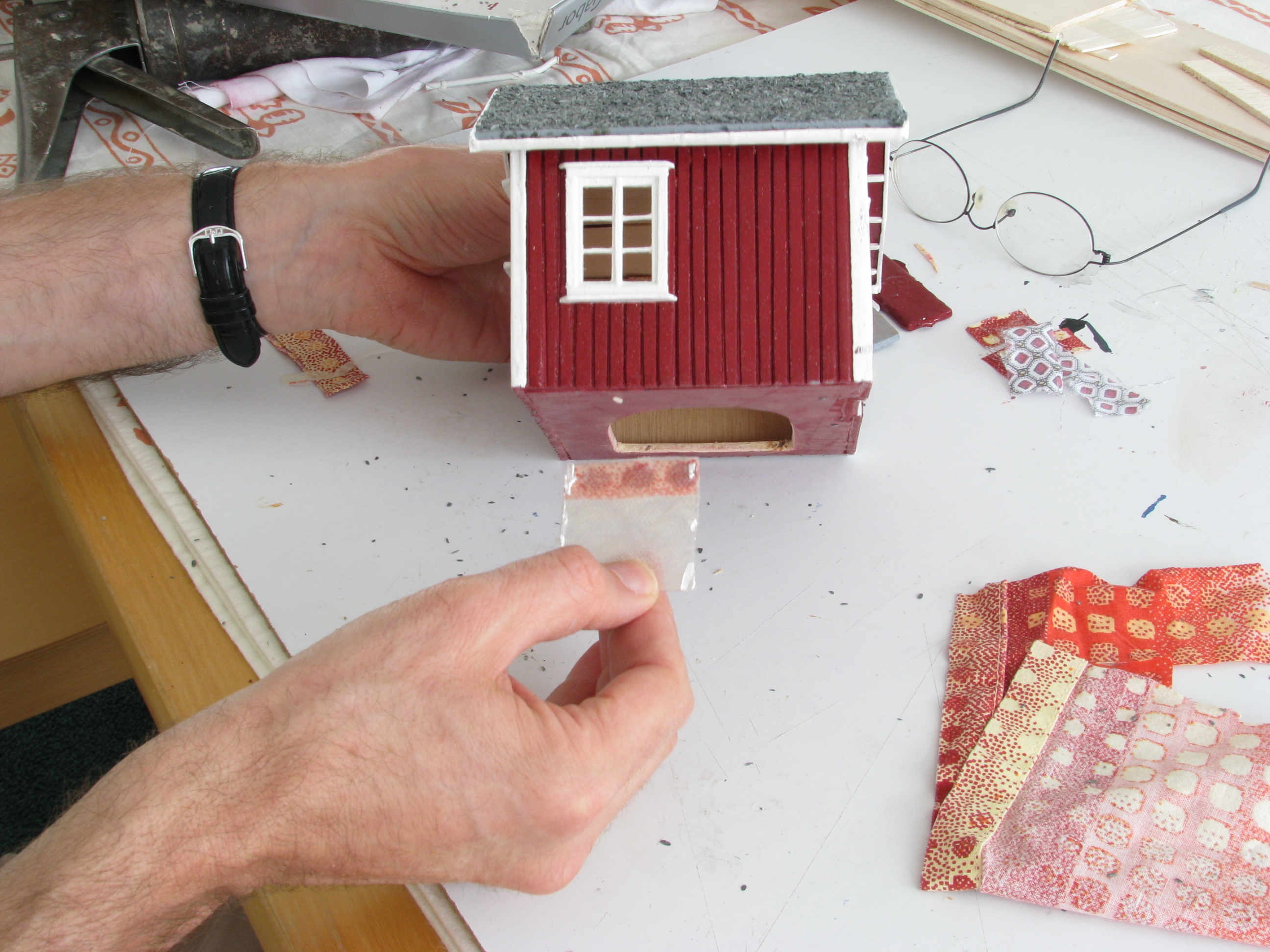

Roof grit.                                                                                                                                              Gluing the plastic windows and the cotton curtains.
[attachment=16528][attachment=16529]

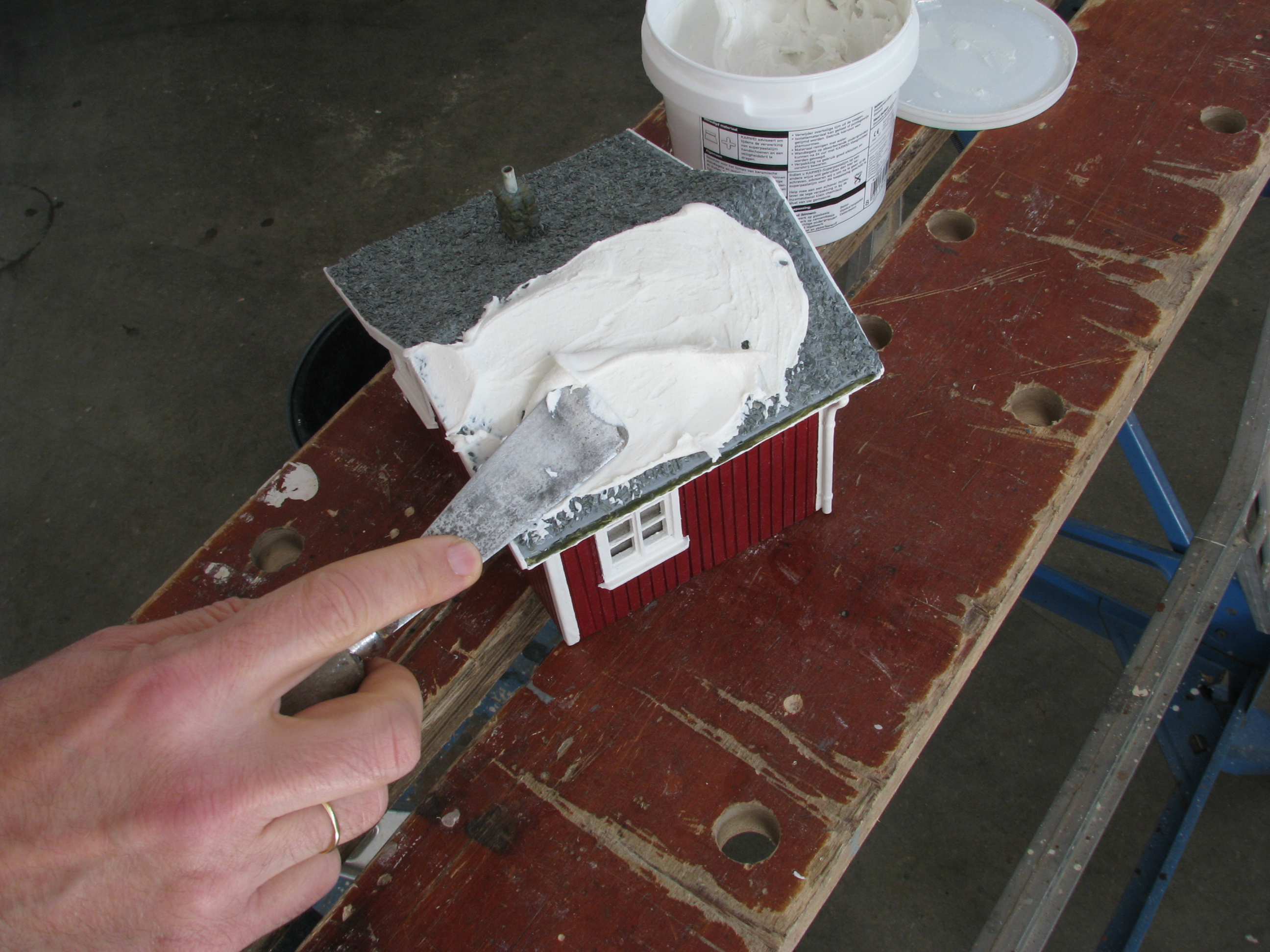

Applying tile adhesive to the roof.                                                                                            Finish with a wet sponge.
[attachment=16530][attachment=16531]
Applying tile adhesive to the windowsill.                                                                              The Swedish house is finished.

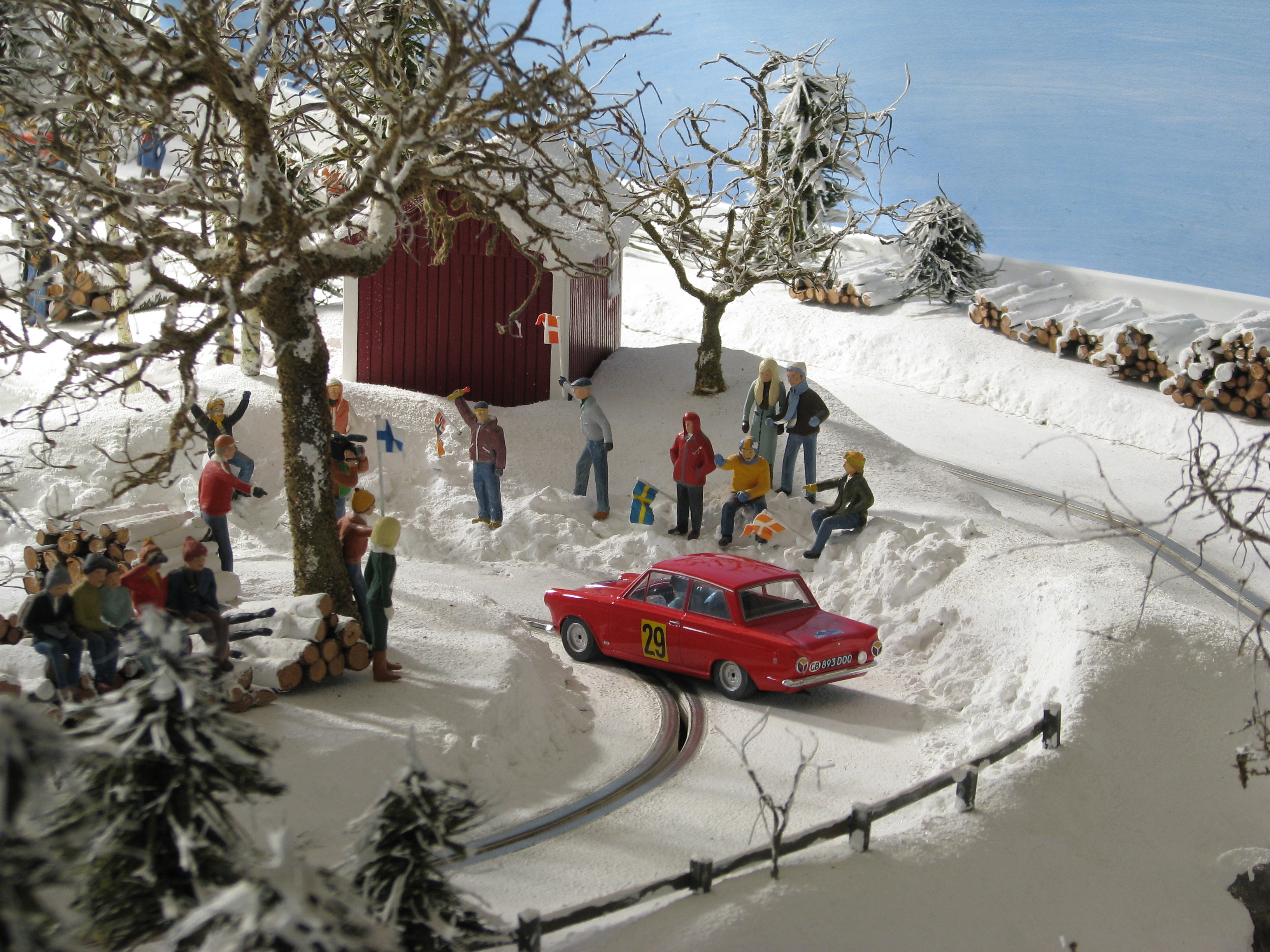

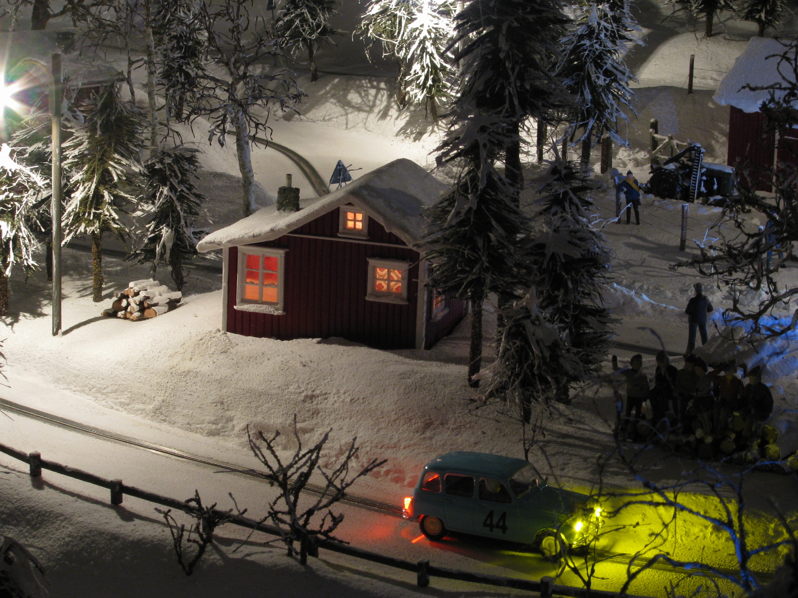

RE: Swedish Rally Track - rallyhub - 19th-Jul-22
I think I've discovered a strange effect of climate change on slot tracks.  Cool
It's now almost 35°C/95°F in the garage, but the snow on my Swedish Rally Track hasn't melted yet.
40°C/104°F is forecast today.  Sweating
Maybe the pictures will help cool down.
Hub Thumbup
[attachment=24974][attachment=24975]
