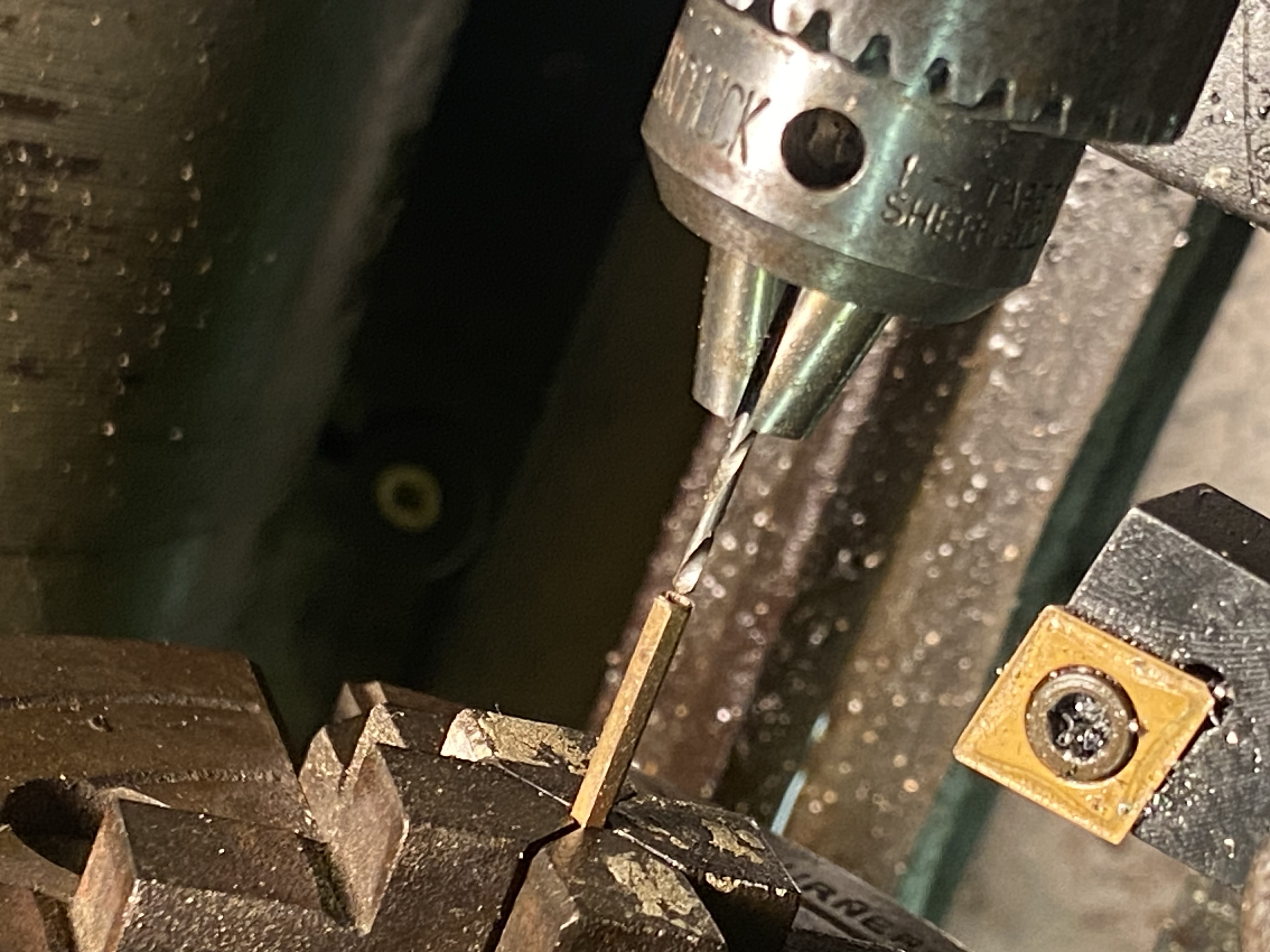

RE: Flying Fiona 1929 Fiat - Tibbs - 14th-Nov-23

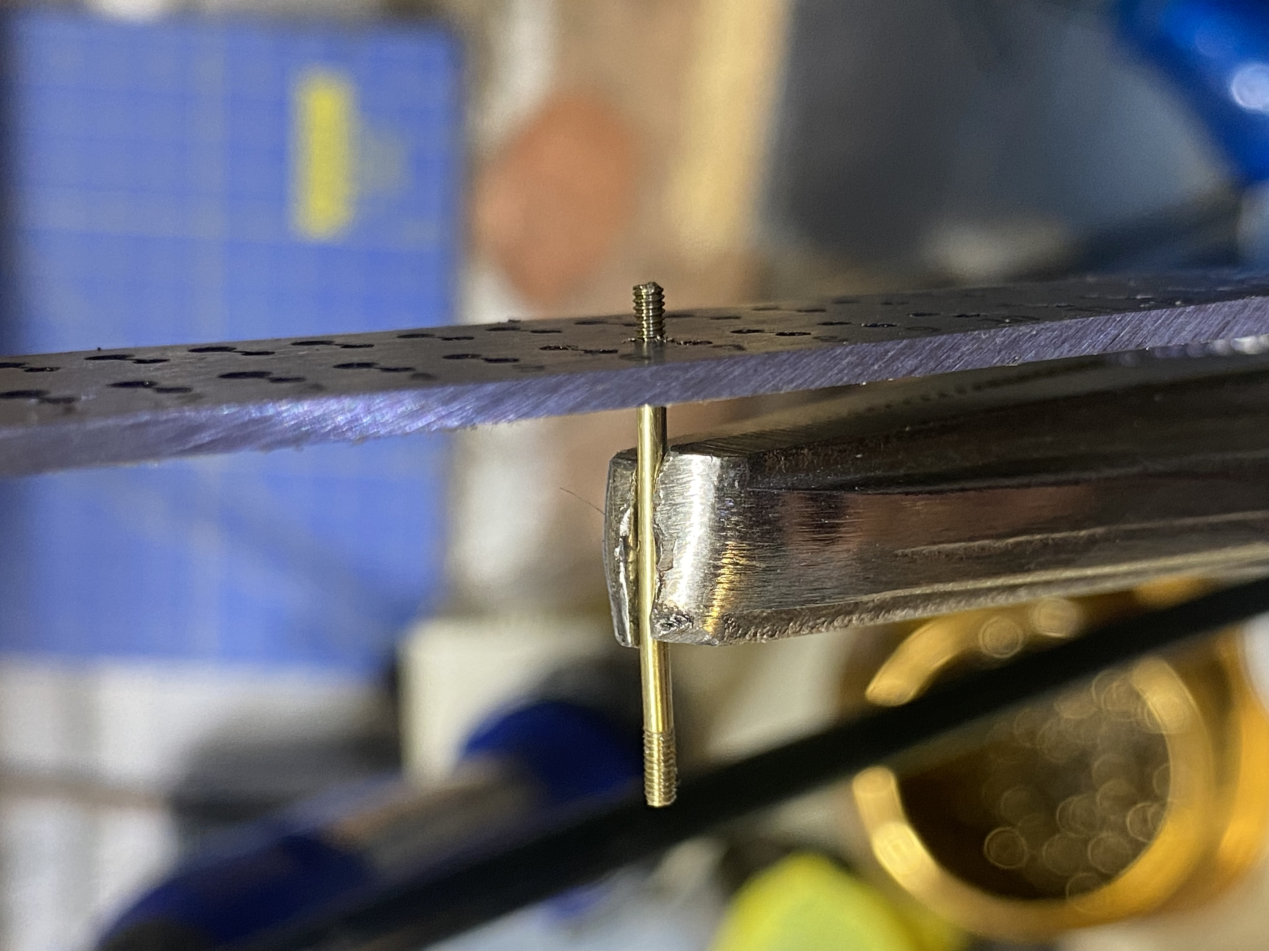

A little bit more progress on the suspension.

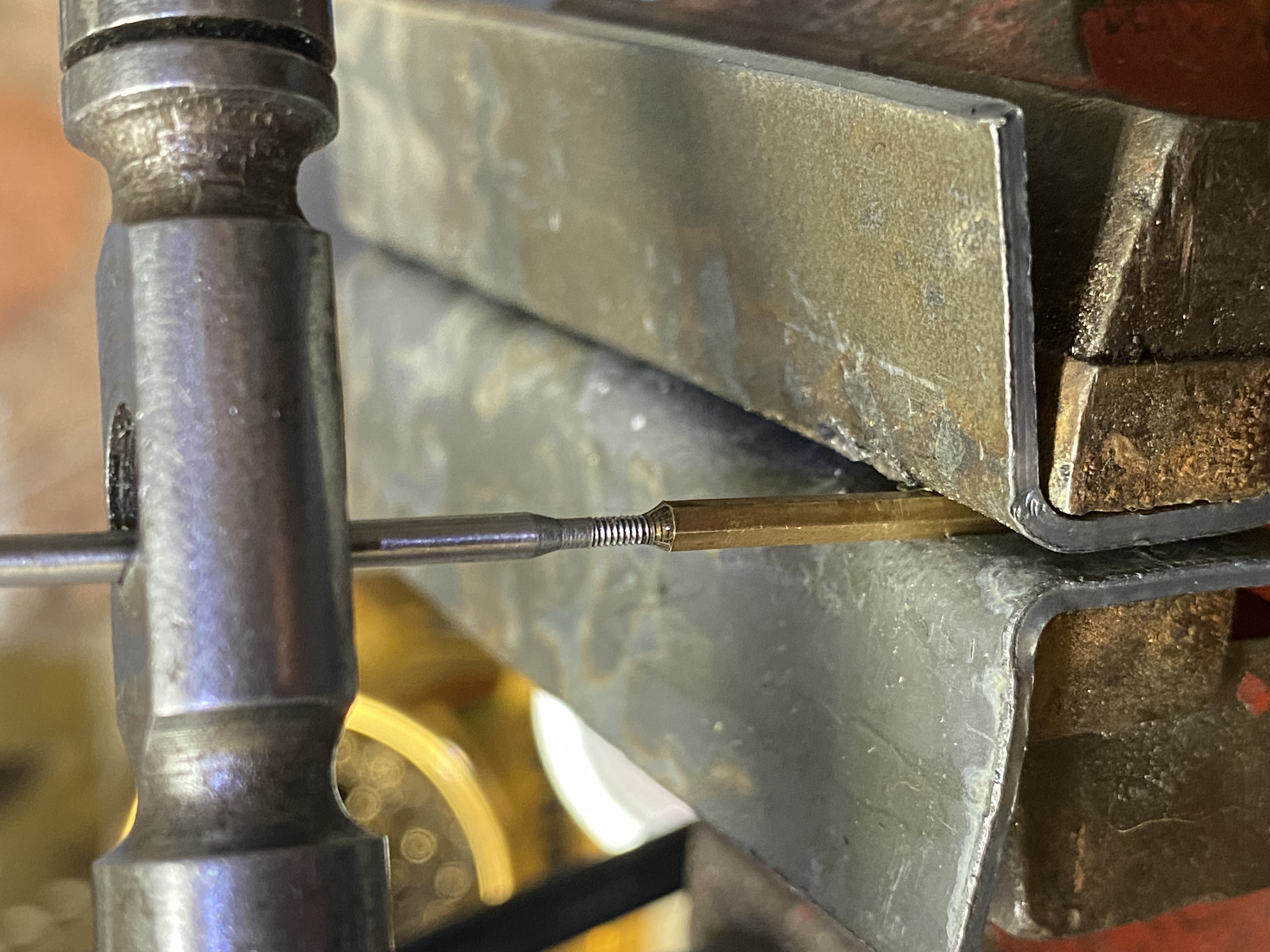

I brought some 1.2mm brass rod and some 2mm brass square bar.
The rod I threaded the ends and then cut and bent to make some u-bolts.
I didn't want to make a order of just 1.2mm threaded nuts from Prime miniatures so I decided to try and make my own nuts, hence the 2mm brass square bar.
[attachment=32400]

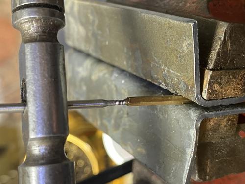

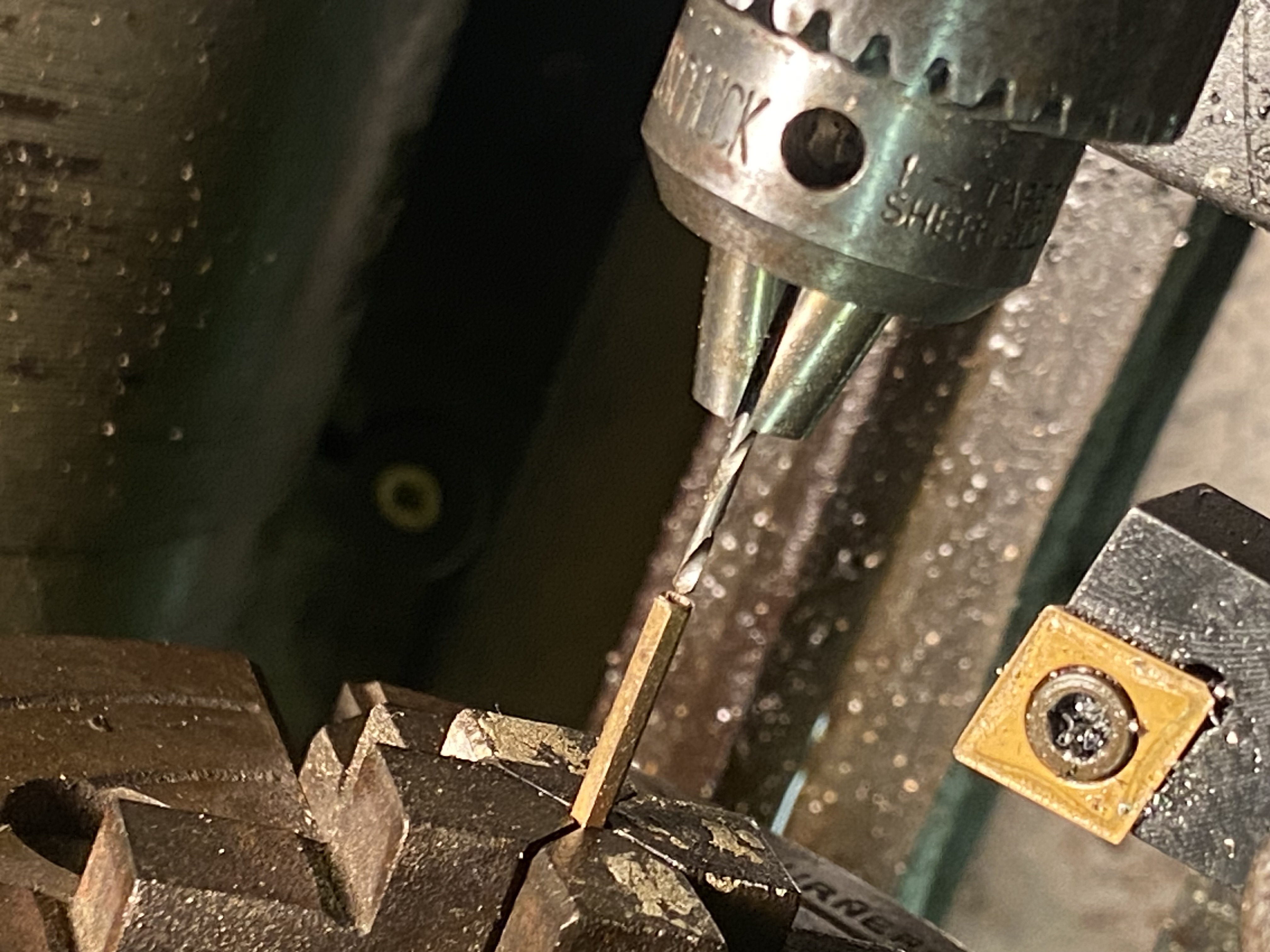

I'm still learning on my little lathe, so the drilling and tapping of the square stock was heaps of fun, when I remembered to breath Rofl
[attachment=32409]
[attachment=32410]

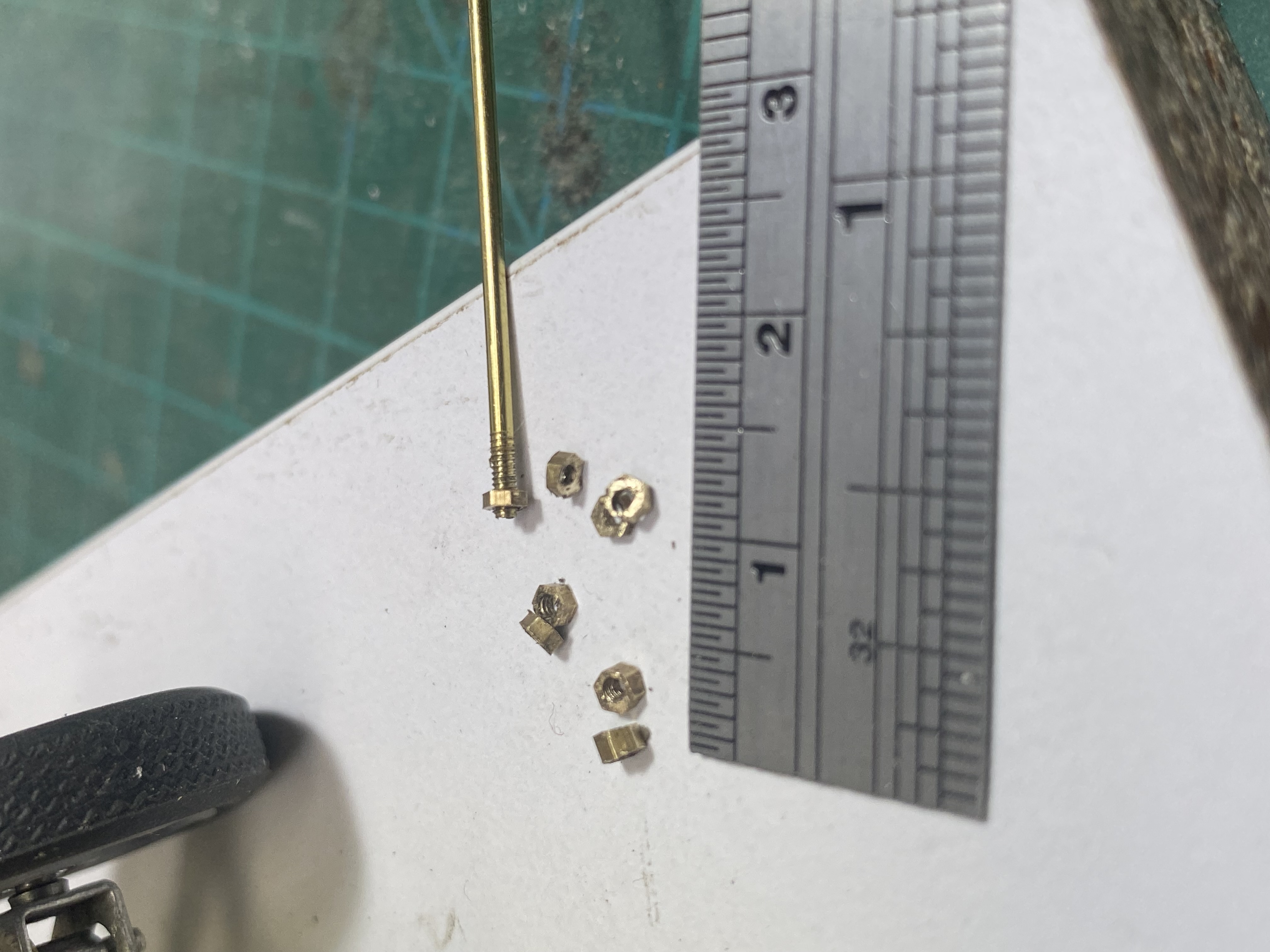

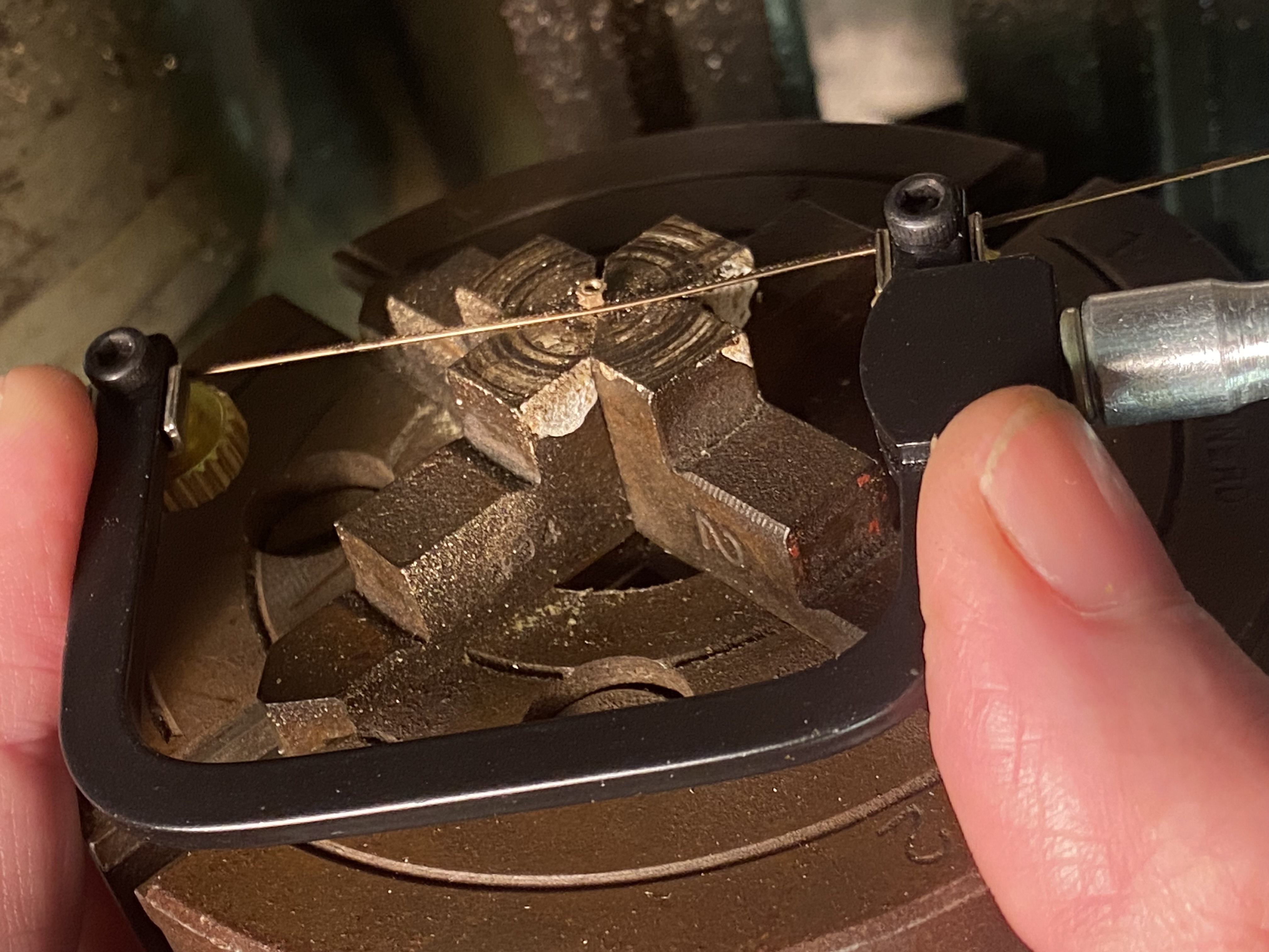

I brought a jewellery's mini saw to cut the nuts as the smallest hack saw I have the blade was way too thick.
[attachment=32411]
I was over the moon when they actually worked, a little filing and they do the job nicely.
[attachment=32412]

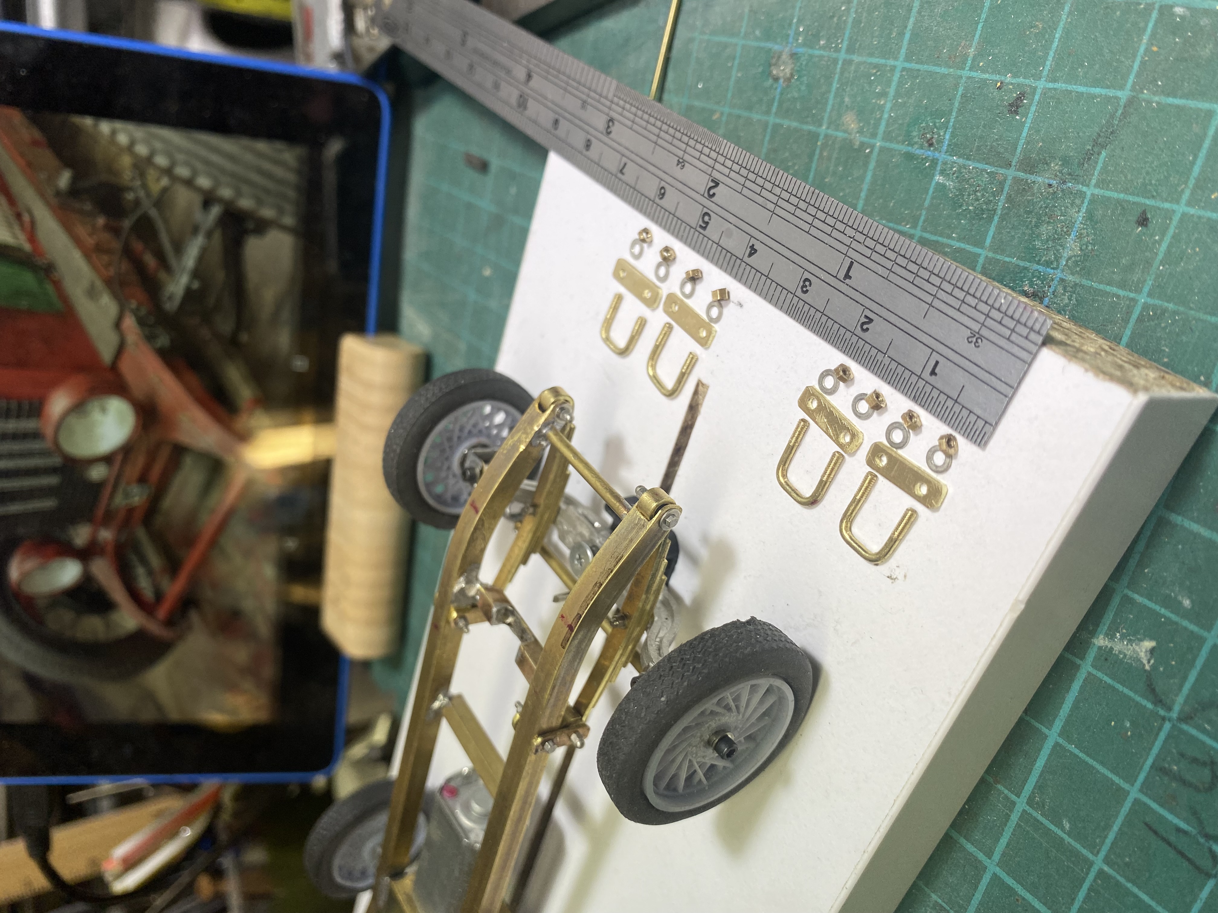

Then I used my little bench cutter to make the small plates.
[attachment=32413]

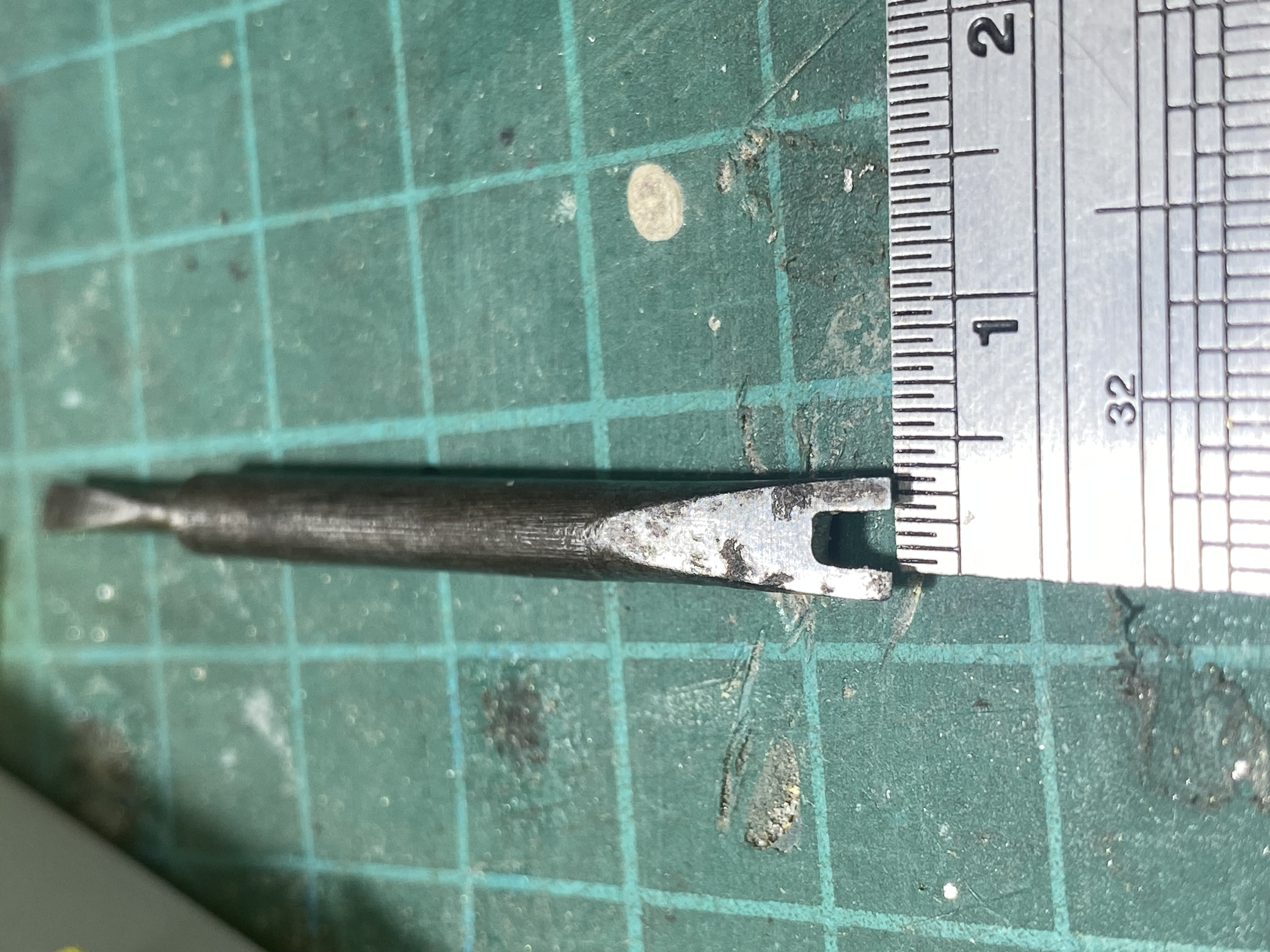

I didn't have a 2mm spanner so I ground down this little thing I found and it fits well into the end of a exacto handle.
[attachment=32430]

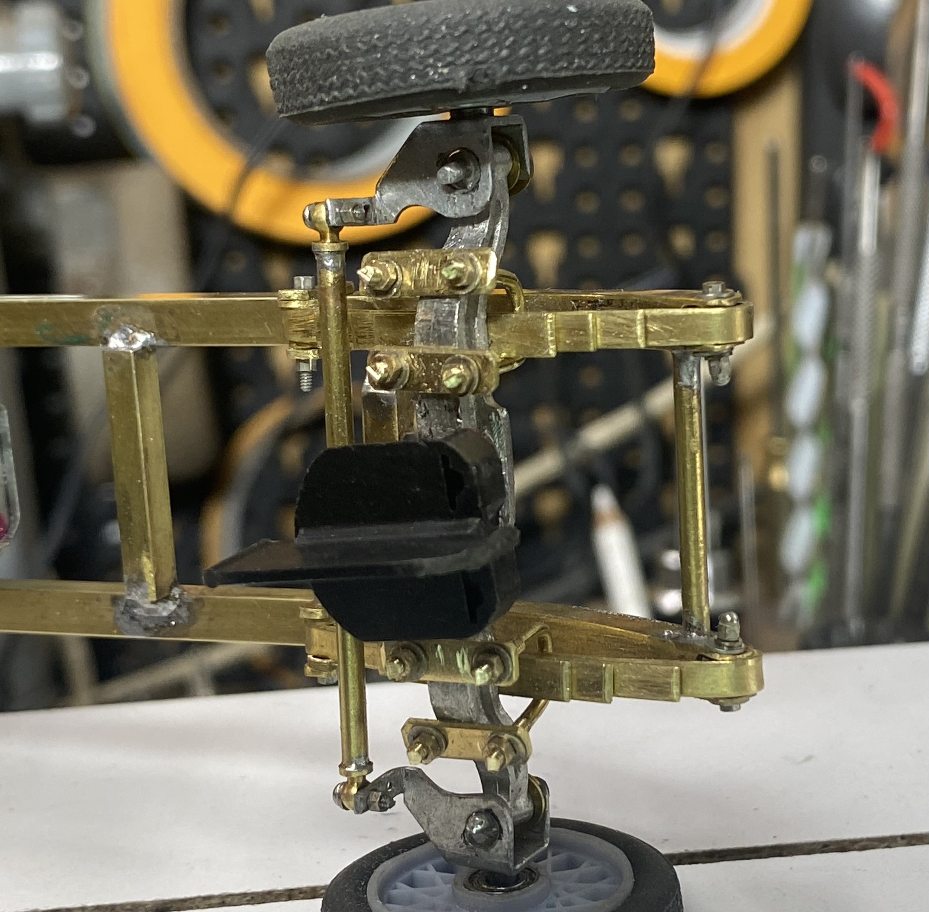

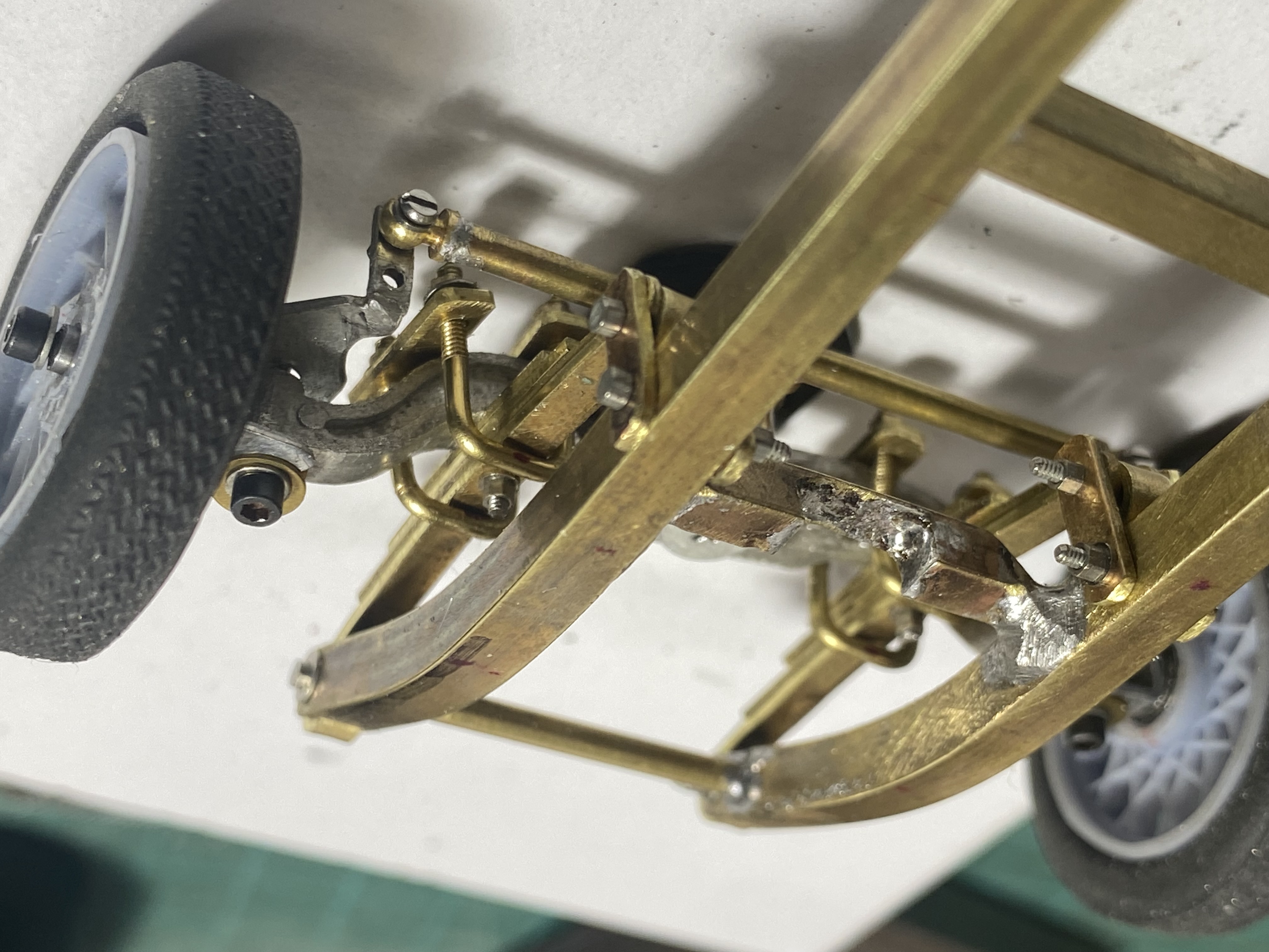

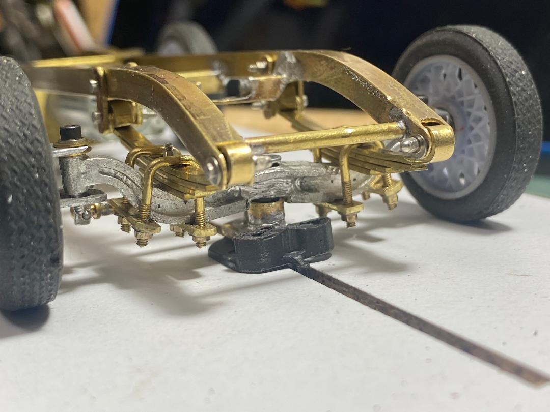

They do exactly what I was hoping and I think look the part too.
[attachment=32431]
[attachment=32432]
[attachment=32433]
