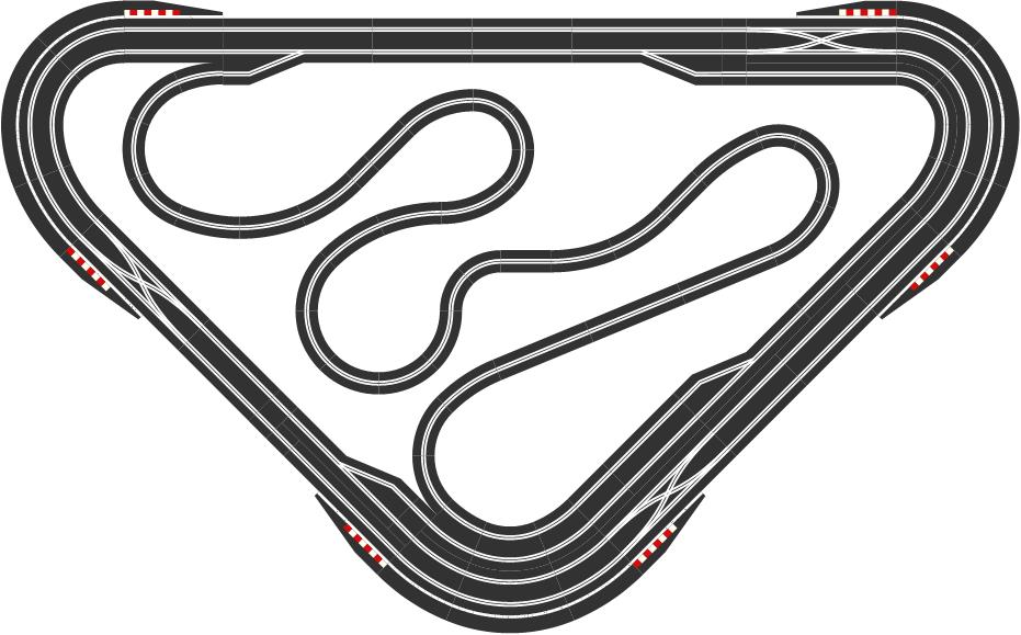

RE: The beginning of a track. 1:32 scale - JasonB - 20th-Oct-19
(10th-Oct-19, 09:05 AM)Skogis Wrote:  But i guess you could run digital and have pitlanes to change into a new part of the track.
Yes, there are some interesting possibilties.
This is a digital tri oval and single lane rally track combined. Obviously some significant "butchering" of track pieces would be required.
[attachment=4041]
